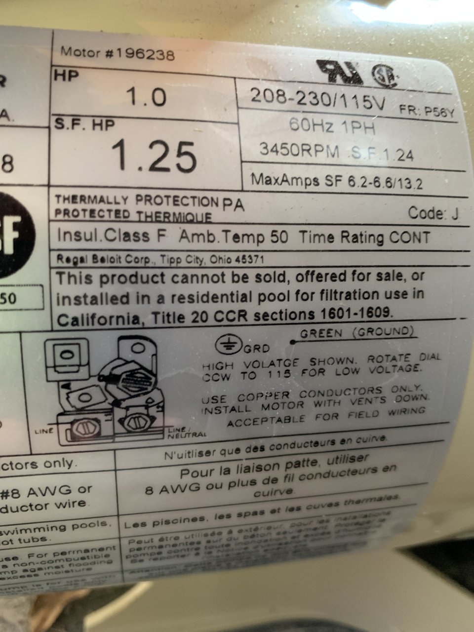

    That must be a better model than mine. I don’t have any lights or digital display. I’ll take a picture of it in a minute

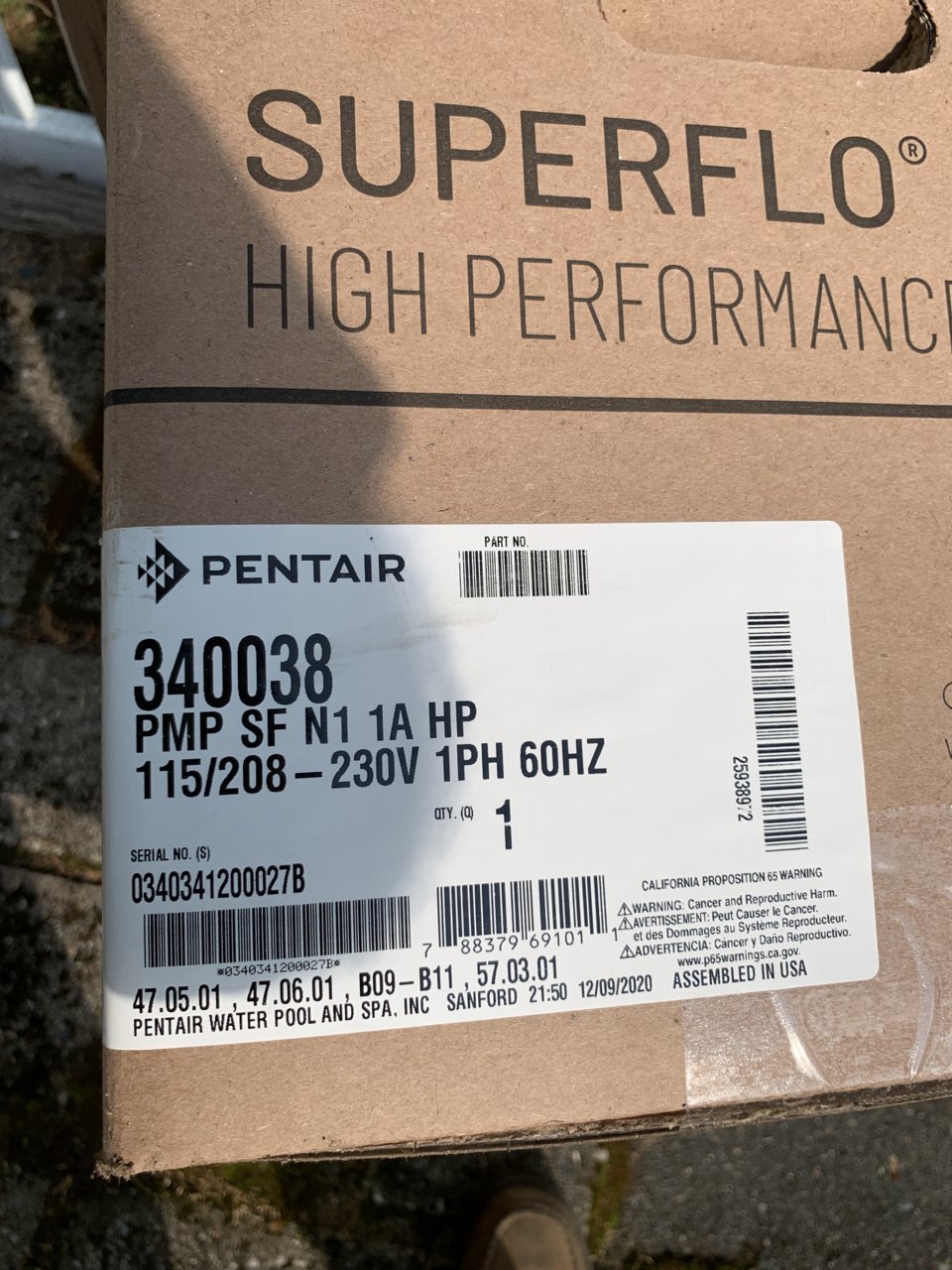

    The box

    Model #196238
    sorry that’s the motor #
    The model #

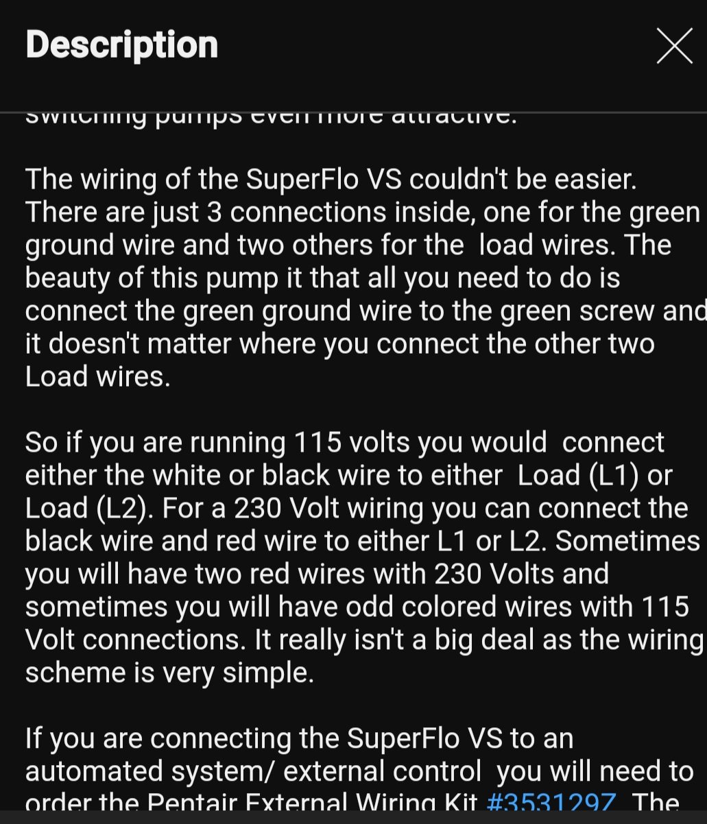

    In description,

    Ok it shows which line is neutral but can I still hook this up if 110?

    Thanks I think I got it figured out now.

    Ok I’m an idiot. It says right there to rotate the dial ccw for low voltage

    for 120v wiring, connect the hot/black to L1, white/neutral to L2. that pump also warns you that it's pre-wired for 230v, you need to rotate the black knob just above the L1/L2 connections counter clockwise to display '115' in the small window--this is critical to making it work, and the above black text doesn't identify this step, which will burn up the motor.
