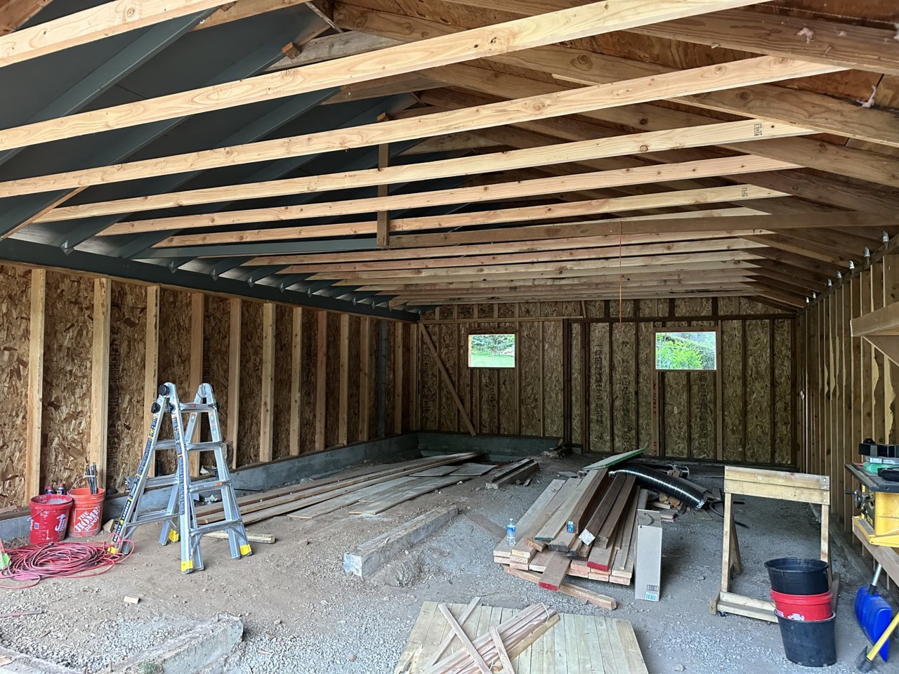

    Shop is ready for concrete:
    I’ve got the excavation crew sticking around an extra day to dig me a trench to finish my conduit run and set me up with a footing and proper drainage for an 85’ long retaining wall around the building. They’ll also grade-out for my shed and fix some of the drainage around my gravel road with the backfill so nothing dumps into the shop or future shed. Gotta head to the supply house for drainage pipe and geotextile first thing. It’s a pretty solid dump of ground water right into the shop:
    Excited to get that remedied. Not excited to stack 585 wall blocks or backfill that wall with clean stone.

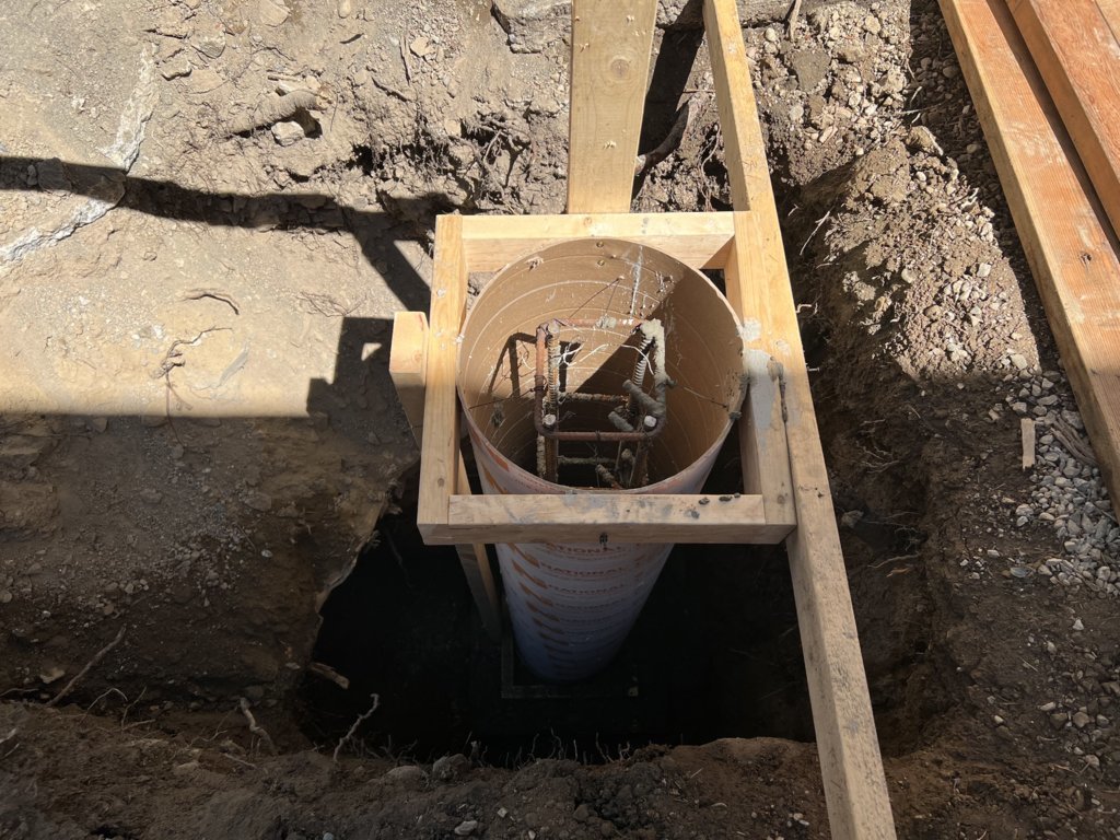

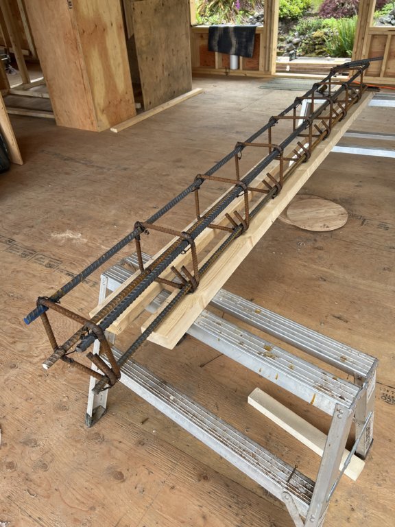

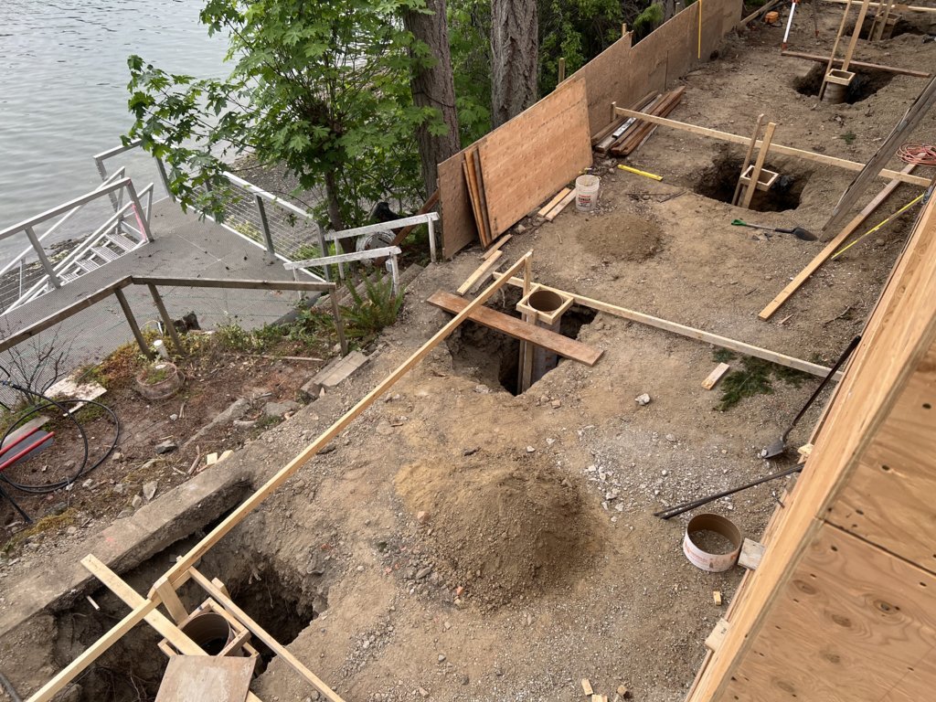

    We removed the portion of the original basement slab we needed to pull out for the plumbers and they have almost completed their groundwork .
    Meanwhile we've moved outside to complete the entry formwork , retaining wall / covered deck foundation extension and the ocean side deck post footings and columns .
    We have a geotech on this job due to our proximity to the ocean and for the deck columns , the geotech has spec'ed that we set the footings on the shale bedrock and behind a 1 to 1 aspect ratio to the toe of the slope down at the high tide mark .
    The columns ended up at different depths due to the various elevations we found the shale at . From the far end , 6' , 4' , 7' and then the final 2 closest to the camera are 9' deep.
    Our structural engineer has spec'd a cage of 15m (5/8") rebar with 10m (3/8") rebar closed ties , these reinforce the deck 14" concrete columns
    The 9' deep holes in particular posed an issue logistically as we had no shoring and the soil on top of the shale layer was pretty sandy and prone to caving in . I decided it wasn't safe putting anybody into those holes so we formed the footings and 14" sonotube columns as a monolithic form and tied in the footing rebar cage at ground level and lowered them into the holes
    We finished and braced all our sonotubes Friday and left for the weekend
    Sunday it rained and both deep holes filled with the water coming off the roof and the sonotubes sat overnight in about a foot of standing water and the cardboard tubes started to delaminate
    I was concerned the sonotubes would fail at the column to footing connection if we poured them monolithically with the boom pump so today we hand mixed and placed 22 bags of concrete into the 2 deep columns , pouring up to about 12" above the questionable cardboard form
    That sucked , no more sonotubes for this cowboy

    Belled piers might be easier, but not much. Cased piers are complete hell.

    I usually build a plywood column form

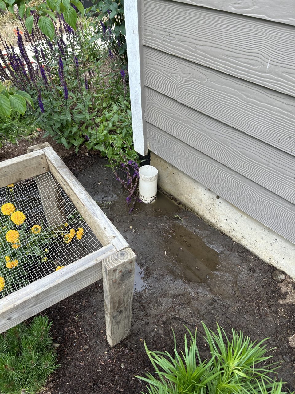

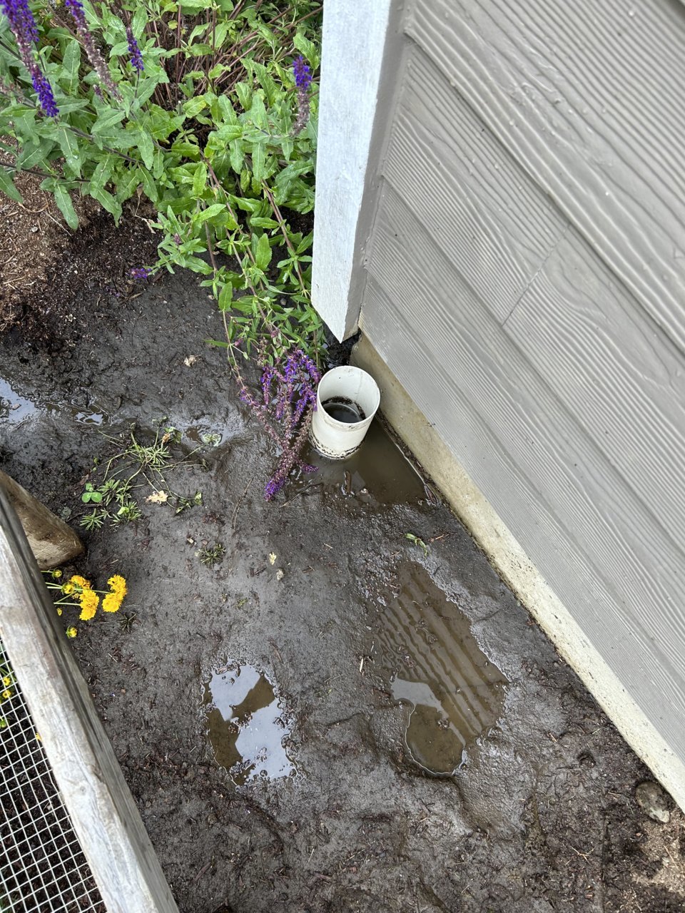

    Almost done with shop door trim (finally delayed a year or so ...haahhahahaha)

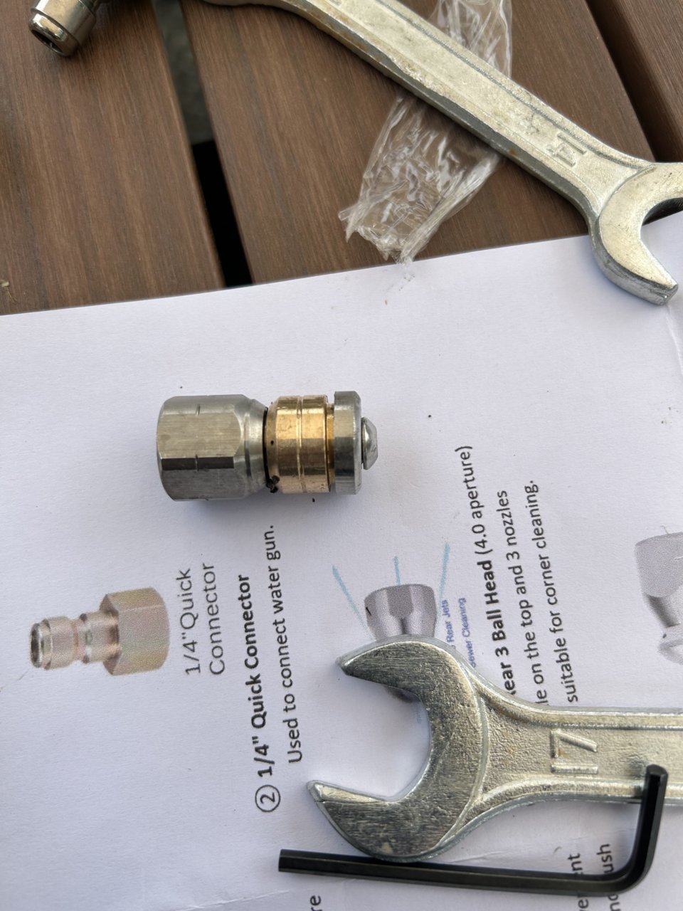

    New project time: Some growing blockage in gutter/back flush drain line/field. Anyone done this?
    Attempt #1: Pressure washer and specialized blast hose

    What a complete shit show. Then my pressure washer pump went south.

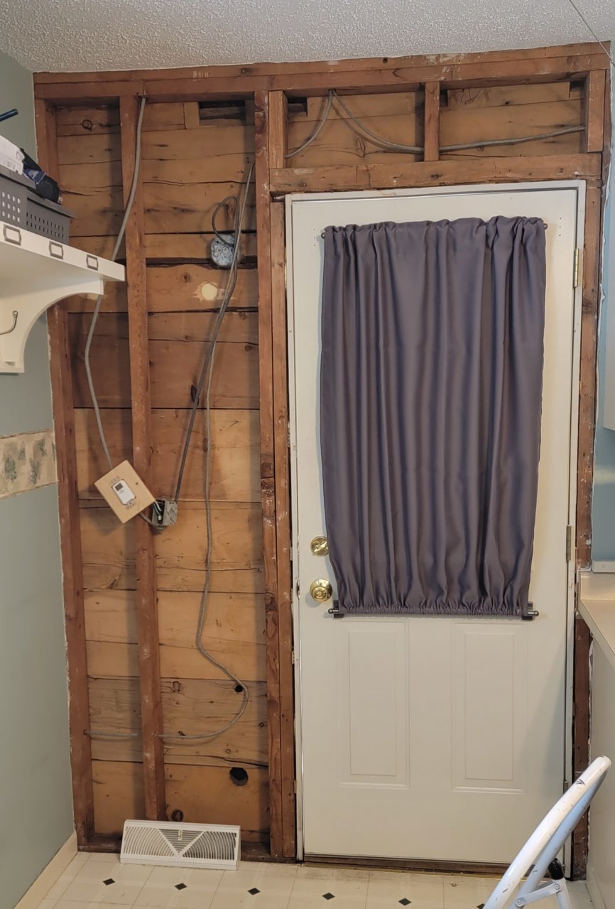

    In two weeks, I'm getting all new windows and siding installed. The siding will be LP Smartsiding. I pulled some sheetrock around my back door to put in a 36" door before the job begins and it looks like the sheathing on the outside of the house is 3/4" rough cut pine boards. I'm assuming the contractor is just going to wrap the house in Tyvek and put up the siding. With all the knot holes and open gaps, should I push for something better than just Tyvek? Maybe even some additional sheathing? The exterior currently has some old vinyl siding over a very thin layer of Alcoa brand fan-fold foam and tar paper under that. (And yes I will be installing a proper header when I frame the new door)20230607_120644.jpg
