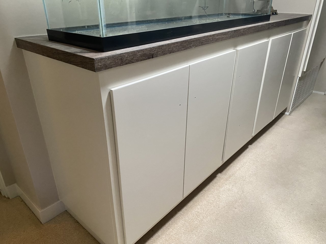

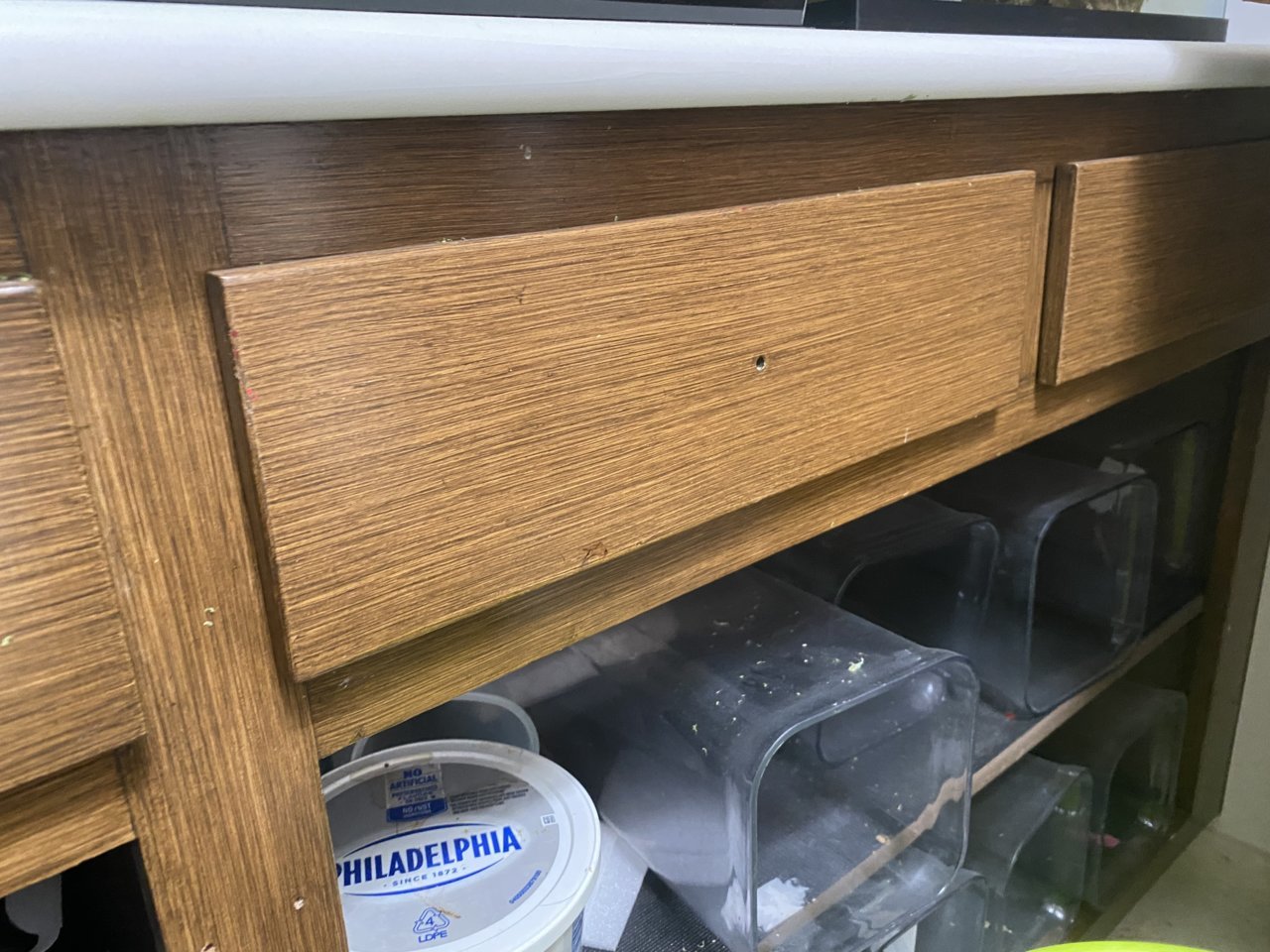

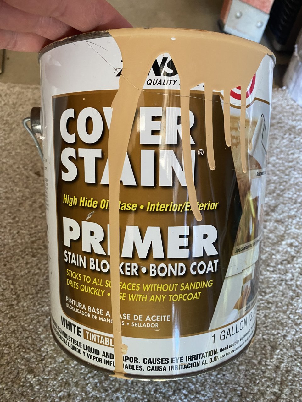

    As stated above, using an oil based primer is the key. We have done several and now only use Zinsser Cover Stain oil based primer. Shown below it is tinted to 'sandstone' then we brushed on Gel'd stain to make a faux finished wood grain effect over sanded painted pine in a bathroom. It came out really well, and looks like expensive wood.
    For solid colors, we also use Benjamin Moore high end paints which are not indicated specifically for cabinets and it works great long term. Also use foam roller with good results.
    Faux finished wood stain over painted cabinets
    Benjamin Moore Aura Windsbreath semigloss foam rolled over Zinnser Cover Stain primer

    That's the exact primer I like to use. Stinks as all get out, but works. I have used the Kilz Odorless oil base, but it definitely still has a smell to it. Also seems to splatter way worse than the Zinnser. It's getting harder and harder to find though with all the VOC things they keep putting out.
    I have to prime my entire house in it due to the severe nicotine buildup from 1965 to 2021. Even the Kilz restore which is touted to block it, does not. Still have to re-prime and paint the bathroom. Used an oil base in the master bedroom and it worked.

    Agreed, Killz Restoration doesn't work as well yet stinks what seems to be worse than Cover Stain. The plaster guys wanted Kilz Restoration under fresh plaster since they say it is best for adhesion of Weld Crete. I would guess this is because Restoration is still water based (but I think the can says it is OK under oil based paint but I would never try that).

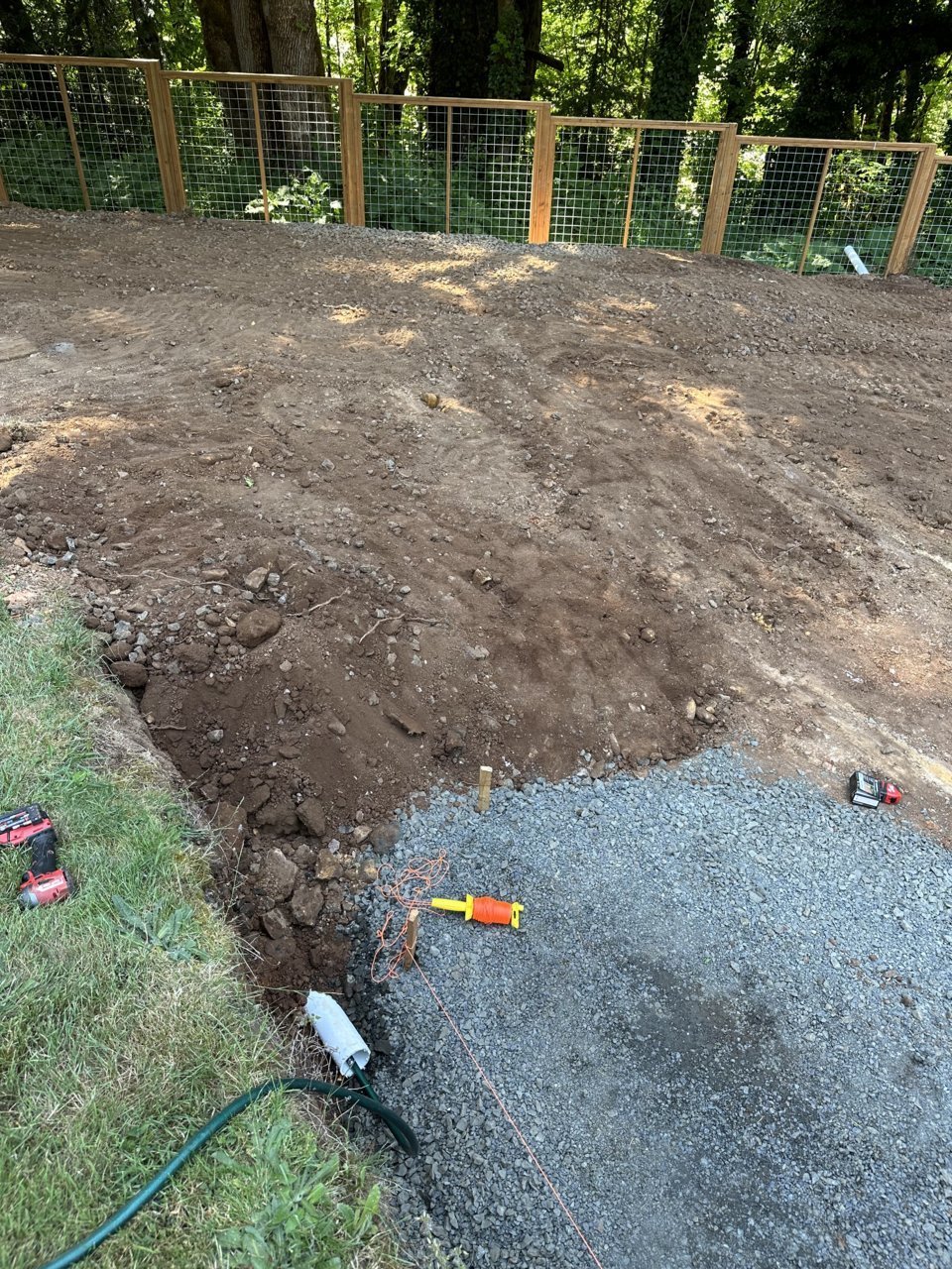

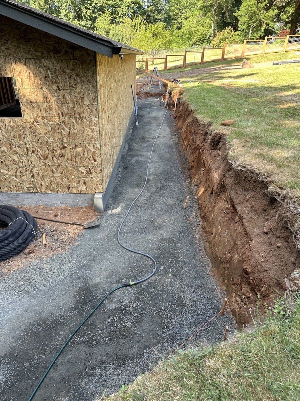

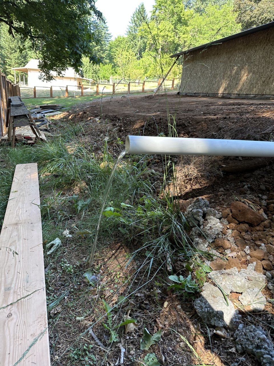

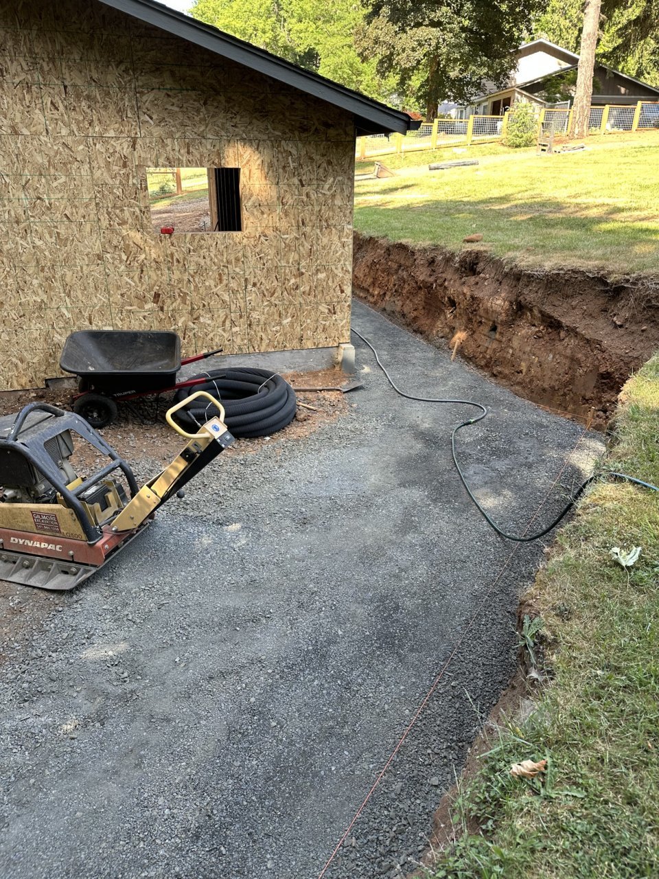

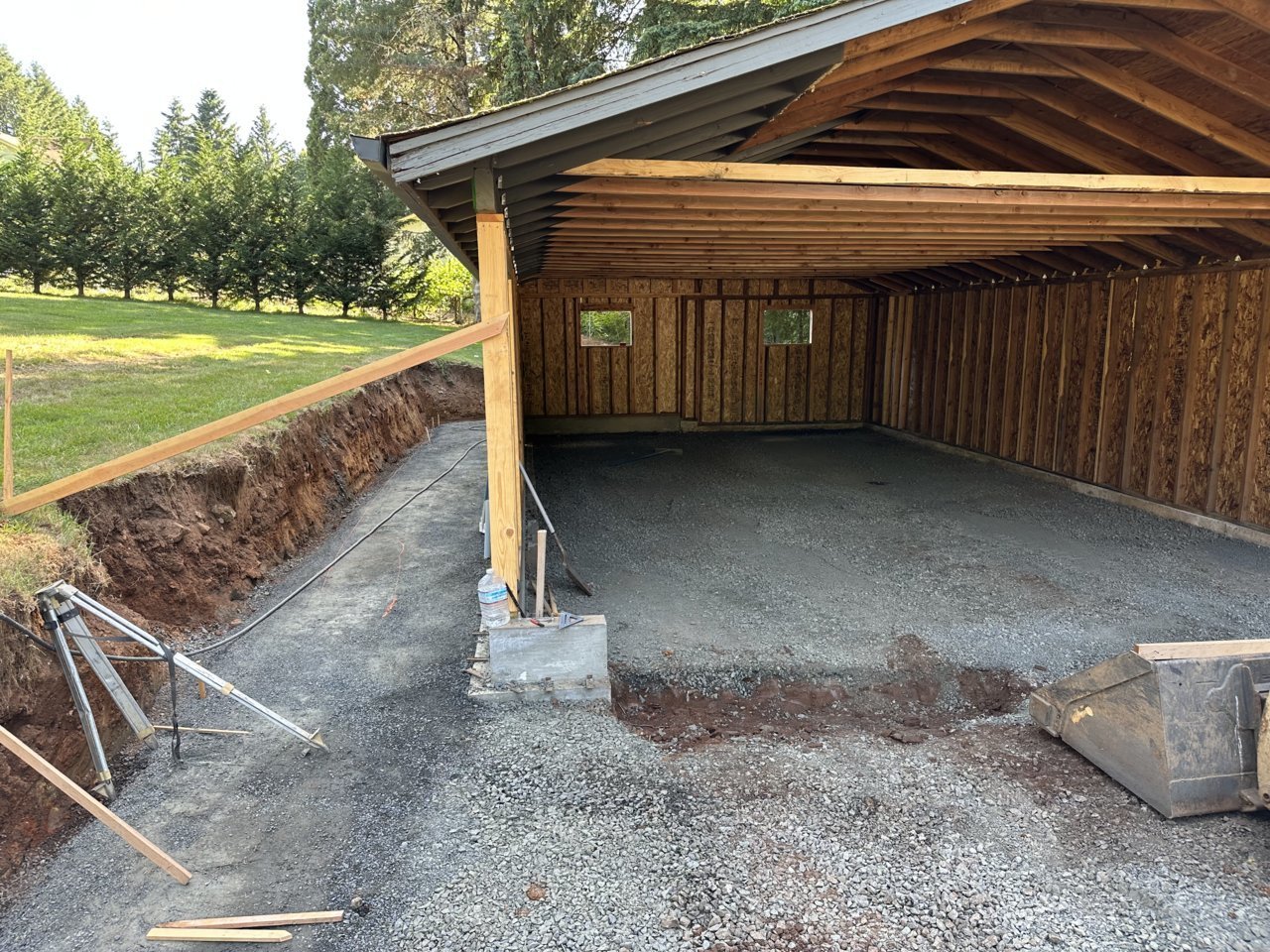

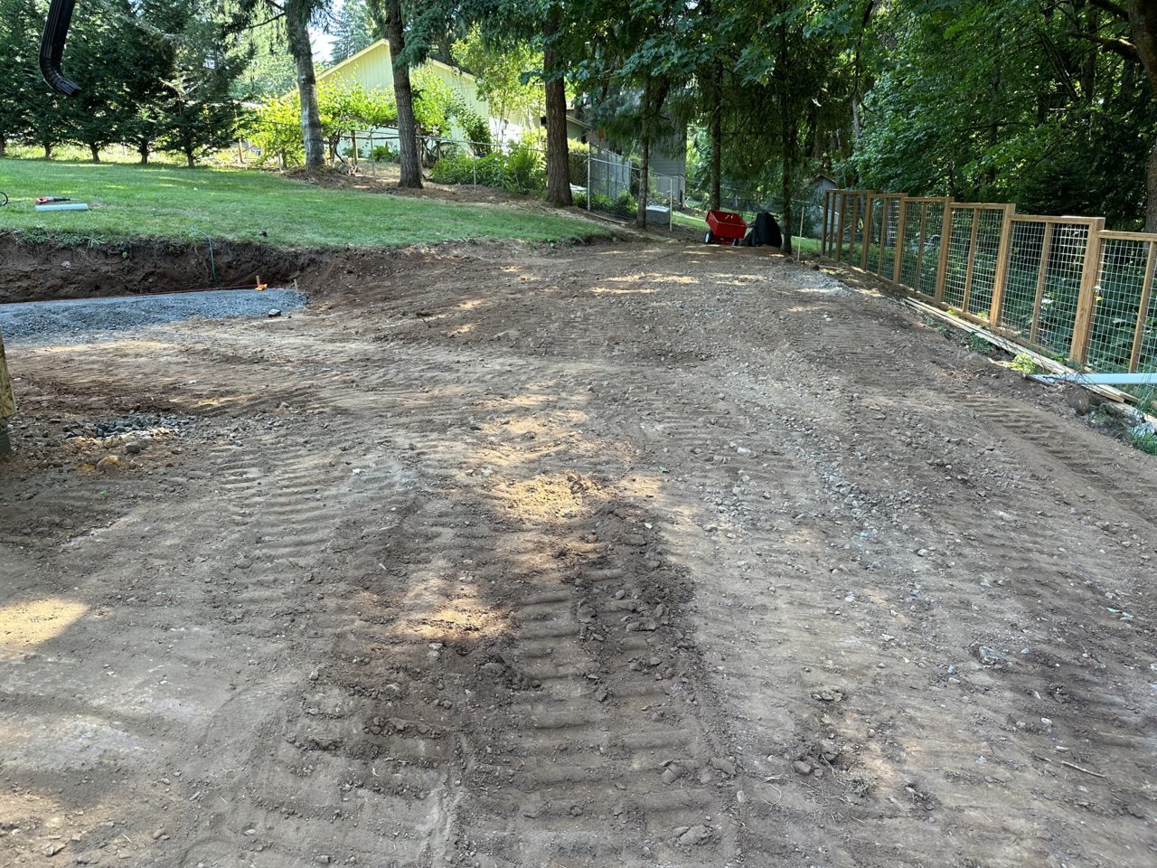

    Concrete day! Had to pump 12 yards of concrete about 200 ft through my fence, but it’s done.
    Super excited. I’m thinking this weekend it’ll be cured enough to start moving some of my smaller tools in. Then next weekend move all the rest and maybe the gym and just hold off on deadlifts and whatnot for a while.
    What’s remaining is cutting more windows, house wrapping and installing windows / man door, strip shingles off (scheduled), and then finish with siding and roofing. Estimating that’s probably as far as I’ll get this year. I just need it weathered in and I’ll run electrical when I get a chance and paint when the weather cycles back to dry next year or so assuming my timeline is right.
    While the concrete cures I’ll be stacking a whole bunch of block. This first course is about 70% done and took 6 hours to level it out. Once this first row is done the rest will fly, but man it’s slow going.

    Can you get gravel screenings? Will level easier than that crush and run it looks like you are using. Looks great, good luck on the build.
