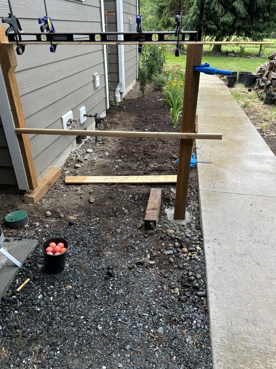

    We could add finer material under the first course kind of sparingly. The strongest wall is built on a super compacted base, so unfortunately I elected to do it the hard way and start at the lowest point in my compacted sub base and then dig-out compacted rock as I get to the higher spots in the sub base. Even though it’s hard as hell to dig it out, doing it this way still leaves my blocks on a very compacted footing vs dusting sand or screenings under a low rock to shim it up. The wall will have a tendency to settle in those spots. That’s just what my engineer said. Either way I doubt my wall will be level enough to care in the end. It’s spot on now, but my patience is running out and I can tell I’m off by an 1/8 here and there over 2-4’ lol. Give me another couple hours doing this garbage and it’ll be off by a lot more.

    Slow and steady wins the race man. Just remember, if you call it "good enough" your the one that will see every imperfection in it for as long as you own the house. lol
    If you want to speed it up go buy 2 10' lenghts of 1/2" black iron. Get some fines while your at it. Set the pipes level. Dig out a little road base where needed. Backfill the pipes with the fines then screed them. Compact the fines with some water and a tamper. Add more fines and screed a second time. Then lay your blocks.
    It's just like painting. It's ALL in the prep.
