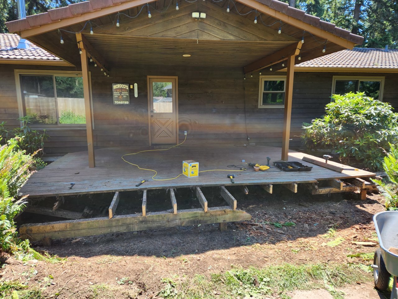

    Holy rot batman! I knew it was bad, but c'mon! PO built this.

    hope those roof support beams look like that from a fisheye effect and are not leaning over that far

    Is that a 4x6?
    Never seen one rot all the way through. Awesome!

    Yeah, optical illusion.

    Doesn't help there has been an oak barrel planter sitting on each corner for idk how long, draining on the beams.

    Does your house foundation under the roofed area there come up to underside of deck joists ? Just curious if you could eliminate the deck structure completely and do an infilled patio
