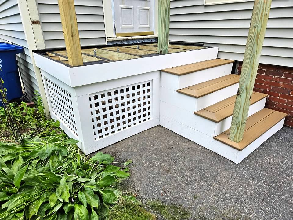

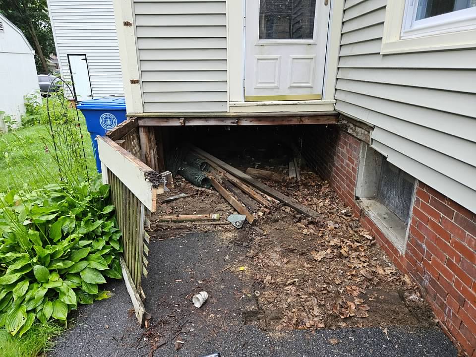

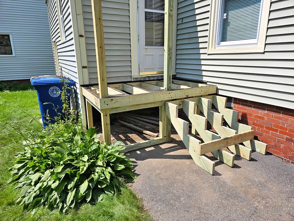

    Been working this week on replacing this 40+ yr old Porch on a 100+ year old house. Was able to peel of the layers to get to a solid 8x8 beam.
    Don't know how the old porch was standing. Only supported by 2 2x4' on the front edge resting on bricks in dirt. Same with stairs. Joists were 2x4 24" on center and posts were just toenailed into the decking. :eek:
    I added 12" so the posts and stairs would land on the asphalt. New one is only 4' x 7'.
    I hate working with synthetic decking products btw. Customer likes shiplap and wanted solid material on side of stairs, so I gave it that look.

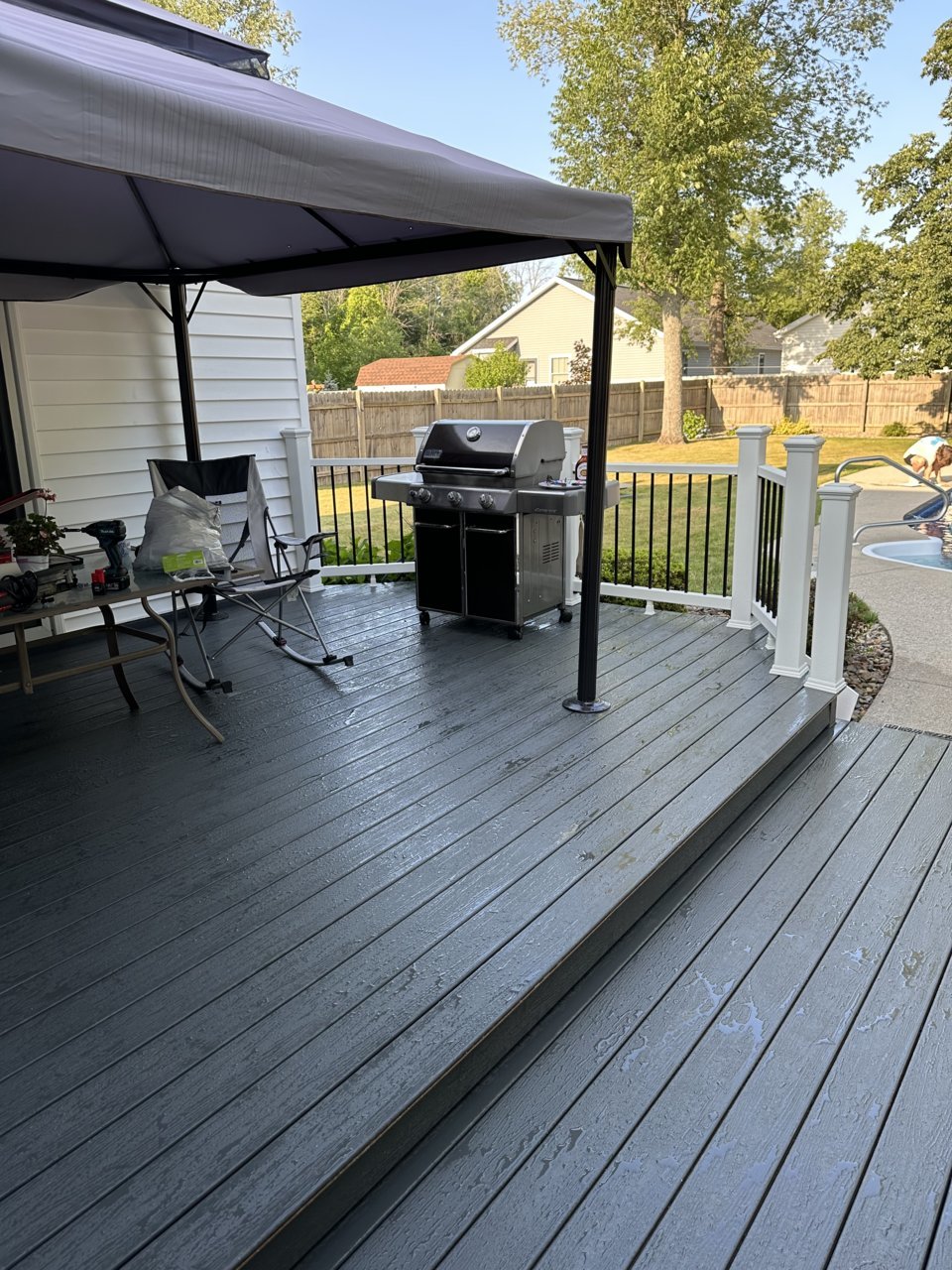

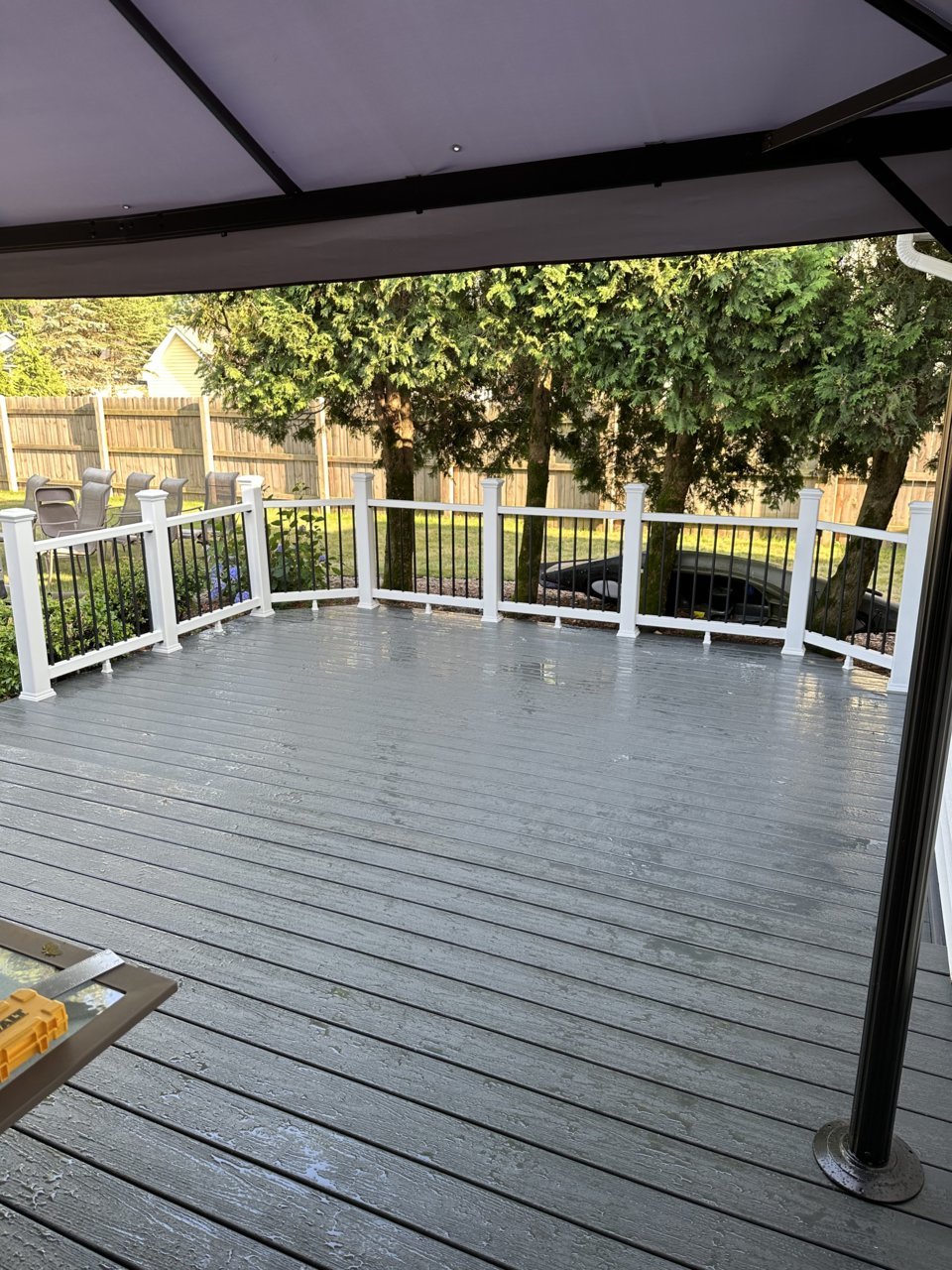

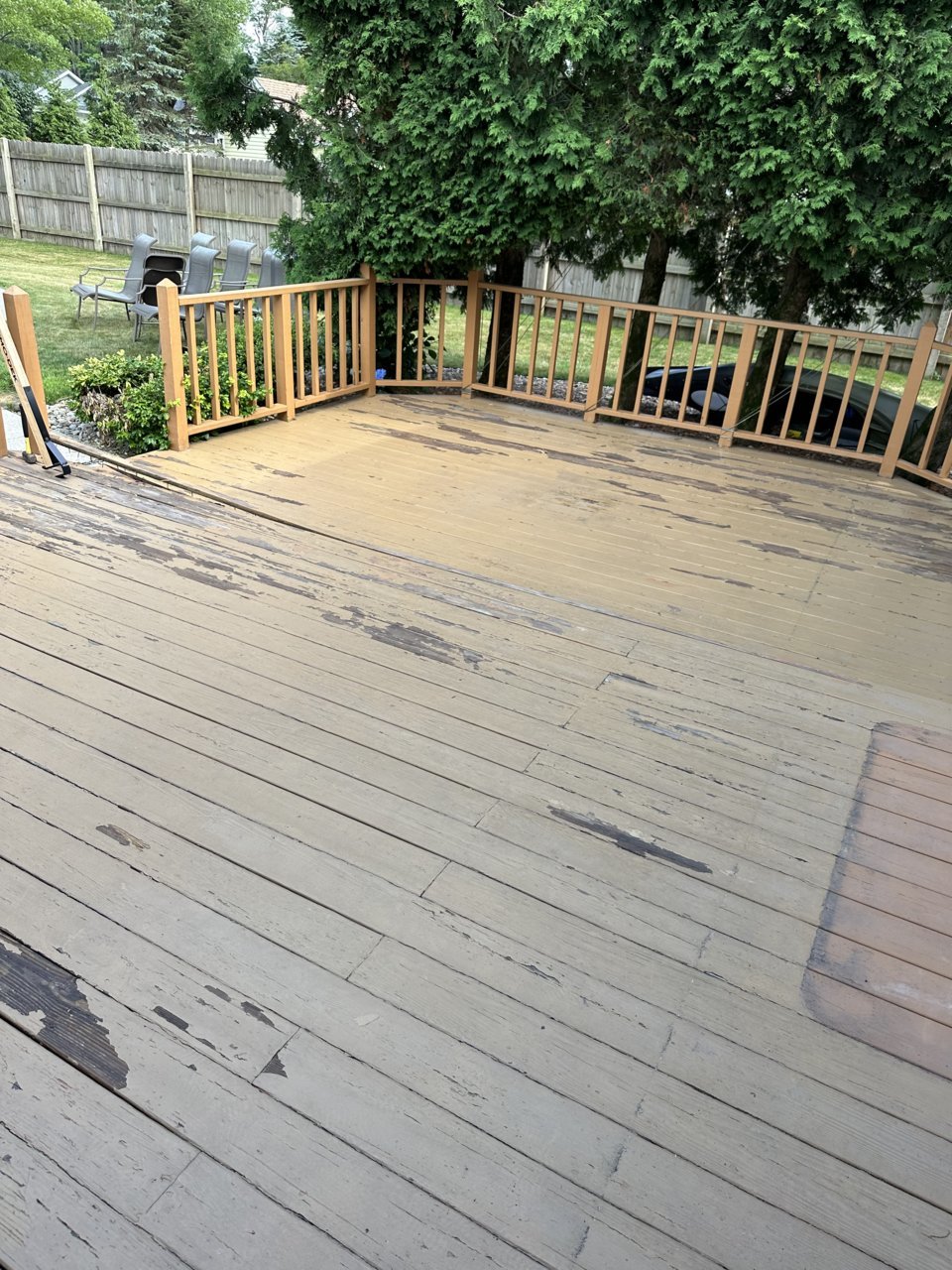

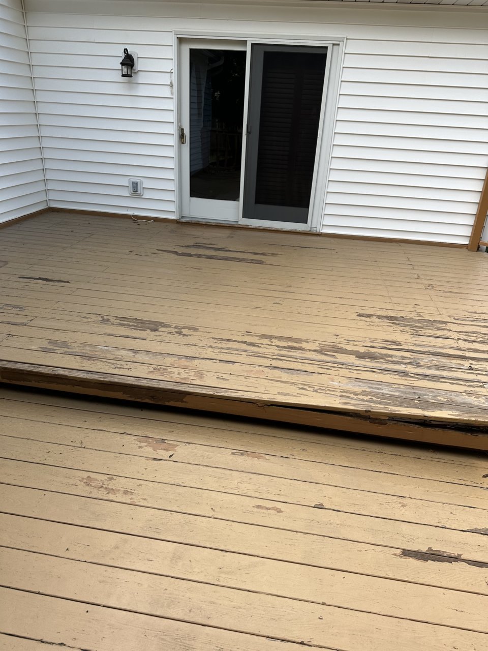

    Just ripped up my deck and redid it. Probably the worst part of the home we bought last year. Didn’t feel like sanding it all down and restaining. They used nails so a lot of them were popping up. Figured with the baby Trex was the way to go. Still gotta do the facia boards

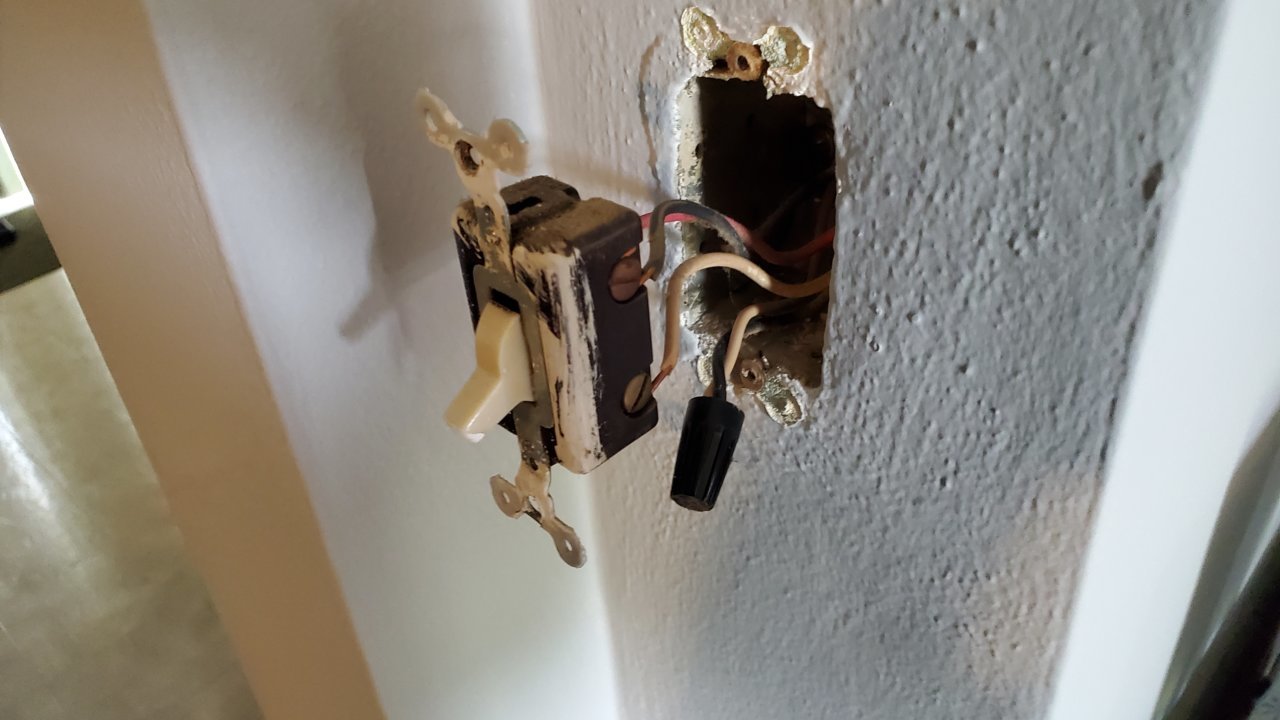

    They sure did some funky stuff wiring 3 way switches back in the day...
    Had 4 to do and somehow figured out the wiring on all first try. Luckily the common screw on the old switches weren't completely worn away. You would think it would be a standard color, but not in 1965. It was the wild west o_O
    Also had an outlet that wasn't properly grounded to the box. Grabbed a pre made pigtail and corrected it. I've come a long way on that kind of stuff. Learned most of my wiring in Mississippi that there was no local codes.

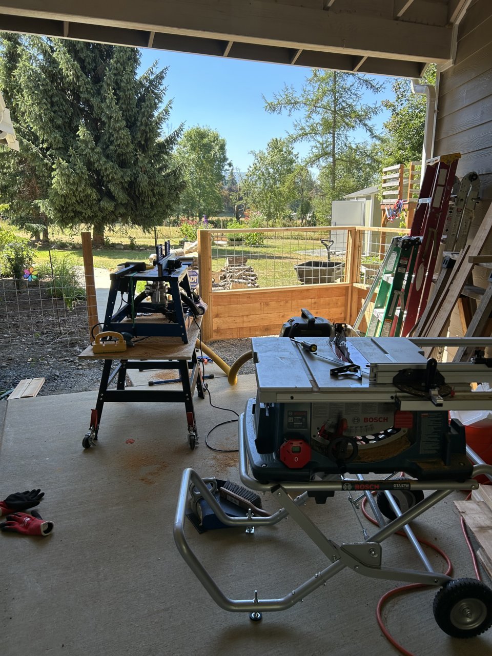

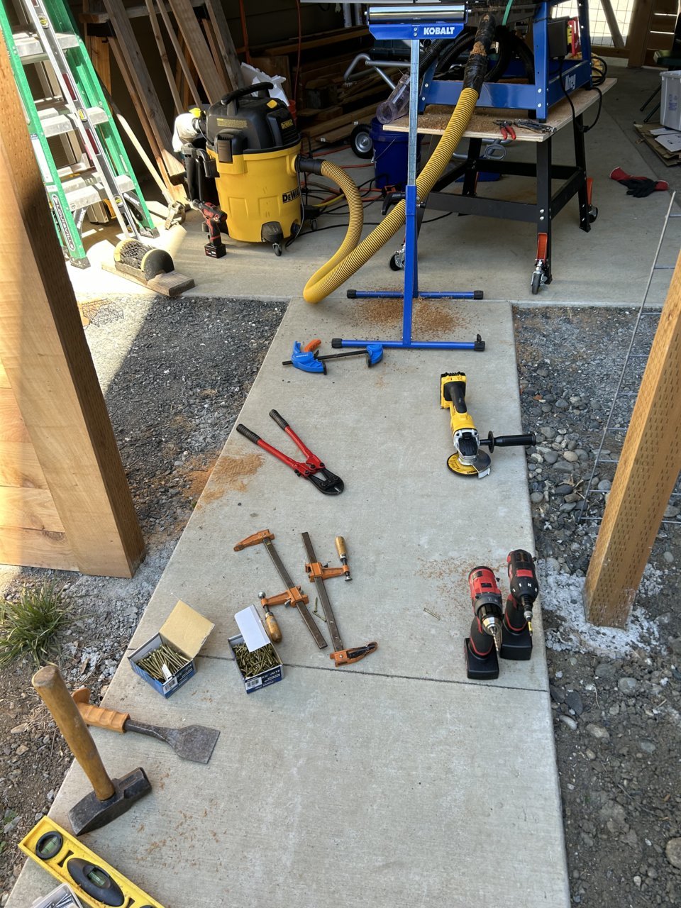

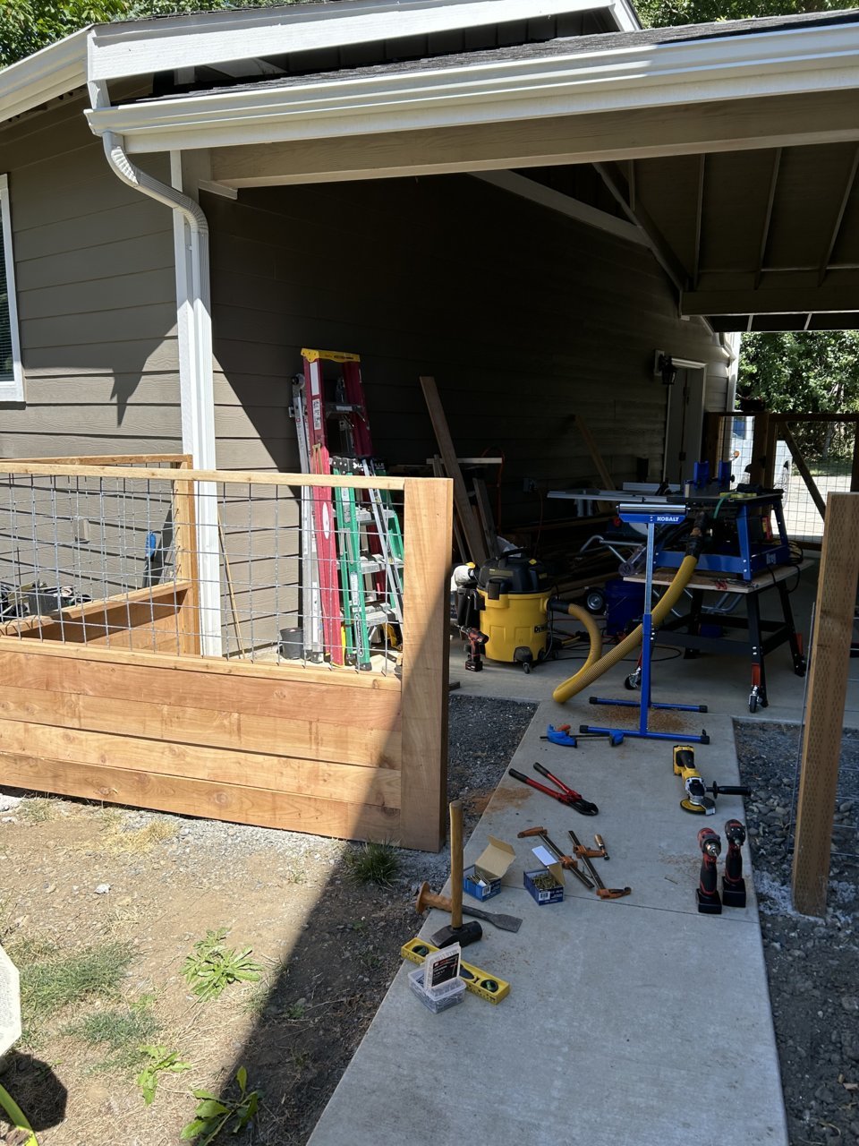

    South breezeway entrance

    Did I mention I facking hate cutting hog wire fence with the bolt cutter? It can't be good for the wrists. Then oops 1/4" too long. Screw that, angle grinder worked great!

    :thumbsup: Angle grinder (Battery powered is preferable) with a cut off wheel is how we do it for production speed on large slabs.

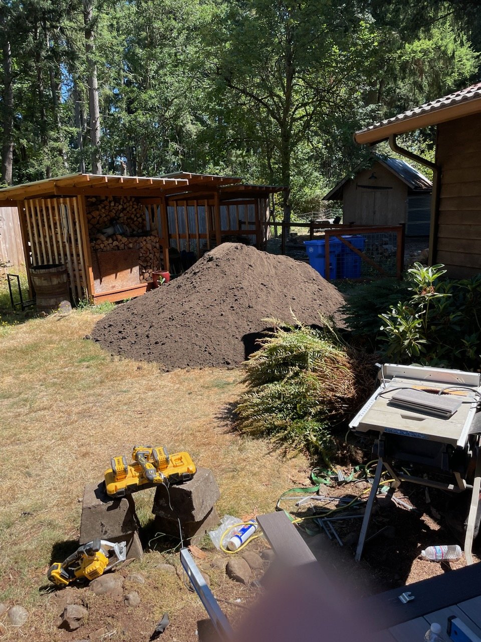

    Dirt goodness!

    code requires 6" minimum BEYOND the box. many guys somehow seem to interpret that as the maximum from where it enters the box...
    also, that old outlet that you posted-- you really should change that so that the wires splice to the other wires, and then use a small jumper to go to the outlet from the splice.
    it should look more like this.
    the reason for this is if you connect only to the screws, you're entirely relying on that little tab above the screws to support the load of whatever gets plugged in downstream of that outlet, but also because the screws are not as solidly connected as wire nutted splices, and relying on each consecutive set of screws creates more failure modes in the circuit, which can more easily create fires.
    i can't know all the details of that specific installation, but with romex, that picture can be(mostly) code-acceptable. there's an exception in older code that allows one to run a white as a current carrying conductor/switch leg, as long as it's re-identified as a hot wire(usually scratched over with a black sharpie). this is where that installation would fail inspection-- they didn't identify the change, but to be fair, most electricians and inspectors really don't seem to care.
    newer code does require a neutral to be 'accessible' in every box-- many houses built well into the 90's aren't compliant.

    Last house I owned (not lived in) had knob and tube. Wire in the box was super short, this house seems to be a luxury. I'll keep the pigtail thing in mind. That particular outlet doesn't ever really get used and the other leg of the wire goes to a light that is LED, so not much draw.
