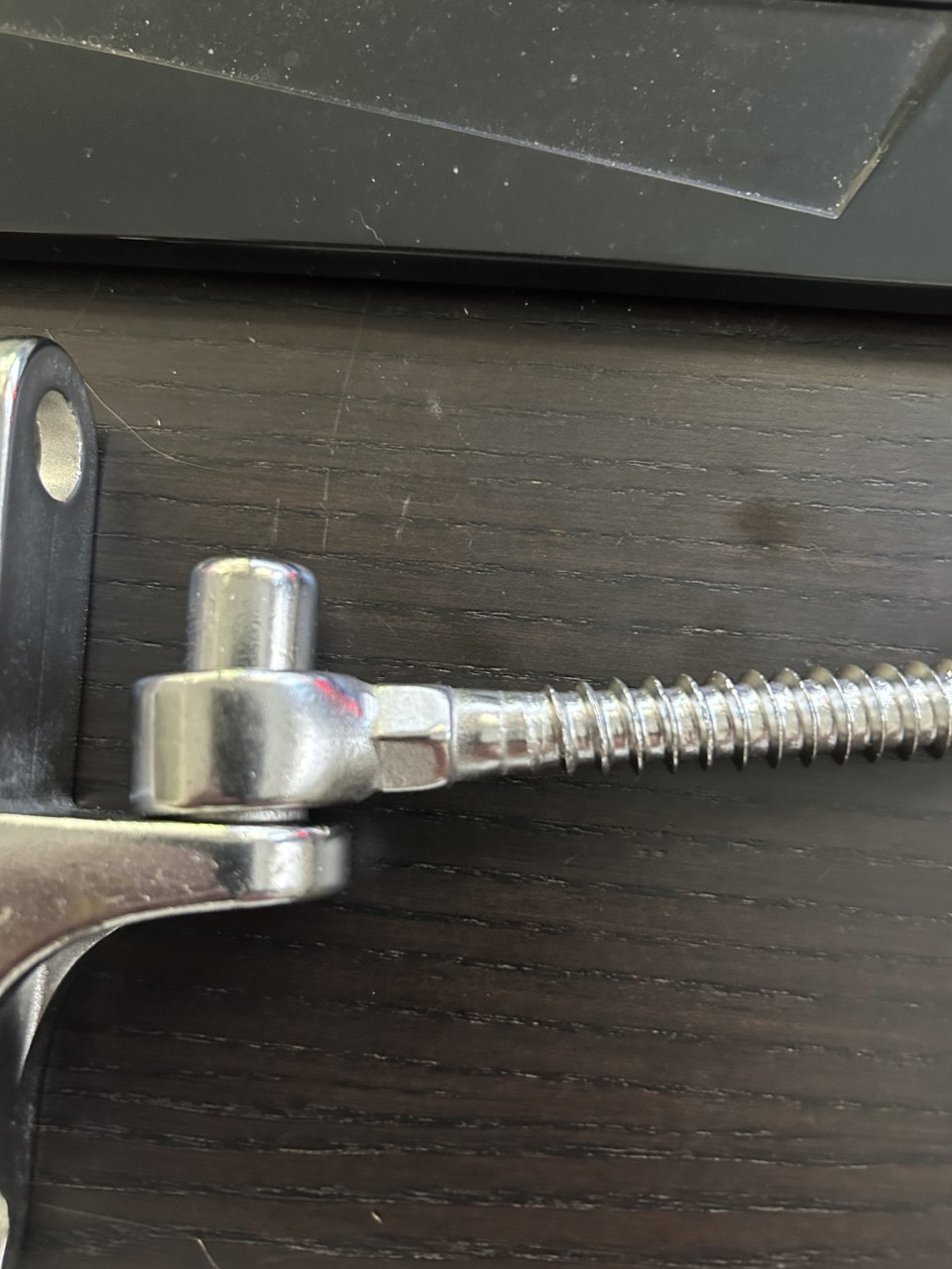

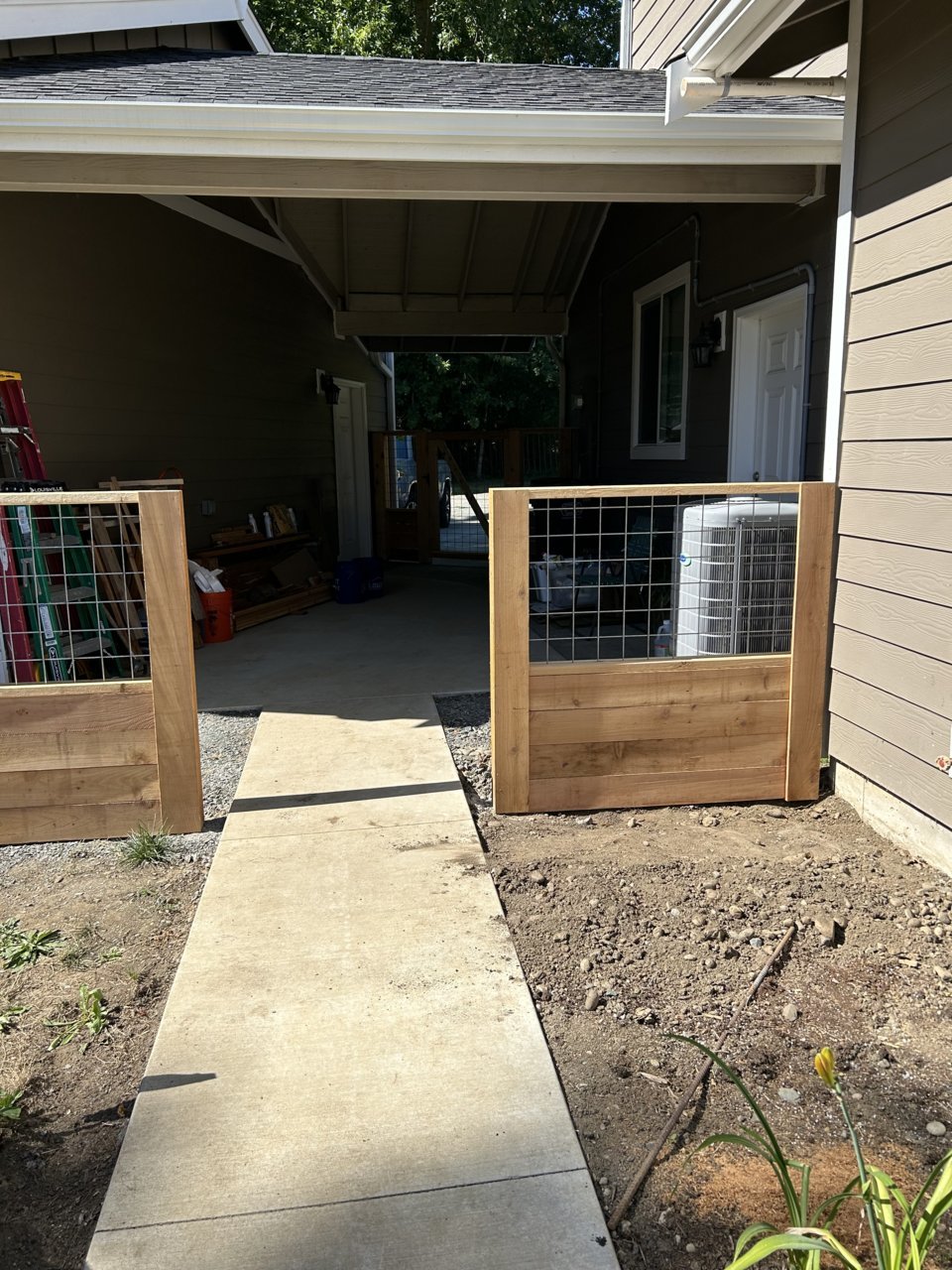

    Built a little decorative fence. Designing a lightweight 180° gate (swings both ways, nudge nudge)
    Picked out these simple stainless hinges: https://www.amazon.com/dp/B0C2Z5MBXH?ref=ppx_yo2ov_dt_b_product_details
    They arrived today (yes Sunday, that urgent. Not) Anyway, I thought (duh) the pins would be a hair more snug. They are not. Quite a bit of wobble, as in built in sag (ugg). Other than bushing the pin (if I could) any ideas? I was thinking a washer under the post mounting plate lower hole to angle them up a bit.
    Thoughts? Maybe you see how much looseness in these still shots

    Tapered plastic shim stock? (I know Amazon has them)

    Wait.
    Damn good idea. Neither really has much taper. I could just wrap some stainless or plastic shim stock. Does not need to be tapered.

    Have you considered the depth of the lag as your gate adjustment? Half turn out on bottom makes the gate swing level without slop… etc?

    My thought was the tapered shim under the pin mount, wider at the bottom to angle the pin

    No I hadn’t. Another good idea!

    Ok yes I had thought of grinding a large warsher in a taper profile

    Ima do both as I have stainless shim stock. You guys rock thanks

    ECGS doesn't make a bushing for this?
    How about shave it down and do ball bearings?

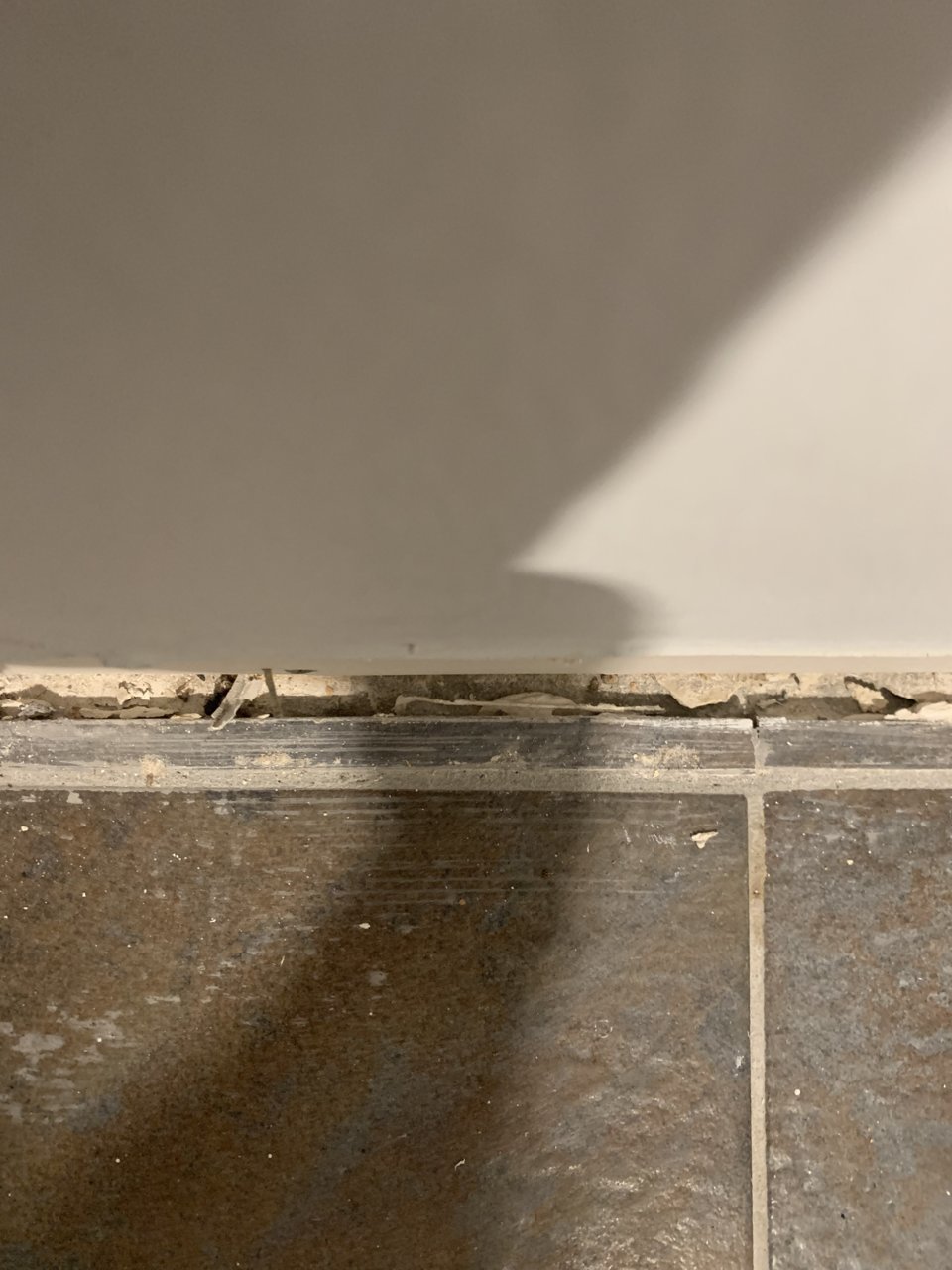

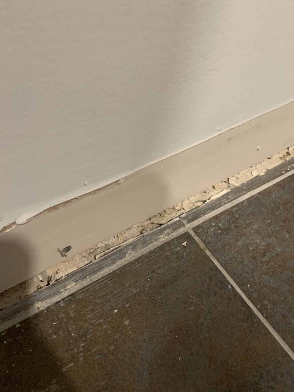

    Started my mudroom built-ins project this weekend. I pulled off the baseboards in order to paint and be able to install cabinets/cubbies flush to the wall.
    Not sure if this is normal, but it appears that when the tile floor was installed, the baseboards were in first, the ran tile to the baseboard, then covered the edge with a piece of quarter round.
    In areas where I don't have cabinets or cubbies, I guess I'll put baseboard back the same way in that gap with a quarter round on the floor, but what should I do behind the cabinets? Just leave it, or try to fill that gap somehow? I wasn't planning to run backpanels on the cabinets or cubbies, but maybe thats the best solution?

    It seems to be the new normal level for the acceptable level of craftsmanship now a days.
