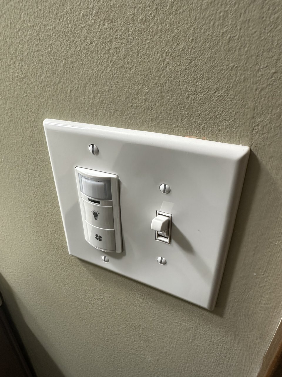

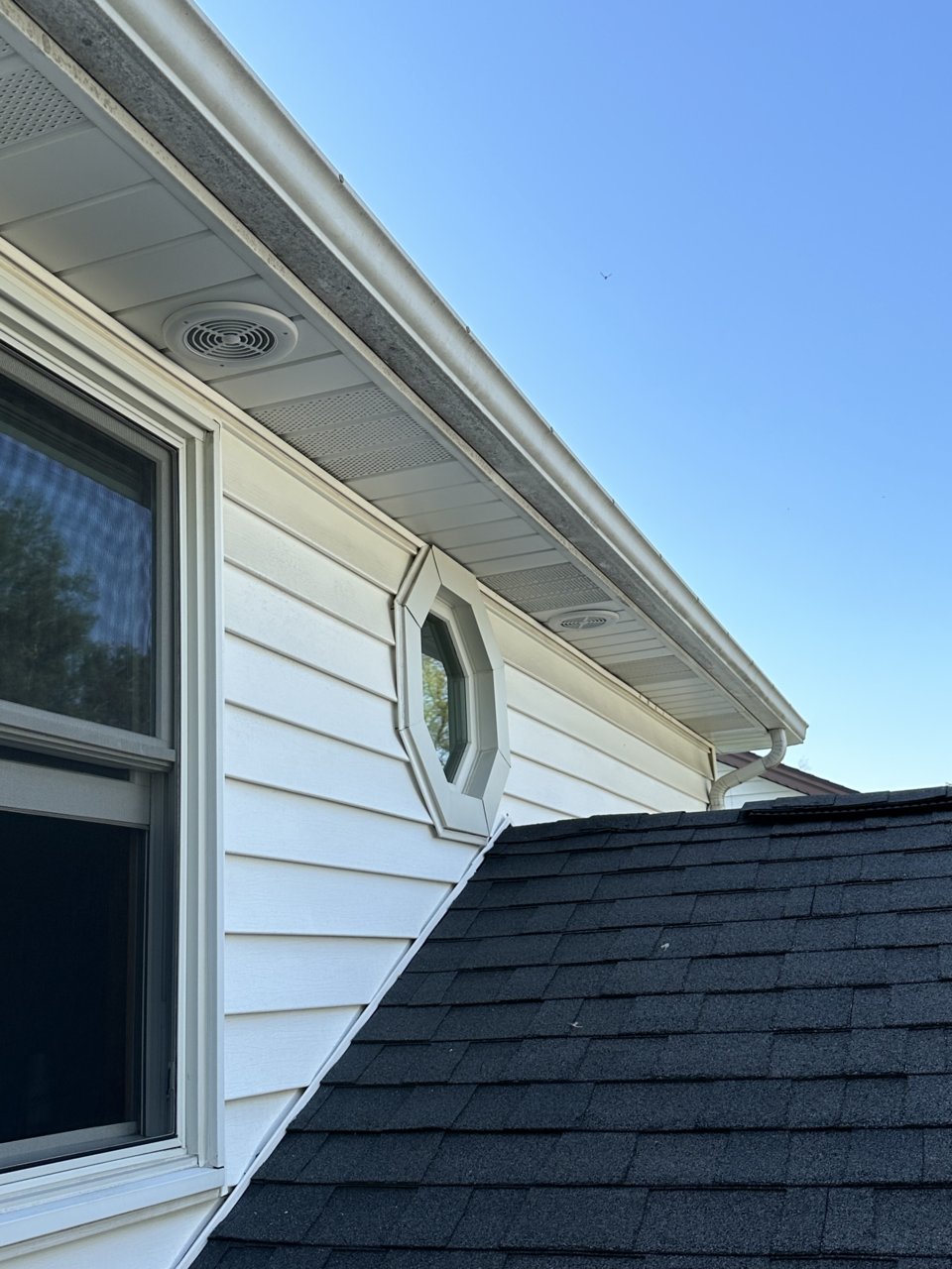

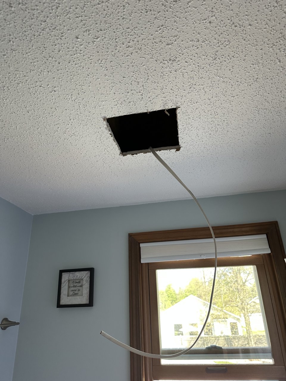

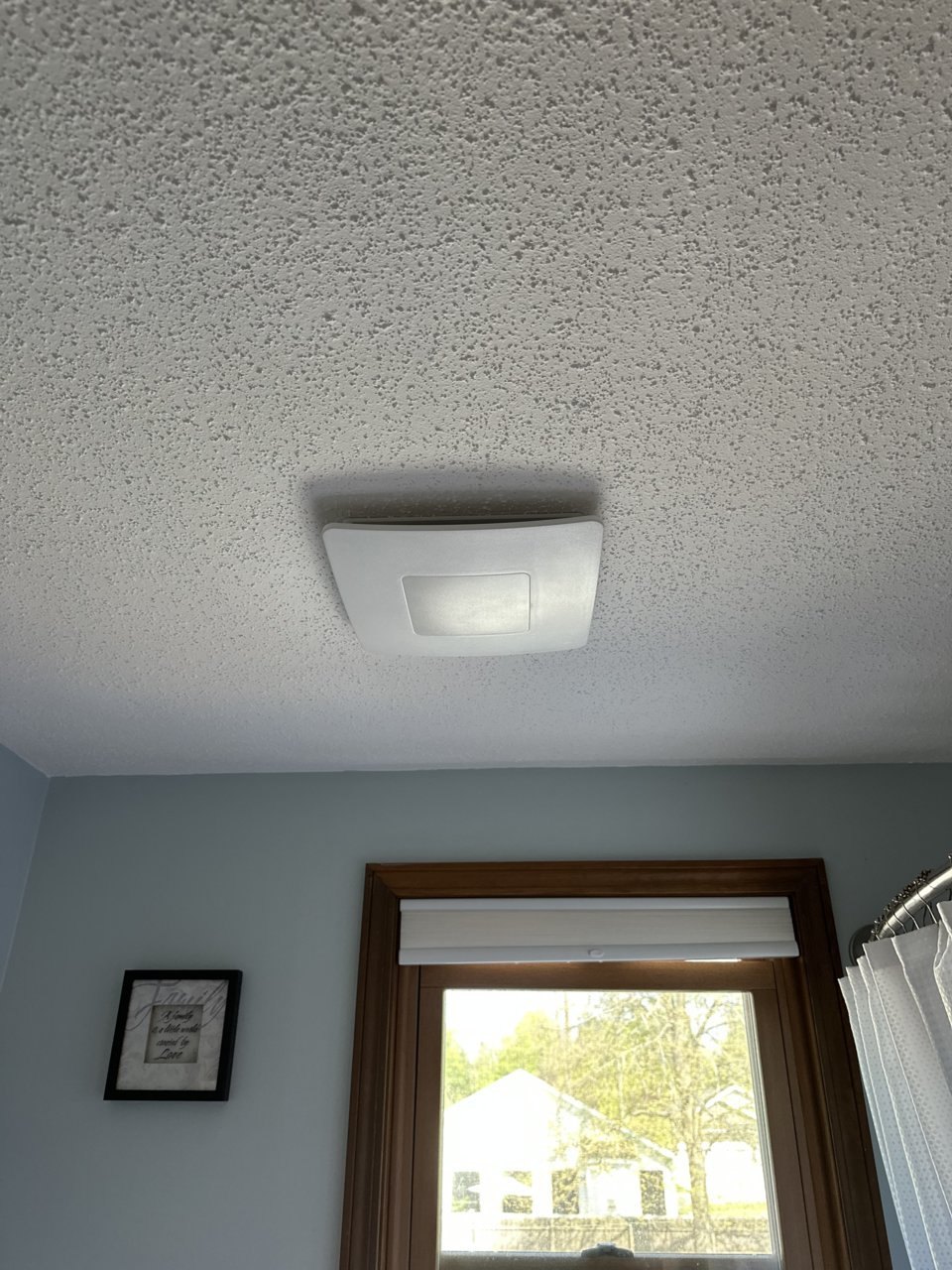

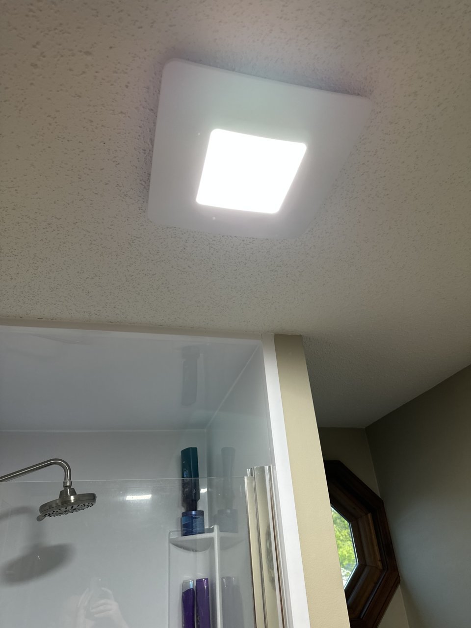

    My bathrooms didn’t have any exhaust fans. So a couple of months before it got too hot decided change that. Had to run all the wiring and ducts, and was doing it by myself. So spent some time up there doing it. Was soaked as well. Was like 81° when I installed these. Luckily in the north east we don’t get the temps they do in other parts of the country. Couldn’t imagine living in Arizona or something

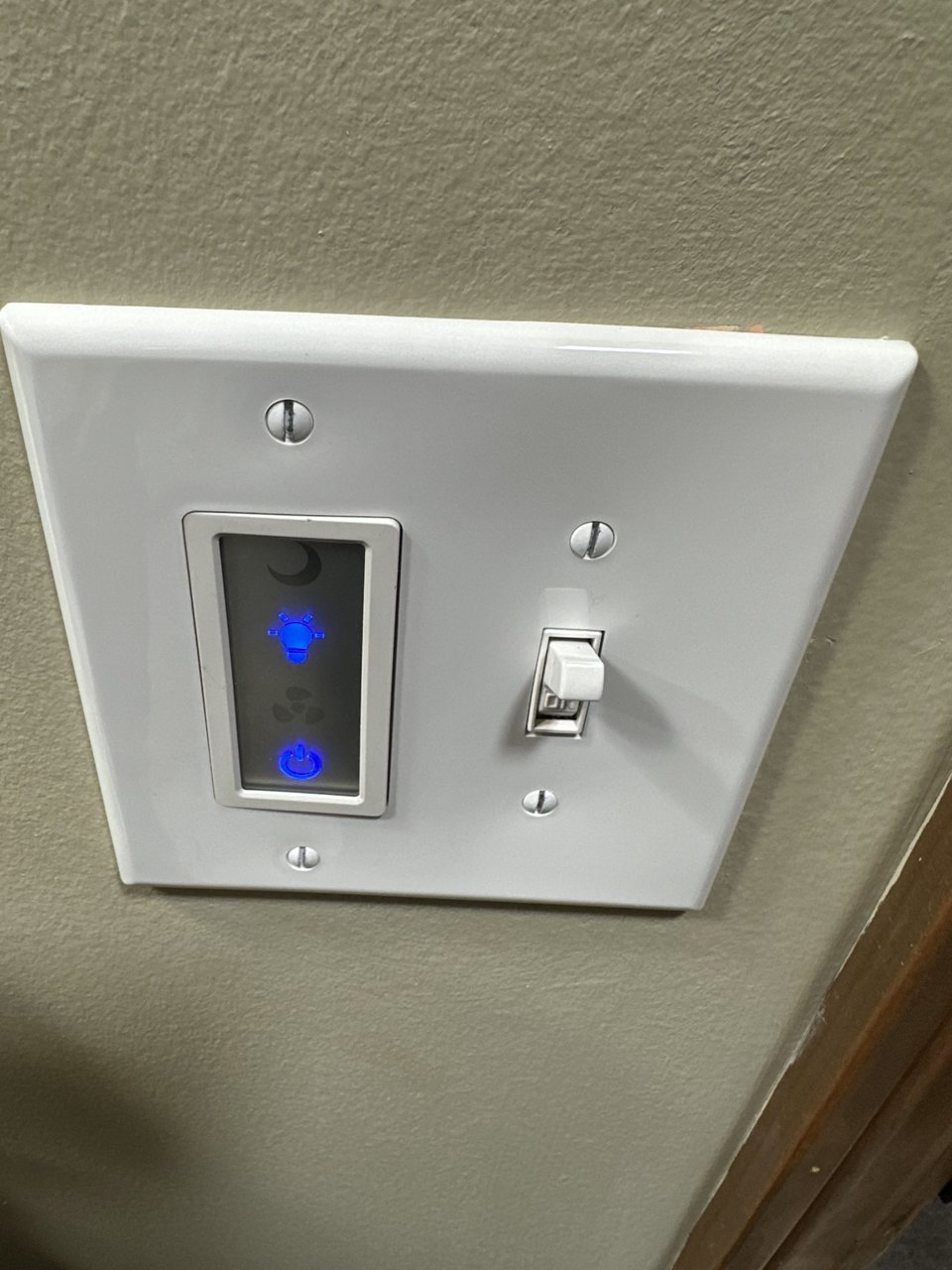

    Originally bought these touch switches but didn’t like them. Replace them with the humidity sensor switches. Like these a lot better.

    Looks nice! Also :101010: for the cover screws!

    I’m an electrician so that’s one thing I should do right :rofl:
    smart move on the 14/3. Better to have and not need, than need and not have.
    Thought that first switch had a dimmable night light output, however it was just a separate output for like a separate night light bulb. Hated how you had to turn the power button on first before it would let you operate the fan or light too.
