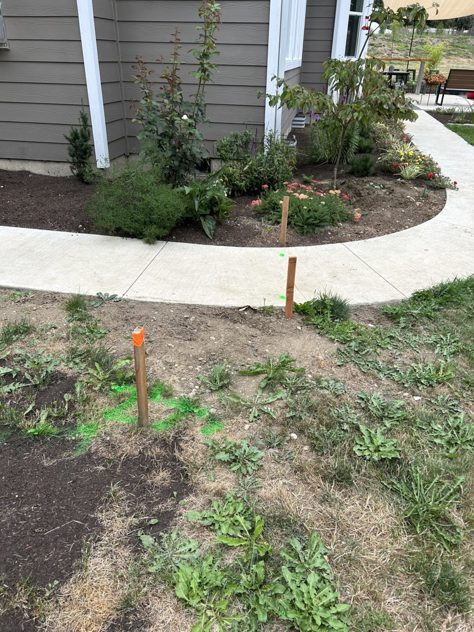

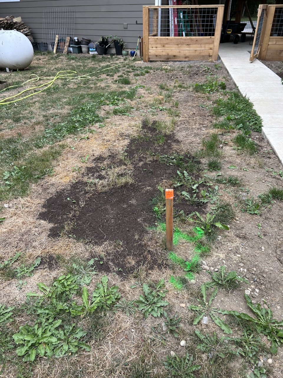

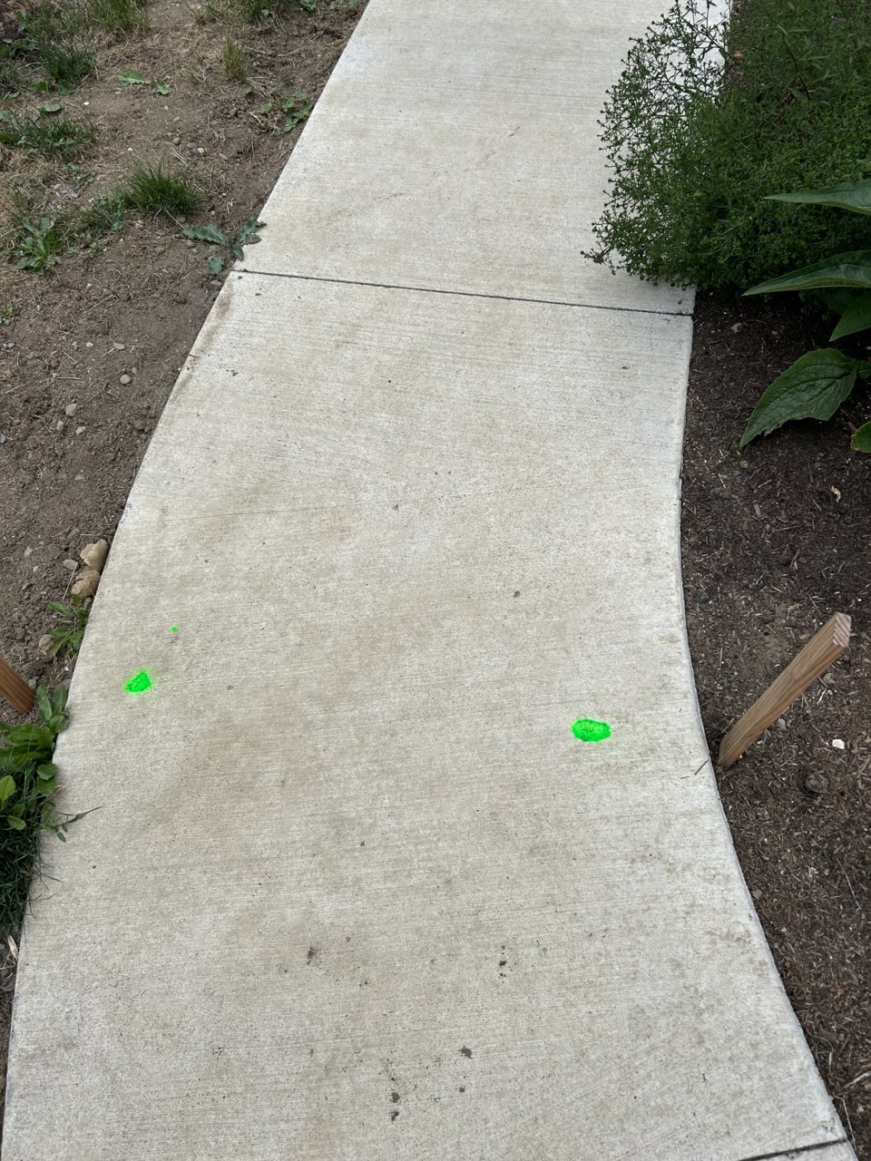

    Yesterday I paid $649.43 total to have my downspout pipes FROM the house and the shop video inspected and located. There are a couple breaks, one is 3'7" down right under a sidewalk (poured in 2021) and the other is perpendicular to that from the shop around 5 feet away from the first mentioned break, supposedly 2'6" down (which may or may not compute as they are both down slope)

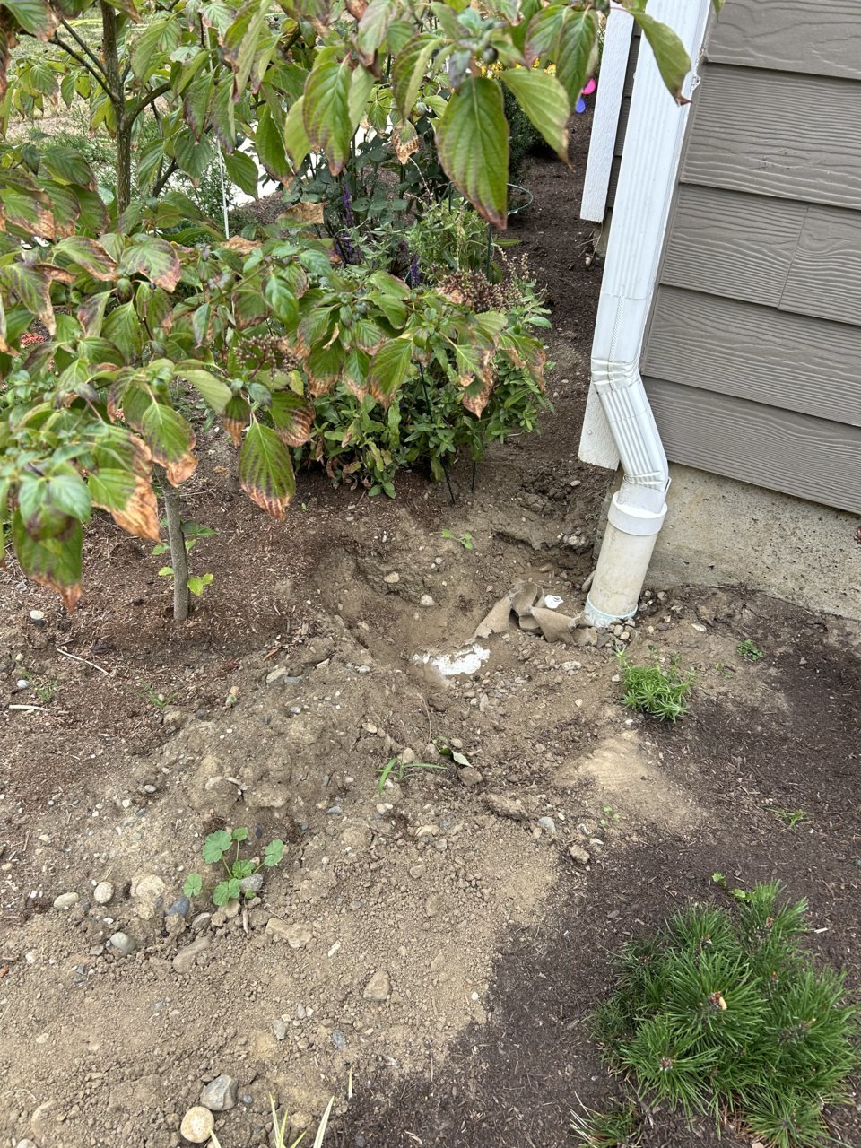

    The beef is the water backs up at footing at the corner of my house. I have tried routing it out with my pressure washer and special hose but no luck.
    So the result of all this I have contacted an excavating company. Gonna be the big dig.

    Curious if, now that you know the location, you can re-route? Just chop that stuff out of the loop and find a different path downhill/downstream which bypasses that mess? Or you have to cross the sidewalk at some point and hence you're f'd no matter what?

    I have to cross under the sidewalk indeed.
    I have zero true idea where on my property the drain pipe terminates. I am willing to bet there is no designed drain as these things tend toward the 1/2 assed. I can reconnect to a good part of 4" PVC then run it out.....and maybe make a nice rock drain down hill. That could perc to it's max and if it blows out the top of that drain? No worries.

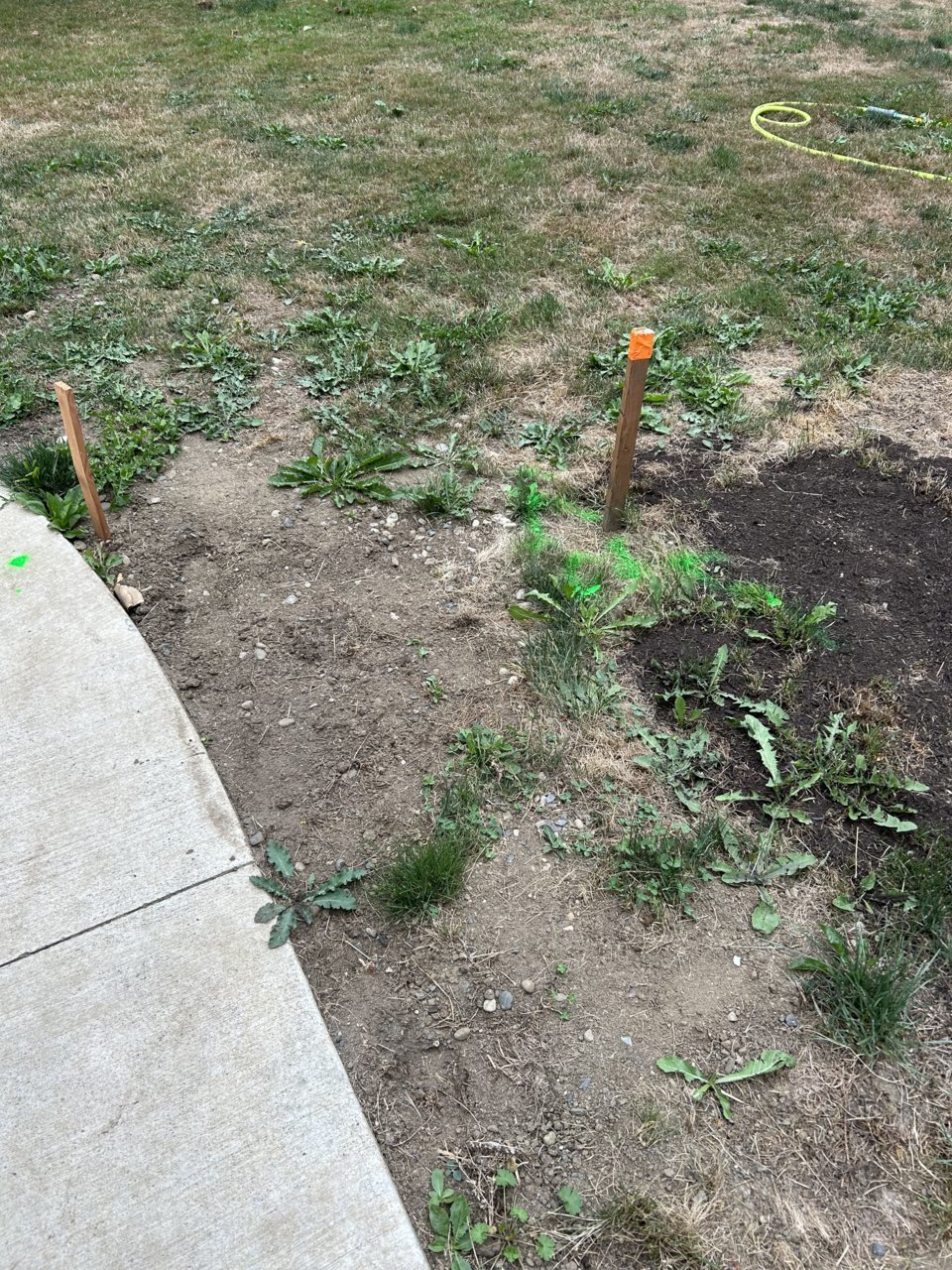

    Some idea of the layout IMG_5425.jpgIMG_5426.jpgIMG_5427.jpgIMG_5430.jpgIMG_5428.jpg

    Major block/break to drain pipe is under right green dot in bottom picture. 3 1/2 feet down. My pressure washer blasts by it but drain still doesn't run.
    Top picture is where the pipe runs meet, more or less. One from shop by the gate in other pic and one from under sidewalk.
