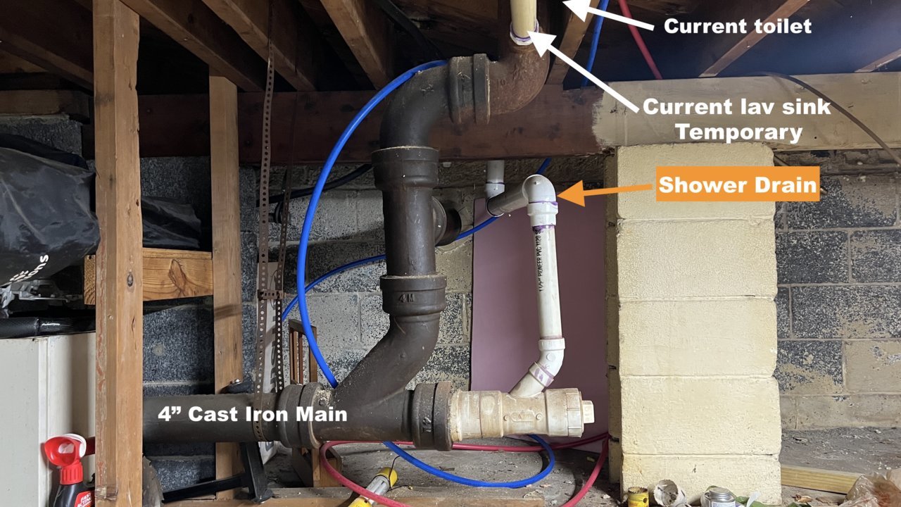

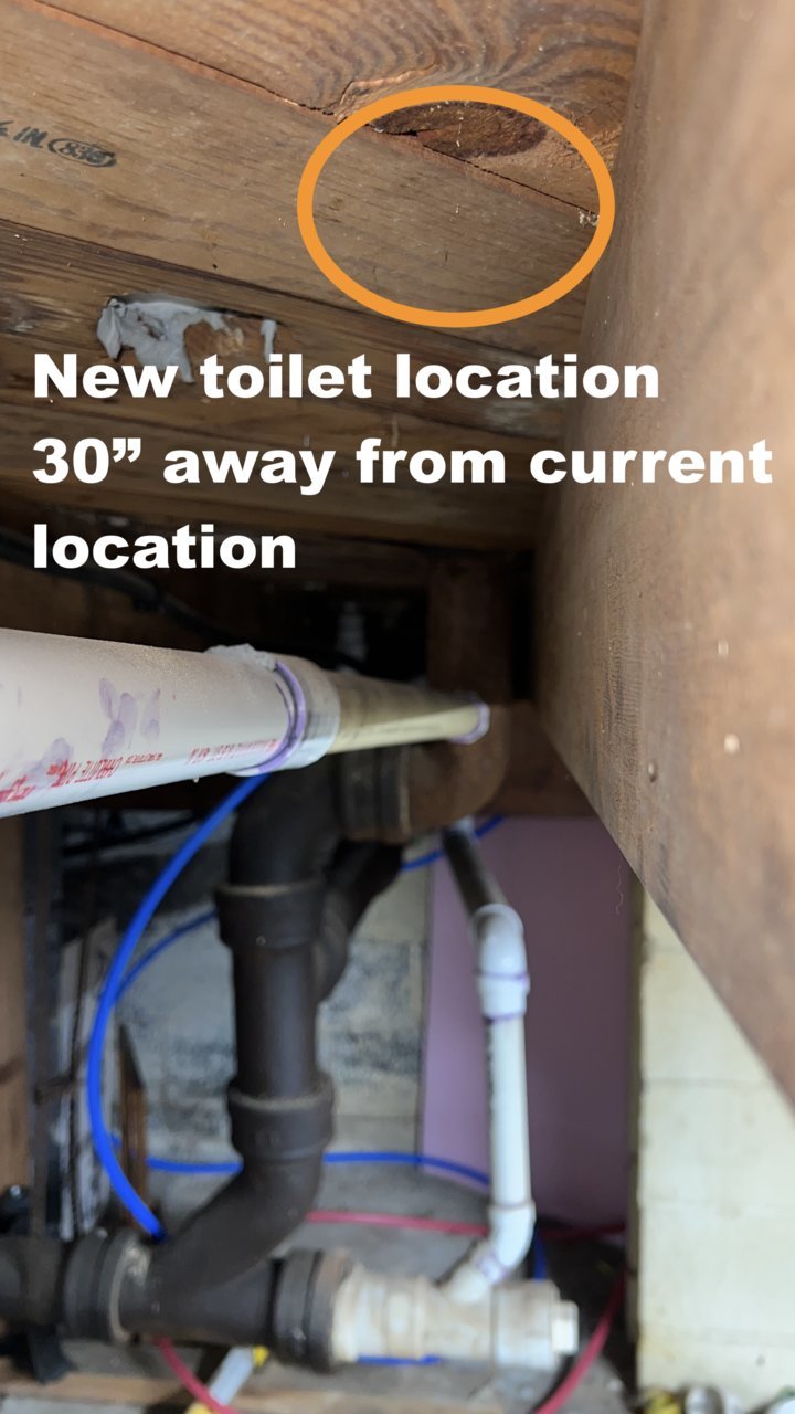

    So the Lav drain is temporary and the cast iron is 80 years old. Do I need a special adaptor to go from cast to PVC. If I need to cut out the old cast iron to the main straight run I don't mind there's not a lot of connections. May be easier I was thinking. I. just need to connect the toilet, lav drain and shower drain.

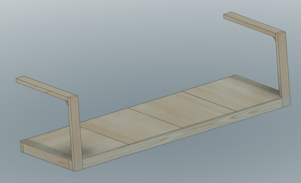

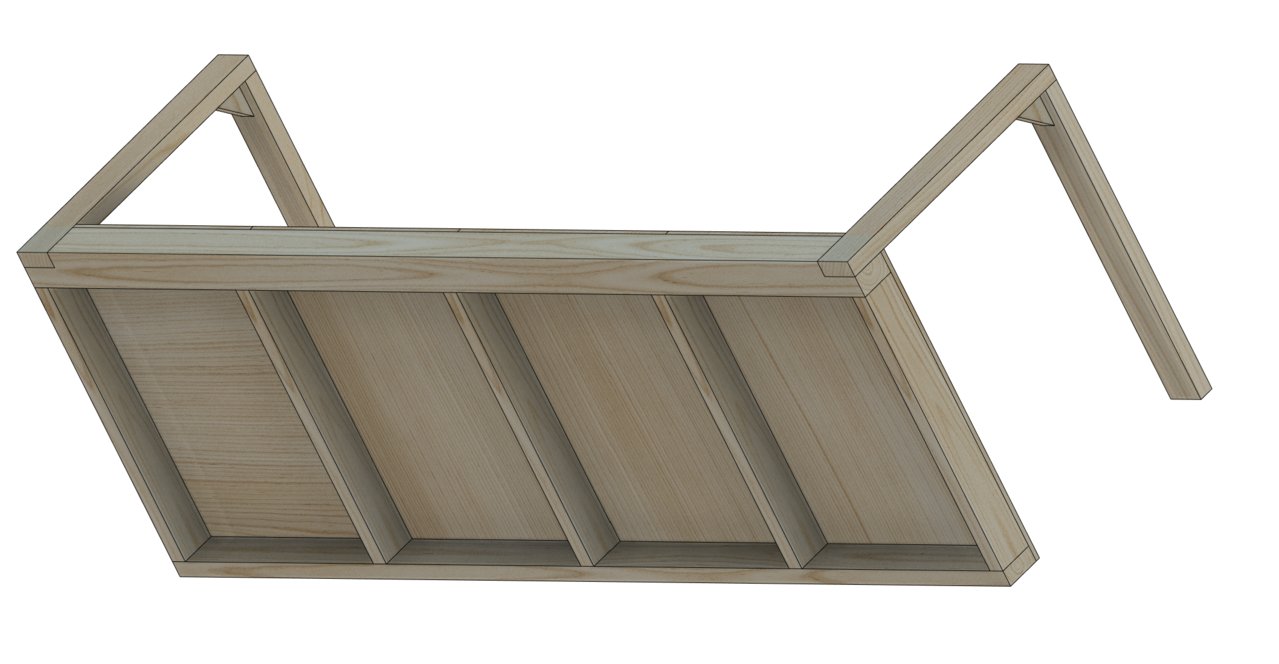

    I thought about this for a while last night and decided that I didn't want to crawl through the attic. It would be nice to not have the top brace but it's a garage so it doesn't really matter that much. I changed your idea slightly and this is what I came up with. It's 8 feet long, 32" deep. It uses 2/3 sheet of plywood for the top so it's best to make multiples of 3. I think I'm doing 5 of them but I'm not certain yet. Also the vertical supports will likely not be exactly at the ends since they need to line up with the boards in the attic.
    With current lumber prices where I live, it's roughly $50/shelf or $120 for 3 since 2 pieces of plywood will cover 3 shelfs.
    1x 4x4
    4x 2x4
    1x 7/16 plywood (or thicker if you want)
    box of screws/nails
    cut 2x4: 5@27", 2@ 27.5", 2@30.5"
    cut plywood: 4@ 32"x24"
    use scrap 2x4 for 45deg corner braces on the top
    I haven't decided if I want to buy longer screws to put through the front into the 2x4 braces or if I want to use more 45deg braces from the scrap.

    What are you planning to store up there?
    I think the outside rail could be a 2x4 instead of a 4x4. My shelves use 2x4s, and haven't sagged in 20 years. Looking at your design, I have the equivalent of 1 more vertical support than you do.

    Pablo8
    Pablo8 Here!
    Aug 7, 2019
    #301483
    9,857
    Paul
    Everson WA
    2019 Cement Sport 4X4 MT AC
    OVT, 4.88, ADM, F&R ARB lock, KO2's, RWD L MOD
    Regardless that will be your weak point(s). Into the end grain.
    Not sure which way the joists run but I would screw in a sleeper across the joists and attach to that.
    None of this should be for real heavy stuff.

    Cut that mess out and use a no hub coupling to the cast iron to transition to SCH40 PVC.

    It depends on where you plan on going from PVC to the iron.
    If you adapt at a joint, you use one of these...
    Warning: when you pull the packing out of the joint, it will be full of lead.
    If you cut the cast iron you can use a fernco like this...
    shakerhood, Drainbung and Delta09 like this.

    Alot of jurisdictions those regular Fernco's are no longer allowed. No-hubs are the only acceptable choice.
    Have I used tons of the regular Fernco's without any trouble? Yup. Are there several cobbling the copper to PVC repairs in my old house? Yup :laugh: I still like the no-hubs better. You can roll the rubber on itself to make a repair easier.

    Just before the first joint at the left where it leads out of the house. Also the vent stack is there can I use the same rubber coupler on the vent stack connection?

    Yes.

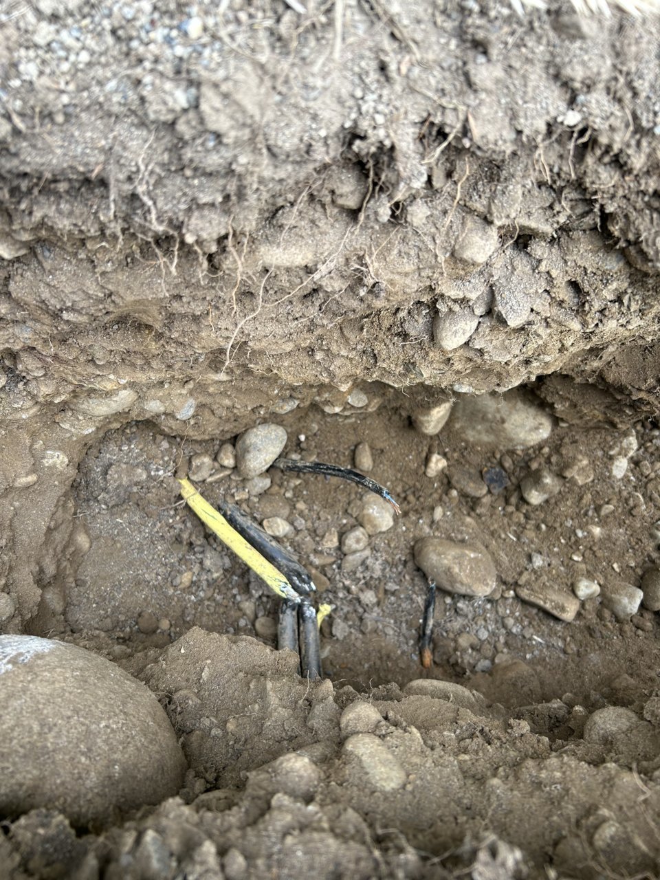

    Some ancient farmstead work. Nothing was live.

    No just some old old illegal work on our land from who knows how long ago. 3 wire power (240V I assume) about 14" down. Wow.
    I was worried at first the other was cable!Just an old school multiwire phone - you can see blue insulation and the copper on one
    No no, ditch witch guy would have been more excited! He did ask is power was out. Nope all good.

    soggyBottom
    soggyBottom Well-Known Member
    Sep 19, 2018
    #266818
    1,997
    I calculated the load capacity at L/360 for the deflection. Note that this is for a single beam with the load uniformly distributed. By adding the 2nd beam that is fixed to the wall, I think this doubles the load capacity but I'm not 100% sure on that. This is also assuming the load is evenly distributed on the x and y axis.
    Here are the values for a single beam
    2x4, 4' span: 186lbs (0.13" deflection)
    2x4, 8' span: 23lbs (0.27" deflection)
    4x4, 4' span: 434lbs (0.13" deflection)
    4x4, 8' span: 54lbs (0.27" deflection)
