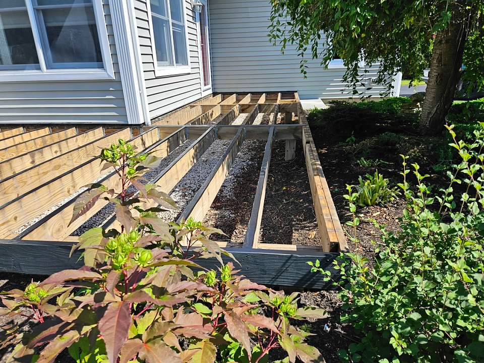

    Day 2 on this deck improvement job. Initial job/request was to simply replace the decking on both the lower and upper deck with PT. After day 1 of decking demo yesterday, they asked if I could also replace the posts & railings. Current posts were 8' apart, too far for 4x4. I'll space new ones 5-6' apart. I shuffled some things around to free up 3 extra days to do all that on the lower deck. Will be tackling the upper part later in October. I'm a one man operation. Slow & steady wins the race.
    Just wrapped up day 2. All decking, posts and railings removed on the lower deck (41' x 28'). 2 joists replaced due to rot along the top edge. Demo officially done. And got joist tape on the areas that had a chance to dry out. 1 railing section is loose/left that has a gas line attached. I'm not touching that. Homeowner will take care of it. Railing post layout and installation is next. Old decking was cedar and only 15 yrs old. Never seen so much rot. Not sure what happened.
    Also had to move all the PT decking about 100' from where it was delivered to just next to the deck. Mostly 16'. I lost count of the # of trips.

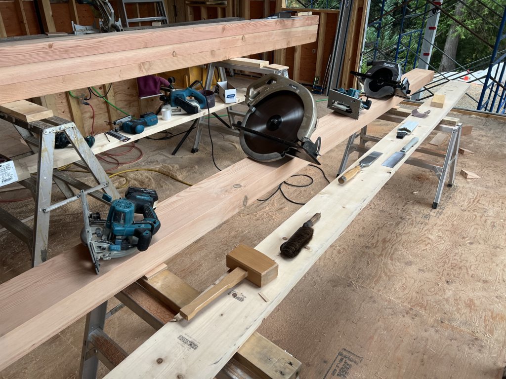

    We finally have a couple days of rain after almost 3 months without , had to move Operation Timber Trim to inside the house.
    Today I'm cutting the 4x8 Fir timber rafters for the glazed covered deck section we already installed the posts and beams for.
    This is where I ended up tool-wise , lol
    16" Makita beam saw to rough cut and trim the plumb cuts top and bottom of rafter , 2 18V Makita 6 1/2" cordless circular saws each set to a different depth but both at a 18 degree bevel to cut the plumb cut portion of the birdsmouth (top and bottom birdsmouth are different sizes , bottom is 6" wide to cross full 6x12 beam , top is 3" to centre of 6x12 ridge beam) , and a 40V Makita 10 1/4" cordless circular saw to cut the level cut portion of each birdsmouth
    it reminded me of watching New Yankee Workshop when Norm would say something like "instead of changing router bits , I'll just change routers" haha

    Ima gonna say it.
    That beam saw is beyond awesome. Is it difficult to operate?
    I could have used it a few times over the years for the three beams on our breezeway cover and beams and posts for a patio cover. VS multiple cuts.

    it takes a bit of practice but its not hard to get on top of , the table is small in relation to the size of the blade so the main thing is getting your cut started square , beyond that just like any other circular saw but with a bit slower RPM , you have to let it cut and clear the kerf for a decent cut , if you force it it bogs down

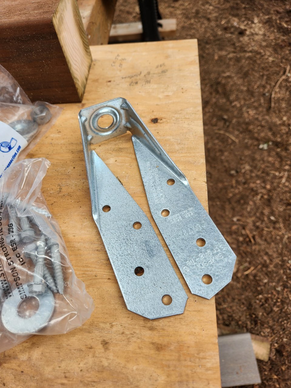

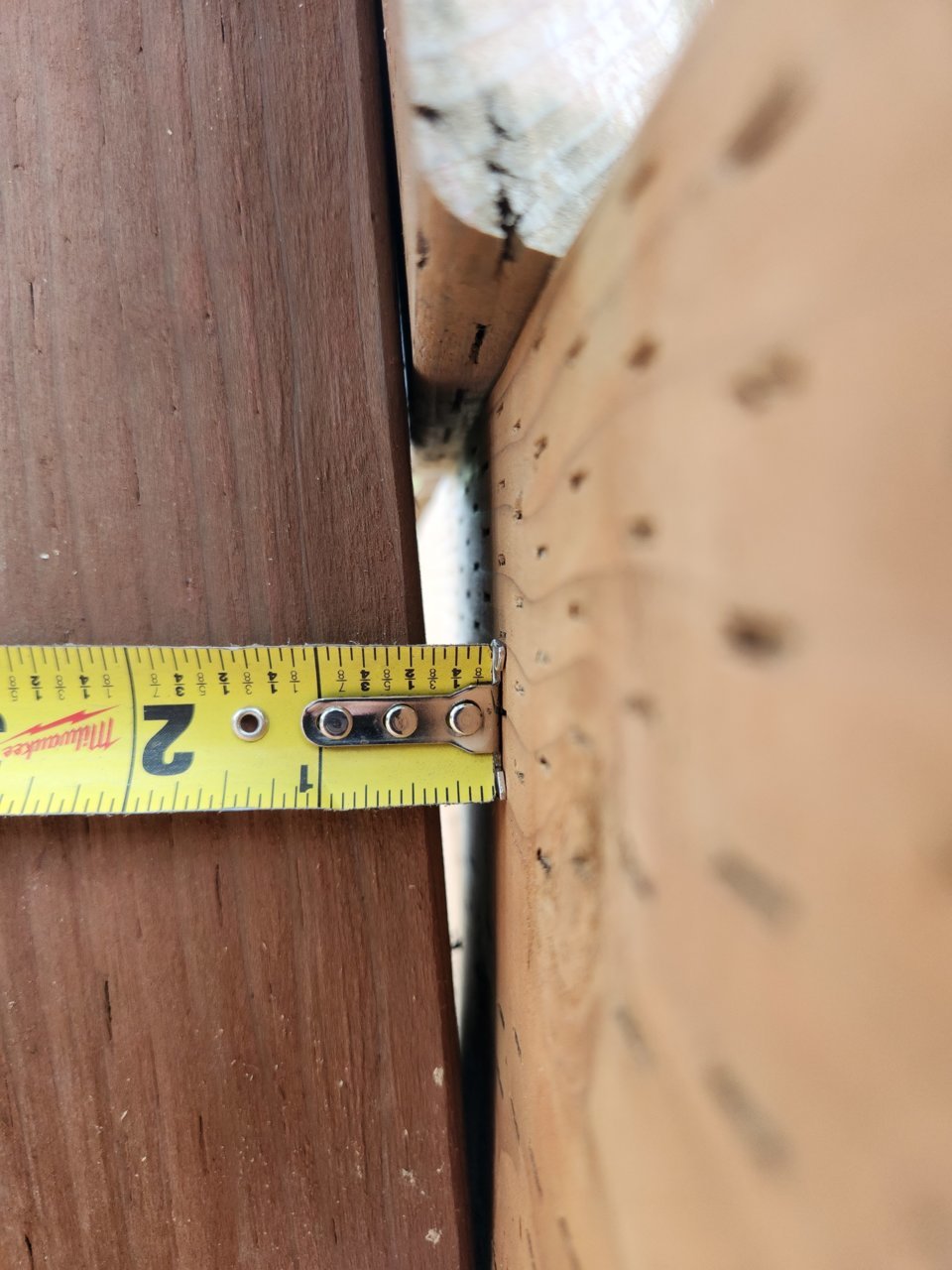

    Railing post meets warped end joist. Is this too much for a couple shims? Not sure if shaving the post would be kosher. This will be attached using two 1/2" lags and the pictured connector.
    Edit: the board laying perpendicular to the post (top center) is just a temp 2x4 attached to help position the post on the joist.

    I would cut a shim to fit from your post stock so it is full height and width and predrill it so you don't break it in half with your lags
