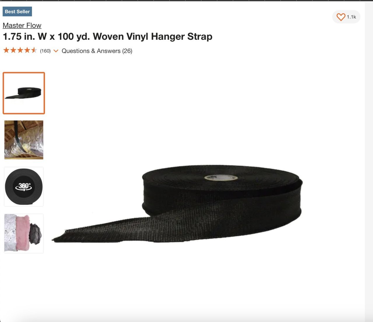

    Cooler today so I may attempt to finish up the ducting for my two upstairs bathroom fans. I’m using metal plumbers strap on 4” round sections with the adjustable elbows where needed. Is it a good idea to secure the strap to the duct with hex head sheet metal screws? The attic is rather tall and the runs are fairly long, the longer being almost 3 full sections, around 15’ total. Attic height may be about 8’ at the opening.
    Or I could make some supports with lumber if that’s a better overall plan?
    I’m replacing flex pipe which had separated at the taped joint, already replaced the two fans.

    you should have at least a short 2' section of flexible ducting right at the fans, otherwise they'll transmit vibration the entire length of the hard tubing.
    it's always best to route the tubing either straight vertical, or straight horizontal, to minimize moisture pooling in the middle of the vent line. ideally, pitching the vent like plumbing towards the exterior vent outlet would be ideal, but rarely possible.

    Good advice but not really my question. My question was support along the longitudinal axis of long runs of solid ducting which rises slightly steeper than the roof pitch. Is there a good way to do that, is lumber best or strap just fine, do I tape or should I use sheet metal hex head screws or is there some good way to ensure the weight of 2-3 sections doesn’t all end up on the elbow at the bottom?

    strap is really fine. i always avoided running screws into the duct to reduce dust balls from forming over time.

    Thanks. I was concerned about the downsides to punctures but wasn’t sure if I was overthinking that one.
    Zip ties are a good plan, thanks @theesotericone. Those specialty ones are super slick, I’ll see if I can find them. But I think hanger strap with zip ties could get it done, right now it slides through a bit too easily even though I wrapped it once.

    When I upgraded to Panasonic whisper quiet exhaust fans I redid the ducting with new insulated/flexible and used Master Flow woven vinyl hanger strap to support the ducting. The strap was stapled into the rafters.

    Yeah, these Panasonic fans are so awesome, quiet, modular, serviceable from below, move a ton of air. I love them.
    why insulated? To keep hot air from leaking in?
    I found exactly the ticket at the depot, thanks for the help on this.
