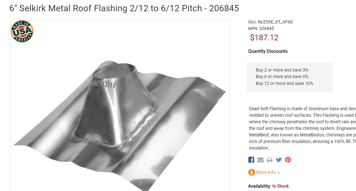

    there exists a corrugated roof flashing made by Selkirk for class A pipe

    Neat, this? Kinda spendy for a piece of metal, almost half the cost of 18 panels of polycarb.

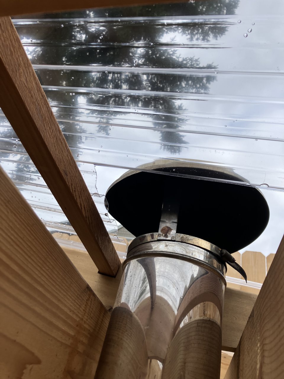

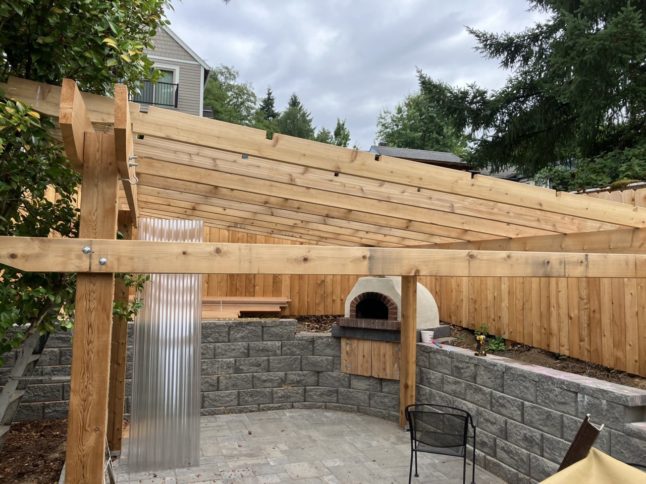

    2" to combustibles is a general rule for not torching your house

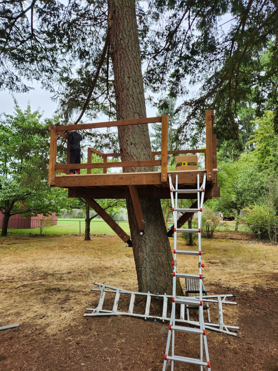

    Adventure park stage one 95% complete. Platform... check. Zipline (not pictured)... check. Uncontrollable laugher as my 6yo flies... check. Still need to build the ships ladder and waiting on rope for a braided railing. Stage two will be a secured pile of logs, cuz who doesn't love climbing around and jumping off a pile of logs!?

    flue need to run up higher
    I don't know current code exactly but I want to say 6 feet radius from the top of the pipe to any obstruction

    $3k+ on a pizza oven is alright but $200 to install it properly is too far? o_O

    Yes, discussed for months, finally super important since the roof went on today.

    ^i believe you also need a spark arrester in the flue as well
    yes, hot air in the summer, and cold air in the winter-- in the winter, condensate building up in the line is a real possibility without insulation. could also be added later on too.

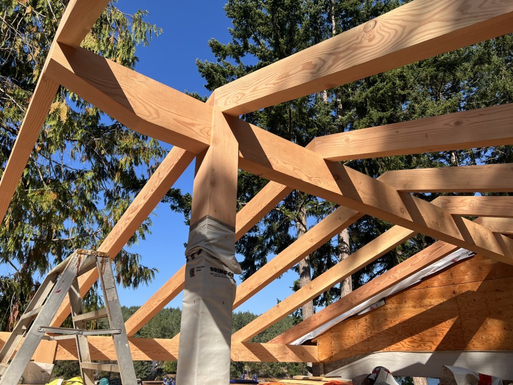

    Got my fir 4x8 timber rafters all cut
    Have the rafters all fitted and secured now
    Just need to add a row of 3x6 purlin blocking in each rafter bay that defines the top edge of the glass sections with solid cedar soffit above
