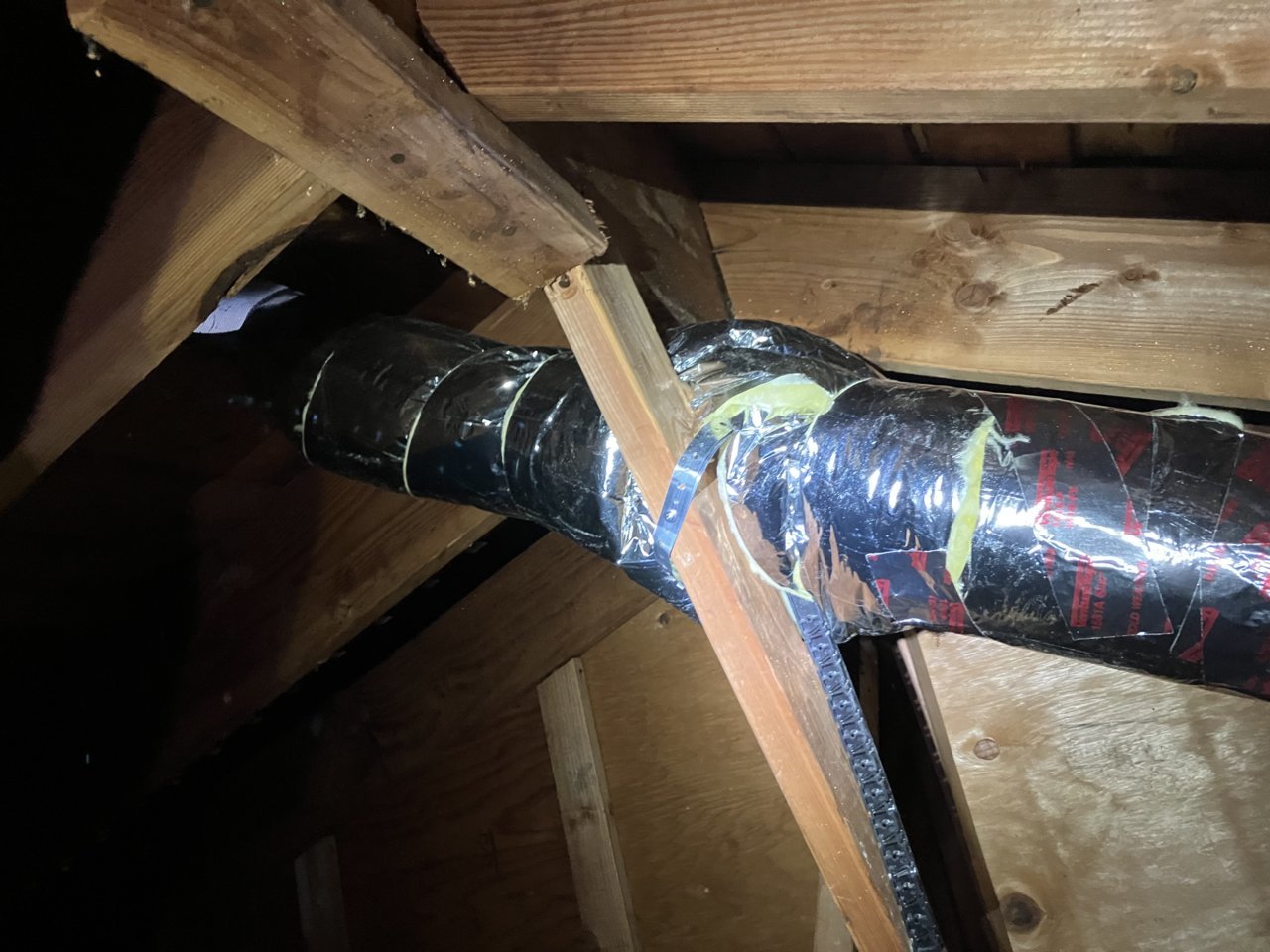

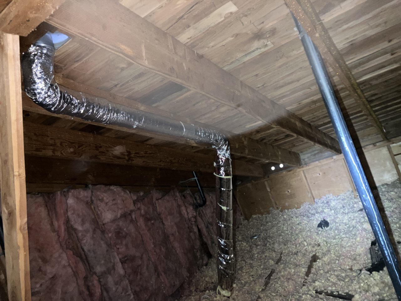

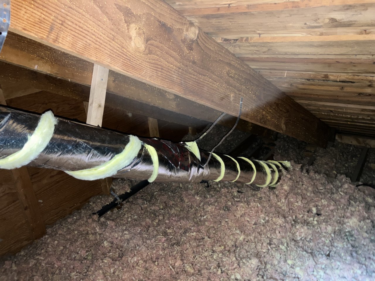

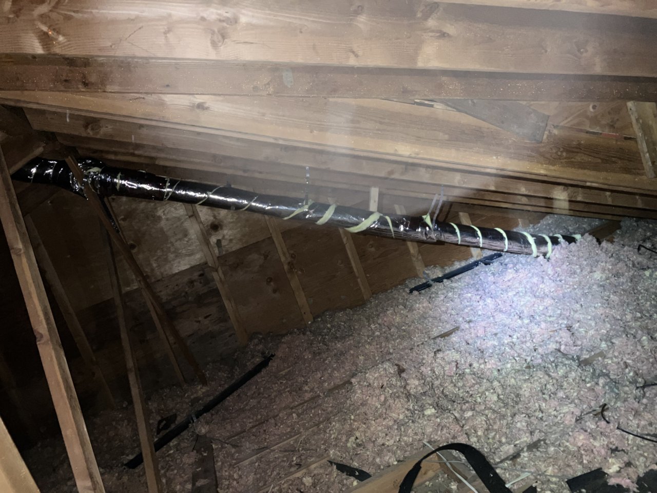

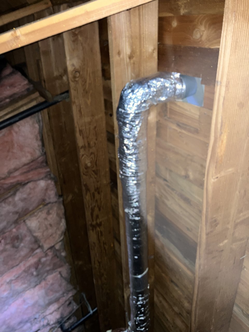

    I’m not going back up in the attic so feel free to tell me what I did wrong so I can be sad :)
    Boys bath vent:
    Primary bath vent:
    I mounted the primary bath vent too tight to the rafter to fit the R6 so I had to use the wimpier stick on stuff for that section. Lesson learned there but no way I’m re-routing it.

    you're likely to get condensation accumulating at the bottom of the downhill slope of your vent in winter

    Any way to address that? Slope change? Can you elaborate on potential resolutions/adjustments?

    I faintly recall something about duct exiting the fan needing to be a certain length before it makes its first curve or bend to prevent condensation buildup. If it were me I'd remove that elbow and make it a slope, but that's purely based upon observation. The flexible insulated duct is a lot easier to work with than rigid too imo.

    Flex ducting has significant downsides to me and is not what I consider a suitable option. I was quite happy to rip all the old flex out.
    https://www.atcoflex.com/uploads/4/9/4/0/49403973/installinstructions.pdf

    We always try to terminate out a sidewall if possible and slope the last section of ducting downhill toward the exterior to drain any condensation accumulation . When roof terminations are unavoidable I make the ducting run as short as possible , use a quality roof duct termination to reduce air seepage around the flapper and insulate with R-12 or R-20 batts wrapped and taped around the vent

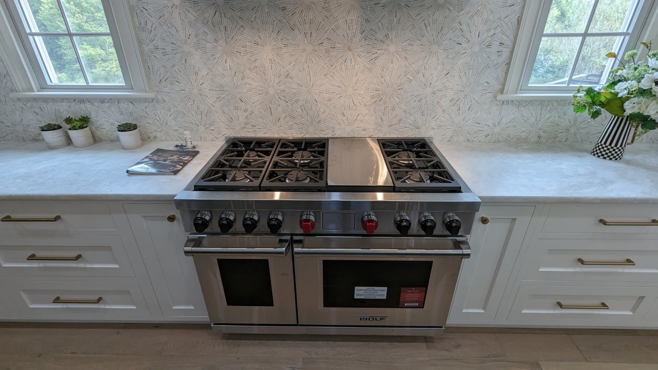

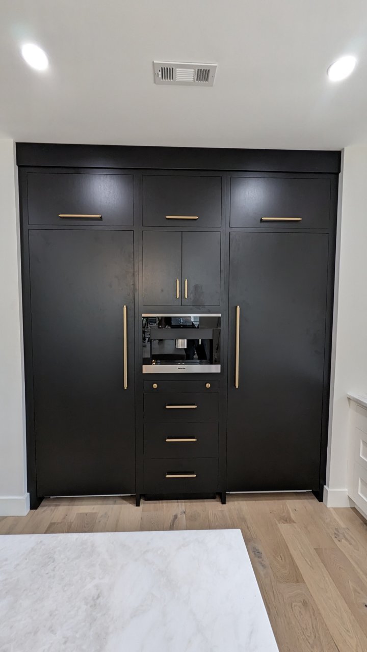

    Appliances were finally delivered! Fridge, freezer and range installed today.

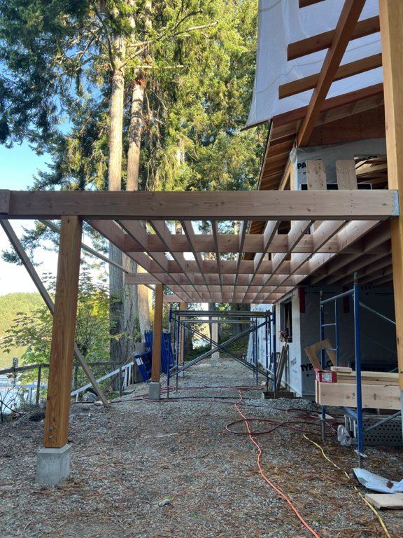

    We're about 1/2 done framing the monster deck

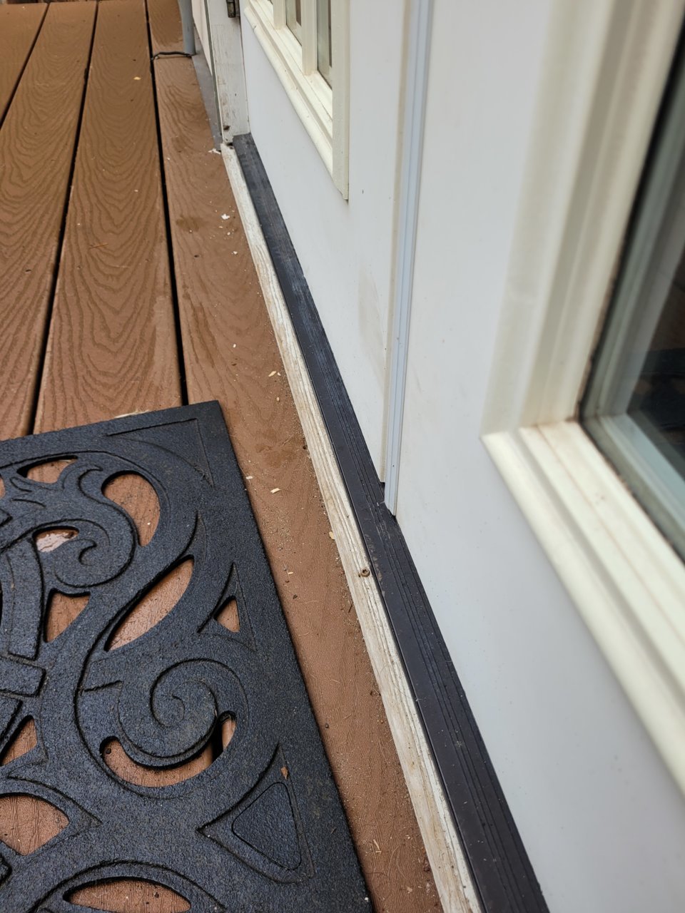

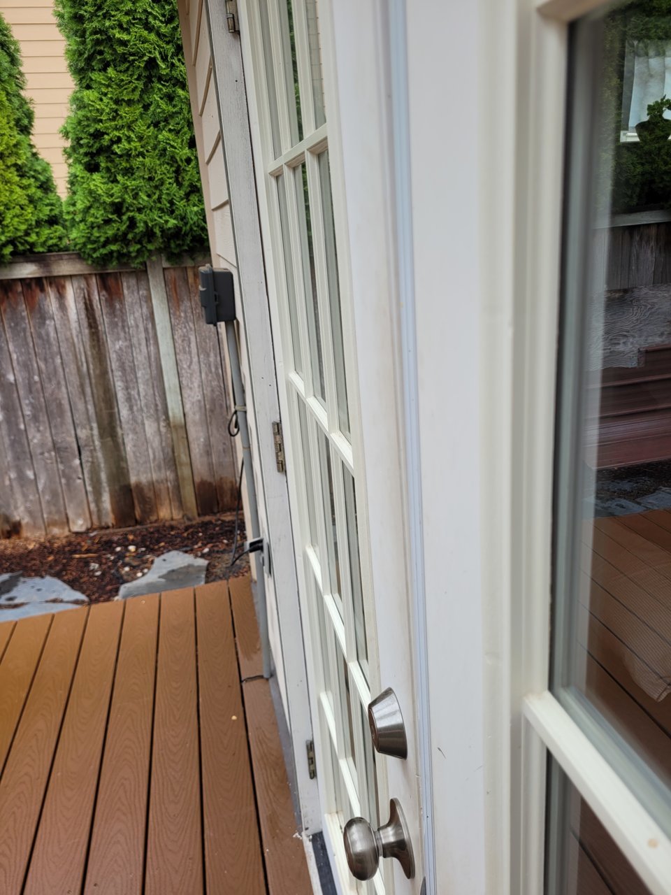

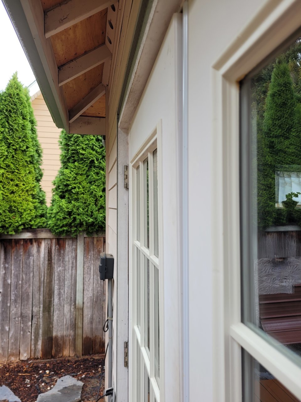

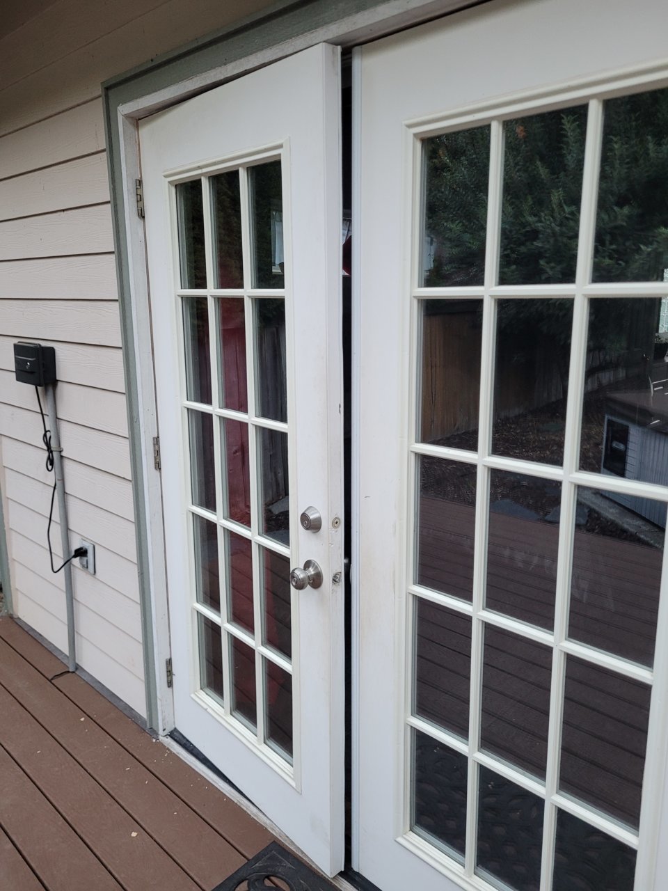

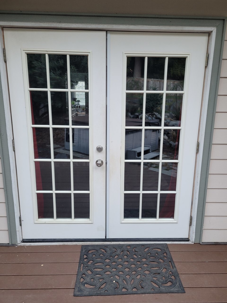

    Need alittle advice on my exterior outward opening french doors that bind when closing.
    I've tightened the hinge screws, checked the weather stripping, checked the frame with a square, shimmed the hinge, and the door seems physically fine. But it keeps binding when u try too close it all the way it will spring open unless I latch it and when I do latch it the bottom is flush and the top bows out. Anyone have any idea what's going on here?

    Too much shim on inside on hinge side? Or framing is twisted on hinge side
