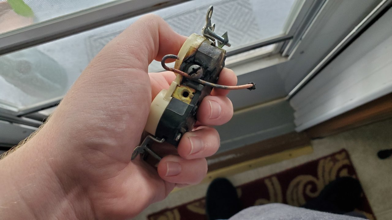

    So grandma called me today and said the outlets didn't work in the kitchen and dining room. Finished spraying the basement and went up and over the mountain to the house. Got there and everything seemed to work? Hmm. Found an outlet that the air conditioner was plugged in to (with heavy duty appliance extension cord) was really warm. Well that's weird. The night light and end of the cord was sorta melted so I went off to the hardware store for a heavy duty 20 amp outlet.
    Removed the outlet and this is what I found...
    Had to go back to my house for some 12/2 to splice in and wire it correctly.
    It got a little warm... o_O
    No more appliance cord. I'll add a cut in box and separate circuit for the air conditioner.

    For sure. No matter what the issue woulda been the owner of the house is in rough shape between cancer treatments and surgery, I had to take care of it. If I had to knock a hole in the wall, he would understand completely.

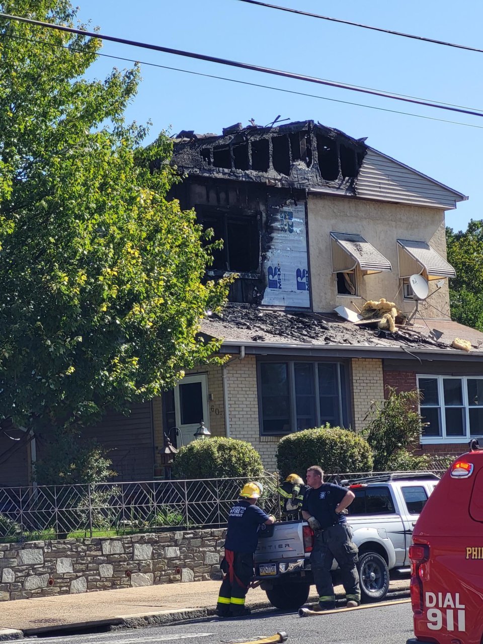

    My cousin wasn't so lucky....
  11. Sep 25, 2023 at 3:44 PM
    wilcam47
    wilcam47 Keep on keeping on!
    Jan 27, 2016
    #176243
    54,920
    Will
    Bourbon state
    :eek::eek::annoyed::annoyed::annoyed:
  12. Sep 25, 2023 at 3:50 PM
    TwistedTLM4
    TwistedTLM4 Unknown Member
    Jul 6, 2011
    #59396
    3,147
    Philadelphia, PA
    '05 DCSB TRD Sport
    WeatherTech Floor Mats, WeatherTech Bug Shield and Vent Visors, Audio Upgrade, RaamAudio RaamMat & Ensolite, Mr. Marv's Custom 10" Sub Enclosure, Pop N Lock Electronic Tailgate Lock, mattgecko's Bedlights, Demello Offroad Single Hoop Bumper, Marathon Seat Covers, Leer Topper, OME885s on 5100s, @Blackout14 HD Leaf Pack
    Fire marshal investigation said it was an old extension cord behind his clothes dresser.

    The bad part about gmas house is it isn't the first burned up receptacle I've come across. I lived there 5 years before she moved in. Replaced several back-stabbed outlets and burnt ones. Thought I got them all, but this was the only one that had a higher amperage draw with a HD cord. I'm betting it has just been cooking for a whole. I'll remedy that situation before she needs AC again.
