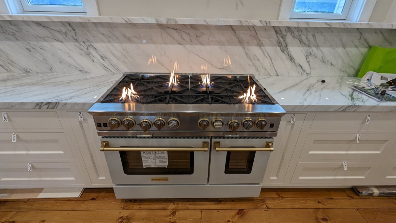

    Seems like quality control is non-existent anymore. Doesn't matter if you buy a $300 range from HD or a $17,000 BlueStar range, there's always an issue. This one shipped out without being converted to LP even though paid extra for it.

    Depends on the range. All burners are easy and so is the regulator. The oven ones can be a real PIA to get to. I did an LG last year for a client. The instructions called for taking the door off because it was so far in the back and only accessible from inside the oven cavity. Fucking idiot engineering at it's finest.

    Yup, the oven burner one was way in back, that was worst one.

    The orifices will be brass. It's non-magnetic. A good trick I use is to put a small piece of painters tape on the head of the orifice. Then slide the socket on. It should be tight and not fall off. Once the orifice is installed you just pull the tape off of it. You do not want to loose them and if you drop one it can be hours looking for it. Ask me how I know. lol

    We received an extra set of "jets" with our stovetop in order to convert it to propane if needed. I have those safely tucked away in the event I need to convert my stovetop.
