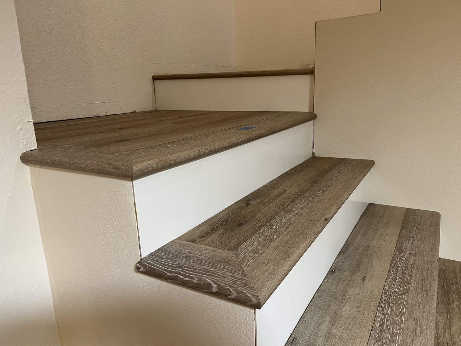

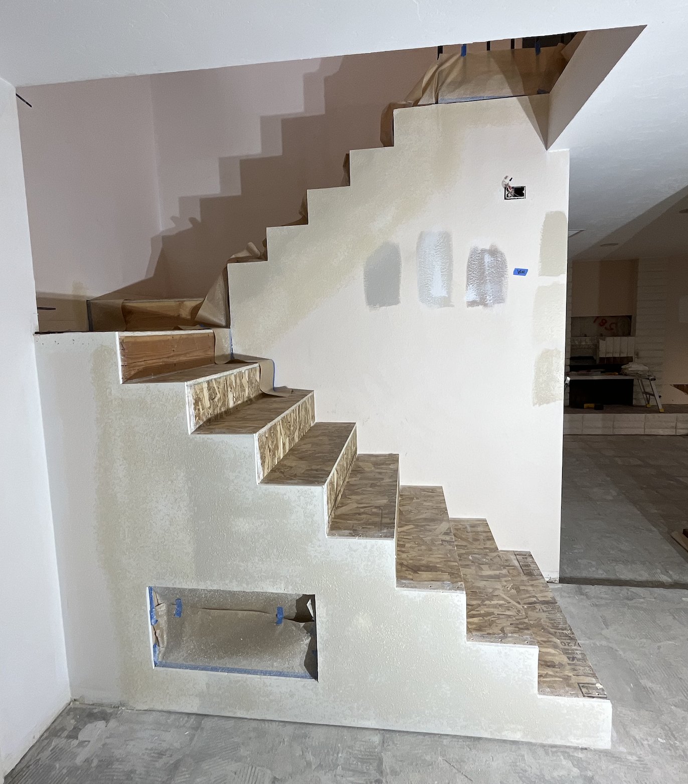

    Finally got the LVP wrapped up on my stair case. Came out really nice and clean. Just some trim details to conceal the edge of the risers and then it's time to burn some metal for the railing. :welder:

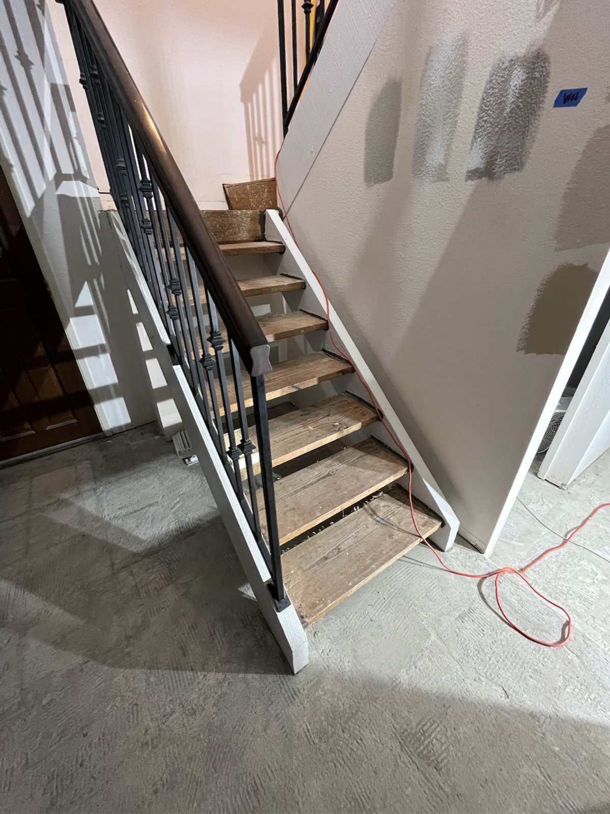

    I like the before. Put it all back. :p

    Ha, nope, nope, and nope! That shit is GONE. The stairs weren't in the original scope, but after looking at all the issues I would have had to correct (like 2nd flight stringer being out of square to the lower wall, the tiny human trap between the lower stringer and wall, and general shitty condition overall) the boss gave the go ahead to rip them out and replace them. It was less than $200 in material (excluding the railing). Easy win, big improvement.

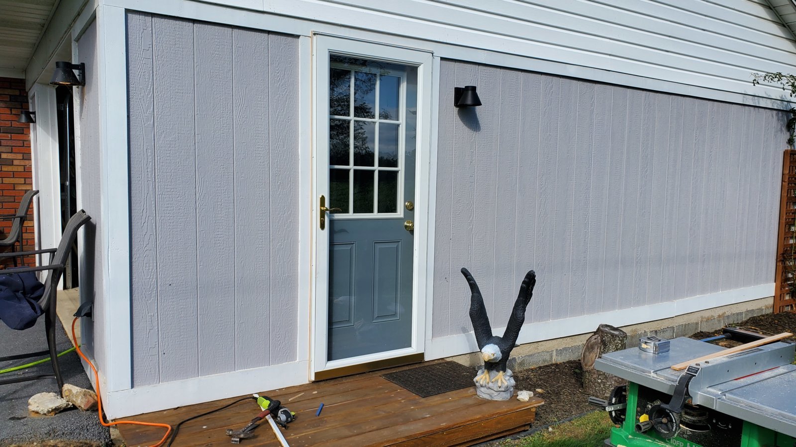

    So @Sig45 in a round about way, got me motivated and off my ass to do a couple projects around the house before winter.
    Side man door on the garage gets all the weather and needed a storm door. I had the Larson off the other door, so that was perfect. Due to the way I had the trim I had to make a shim all the way around. I had some pine S4S 5/4 that was perfect. Ripped 1/4 thick pieces and was able to hang the door no problem.
