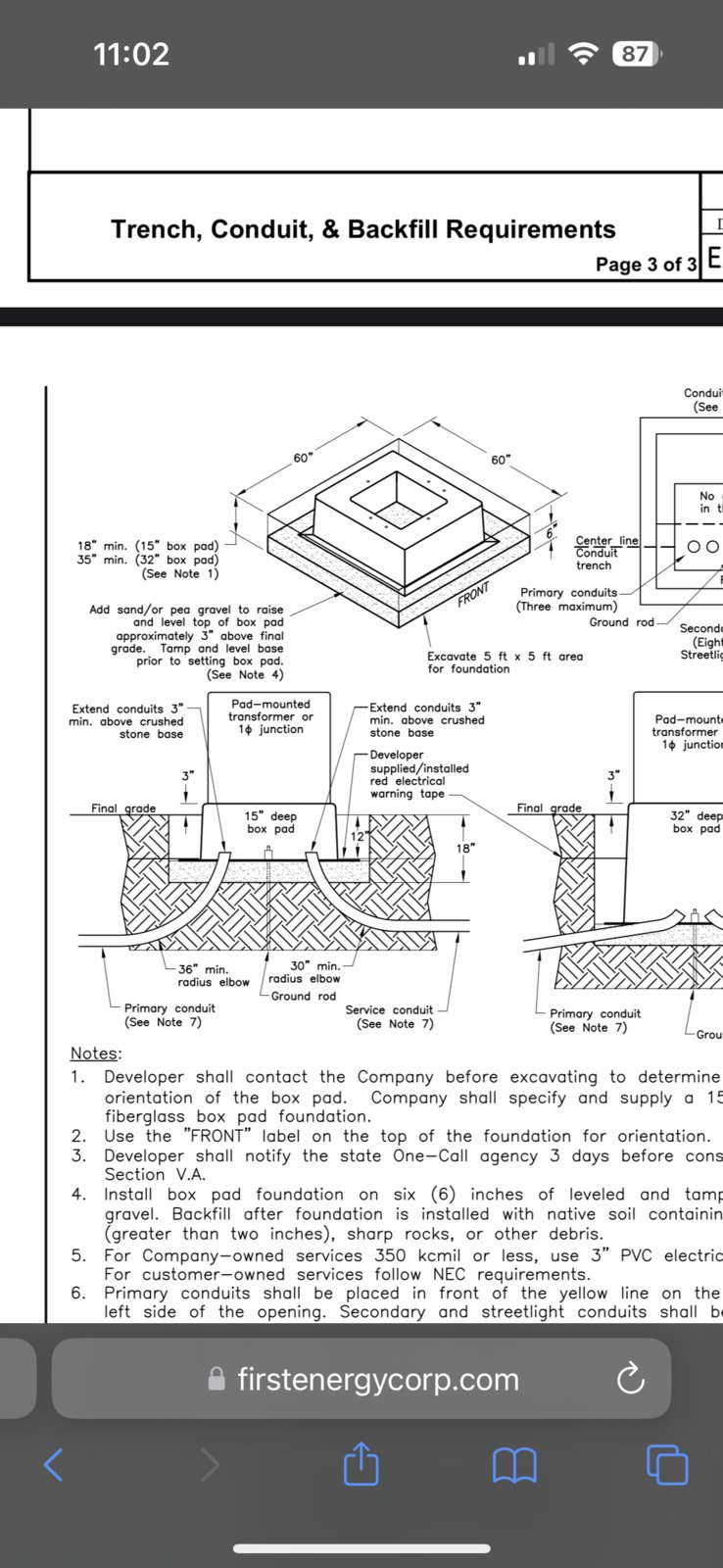

    By code it should be deeper than 18” but your local AHJ or power company may require it to be 36”.

    Primary line should be 36” for ground transformers. Secondary lines may vary depending on local codes. Usually they are around 24”

    Is there a way to confirm that ahead of time? You think I can ask the guy doing the marking? Or is that unknowable?
    Edit: I would also feel better knowing it's in conduit. Is it crazy to say that makes me think it's less dangerous especially if I'm just digging with a shovel?

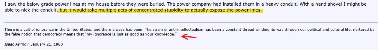

    I use a method similar to wilcam47's. I use an off-road recovery strap that has sewn in loops. I create a slip loop on one end and try to get as much of the bush as possible in it. The other end I attach to my truck and slowly back up, putting as much tension as possible on the line. Then I take a shovel and dig around/cut any roots that have tension on them. When I've released all the tension it's back to the truck for another pull. A bush your size would take 5 or 6 pull/dig cycles, but it isn't particularly hard work.
    I saw the below grade power lines at my house before they were buried. The power company had installed them in a heavy conduit. With a hand shovel I might be able to nick the conduit, but it would take multiple acts of concentrated stupidity to actually expose the power lines.

    The wire they use ahead of the transformer looks like a large coax cable and will be hard to damage with a shovel, after the transformer its not necessarily going to be in conduit and that wire can be damaged fairly easily. The guy doing the marking should be able to tell you a rough depth if you are there when he marks it

    I know they have locators that can tell the depth. However usually they just mark the location. You’d have to ask when you call
