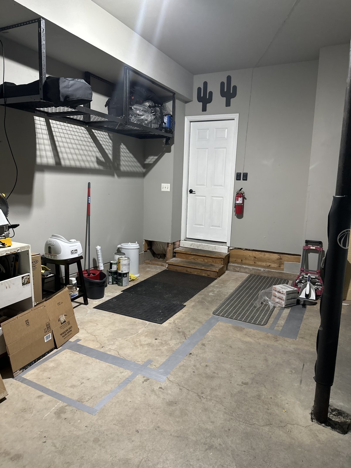

    Hey, been awhile since I've posted on this thread but I used to contribute frequently a few years ago living in Arizona and renovating houses. Since then had a baby, moved to PA and have been renovating the 'forever home'. Large single family home in the suburbs, built in 1997. Have done a ton of work since buying in March 21. Current project is construction of a mudroom. I'm looking for some input on this as i start the project. We have a large 3 car garage attached to the house. Though it's the volume of a 3 car garage, there are only 2 doors, leaving a very large storage area on one side where the entrance to the house is. You enter the house into a tight laundry room and then the kitchen/family room. We want to build a mudroom with laundry in it, in part of the extra space in the garage. Because it only has two doors, it's listed as a 2 car garage + storage in public records & MLS, so not concerned about 'downgrading' the car capacity of the garage. With this alteration we can still easily fit my Tacoma and my wife's Subaru Ascent in the garage, along with all of my tools.
    My questions are mostly around the construction framing of the room itself. I am planning to build the room at the height of the existing laundry room floor. That means that I will have to elevate the floor about 2 feet inside of the garage. I was planning to essentially build a deck on top of the garage floor attached to the home on two walls and attached to the existing garage ceiling. As I was researching this, i came across this person's blog series detailing essentially the exact thing I'm planning to do. My door is in the same location as theirs and I will be building a similar size and function room.
    To the pros and semi-pros who are kind enough to grace this forum with their input on a regular basis, do you see anything wrong with the way they went about this project? Anything you'd recommend I alter while constructing something very similar? Mine will be much lower to the garage floor and I don't think I'll get any storage out of the underside of it, so I plan on finishing to the floor with drywall. Are 6x6 necessary or would I be ok with 4x4s?

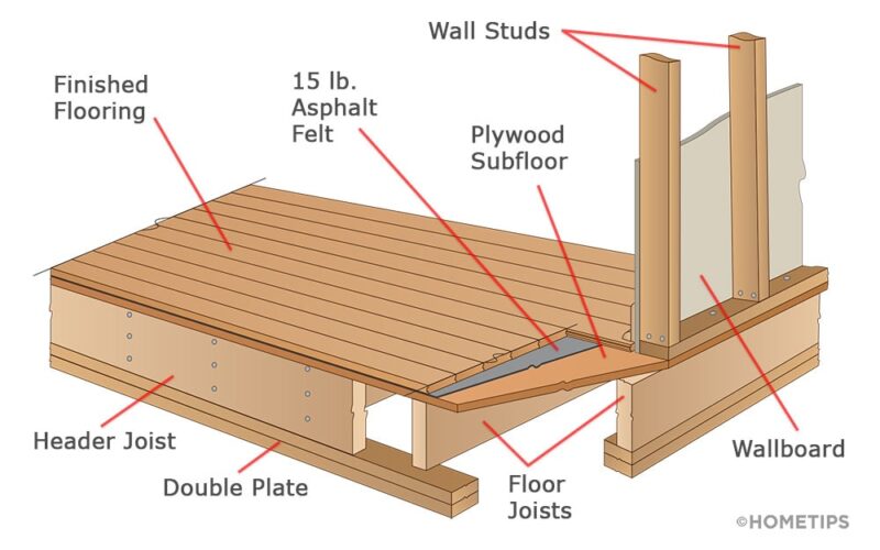

    From the concrete floor. Just google balloon frame construction and you'll get the idea. There's two ways to balloon frame. The old way was to nail the joists directly to the side of the stud. The new way is to use 2x ledgers that get SDS screws into the studs. Then joist hangers off the ledger for the floor joists. If you do it the new way you just need to block out at subfloor level. Google ledgered floor joist and that should give you the ledger side of it.

    Having trouble finding balloon framing specifics for the floor support. Am i notching out a 2x10 section of the top of a 4x4 for the 2x10 to rest on and bolting it in place?

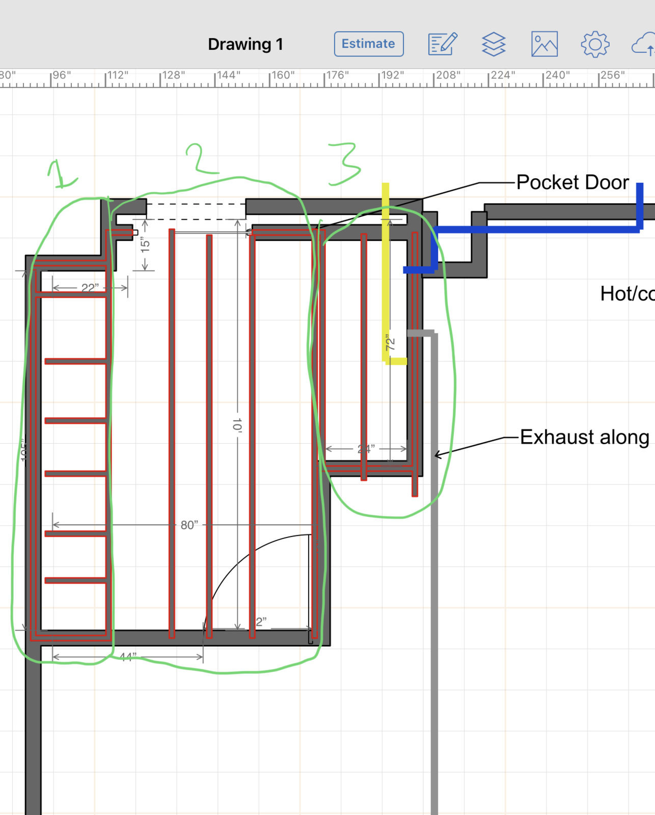

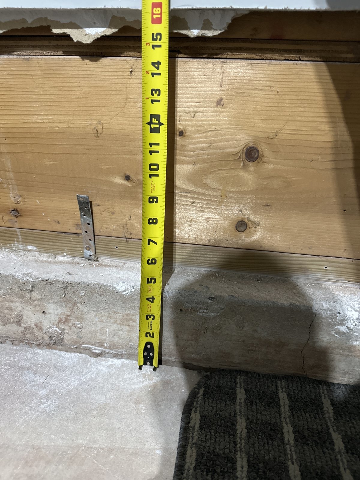

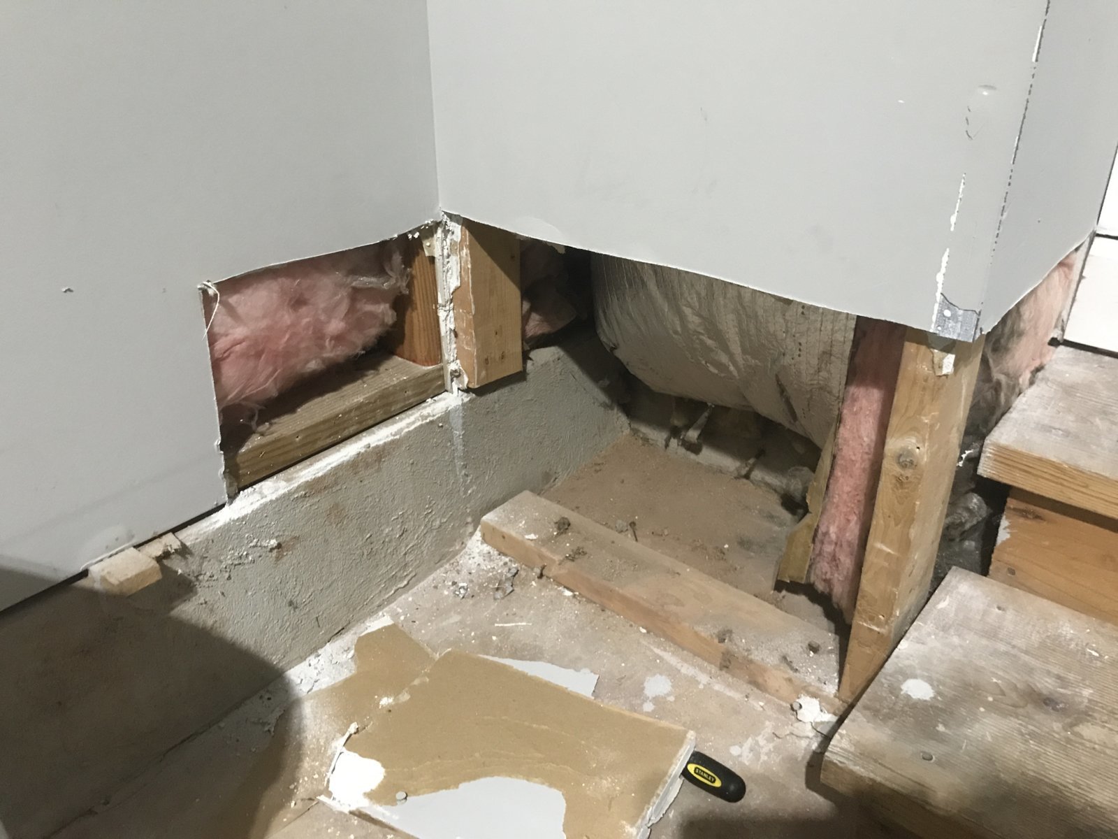

    Thanks. What’s the best way to layout this floor? The door opening where the pocket door is going is the original door to the garage from the house. That wall is where the 2x10 picture above is from. The picture attached here is The 22” bump out in the upper left which is a cosmetic soffit for HVAC and crudely framed with 2x4s. The other existing house wall that’s 105” is also showing and just framed off that concrete foundation. I thought that I would put another 2x10 against the existing 2x10 with a PT 2x4 on its side underneath it resting on the concrete foundation wall (matching what is there on the house side so my floor would be even coming into the new room. The floor joists would be hung from there. But Do I have to do three different sections of flooring to create the floor shape? I attached a crude sketch of the 3 sections. I turned the joists for section one because I don’t have any real support in that 22” corner pictured.
    thanks. You guys rock.
  19. Oct 17, 2023 at 8:04 PM
    theesotericone
    theesotericone Well-Known Member
    Jul 27, 2018
    #260800
    12,378
    Bishop CA
    I'd run them E/W then pull layout from the S side. If you level over from the bottom of the existing entry door to the W wall how far is that mark from the stem wall(the concrete)?

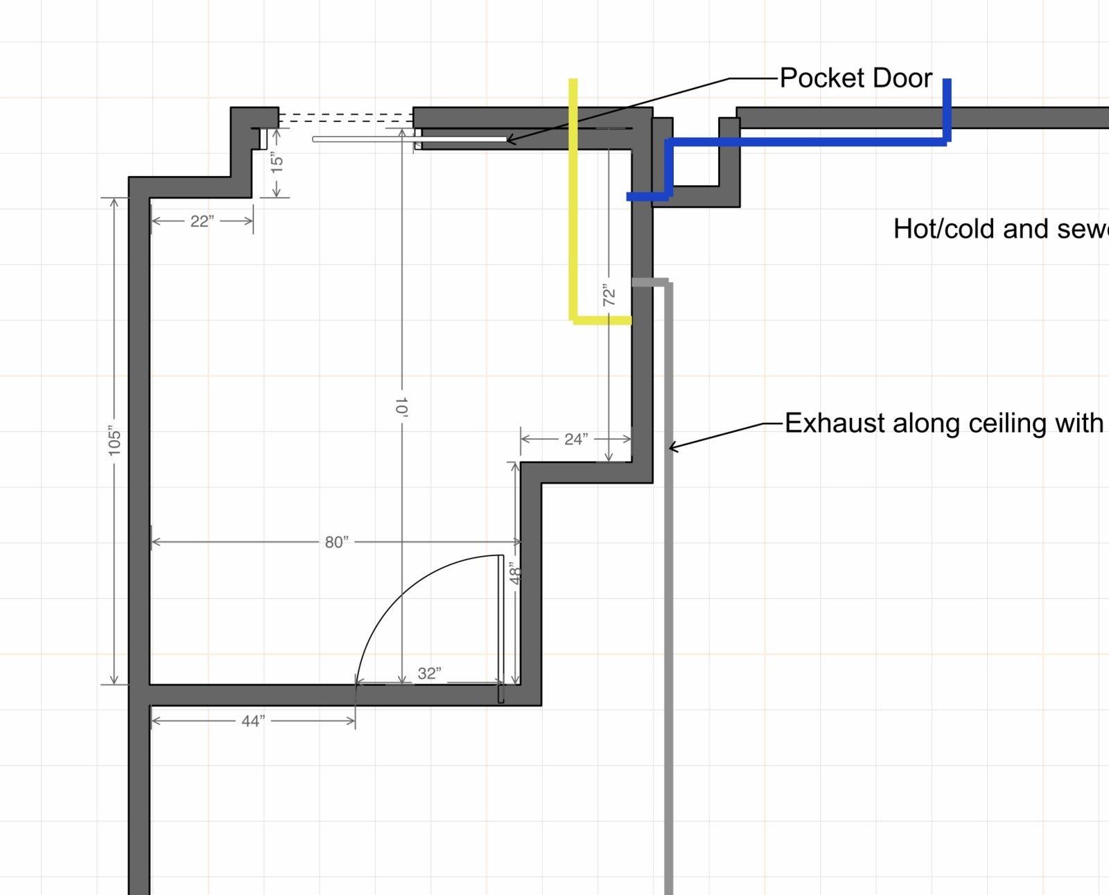

    Was hoping to run that right section N/S to make plumbing and gas routing easy as washer/dryer will be located there. Here are the detailed dimensions. That NW corner soffit next to the existing door is not something I would hang any structure off of.
