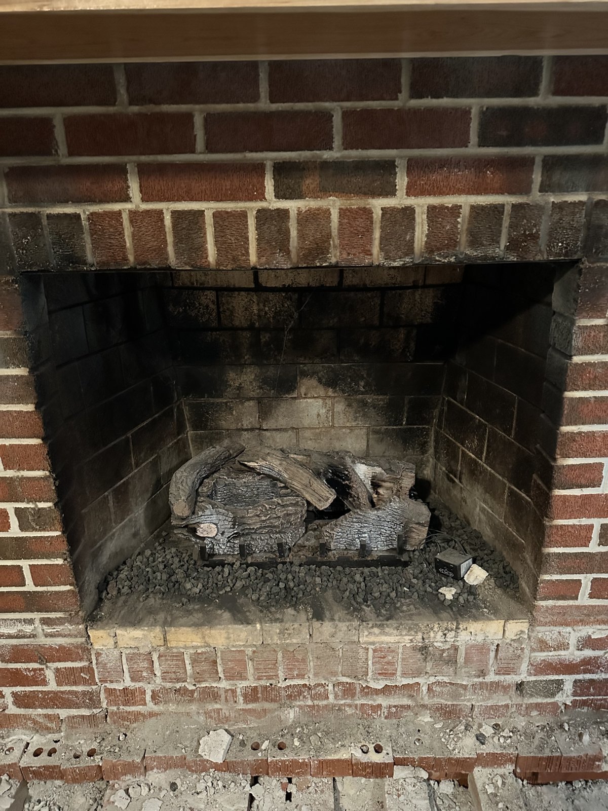

    Ok so my wife has decided she wants a brick hearth put back in place, so that’s an easy fix just need a brick mason.
    went and spoke with a fireplace company about options for replacing our current setup, and he recommended a direct vent gas log insert. To the tune of 8000-8500 dollars.
    I believe we have what you would consider “ventless” now, but I do open the damper because the gas smells are pretty strong when you fire it up at first and we don’t love that. Through the research I’ve done most ventless systems/inserts still have that issue because the gases just come out in your house. They are supposed to be more efficient as far as heat goes though.
    all that being said, do any of you have recommendations on how I should do this? Looking for a more DIY situation for myself. Do I go ventless insert? Or is there a direct vent option that I am capable of DIYing?

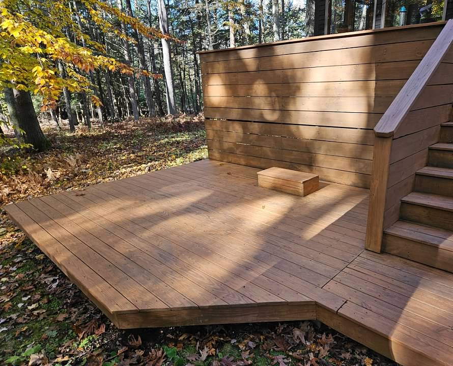

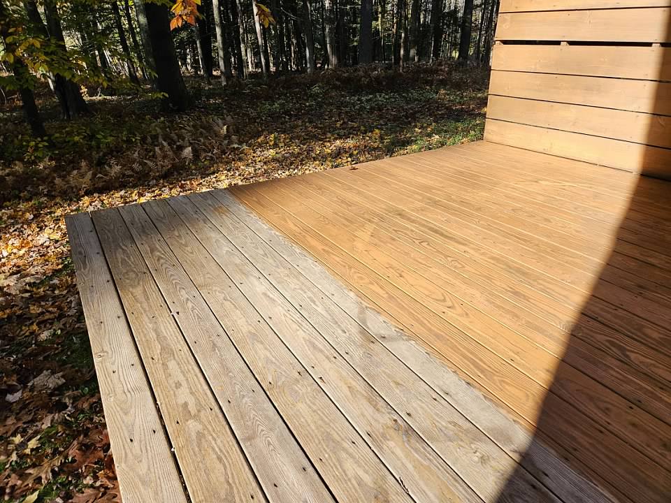

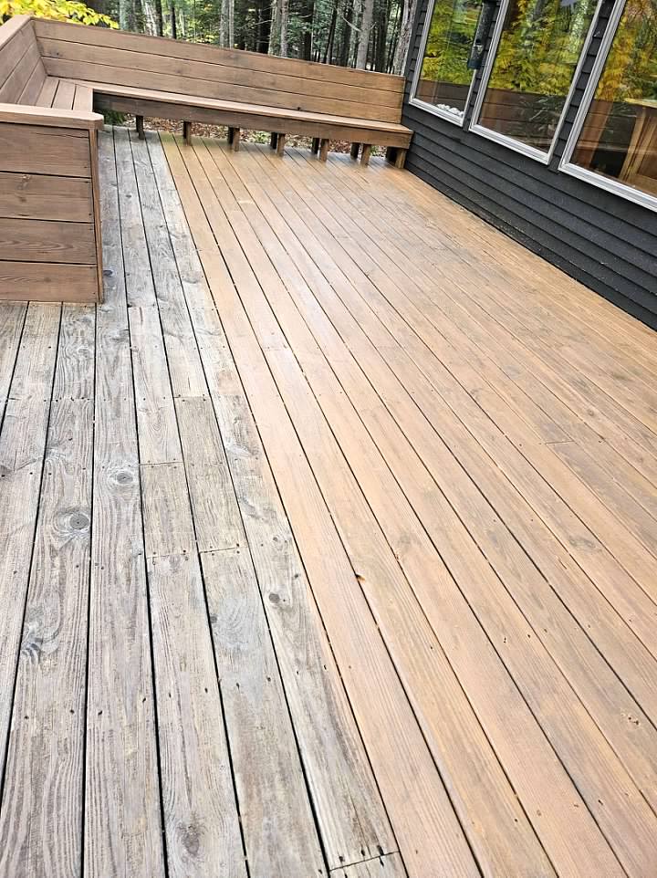

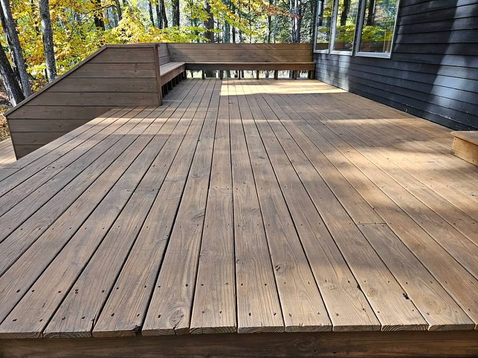

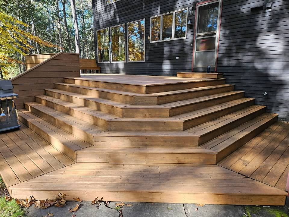

    Some rare warm fall temps (low 70's) here in Maine. Took advantage of it and got a coat of stain (SW water based semi-transparent cedar toned) on that deck I cleaned a few weeks back.

    going to be fun!
    That’s looks great

    I would not run a ventless without opening a window for some fresh air
    Direct vent isn't that hard but it depends on if you want to drill out the back for a side vent or fish flex lines down the chimney

    Having lived in 2 houses with old school wood burning fire places (which is what your's looks like it started as) and 1 with a direct vented insert, I'd take the vented insert every time. As long as you have a flue and damper you will be losing heat up the chimney. $8,500 seems high for an insert. I found this at $4,300. https://www.heatnglo.com/fireplaces/gas/inserts/cosmo-gas-fireplace-insert# Not cheap but but still half the price. I wouldn't hesitate to DIY something like that, but YMMV. As for the "ventless" inserts you couldn't pay me to have one. It's essentially a gas stove venting all of the combustion products into the room or sending, like you do, all the heat up the chimney.
    My vented system has a little fan that blows the warmed air into the living space while getting the combustion air from outside. It keeps the living area nice and warm, but it isn't very efficient compared to using our high efficiency furnace. If we run the firplace alot the gas bill always goes up. However, there is something primal about sitting in front of a fire on a cold winters night.
