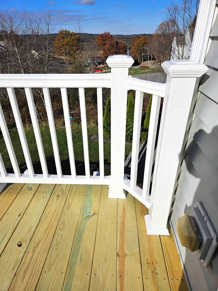

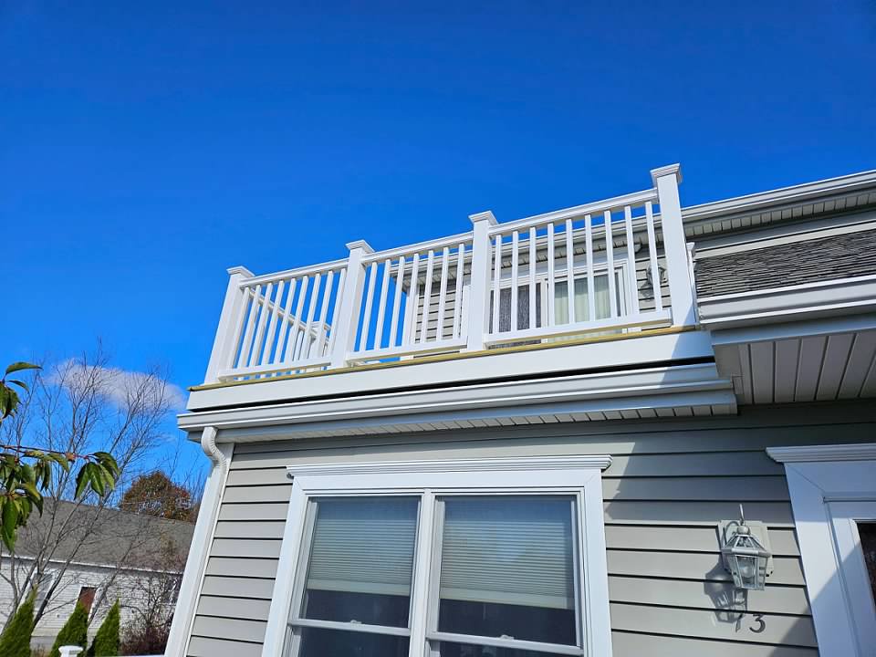

    Made it back to that deck project to install the railing on that short angled section and wrap the rim joist with Azek. Ended up using a different brand of railing that had adjustable angle brackets. Can hardly tell the difference and certainly can't tell from the ground. Customer is very pleased.
