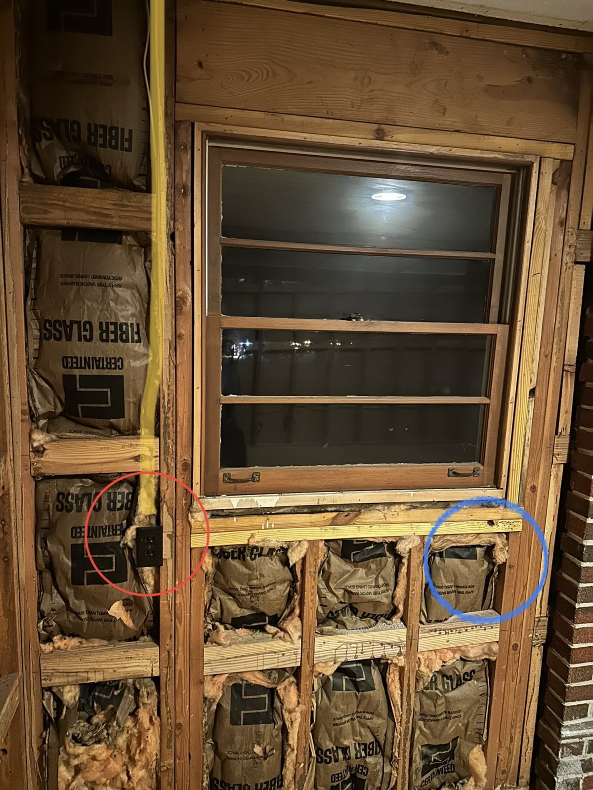

    Check local codes but apparently it is legal to bury this...
    https://www.homedepot.com/p/Tyco-Electronics-Romex-Splice-Kit-2-Wire-1-Clam-A22899-000/202204326
    I realize that is not available on HD but google "In wall Romex wall splice"

    I was looking that up as well.
    I came across this site - https://www.jadelearning.com/blog/splicing-nm-cable-in-walls-and-other-concealed-spaces/
    Read down that page - from what I understand, they are only legal in a few circumstances. But, I'm not an electrician, and I don't play one on TV, so YMMV.

    i used to stock 2 kits like that on my service truck. but never used them. i kept them for the ultra-extreme-emergency where i had no other choice after some bumblehead hit a wire somewhere it shouldn't have been, and as a cheaper alternative instead of costing a homeowner thousands in re-drywalling an entire wall. fortunately, i was always able to figure out a better solution.
    but all the models i've come across like that are all designed for only 1-in, 1-out secenario's. which wouldn't work for the OP, as he needed 1-in, 2-out, to add the outlet in a new location, but also maintain wiring going elsewhere.
    even after taking apart the kits i had, i still don't know what to think of them. they might be rated to be safer than a raw wiring splice in a wall, but i don't really feel that confident that they're really any better than that...
