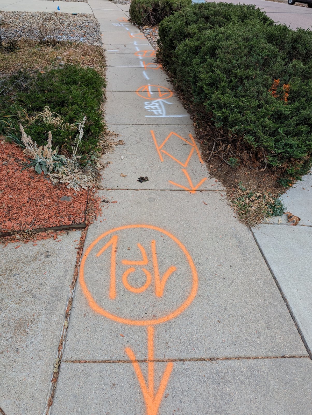

    It means that someone called in for locates, there is going to be some underground work in that area.

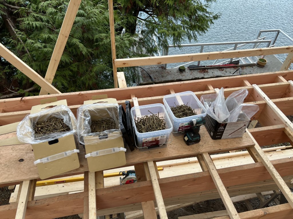

    In case you ever wondered what $1200 worth of GRK structural screws looks like haha

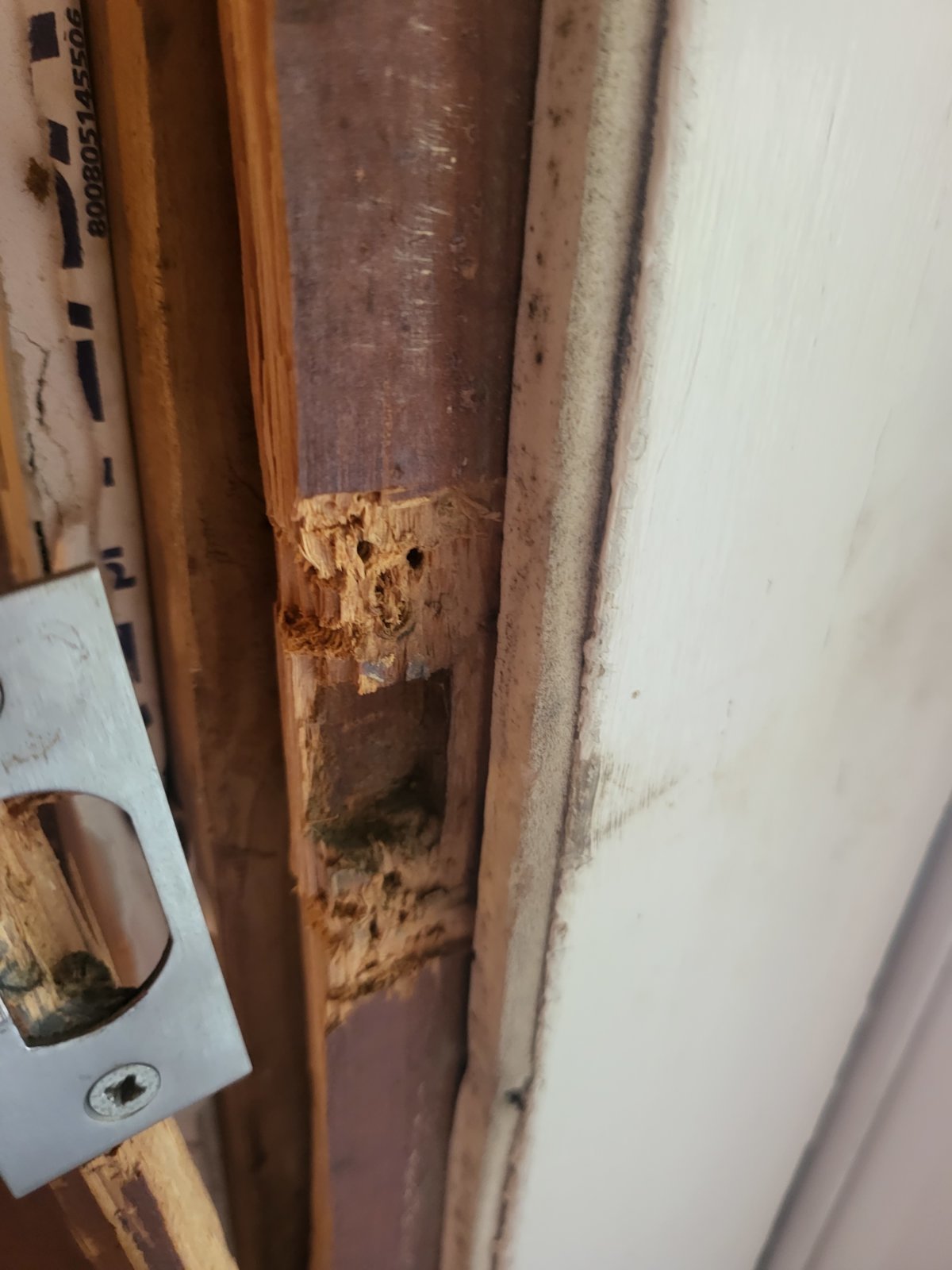

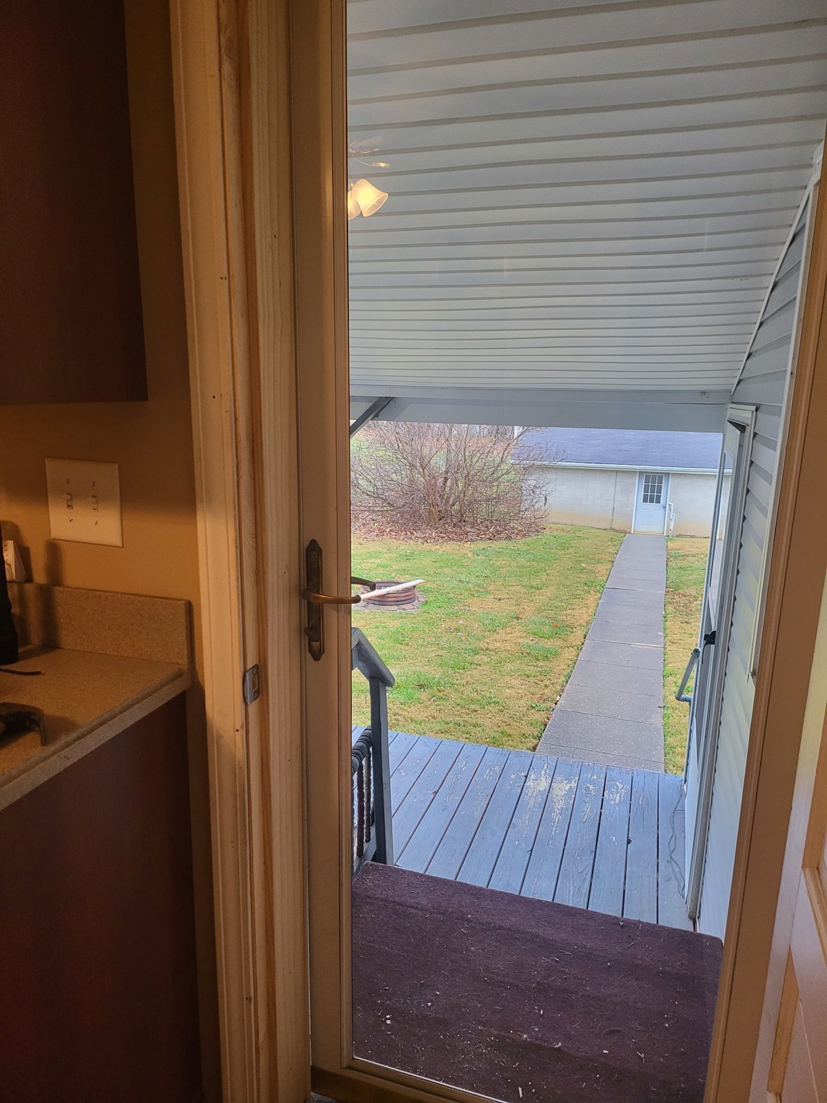

    My door jamb gave way last night, so removed and replaced the jamb. Threw a new handle set on at the same time. I'm surprised the old jamb made it as long as it did.

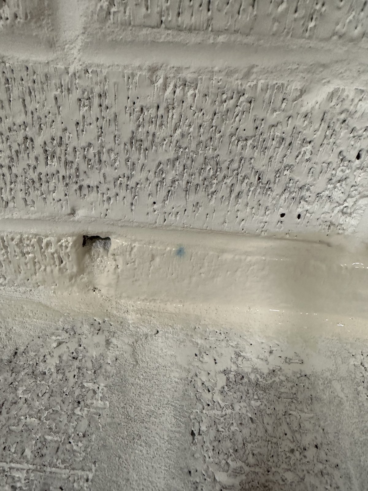

    Painting our brick fireplace and wondering what this blue coming through is? It only showed up when we first did the primer. I thought it would dry and be covered by the paint but as soon as a put a coat of paint on it leaked through. Some sort of chemical reaction?

    Not sure what contaminate is, but you are probably going to have to use a shellac based primer to seal all that out. Might be some odd soot seeping through causing a reaction.

    I don't know what that particular one is, but sharpies do that as well. The reason is whatever is in the sharpie ink is alcohol based. That is what is bleeding through, the alcohol. I'm not saying this is a sharpie, I'm just saying its more than likely alcohol based and that is what is bleeding through. There are several primers that will cover it, you need to figure out what primer will work.
    My recommendation is take pictures and bring them to a Sherman Williams store and ask them. I would not go to HD, they're about as useful as a public defender.

    Well dang that’s annoying since we already did primer.

    You just need to hit the area that is a problem. You dont need to do the whole thing. A quart would do for the whole project.
