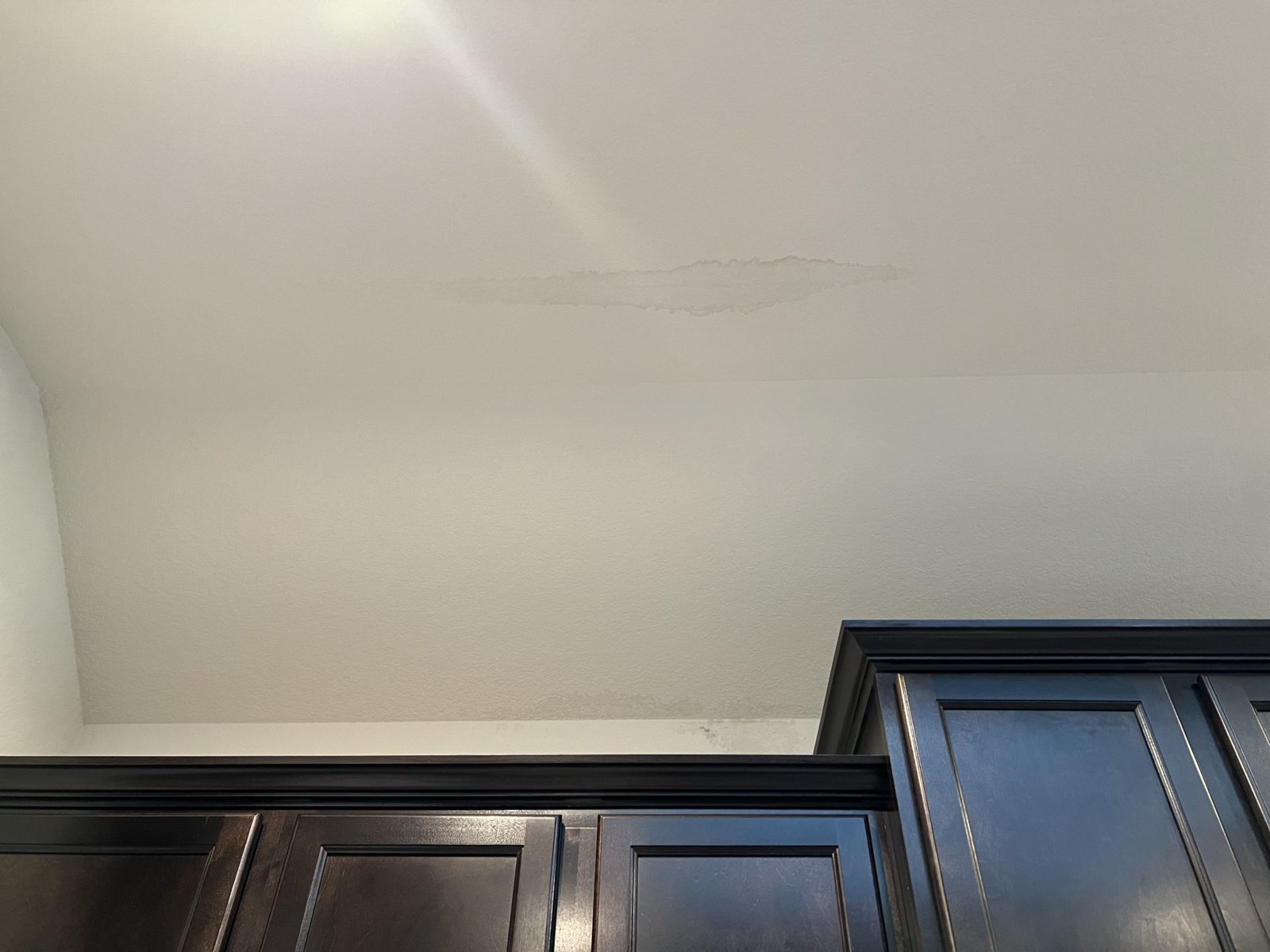

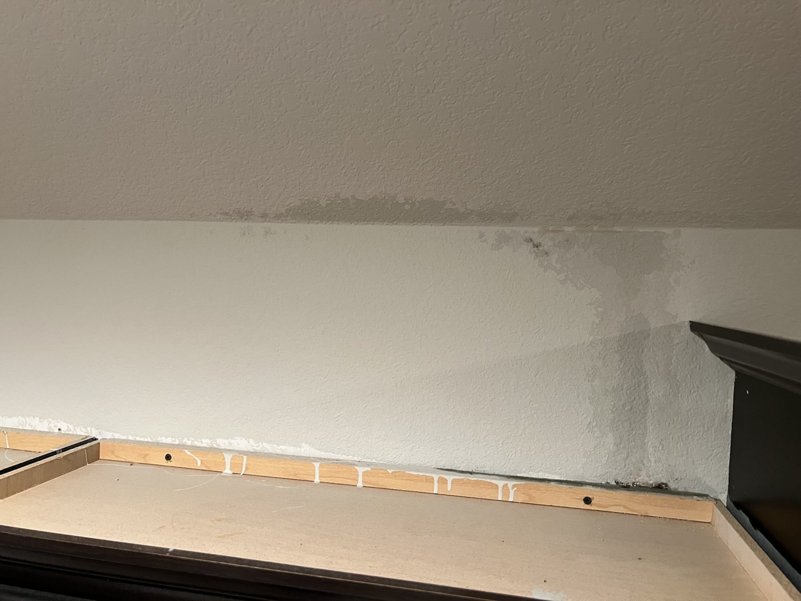

    wet blown in tends to slump and will not billow back up on its own when it dries out , losing its R value

    assuming they just took the skylight off , how exactly did they assess the condition of the framing or insulation ? Did they go into the attic ?

    Another good question. They did repairs while I was at work; my family let them in and I don't know exactly what they did. I just took him at his word when he said they checked it out and everything was ok.
    Sounds like a good excuse to get a borescope. Anyone got any recs that are decent but not too expensive?
