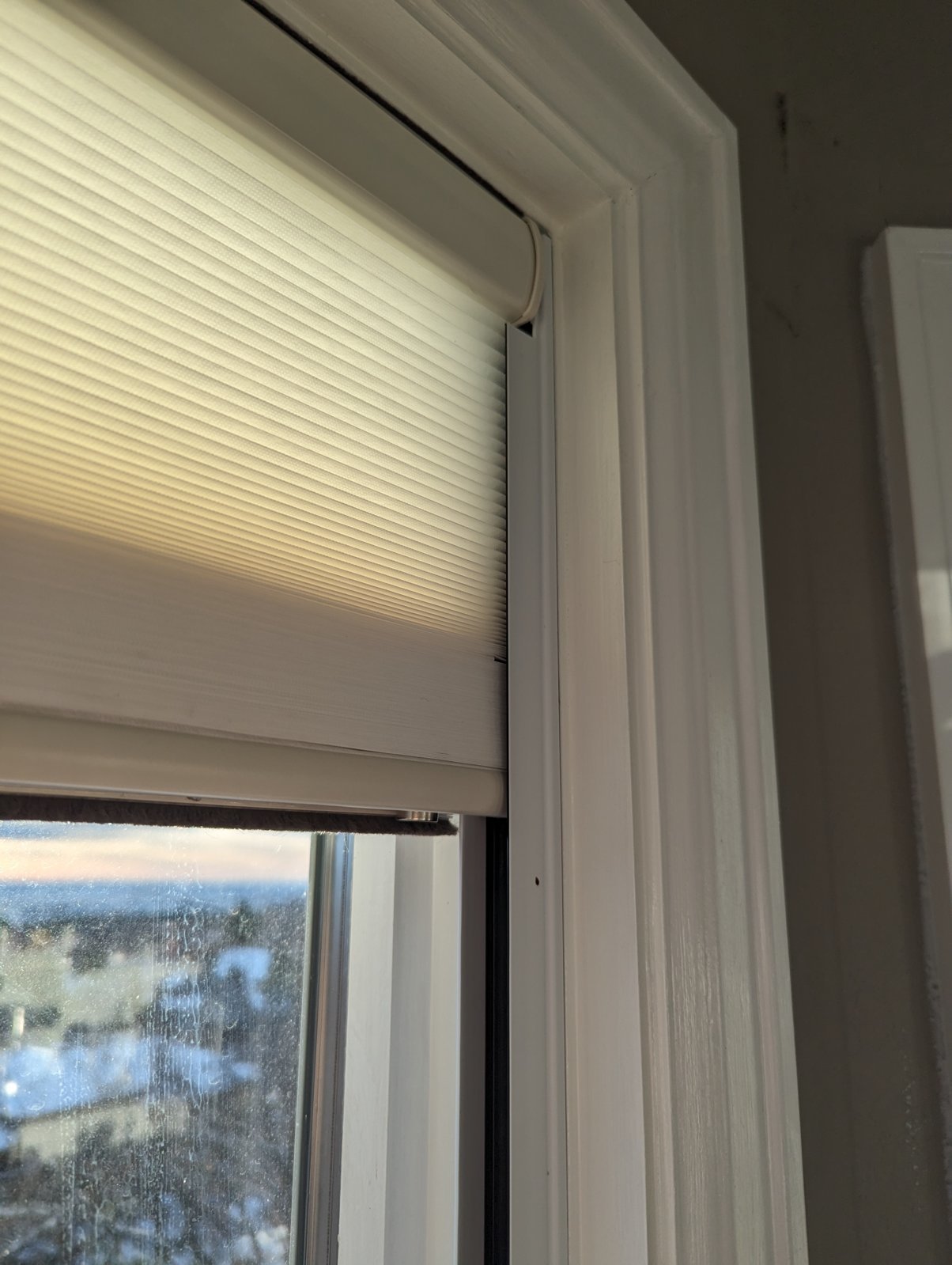

    I have some blinds that have a track on the side. I want to put some new blinds over a sliding glass door but I'm not sure it'll look right. I would be removing the molding and placing a 1" spacer under it.
    Does this sound dumb? The door is in the same room and has the same molding as the window in this picture

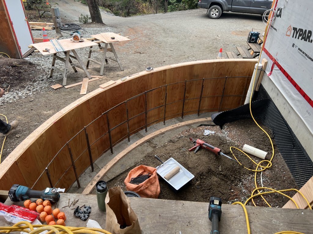

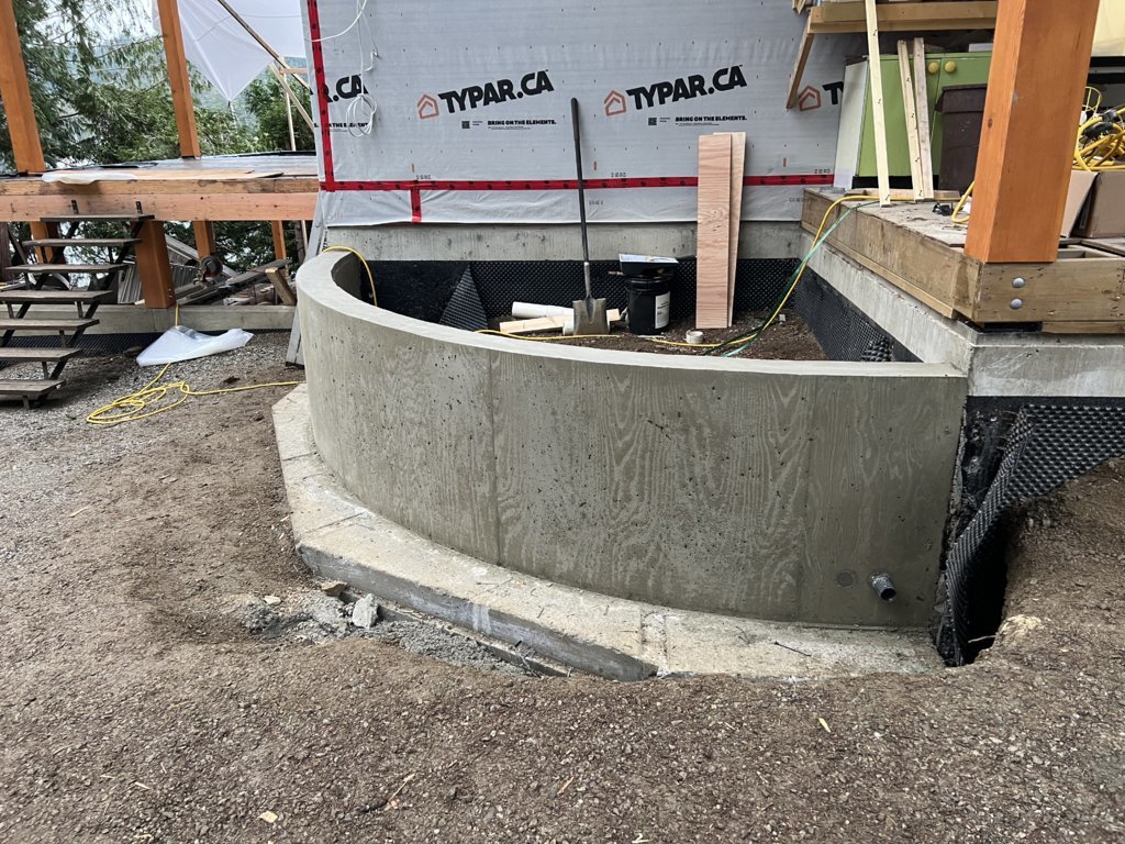

    Fun project we did this week at my current job . A curved concrete retaining wall at the entry that forms a planter . The wall will eventually be clad in stone

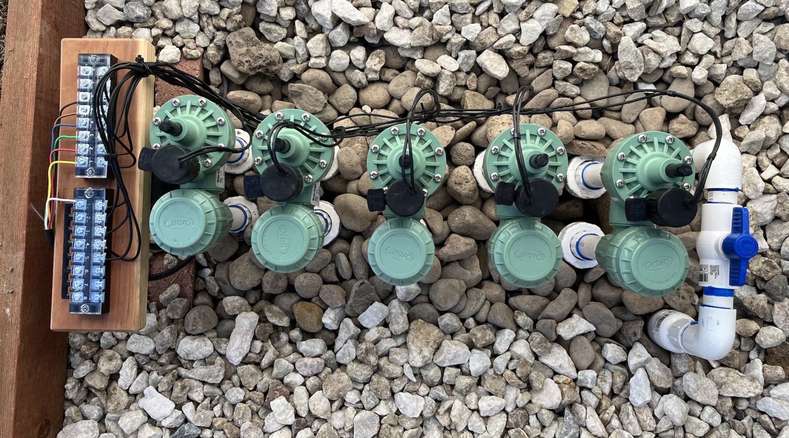

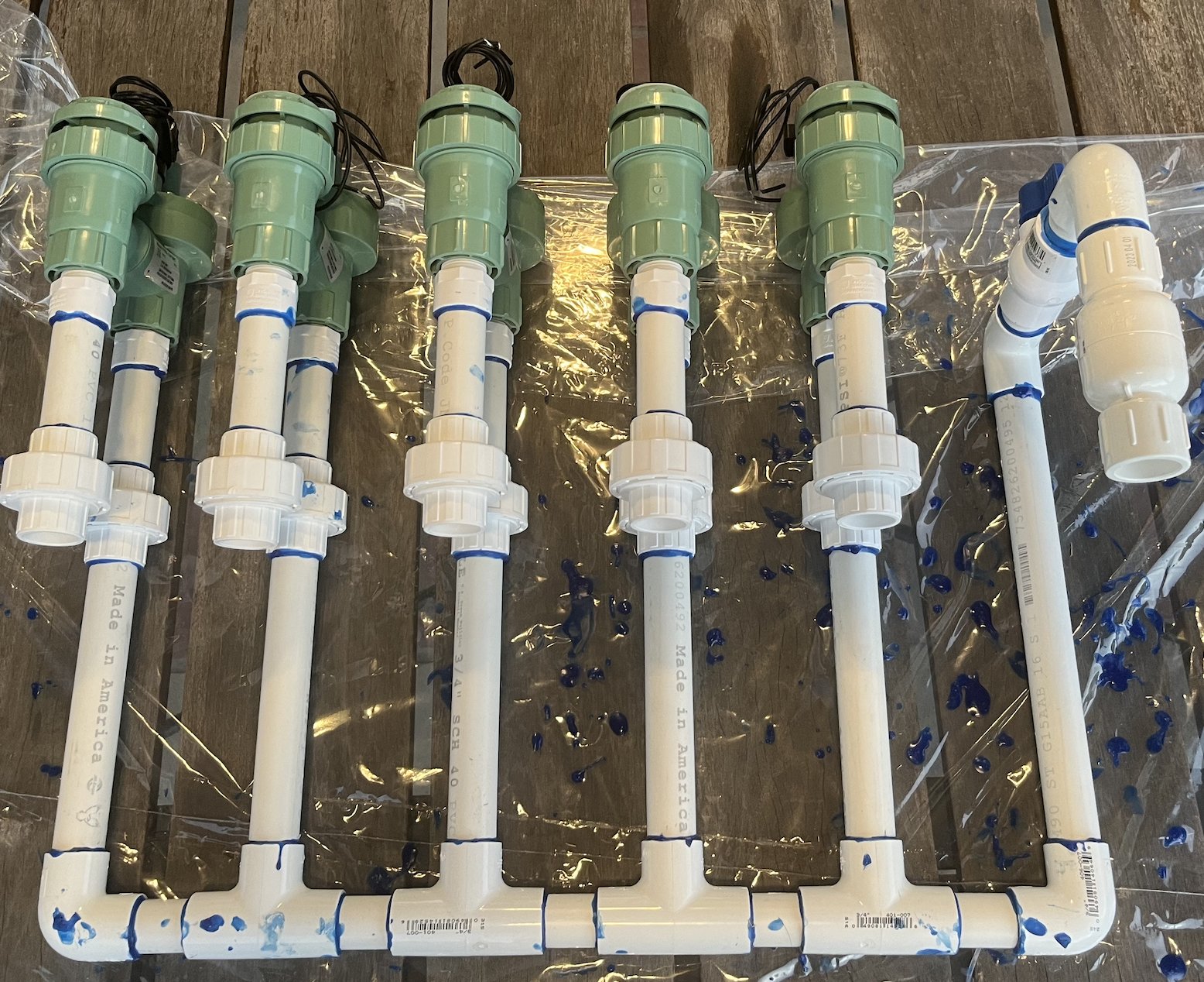

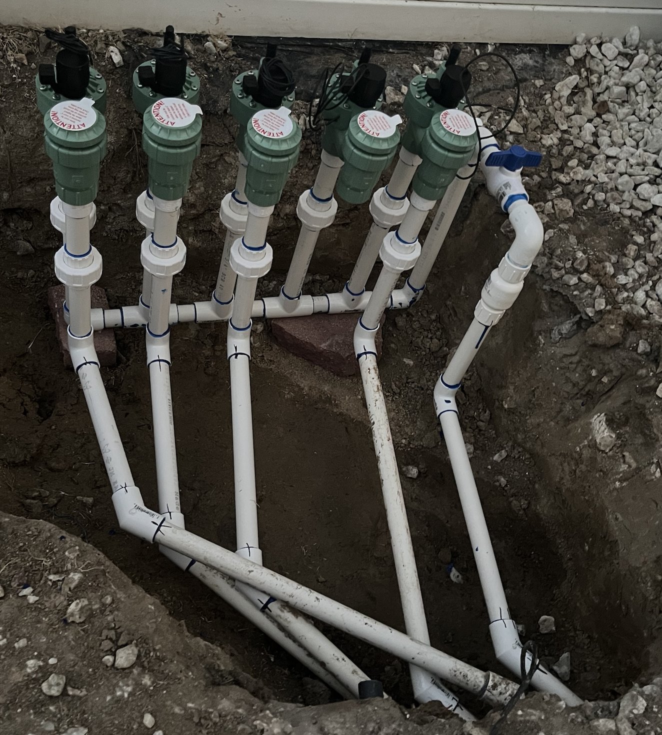

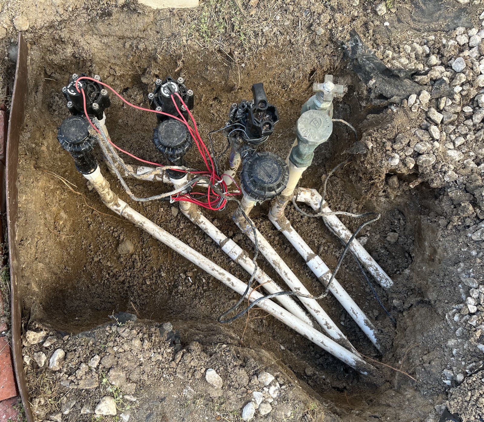

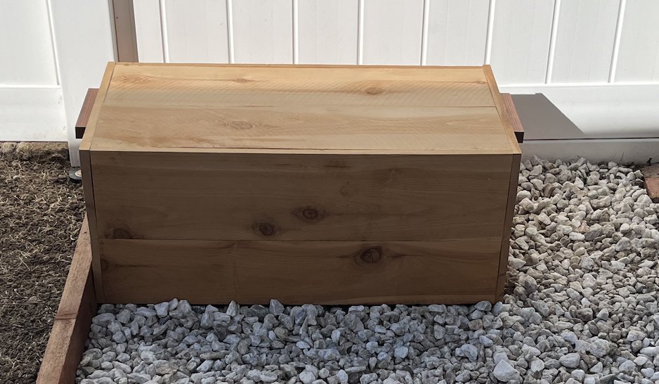

    Sprinkler valve follow up:
    Original
    Improved:
    The originals were leaking around $10 bucks a month of water. Still have another two banks in the front and side yards which aren't leaking as bad, but need to be replaced.

    Nice use of unions.

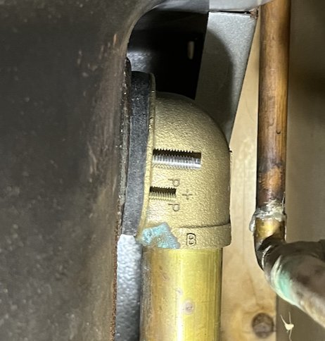

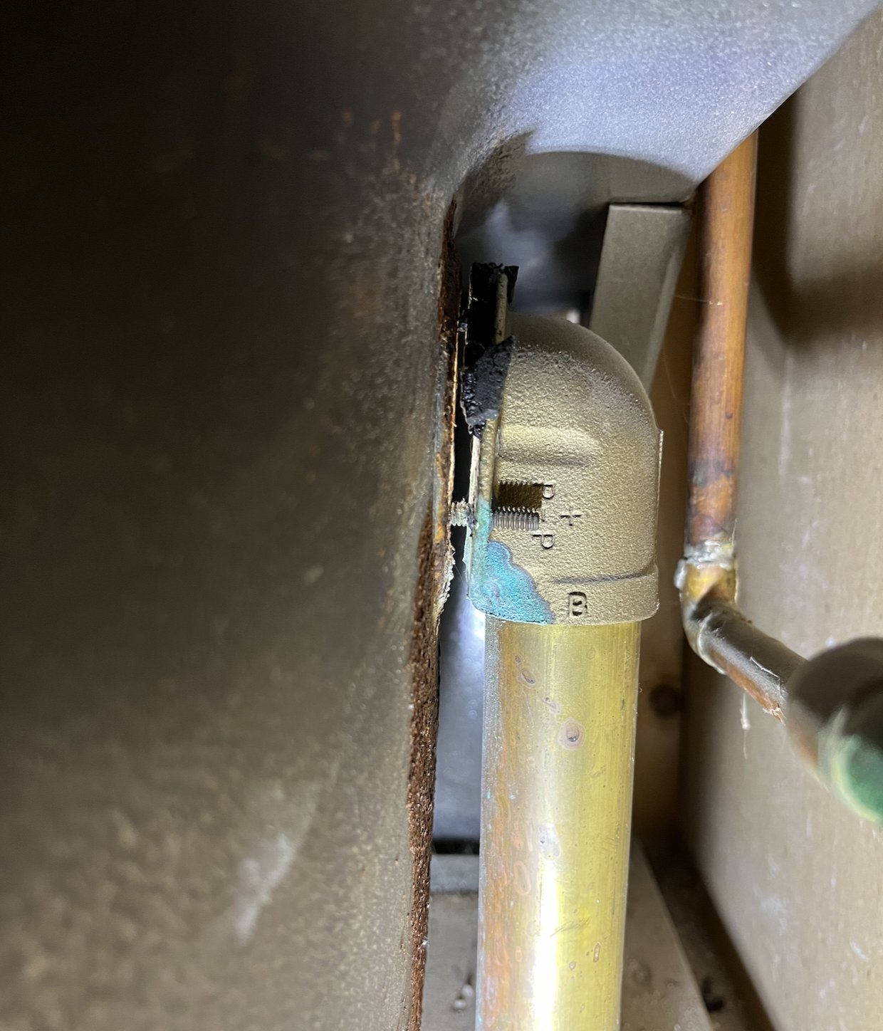

    Bathroom Tub leak, located and fixed:
    Probably the original overflow gasket from 1979. What was left of it was hard as rock, and the lower portion totally missing.
    Luckily I am remodeling the adjacent bathroom and could easily open up more drywall to get at the overflow tube. Pulled the whole thing out and wire wheeled both faces of the overflow, cleaned up all the corroded brass. Had to knock off some old pipe dope and under water epoxy the previous owner (probably) tried to use to fix it.
    That is now on a 5 year replacement schedule.

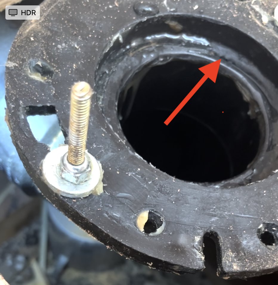

    Toilet leak, found. Not yet fixed
    After a few rounds of "I must have fucked up the wax ring", and pouring loads of water directly down the flange with a funnel, I tried pouring a small amount of water around the edge of the flange were it was joined with the elbow under the floor. Turns out, it was not as joined as it should have been, and water just passes straight through this hole:
    The previous plumber must have just jammed enough wax in there to make it work, and when I came along to clean it up and remove all the old wax, exposed the leak.
    The main issue here (other than the leak) seems to be that the drain line is too high in the sub floor to allow for "normal" elbow fittings to be used. They cobbled together like a 3" spigot x something smaller hub elbow to fit inside of the flange. The elbow being "inside" of the flange has lead to the leak. I found a 3" spigot to 4" hub street elbow that the flange fits inside of instead. I have a 3" reamer to cut and clean out the 90 degree closer to the main drain line- So I should be good to open up a little more sub floor and give myself some room to work and patch everything up.
    Solving bad work sucks.

    It's far from the "correct" fix but would a wax ring like this have done the job?

    A Jumbo wax ring wouldn't have helped. There is a flaw in the way the elbow and flange are glued. Wax could have covered it up, and that's probably how it was before we bought the house... but that was just a bandaid.
    The flange itself was a little messed up as well. It had been raised to accommodate a 1/2" hardie board and tile. We paid a plumber to correct that for us, and all they did was remove the two wood blocks the previous guy wedged under there and called it a day. And the vertical mounting hardware had obviously been over tightened and pulled through the plastic- there were some large washers on the back side... Additionally the sub floor had been cut away in places to try to fix some of this stuff in the past, and never repaired correctly, so the toilet rocked a bit.
    I have sub floor open- just easier to replace it, sure up the sub floor around it, and solve all the problems.
