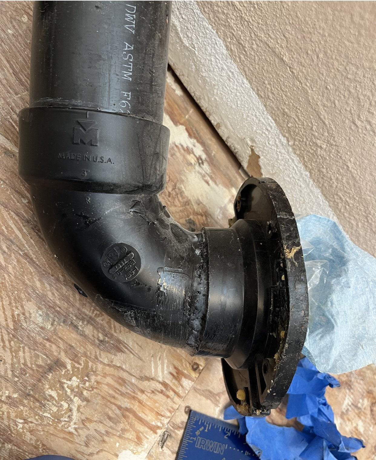

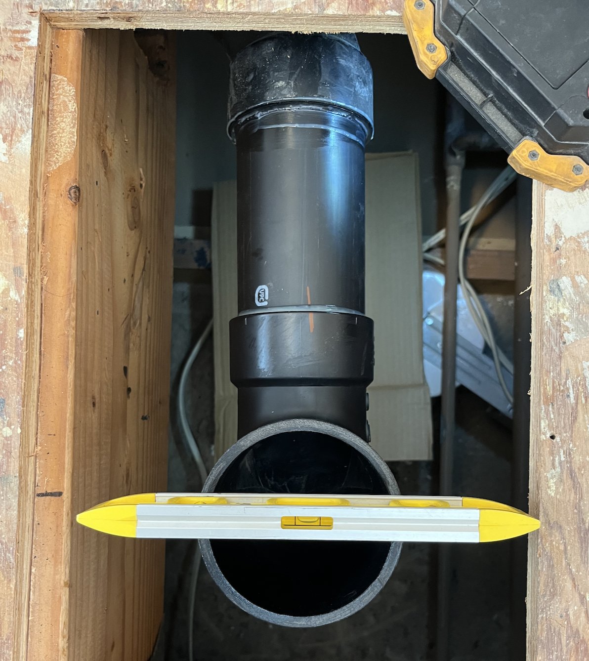

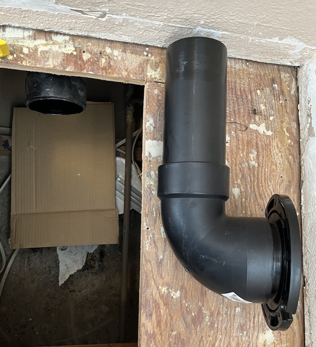

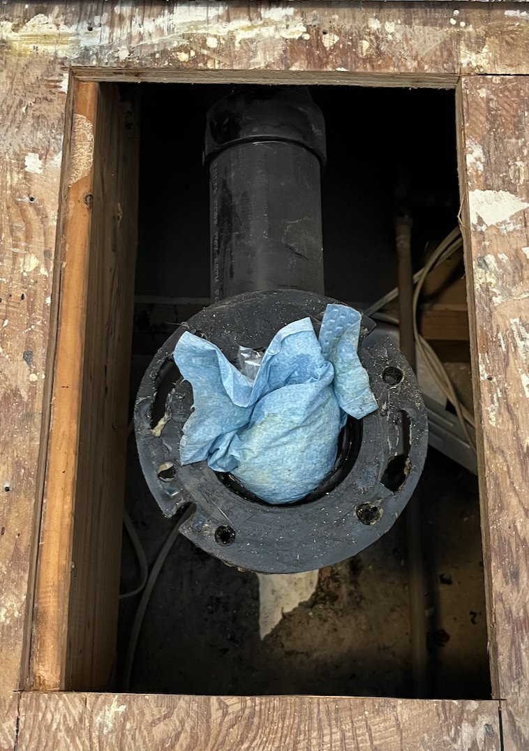

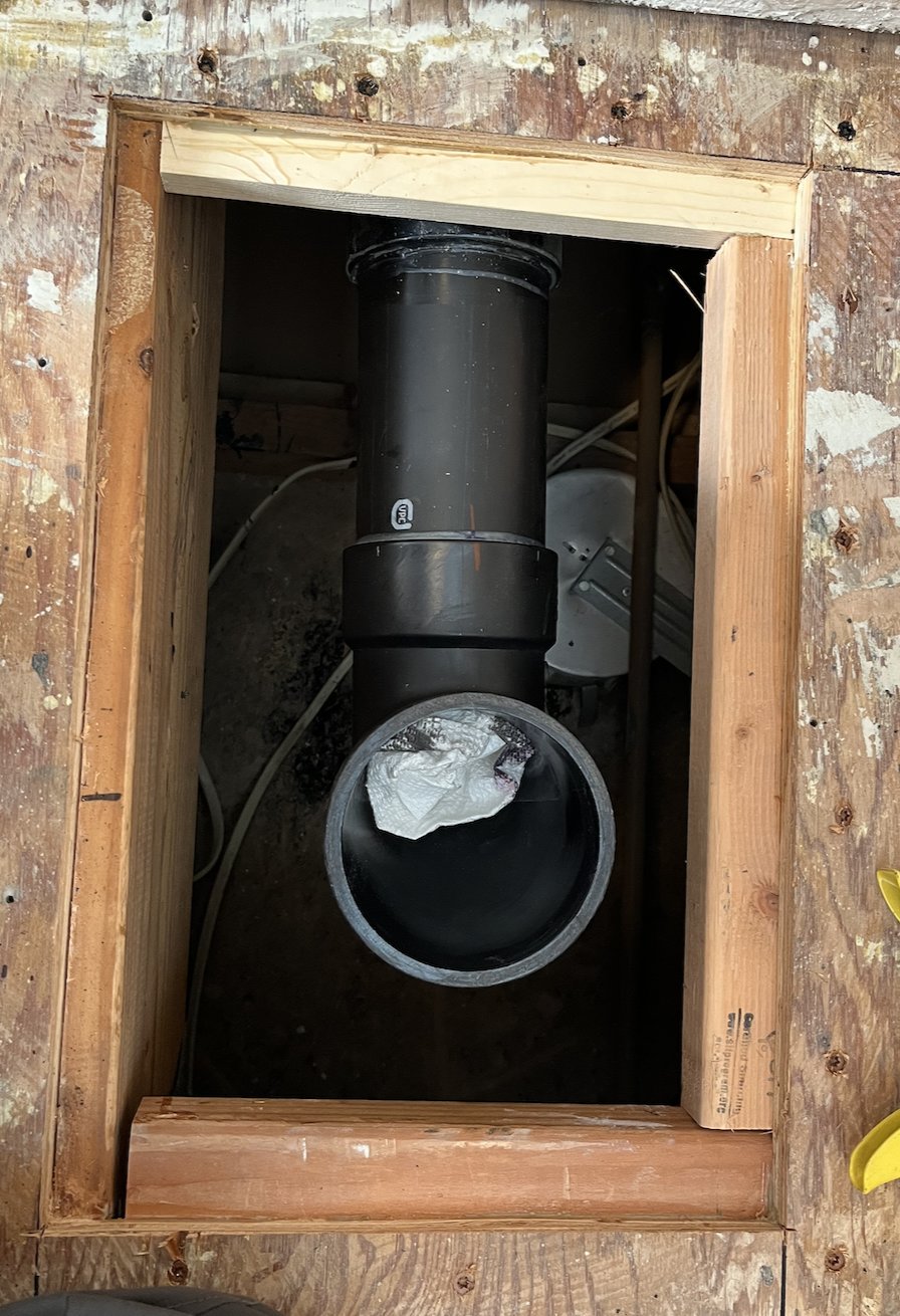

    Flange Leak, Fixed.
    My hunch was correct- the drain line is too close to the sub floor to fit "normal" elbows. The previous plumber pulled some shenangains to make it work, and did a shit job glueing it.
    I had to trim and modify the parts I got as well to fit within the space constraint, but I did it in a mo-betta, less leak prone fashion.
    Reamed the elbow at the top of the picture, fit new 3" drain to 3" => 4" elbow + 3/4" flange.
    Original:
    3" elbow to ??? fit on the INSIDE of the flange...

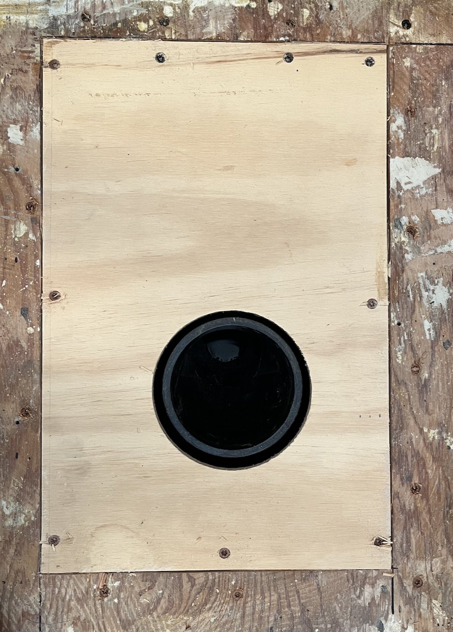

    New assembly:
    Nice and level
    Gotta put the LPV back down and reinstall the toilet in the morning.
    No Leaks, sub floor is sound.
