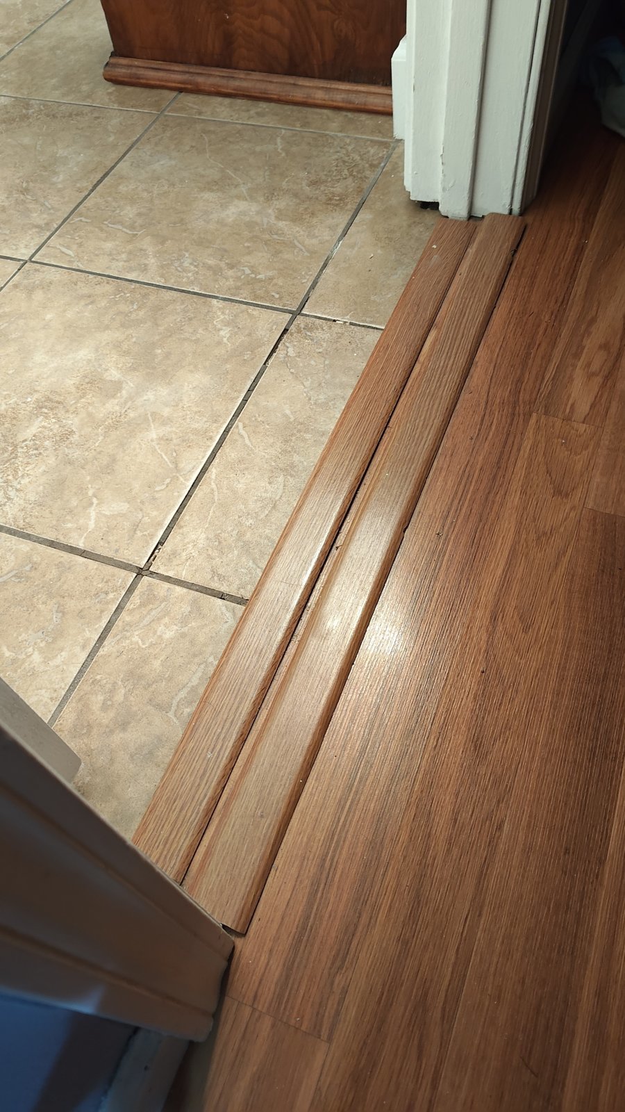

    Assuming this is going into a bathroom the 2 transition pieces hiding an older floor and a newer one both transitions are probably print over MDF, prying them up may break them, there seems to be no nails so there is a receiver track holding them in place. A threshold similar to What soundman98 said may have to be made and finished the transitions are a low and a high profile ones it looks like it could be done with a table saw to adjust the lights and width I'm not sure what floor was laid first but the guy who did it probably didn't know how the first transition was attached. You should be able to come up with something custom. Several years ago I had to make a 7 1/2'' transition for a basement door into a creepy quiet room that had a sound proof retractable sweep in an acoustical door that covered some floor and carpet issues.

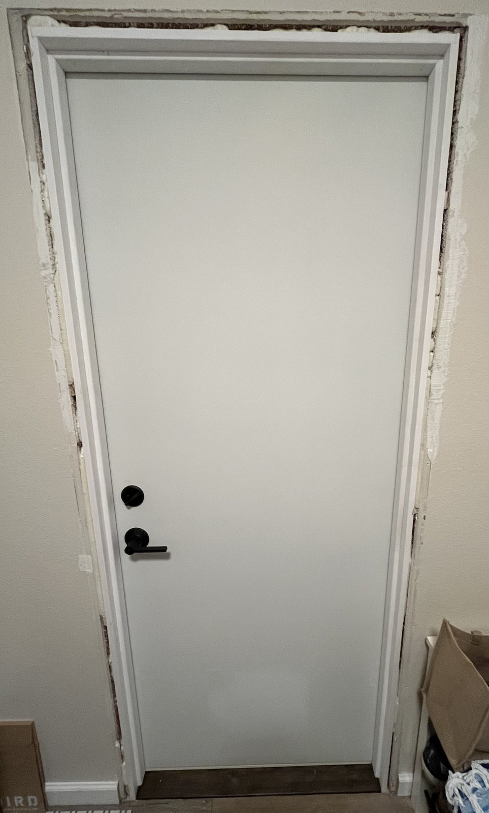

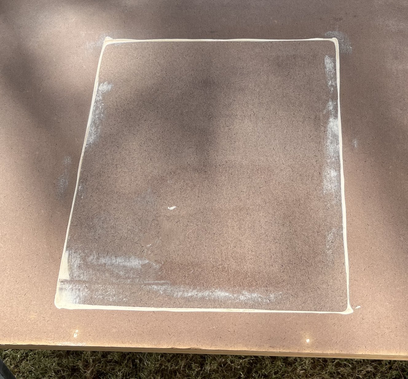

    33467 follow up.
    Amongst all the other projects I also got the door ready for final paint over the weekend.
    final patch:

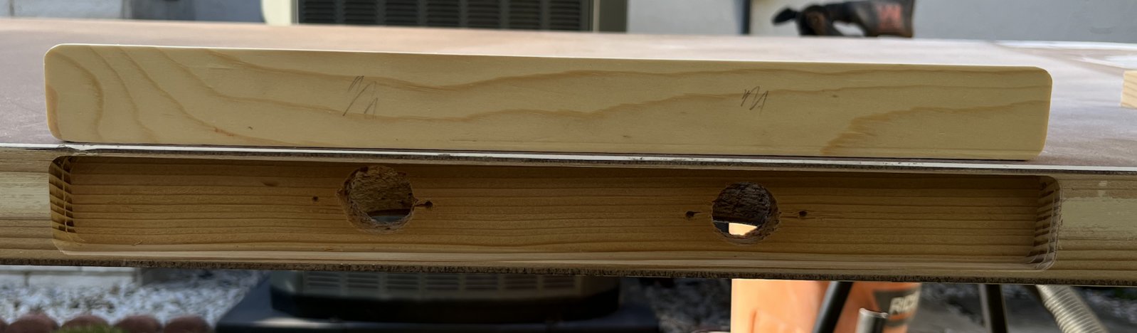

    Also routed out the existing latch mortises cause they were poorly done, and didn't match the shape of the new hardware:
    Ended up springing for a new door jam kit and stops. The patch is visible through the primer, but I am pretty sure the finished paint will cover it completely.

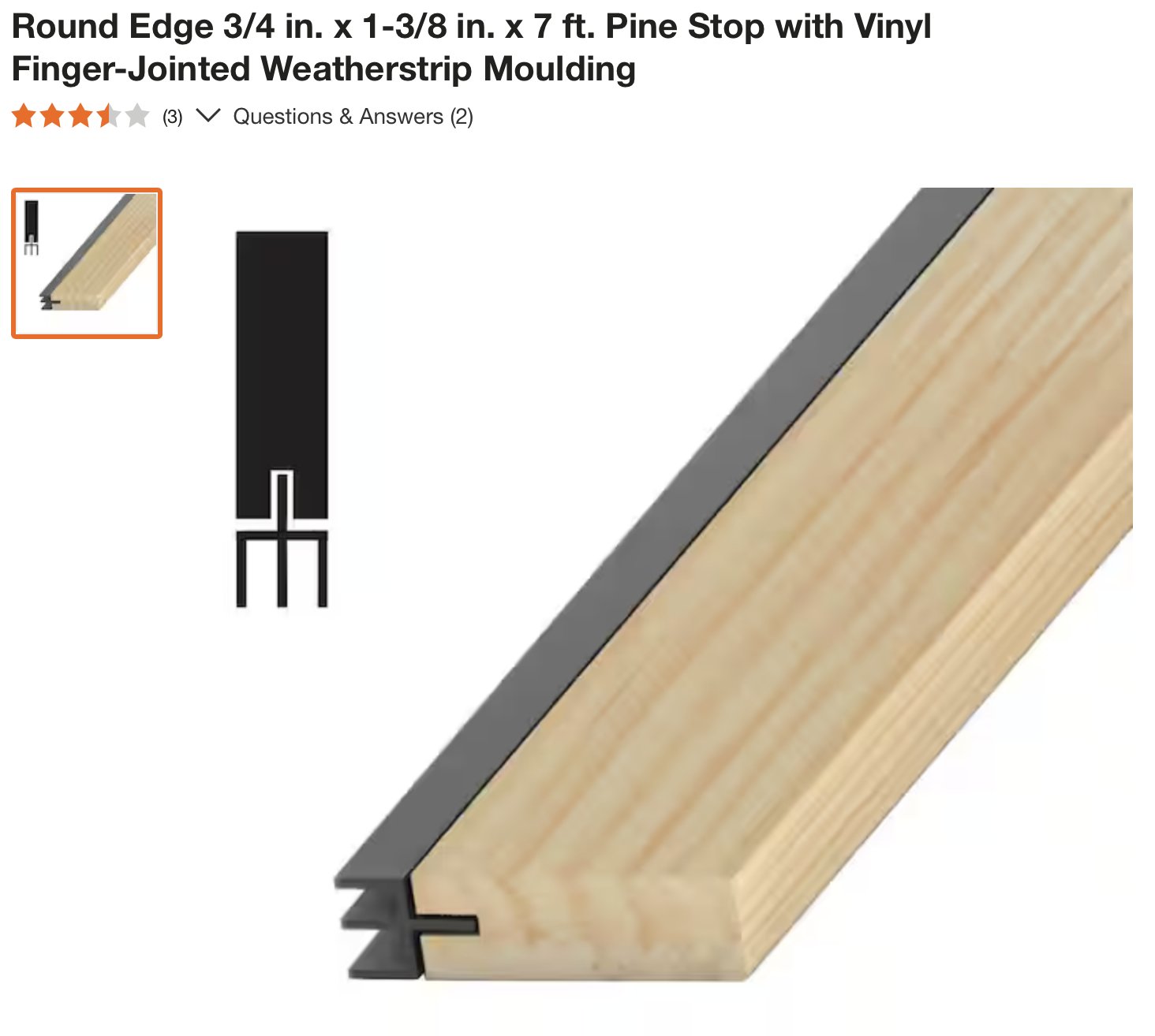

    As a follow up to the weather striping situation, I eventually found what I was looking for. It's actually pre installed in the door stops @ Home Depot.
    Product description is incorrect, it's 1/2"...
    Gotta get the boss to figure out what trim she wants. Probably more modern, and then I'll have to do the whole house... I installed the new jambs as flush as I could to the interior drywall, but the drywall is anything but consistent along it's edge... so not really sure how to address that.. they previously just filled the gaps with caulk.

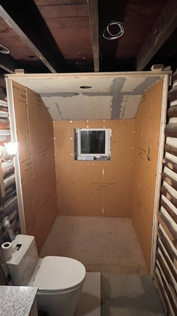

    Bathroom progressing nicely....got up the Schluter Kerdi board walls. then pan and tile. Making round walls flat is not easy.

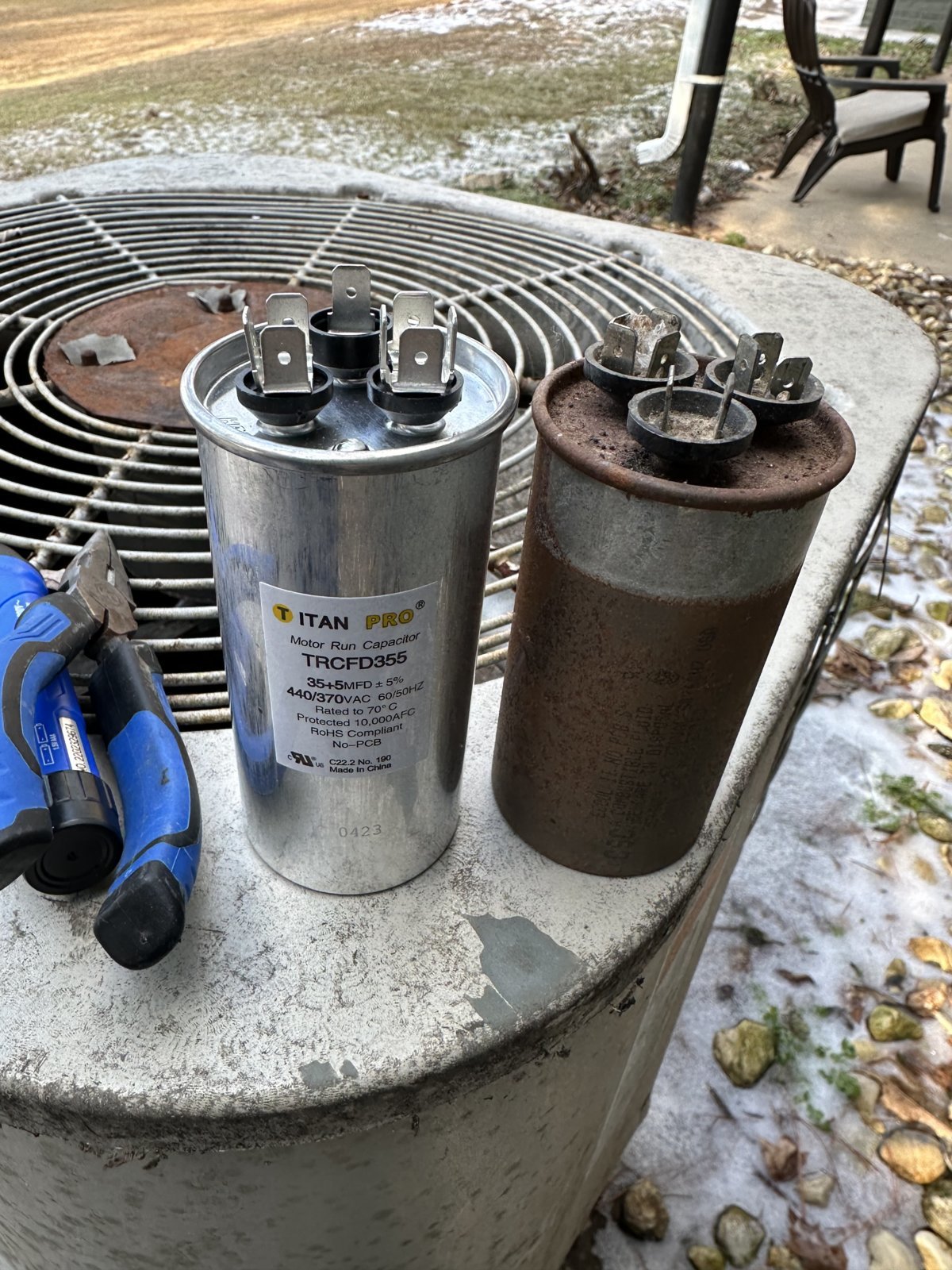

    Idk if this counts as home improvement but changed out the capacitor on my basement heat pump. Can’t read a single label on this unit but it’s easily 15+ years old
