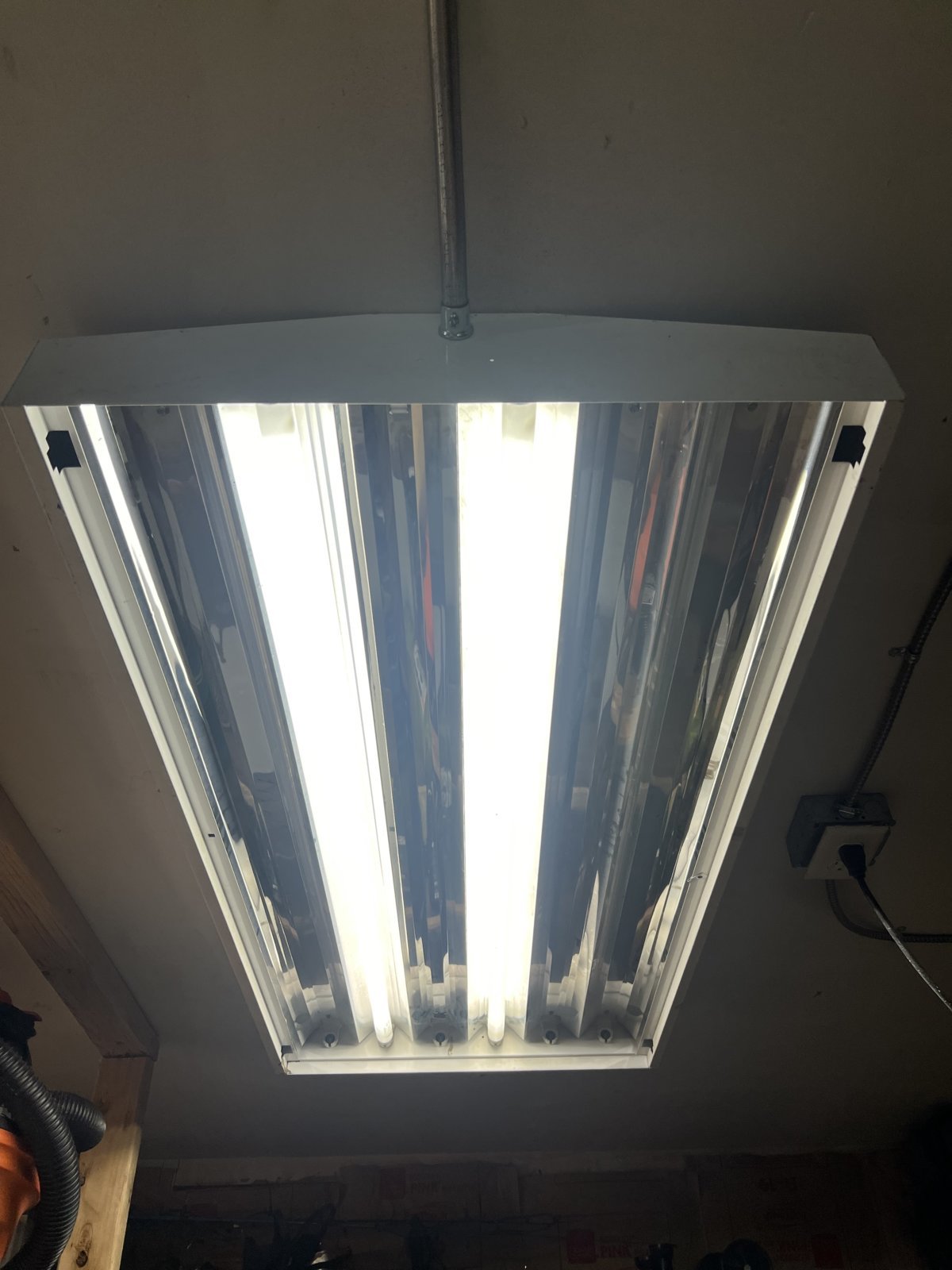

    I have a five light florescent overhead garage light that takes 4ft florescent bulbs. I thought three of the bulbs had just burnt out so I picked up a few more. When I installed the new bulb nothing happened. I checked in a working section of the fixture and the new bulbs are fine. Anyone know why the three other bulb spots wouldn’t be working but the other two are? I really just wanted it to be a replace the bulb fix and not some involved PITA. Any suggestions?

    would a bad ballast be independent to each slot? Like why are two working and three aren’t.

  7. Jan 20, 2024 at 8:15 PM

    When I worked for an electrical engineer, for office lighting (before LEDs) we'd specify a fixture with three lamps in it with a single lamp ballast and a two lamp ballast so they could decide if they wanted one, two or all three lights on. So yes, you could have some lamps working and others not if there are multiple ballasts.

    Pic would be helpful, some have 2 ballasts in them

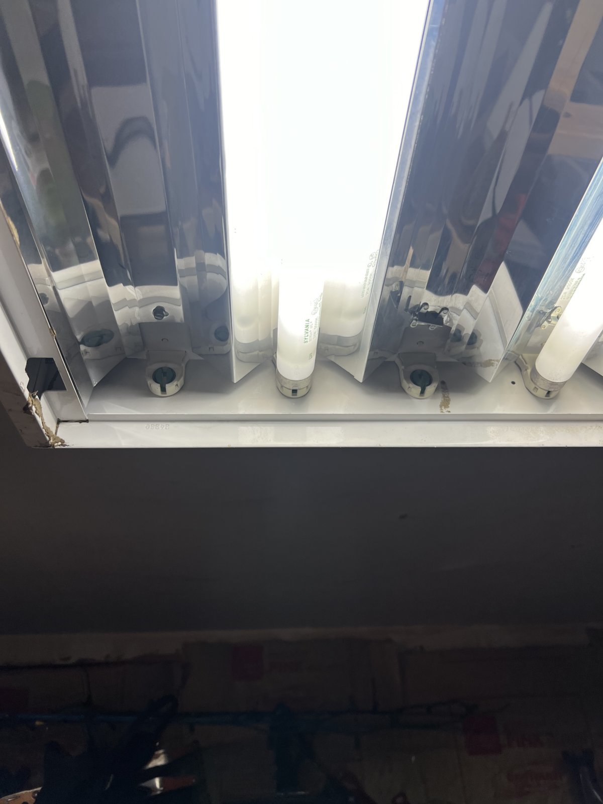

    Kinda have to take the reflective covers off and see how many ballasts you have and which lights run to which ballast. Or replace them with the leds.
    Sometimes its the contacts in the ends not making good connection, can wiggle the light and see if it comes on. But usually its ballasts

    5-bulb fixtures almost always have 2 separate ballasts.
    they make a 6-bulb ballast, but most mfg's, above 3-lamp units almost always use 2 separate ballasts, to allow more end-user customization, as well as some failsafe operation.
