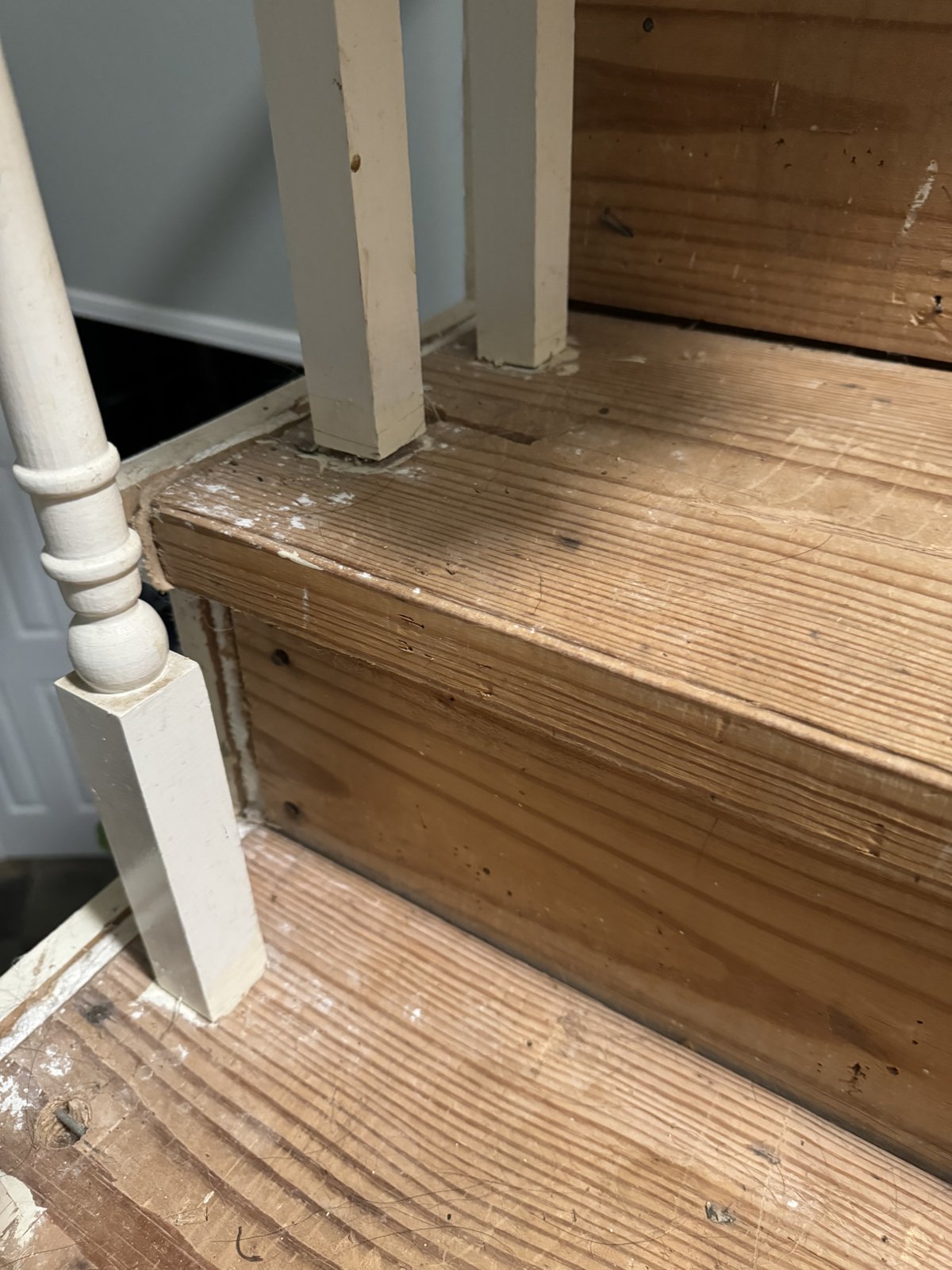

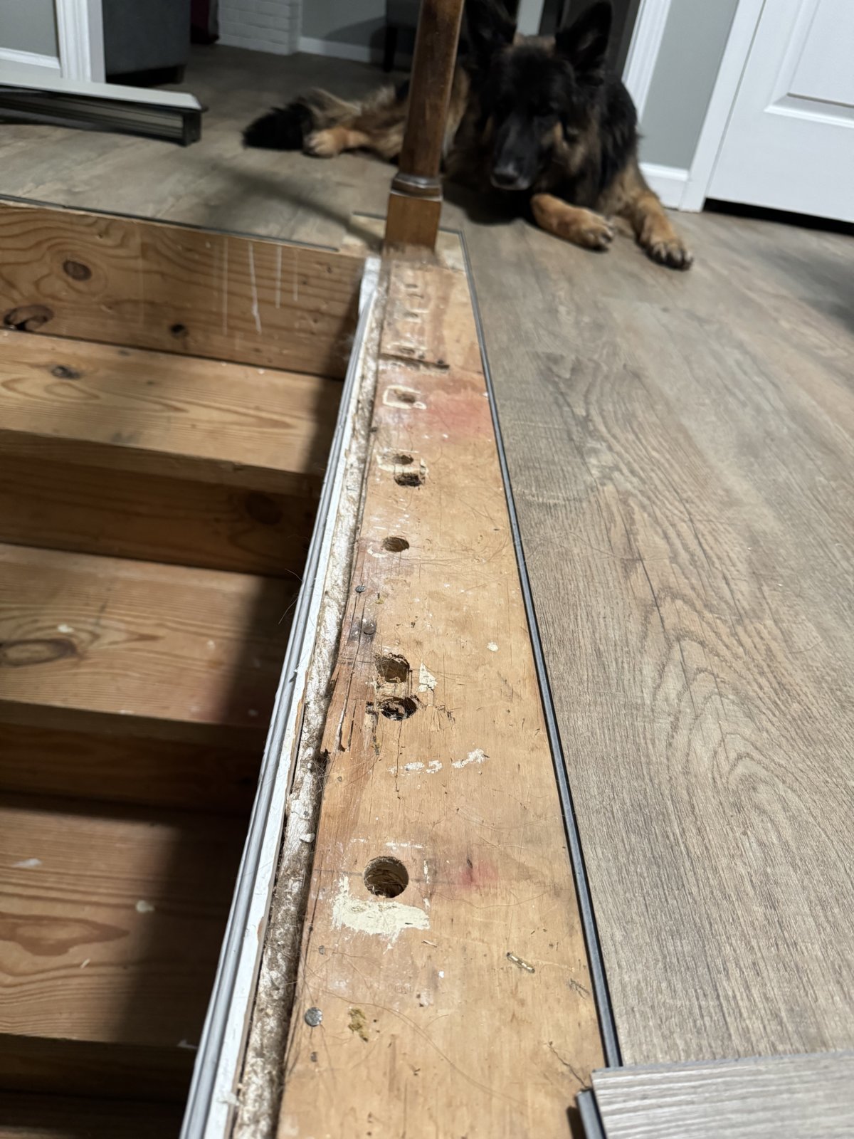

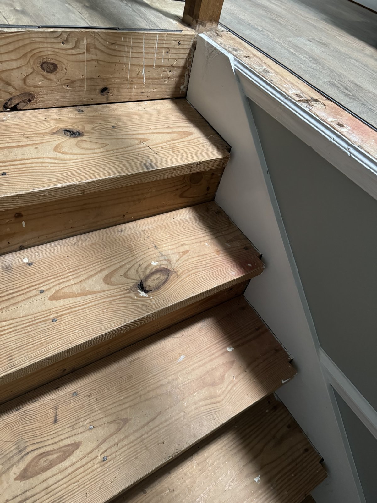

    So looking for advice, mostly wanting a retro fit kit if anyone knows of something easy. There used to be carpet here. I’m at a loss of how to do the edges on the stairs as the white board doesn’t go higher than the stairs.
    I’m going to remove the handrails, but not until i have a plan in place for safety.
    The top part above the stairs I was thinking just run the floor all the way to the edge as it sticks up above the subfloor. Of course filling the holes and leveling it out first.

    what floor covering is planned to go onto the stair treads? thickness?

    Looks like you've got LVP in that last picture. Does your LVP manufacturer have bull nose pieces? I can get you a picture of what I did- but basically, bull nose with a piece of lvp with the backing foam removed glued to the tread. I mitered the bull nose to wrap around the exposed edge of the tread. Looks nice. It was a PITA to do, but as I was installing my own flooring, I could take the time to do it. For the risers, I went with 1/8" ply primed and painted to match the base boards, glued and brad nailed in place (before the treads).
    My railing (currently in the build process) only interfaces with the flooring on the vertical posts, I don't have those intermediate spindles running into each tread.

    The floor I’ve been using is Mohawk LVP from Costco when it went on sale for $35 a box. My stairs treads don’t have to match the floor, but I’d like it to at least compliment.
    I see videos of people doing LVP on stairs, but it’s always with a wall on both sides, my biggest issue isn’t the bull nose or the riser, it’s that exposed edge in the first pic.
    Yes I bought the bull nose for the LVP. I would like a photo of what you did, but I need examples of that exposed side like in the first pic. I’m scratching my head on that one.

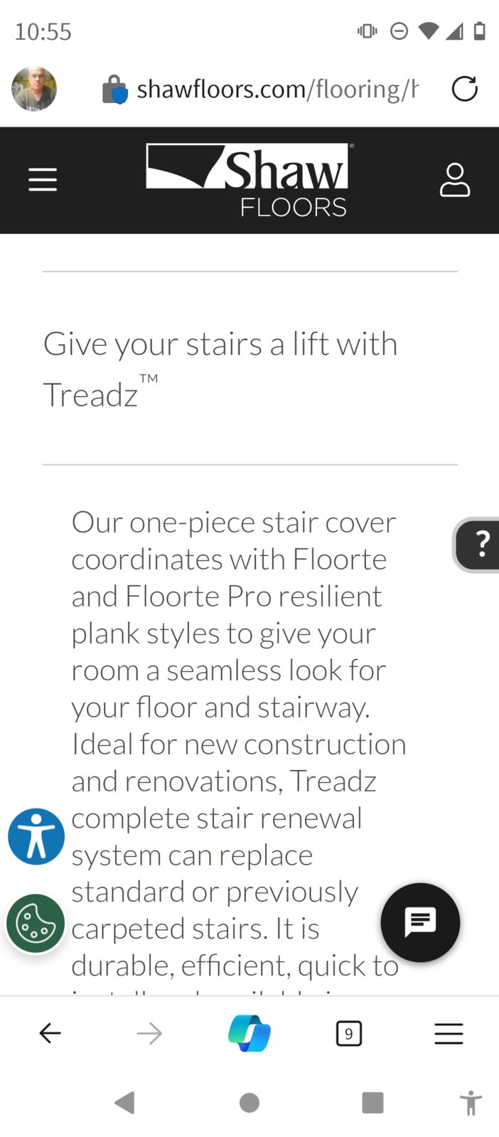

    Check this out

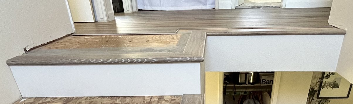

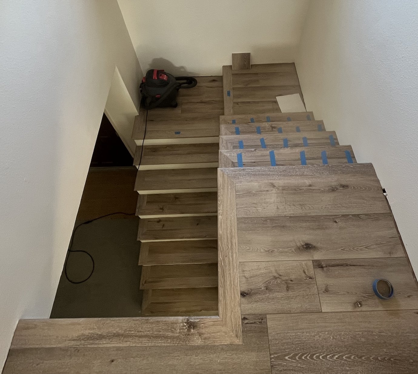

    I am not saying it's the right way to do it, and I would change the way I did things slightly, but overall it worked out, and it looks much better than other LVP stair installs I've seen.
    The LVP is NexxaCore, Everest, although I think this color is already out of production.

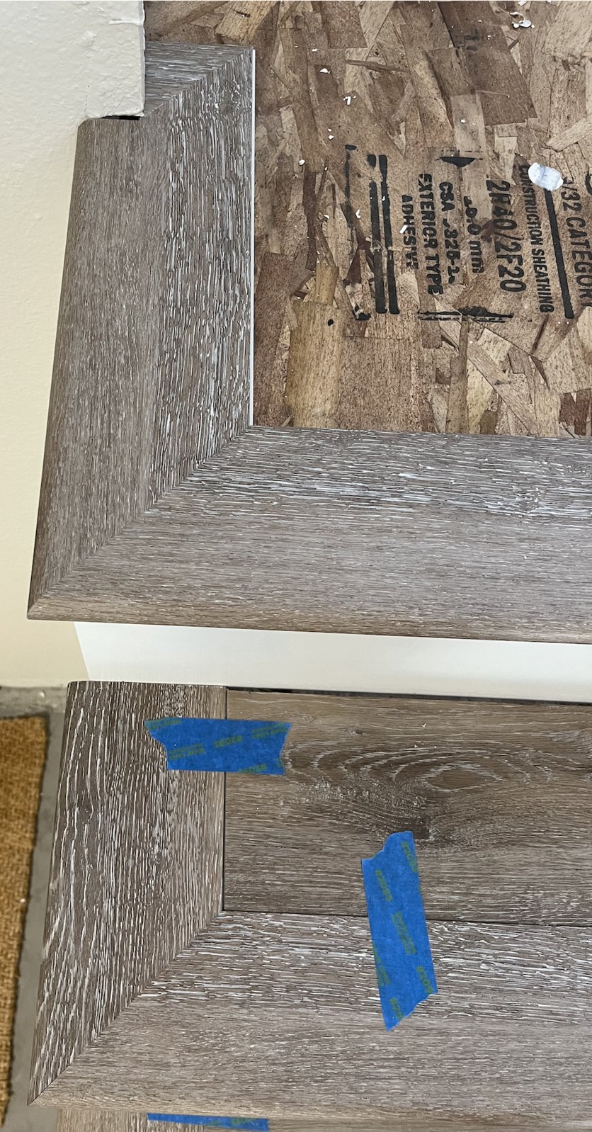

    Here are some detail photos:
    Doing these miters can be a pain if you haven't done something like that before. Just make sure you cut long and walk the cuts into the dimension you need. The miters were cut, taped together upside-down on the flat surface, and then I used Medium CA glue to glue them together.
    You can see a small gap between the tread filler (this was just an LVP plank with the foam backer removed), and riser, I just caulked that when done. My bull nose didn't lock into the normal lvp locking system, but it did have a groove for the tongue, so I glued them with loctite clear super grip or something along those lines.

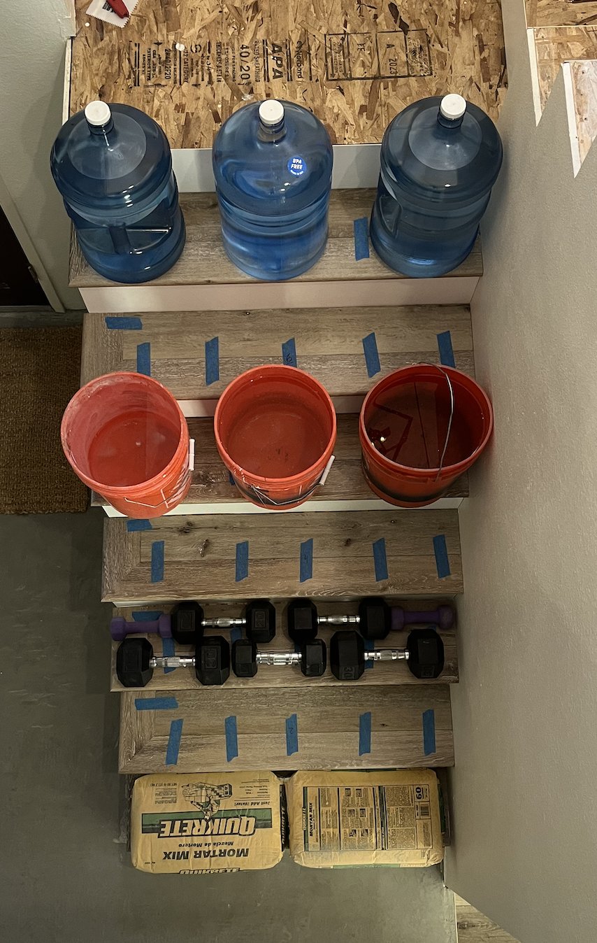

    Once the whole tread was assembled and glued together I spread loctite construction adhesive on the back with a small notched spreader, put the treads in place, and set whatever I could find for weight on them. 5 gallon water bottles, weights, 60lbs bags of concrete, etc...
    I glued every other stair as I was still using them during this time. Let them cure for a few hours before doing the next set.
    Lets just say, I hope I am not the person who has to pull those off in the future.
    Now for the top edge- I used the bull nose again, and just carried it around:
    I very carefully cut the LVP, and in some cases had to create tongues with a router to fit into the bull nose.

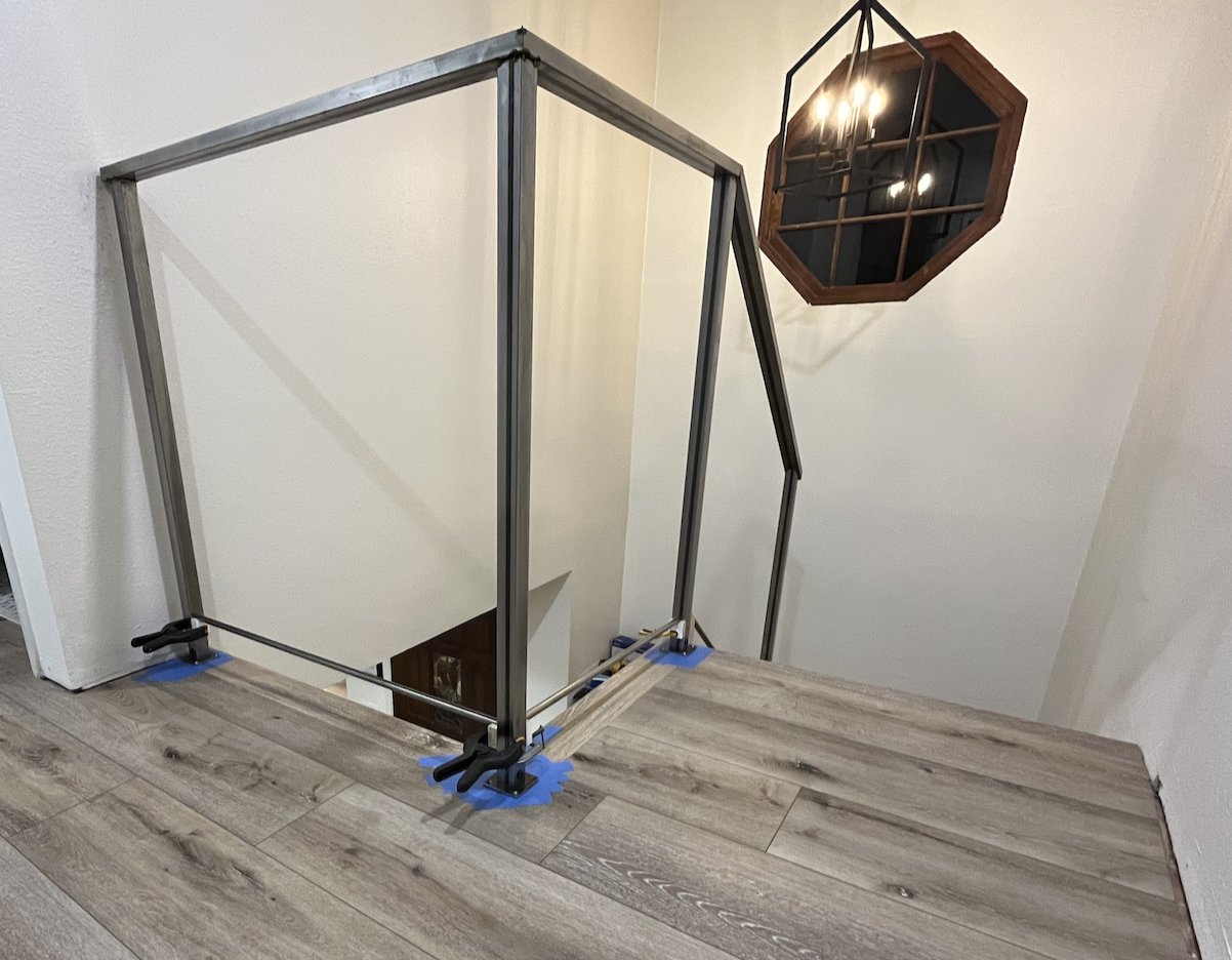

    And this is currently how the handrail is going:
    Just gotta tack weld those bottom pieces in, and then I'll take the whole section to the garage to finish weld and install the remaining horizontal bits.
