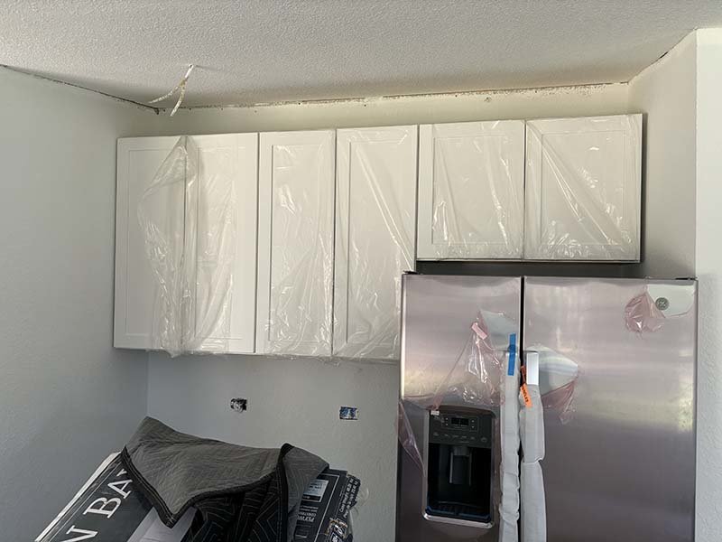

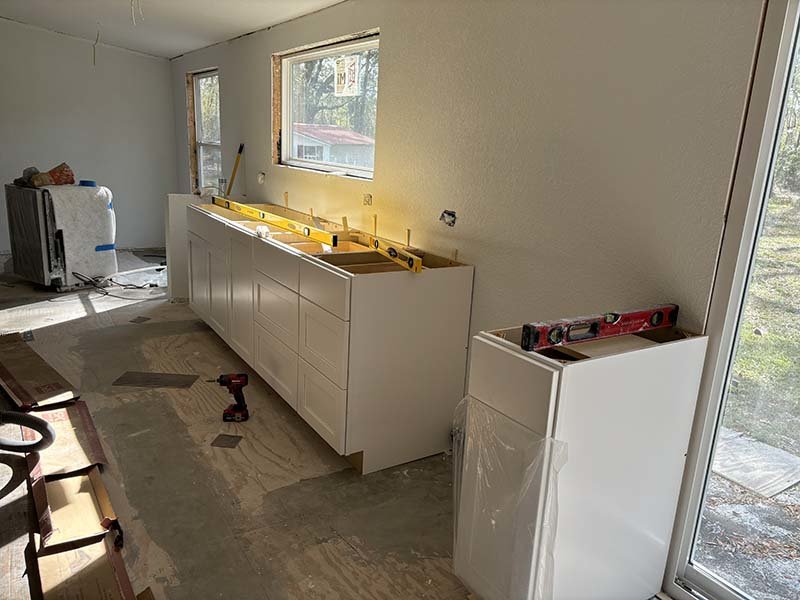

    IMG_0061.jpgGlad to find this thread. Rebuilding a DW mobile home that was abandoned and rotted out.
    About 80% done and going on 2 years. Hung some plywood cabinets last night.
    The other side of that galley is this. I had a friend install these on Sunday. I assembled them but he has experience in doing this kinda stuff.
    I'm learning the add pics and edits...apologies.
