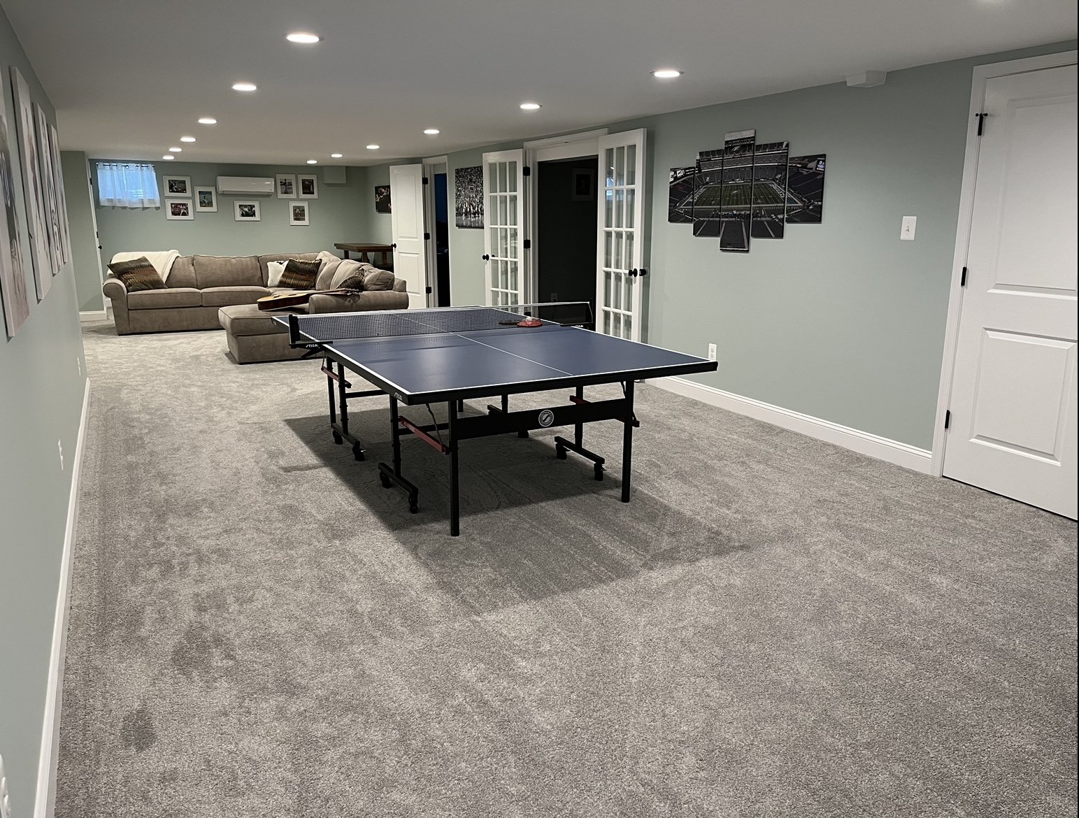

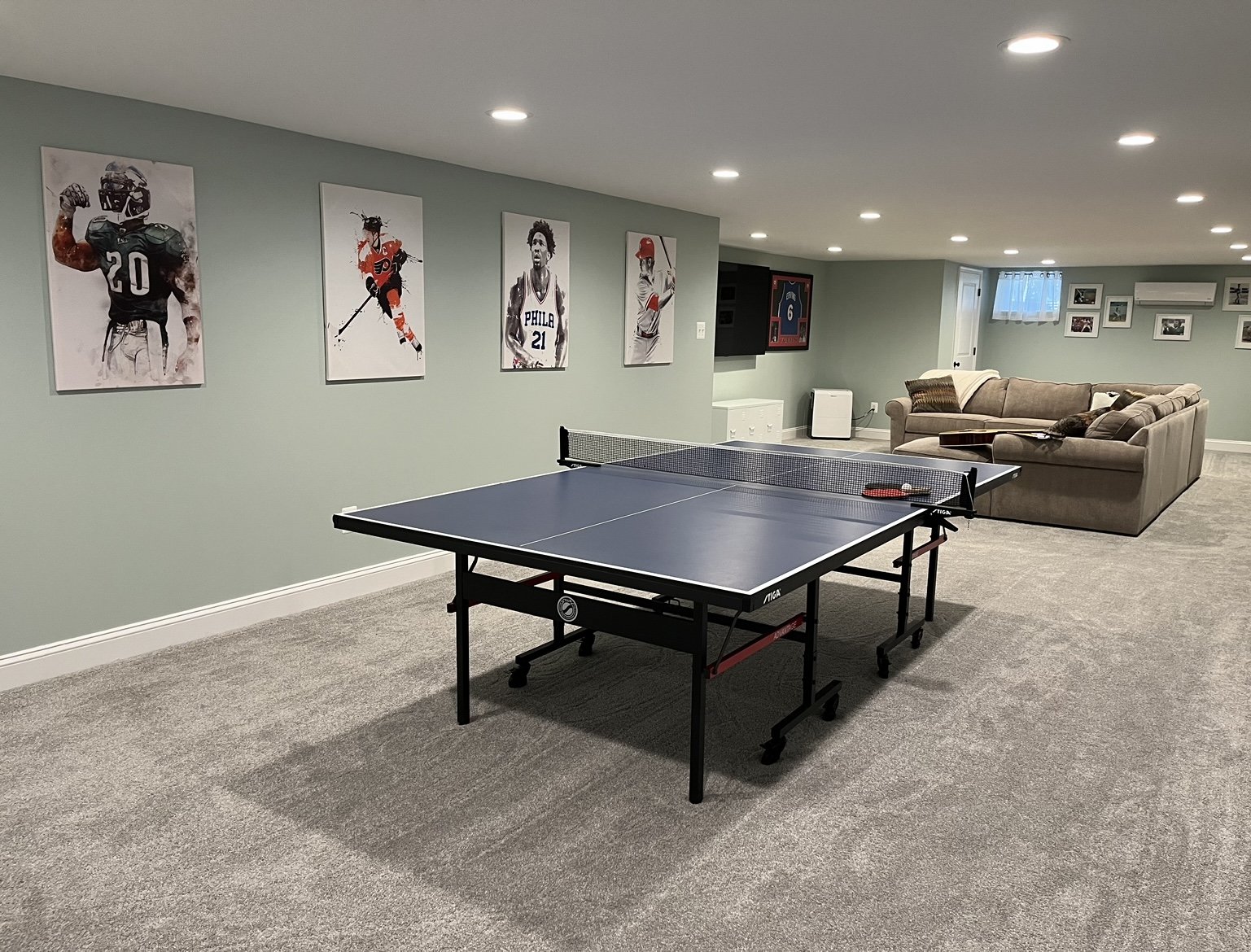

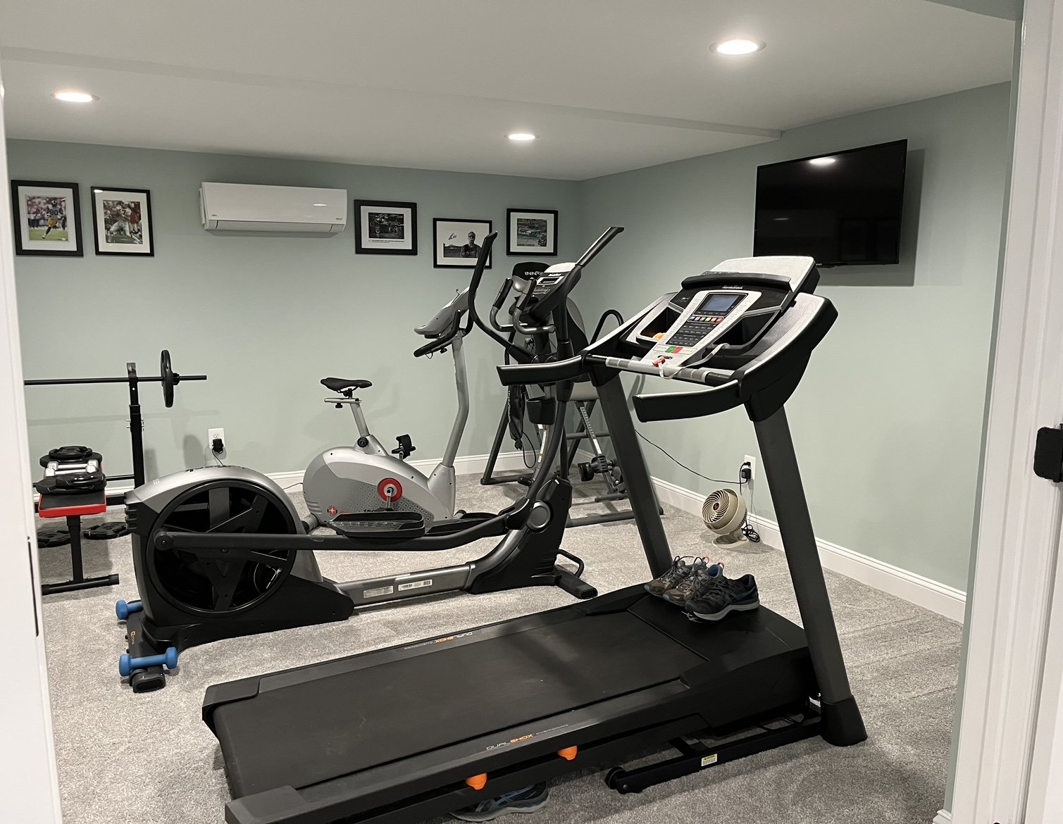

    We finished about 1,300 square feet of our basement two years ago and installed three Fujitsu mini splits in the family room (put a larger one in this room), son’s bedroom, and workout room. They have worked like a champ and are extremely energy efficient. We also placed a dehumidifier in the family room down there and have it drained into our sump pump pit. I wouldn’t change a thing if I had it to do over again. Here are a few pics for reference.
