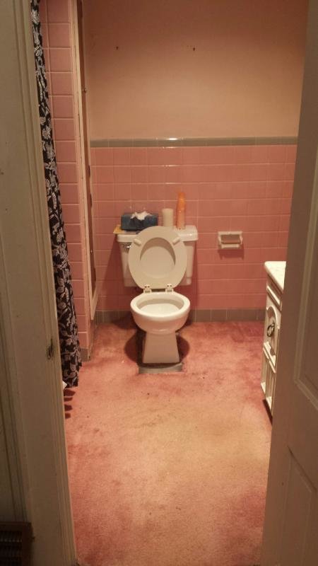

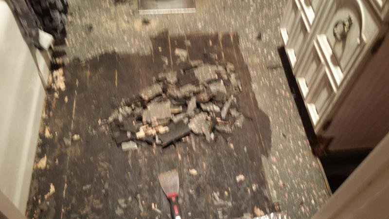

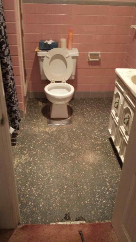

    Just got an old farmhouse that has been in my family since about 1920 maybe earlier. It is so old that part of the foundation is actual rocks cemented together. I am going to be updating the place very slowly and on a very tight budget doing just about everything on my own. Tonight I started on the bathroom which had pink carpet in it and then that very ugly black tile with pink, blue, and green spackle all over it underneath the carpet. After taking about 4 hours to rip everything up, it is ready for a new floor. I have decide to do a laminate wood floor (floating). I know tile is normally the best thing to use but... I am on a budget so this will have to do for now. Its better than pink carpet. I also have pink tiling the goes halfway up all 4 walls in there so that will get a tub/tile paint.
    Here are a few pictures of tonight's progress. Also, please feel free to offer any input/ tips/ tricks! This is my first major home improvement project.
    Tomorrow will be underlayment and the flooring

    Definitely get a respirator

    That underlayment looks like it may have asbestos. Hope you took safety precautions.

    thanks guys! Definitely got a respirator! Its going to be a lot of work but will looks nice in the long run.
    Kolunatic- there actually wasn't an underlayment. The black stuff was old laminated tile. I took trim off and got all the way down to original wood floor but didn't find any noticeable mold or asbestos. Other parts of the house might be a different story though. I will be taking down some walls to replace so only time will tell. :rolleyes:
    PkTaco- I looked at tile but just couldn't afford to do it at this time. I might pull the laminate up later down the road when I have the funds to do a nice tile in there but for now, my main focus was to get the old carpet out and put something halfway decent down.

    What size were those tiles? 9"x9" tiles are almost always asbestos containing. And a respirator should be fitted by a professional. Dust masks and such don't filter down far enough. Best advice is to wet the tiles down with some water while you're taking it up. Keeps dust down and lowers the risk of the fibers becoming friable or airborne. Best idea would have been to let it there and go over it.

    they were 6x6 tiles. I bought the 3m 6000 series respirator that has asbestos/ mold filters on it. it cost about $40. not a bad idea to wet them down though. ll remember that next time.

    Looks like some old wood flooring under there! Maybe 3 1/4" fir? Kinda hard to tell. Being a hardwood floooring specialist i see this type of thing all the time. Lately ive been turning these nasty jobs down but if youre up for the task you could make those floors look beautiful. Just gotta rent some sanding equipment and dedicate a weekend to it. Good luck whatever you do!
