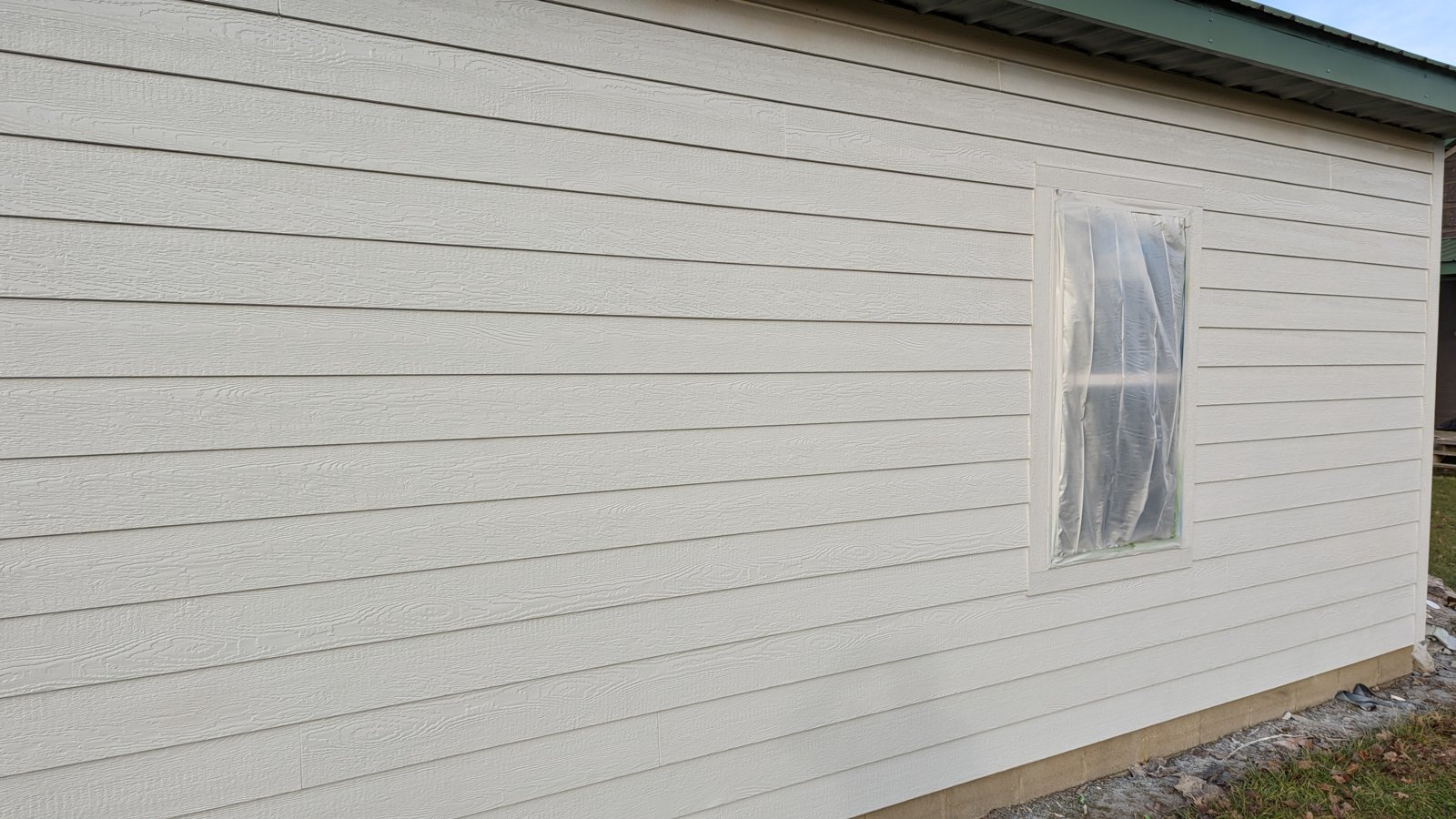

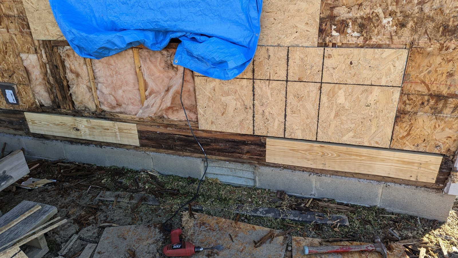

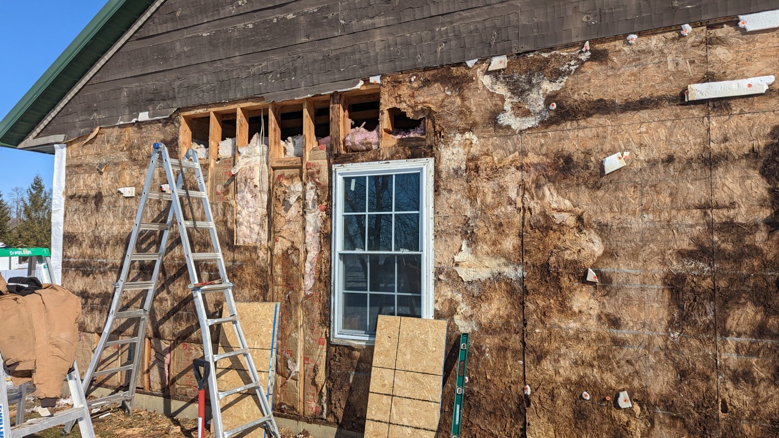

    The wife and I had bought a log home made out of 12x6" logs. There were two other buildings on the property, they were built to look like the house with 12x1" siding hand hewn to look like logs. These had 3 in of chink in between them and were nailed to OSB. Builders had not wrapped the house. Below you'll see pictures of what happens when you do that. Pulled all the siding off, fixed the OSB, replaced windows, wrapped building, and installed LP SmartSide engineered wood siding.

    Your second pic is the EXACT reason I HATE OSB.
