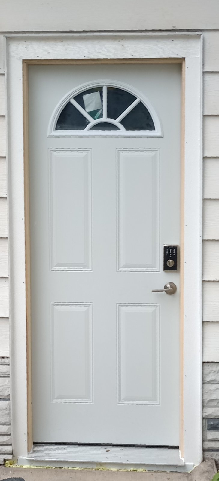

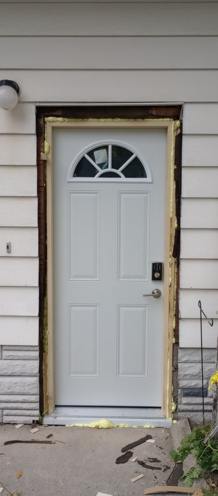

    Here is a little project I did for a friend of my wife's. A little more work than expected. But turned out ok, the sill from the old door was 2" thick. It's cleaned up better with a storm door. She was told by 4 other handymen that it would be impossible to put a new door in. I got it completed in 2 days 5.5 hours each day. Problem was having to exchange materials or not enough. Probably about 6 hours of work. 5 hours at the home improvement center. This was last fall. The gal was happy. And the sill got sealed and finished off nice.i ended up using a 6" white steel fascia to cover the 2 piece treated 2x8 1 full the other plained down to a 1/2"

    Halfway up the first lap siding piece was a cinder block wall, the ro was 36" - 38" trapezoid so far out of plum it was crazy.

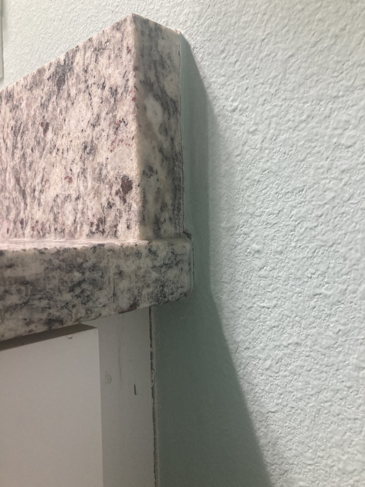

    How much time would you spend trying to figure out why a bathroom vanity is 1/16 of an inch low on one side? The vanity has been in place since 2018 and over this past winter of notice that the caulk is separated, and the whole right side is lower about a 16th of an inch. image.jpg

    I'm a little OCD, so I see the need to correct this. Still, unless you have time and money to blow, just a bit.

    Thats not much in todays home building, temps change, product/sealant shrinks. Unless you see water damage, id get a no shrink sealant

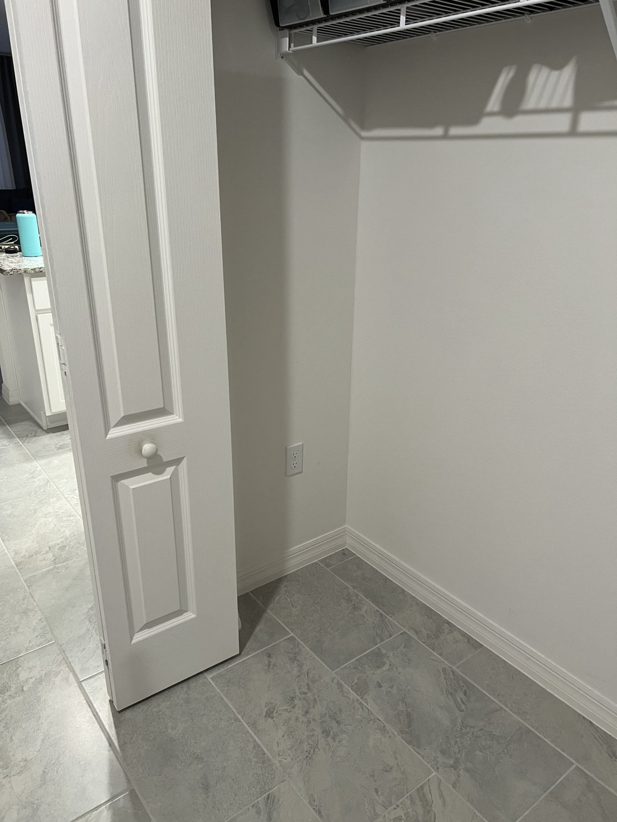

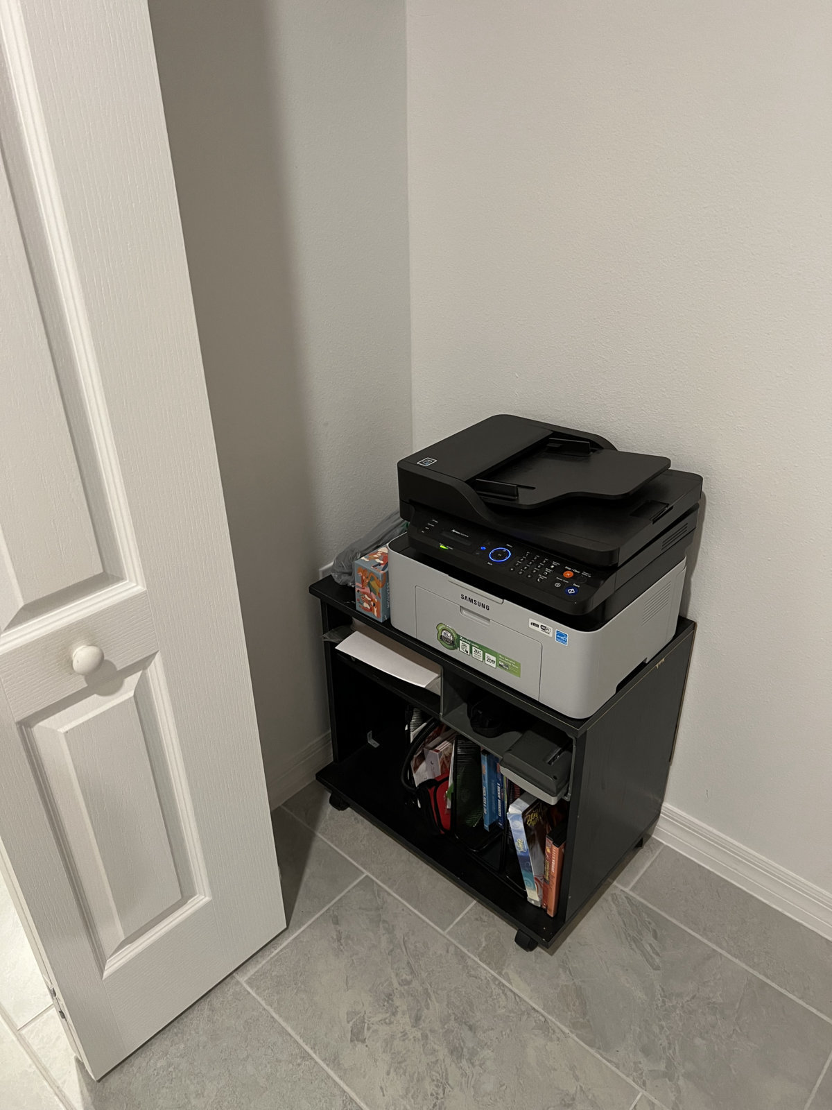

    Added an outlet in my coat closet. We keep our printer in there and would run an extention cord to plug it in. Now its seamless and will always be plugged in.

    I'm going to steal this idea. I've got a 3D printer that's noisy AF and runs for 30+ hours at a time. Putting it in the closet on the other side of the house is a good solution to the problem.

    Just if you plan on closing the closet door, maybe watch temps. You may need to run a fan into the closet so the printer doesn't heat up and compromise the print towards the end.

    I would be fine with “settling” but my issues is that it’s only on the right side so now the 7’ wide mirror sitting on the backsplash is crooked. I wonder if I should just remove any screws holding the vanity in place and try to add shims?

    1/16" isn't a lot.. but if the back splash and mirror are also moving, I think you need to figure out why you're getting that movement in the first place.

    I would check the floor and outside foundation to see if there is a bigger problem looming. If not caulking.
