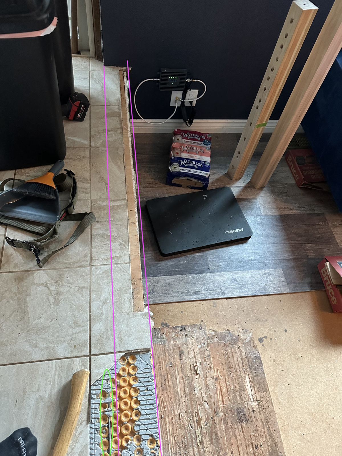

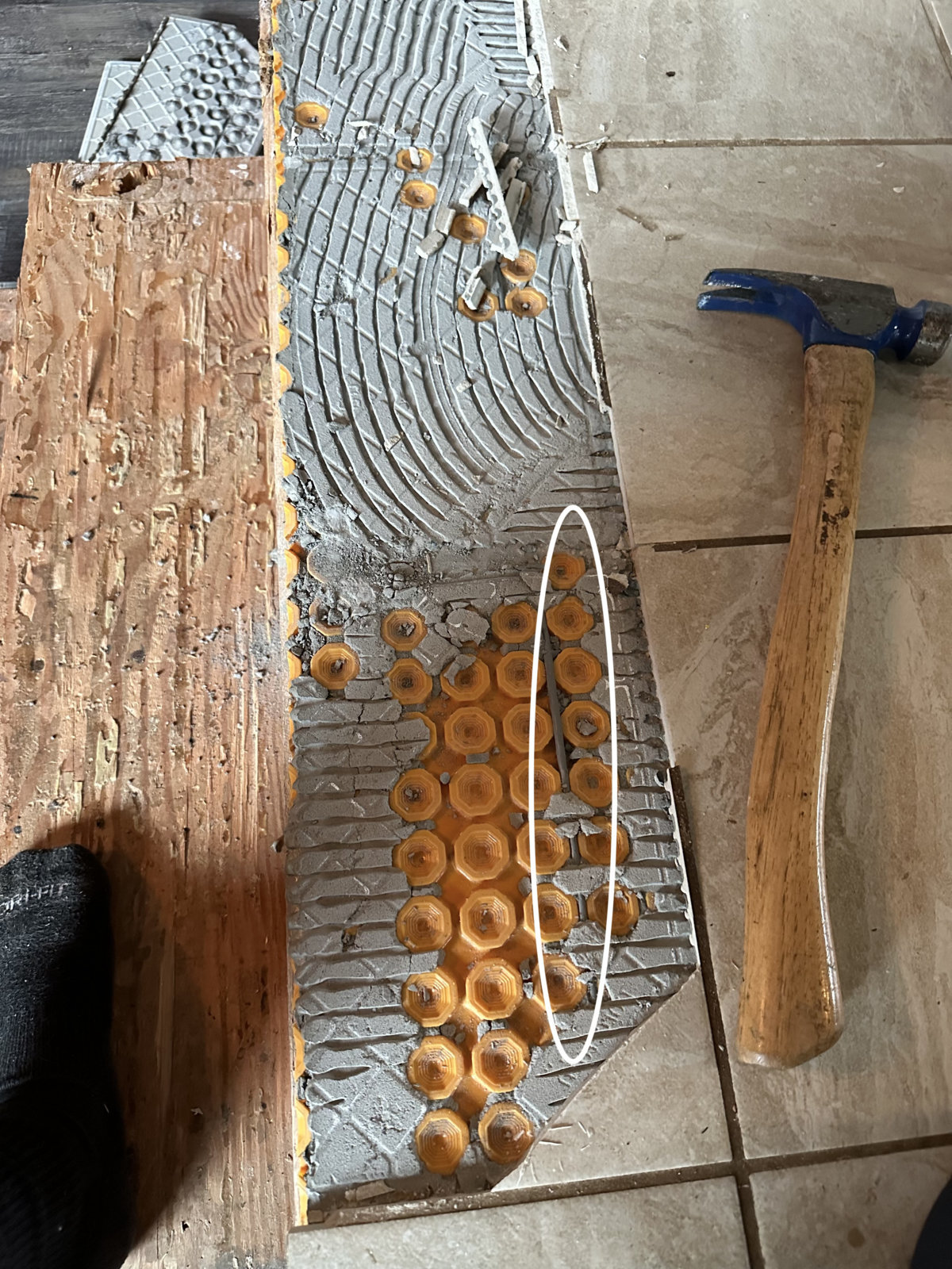

    Thanks for the opinions on the built-ins and the stair! I did some excavating today and am wondering what to do with the tile. The tile is laid over a decoupling membrane (Ditra) with a heating cable laid back from the ledge:
    I'm hoping to keep pulling up the row of tiles like I am doing so that I have a clean edge (no chipping) and then inlay a nice hickory rail base (or just a nosing) so it's a clean transition from tile to hardwood as you make your way down the stairs. Because the heating wire goes this far out toward the ledge I'll need to narrow-up my rail base. Probably make it the width of the purple in this picture so I avoid the wire (green circle) when I cut back the membrane and strip the area down to the subfloor:
    My question is is it possible to re-use that small section of Ditra if I chip-out the rest of the thinset? That way I can cut clean/thin tiles and lay them on fresh thinset up to the my new rail base. If I can't re-use the membrane that means I'll probably need to cut that wire. Any ideas?

    As long as you don't damage it severely during demo you shouldn't have any problems re-using it.

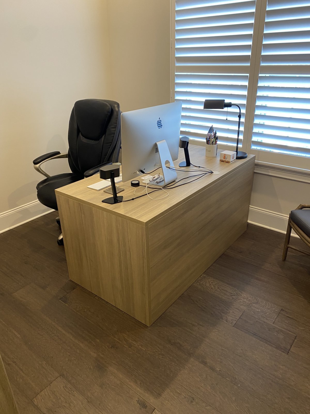

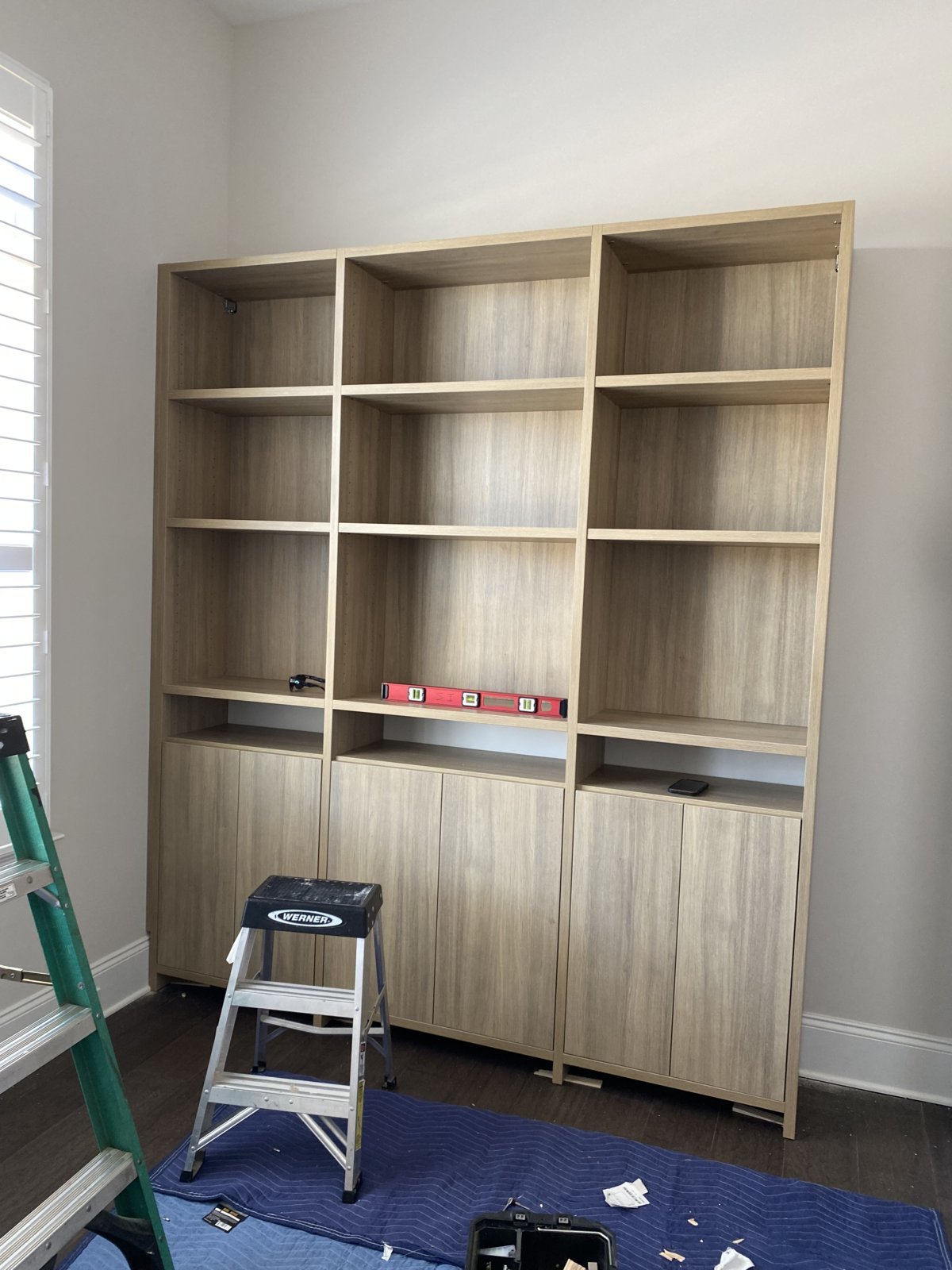

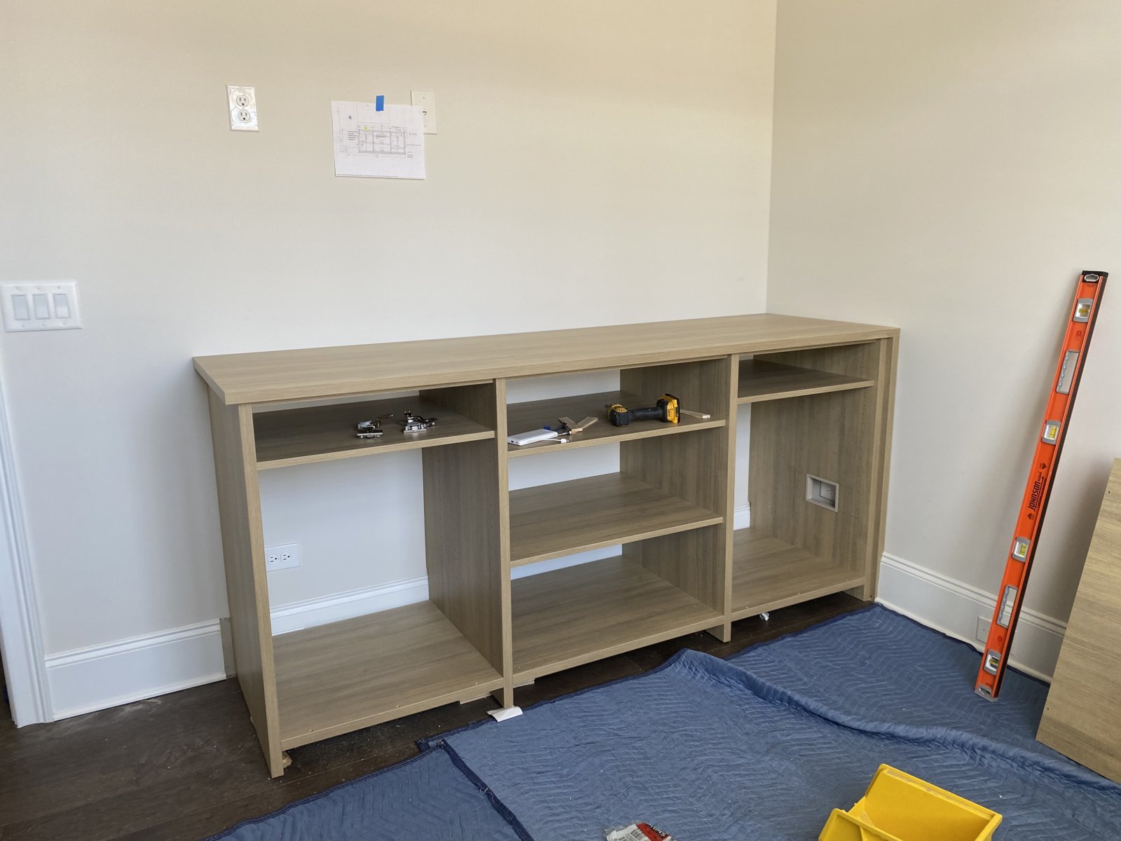

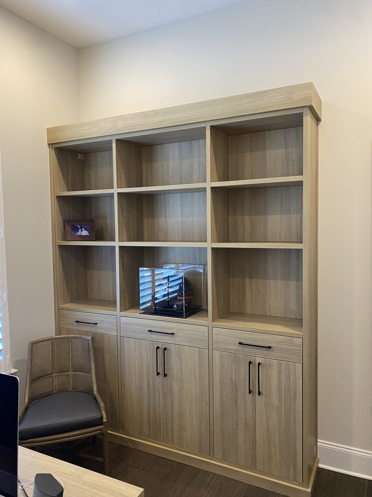

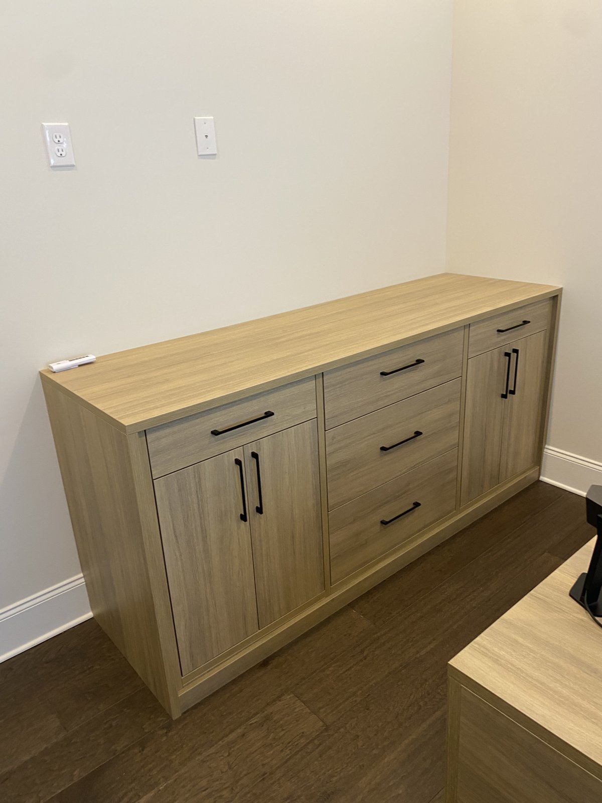

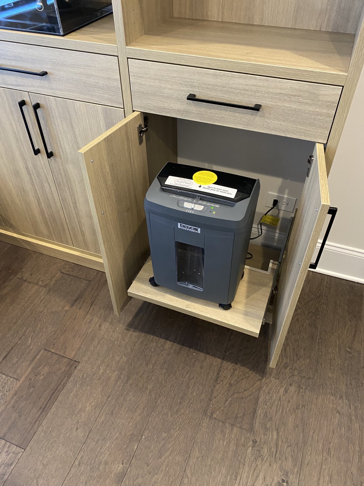

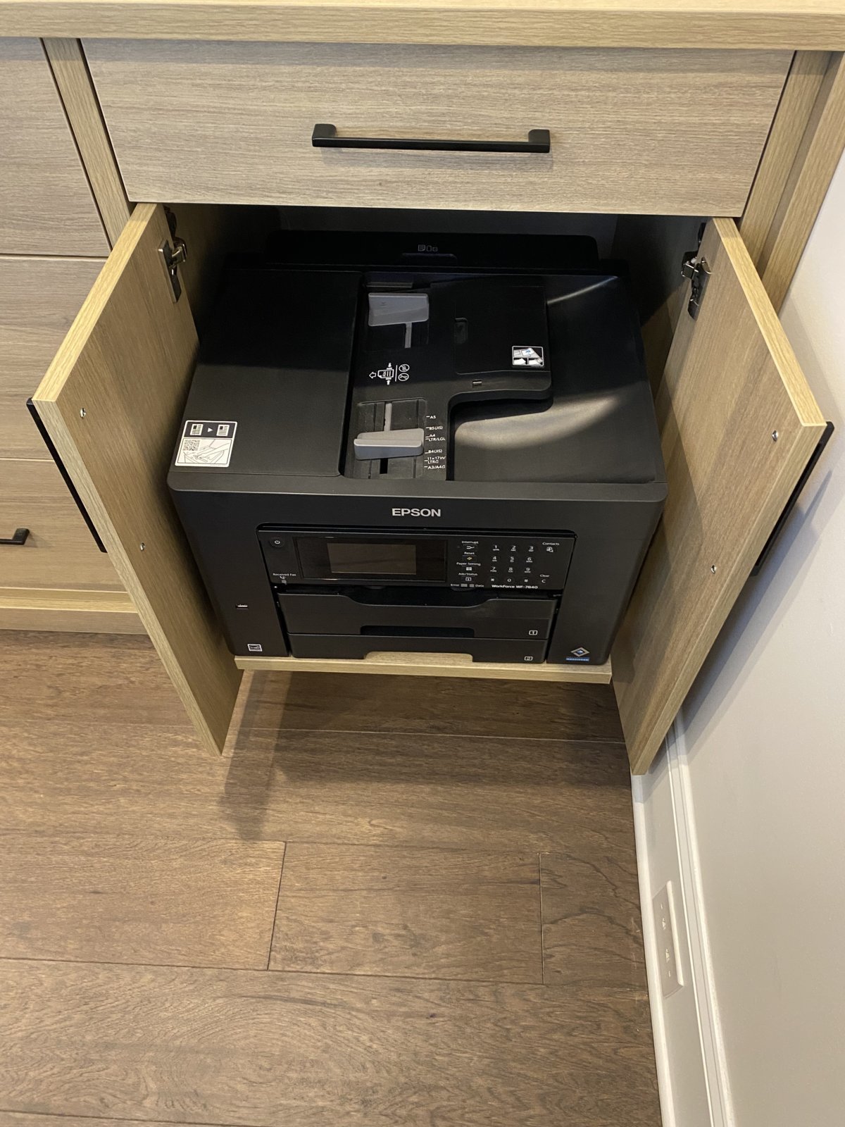

    finished up the install today......

    What did you use to order those

    We had a local cabinet guy help us with the design and install....

    Dang it I wanted to go online and just design a flat pack order of parts for myself to assemble and add trim.

    He is the same guy who did our Master closet/other office/pantry/coat closet and wine beverage bar.....
    TV and sound bar goes in Friday 55 or 60 inch TV goes on the left side tall cabinet

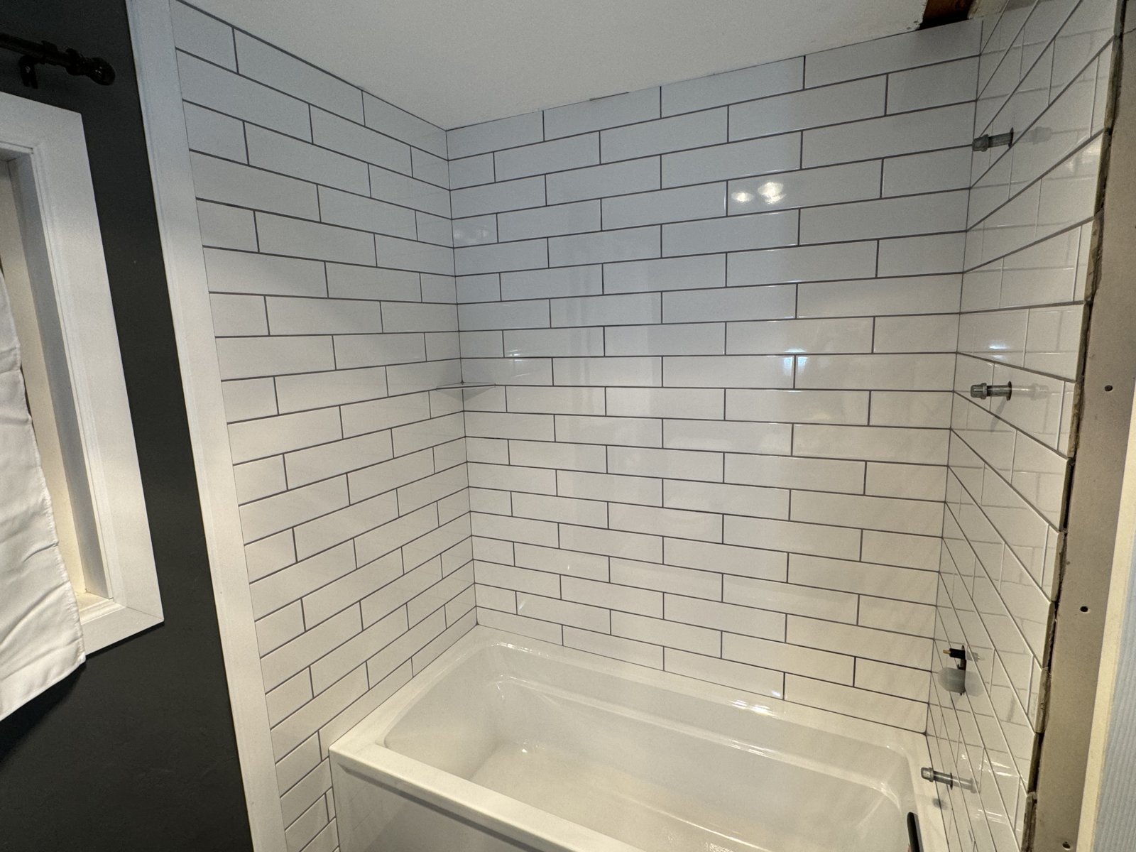

    Finally grouted! My timelines are sometimes a bit wild as I tile somewhat “semi professionally”(did it for living for a period of time, now help a select few out here and there) :anonymous:
    IMG_4014.jpg*home owner still has some drywall and other work to do obviously, will return to touch up grout once drywall and paint are repaired*

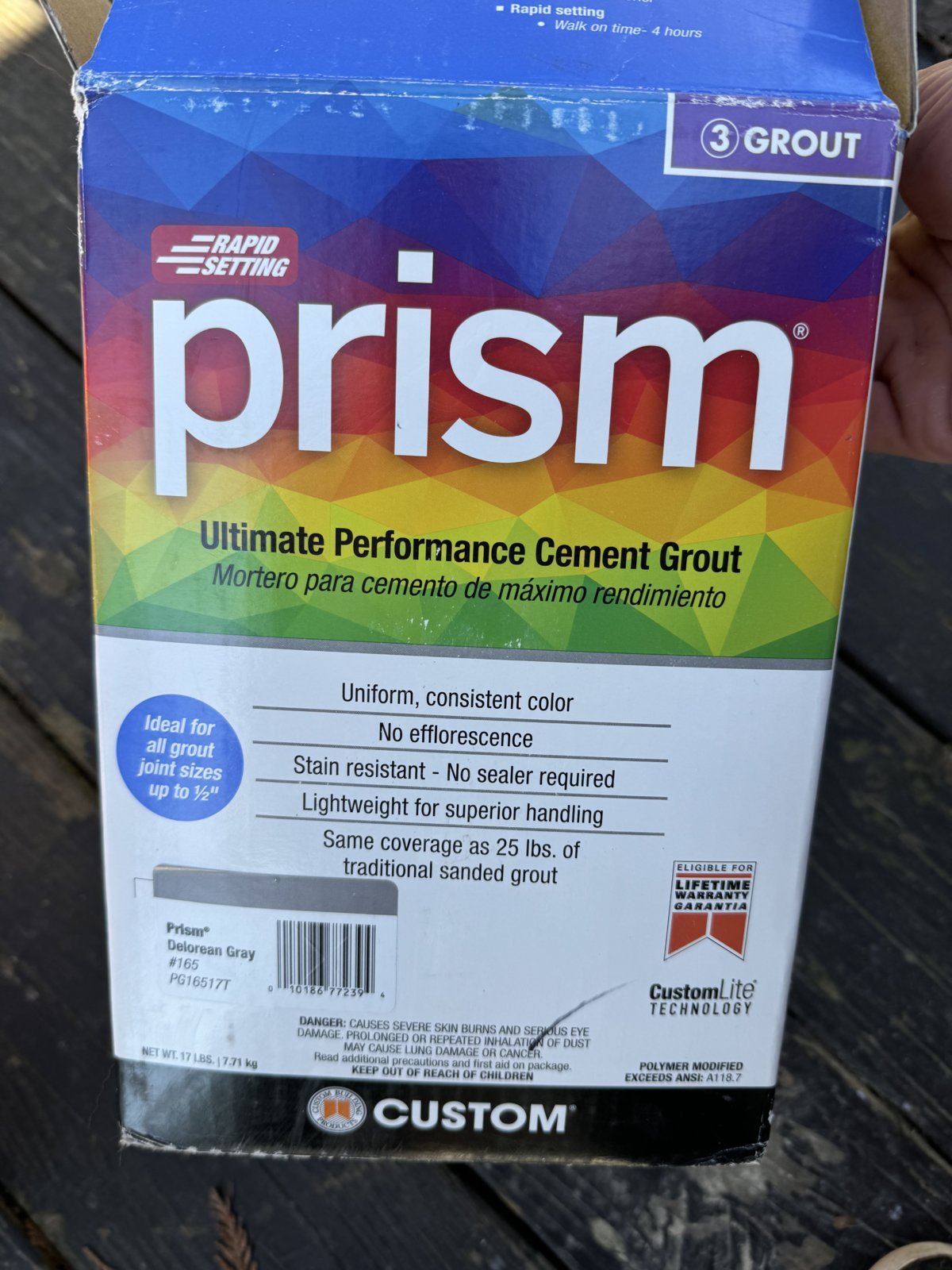

    Looks good! What's your favorite brand of grout? I prefer c-cure mp sanded 924.

    im a custom prism guy myself, also costs a little extra but I do like grout shield.. if the price is right for the project I’ll splurge..
