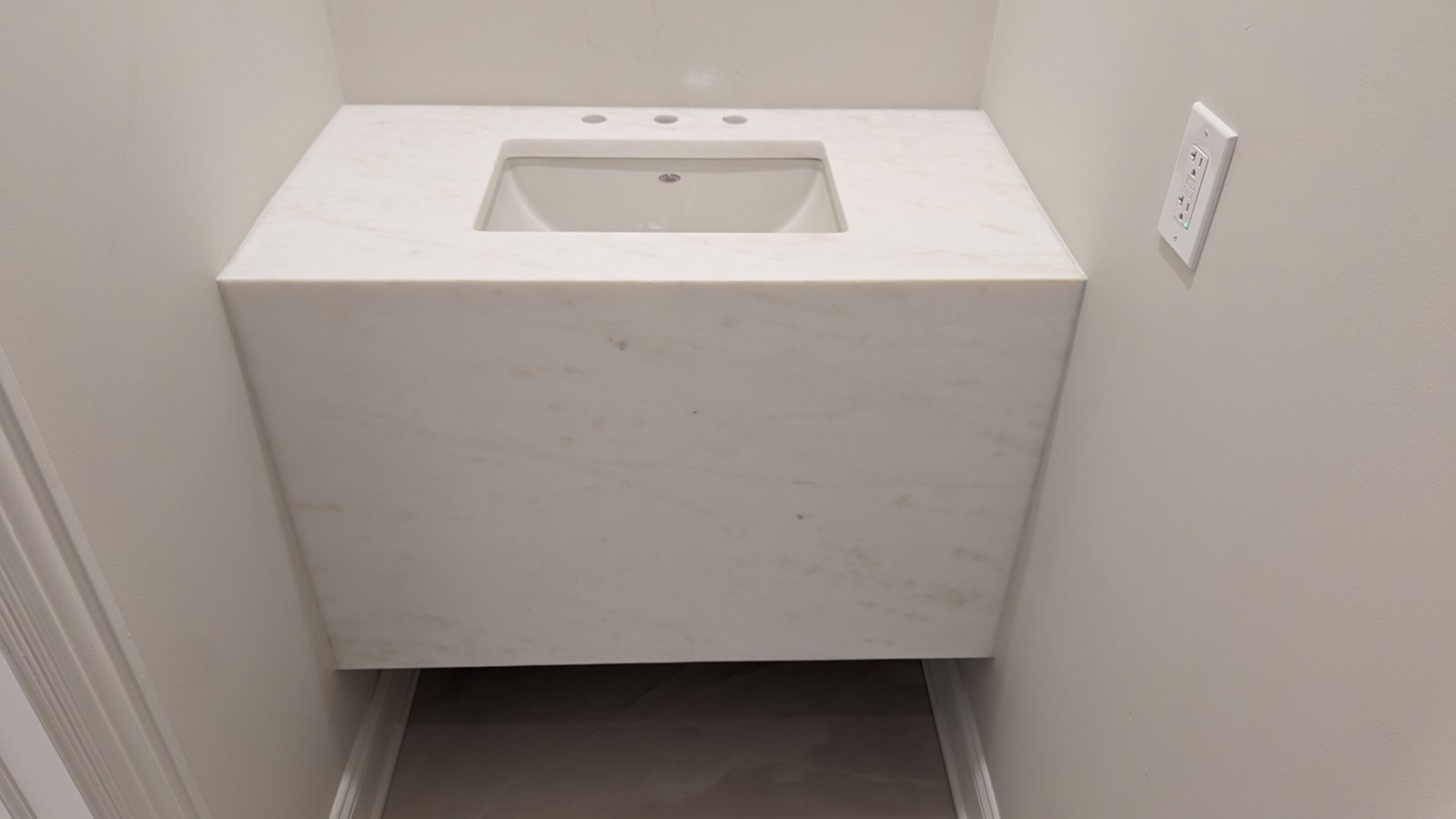

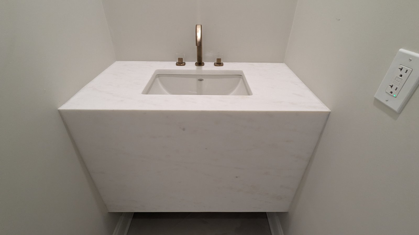

    i'll never understand trendy stuff. i'd rather have the cabinet space under there...

    A waterfall vanity? That's a first for me. Kinda like it but would hate to have to plumb it. lol

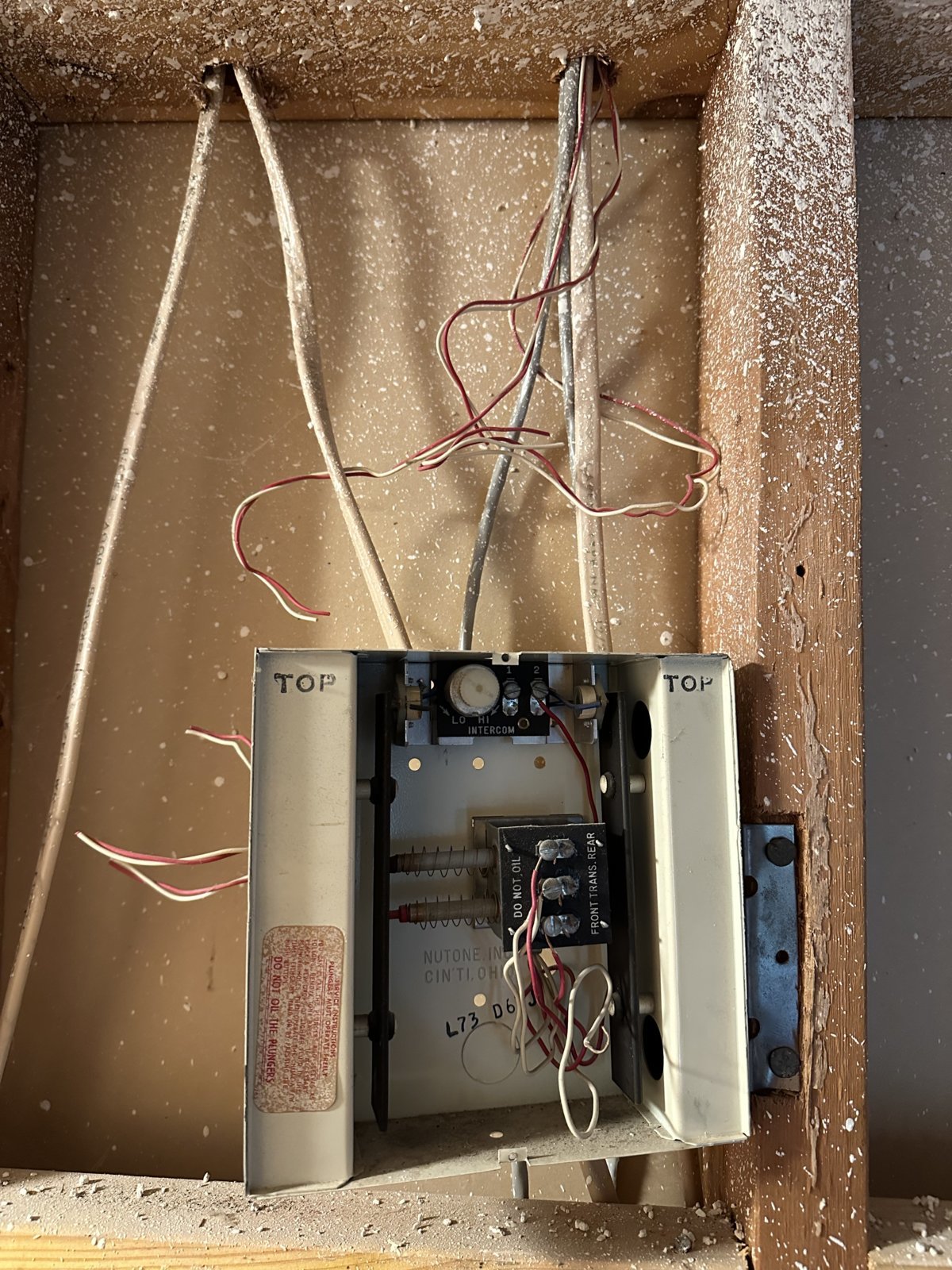

    our house has an ancient intercom system, which I’m tearing portions out as I redo spaces. This was in the hallway I just pulled the paneling out of. The red/white wires were giving me a hot beep. So I went to the breaker panel and turned off EVERY breaker, but they stayed hot. With a multimeter on them I couldn’t get a reading at all.
    so being the safety man I am, I cut them. Didn’t die, so that’s a win.
    I’m still getting a voltage beep on the wires from the attic. Is it just bleed over??
    I hate electrical

    If you pull those red and white low voltage intercom wires way out of the wall and away from everything else you’re still getting a beep? I’d be surprised by that but I’m not an electrician by any means

    Yes! Well I haven’t pulled them out of the hole, but away from the wall yes I get a beep.

    Friend had a major house fire that started from the low voltage doorbell transformer...I'd stay on this issue

    Well that makes me feel good, not! I plan to get in the attic tomorrow and trace it back to who knows where and at least cap it off

    I would just cap them off in a junction box and then cover the junction box with a blank faceplate.
    I had a rental where the previous owner did something similar. He left the bare wires capped off, but no junction box and just put sheetrock over to hide it all. :facepalm:

    If you touch them together does the transformer work and the thing chimes? You may fry it but it’s obviously not in use. Like @MGMDesertTaco said j box or trace find where it’s fed from

    No nothing chimes or works, never has since we’ve been here, I was so confused when I was getting a hot signal

    Is it connected to old land line? Only thing i can think of.

    my only guess is that maybe it’s hooked into the old security system that’s based in a closet, but I haven’t traced the wires back yet. That security system has one of those giant Duracell battery packs in it I remember that may have some charge, idk..

    Could be, i had an old system disconnected in last house we had. It still had battery in it but i didnt mess with it.

    Check for small transformer close to or attached to your main electrical panel. Hard wired door bell and old intercom systems need a low voltage transformer for power source.

    Is that what I’m looking at here?
    yes, that is in fact a skeleton of some rat or mouse.
