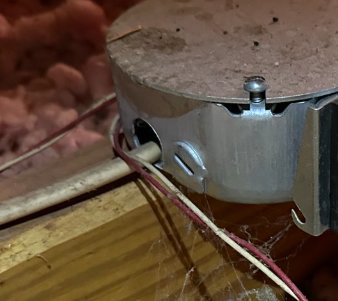

    Not a bad idea. The attic isn’t hard to get in and out of but this has all been this way since 1967, and I don’t feel like chasing down all the junction boxes haha.

    Yeah, I'd just do the ones you see as you see them if you had these in your pocket. I wouldn't go hunting/fishing for them.

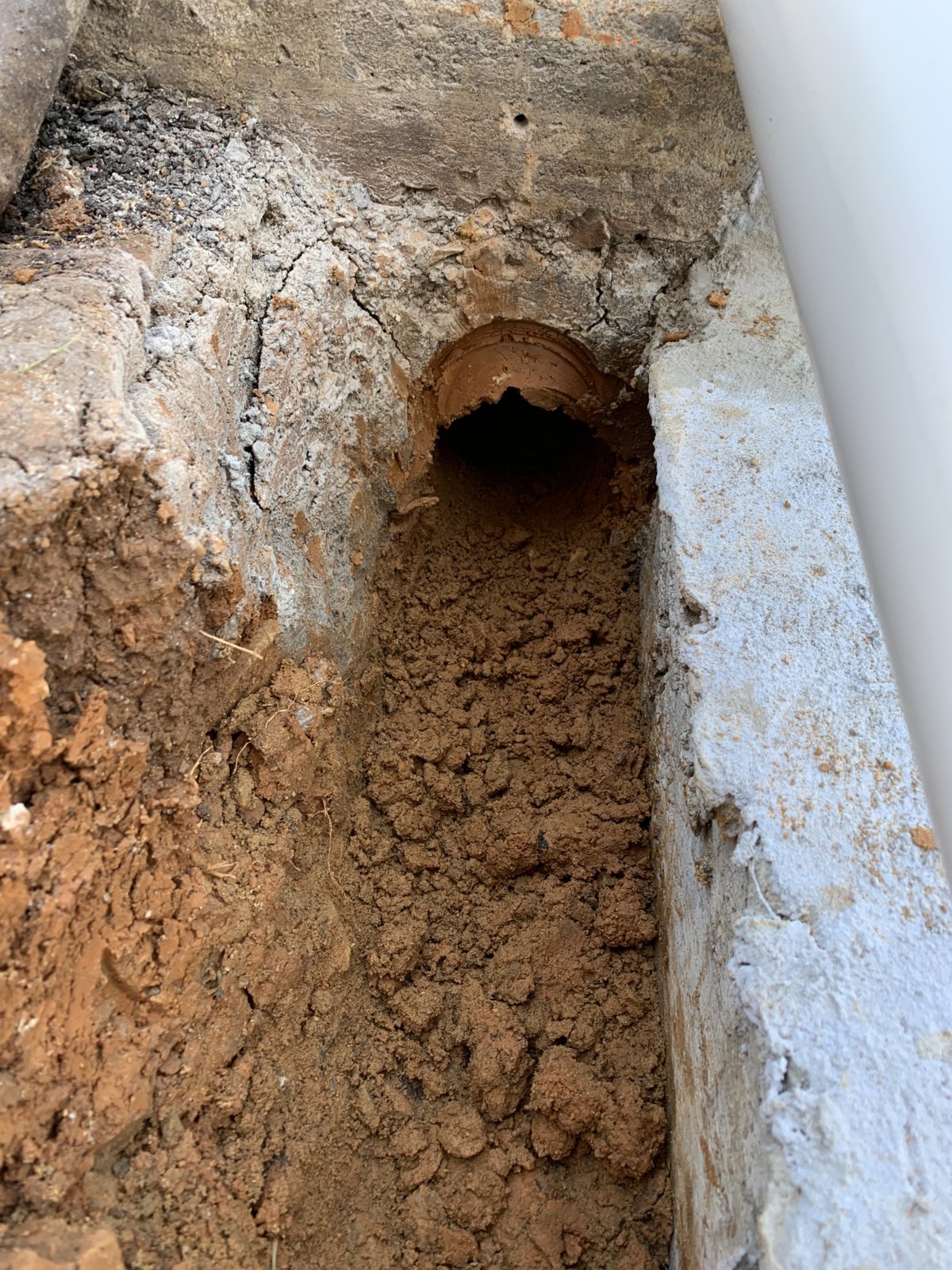

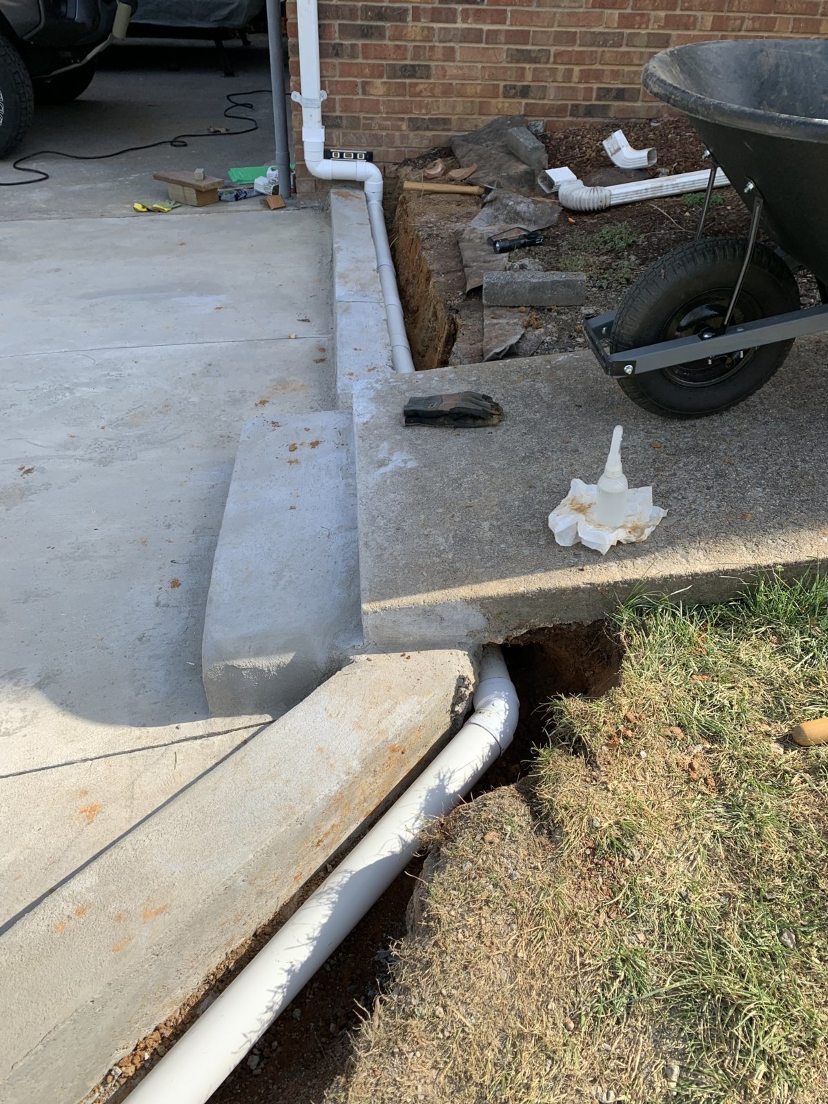

    New drain for the downspout to move it off the driveway

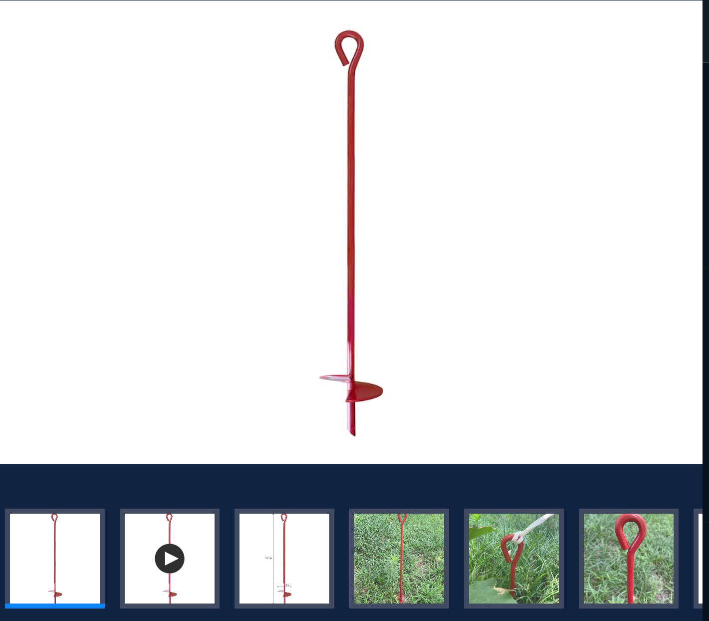

    Good idea on that auger. That used to have a loop on end right?

    Yep, Red Steel Storage Shed Anchor from Lowe’s. Cut the loop and ground a flat on one side to keep it from spinning in the chuck.

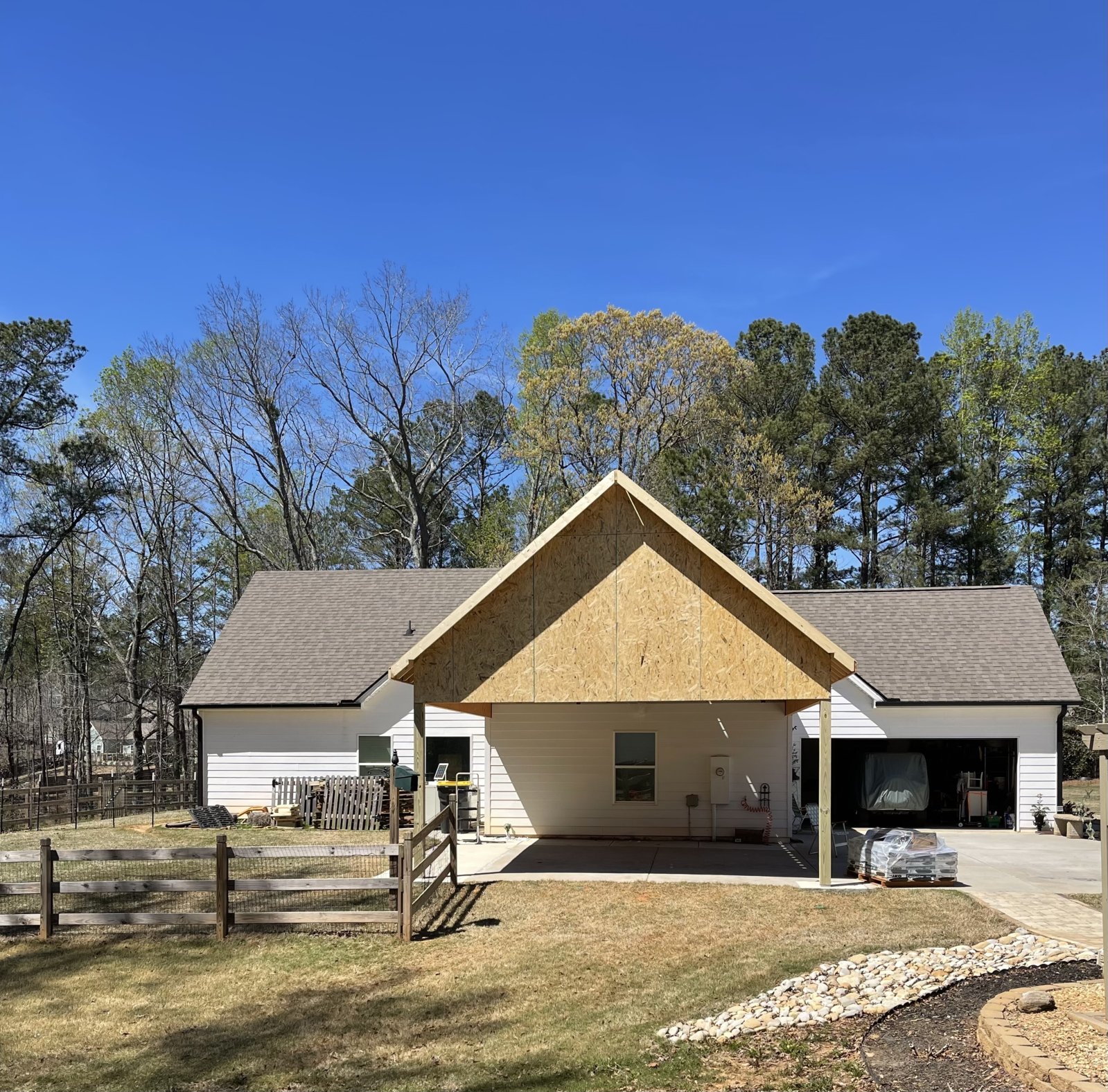

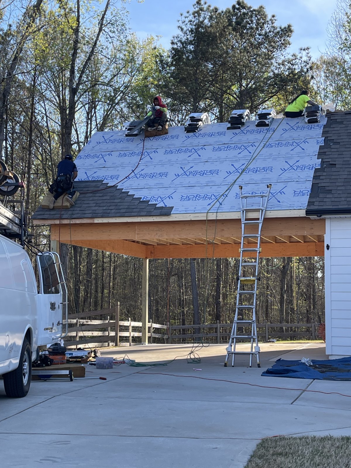

    I contracted a guy to build me a carport on the side of the house, rough inspection is Monday IMG_0375.jpg IMG_0373.jpg IMG_0383.jpg

    I would suggest putting in a cleanout right at your downspout so that you can snake your drain before closing it up. I did something similar and added French drains and basins to help control some low spots where water pools. I use the basins to snake the drains but if you don't plan on having basins, I would install a cleanout before you close everything up.

    I’m not too worried about it, as there is only a small section of gutter going into it. Plus the drain pipe is 3”, gutter downspout is 2”x3”. I also have a gap I can get a snake into at the gutter to pipe adapter. I’m pretty good at keeping the leaves blown out of the gutter also. My luck it’ll clog up by this weekend!

    curious about the way it was framed
    is it stick framed rafters joining on a ridge board that is transferring the load mid span down to an LVL beam that also carries the ceiling joists ?
