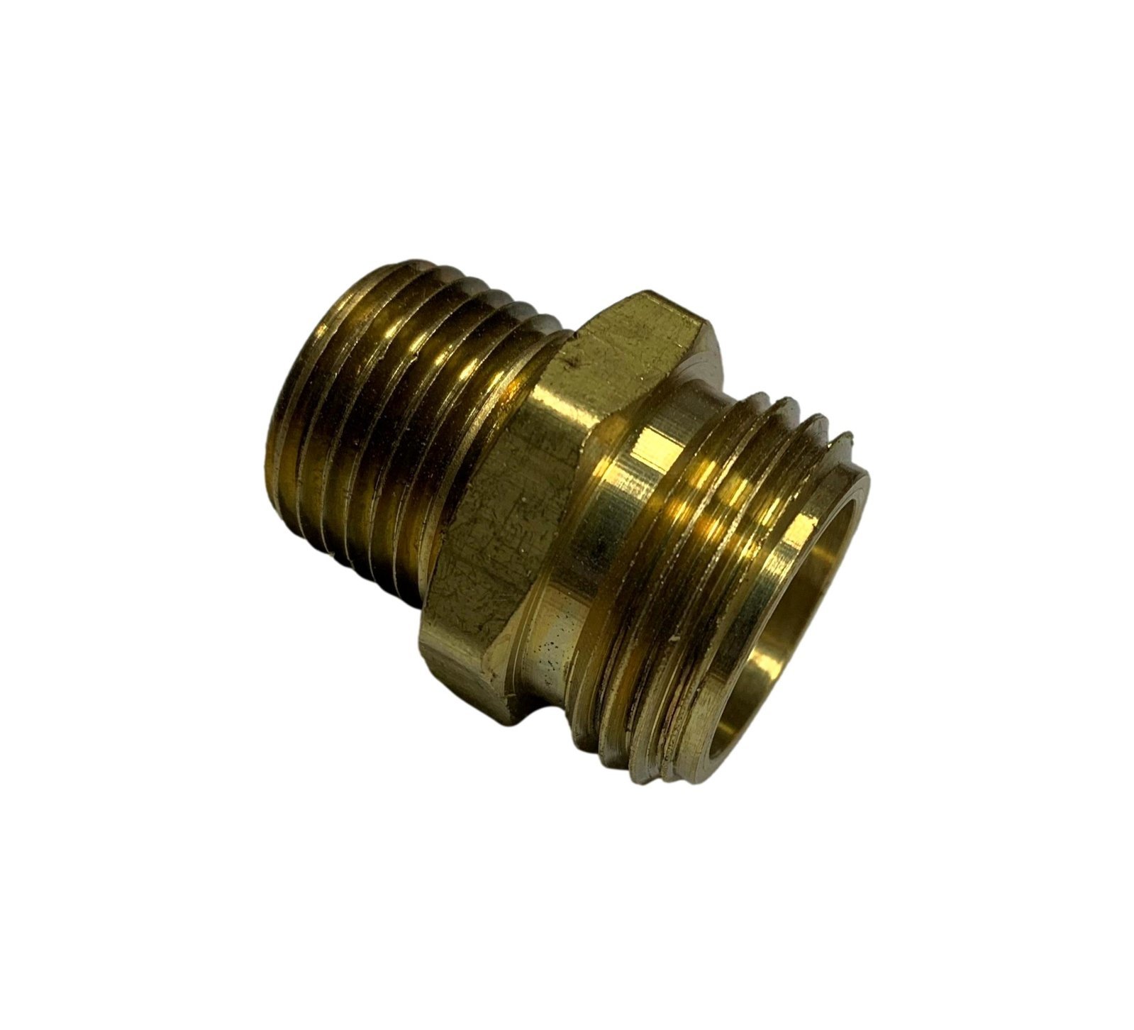

    While we are on water heaters:
    When I replaced my 30 gallon electric I removed the original plastic drain valve and replaced it with a
    copper pipe nipple, a brass full port ball valve and a male garden hose fitting. I keep a short length of hose tucked behind the heater and flush the sediment out into a pail every month or so.
    That full port valve will really move the water & sediment and it feels solid unlike those plastic drains.
    This type fitting:

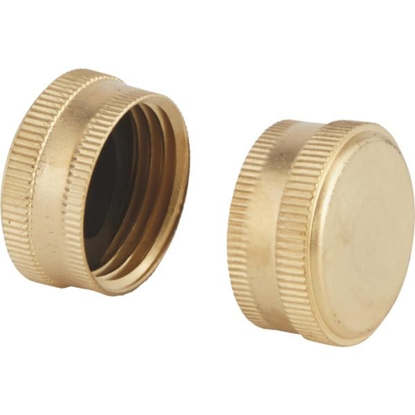

    I keep a cap on it when not in use just to prevent any misadventures.

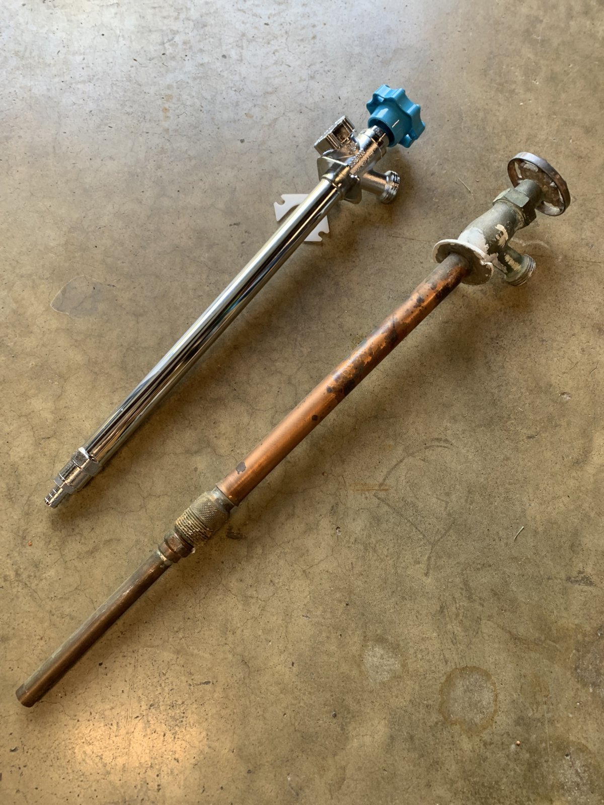

    New vs old

    Pretty much the long & the short of it right there.

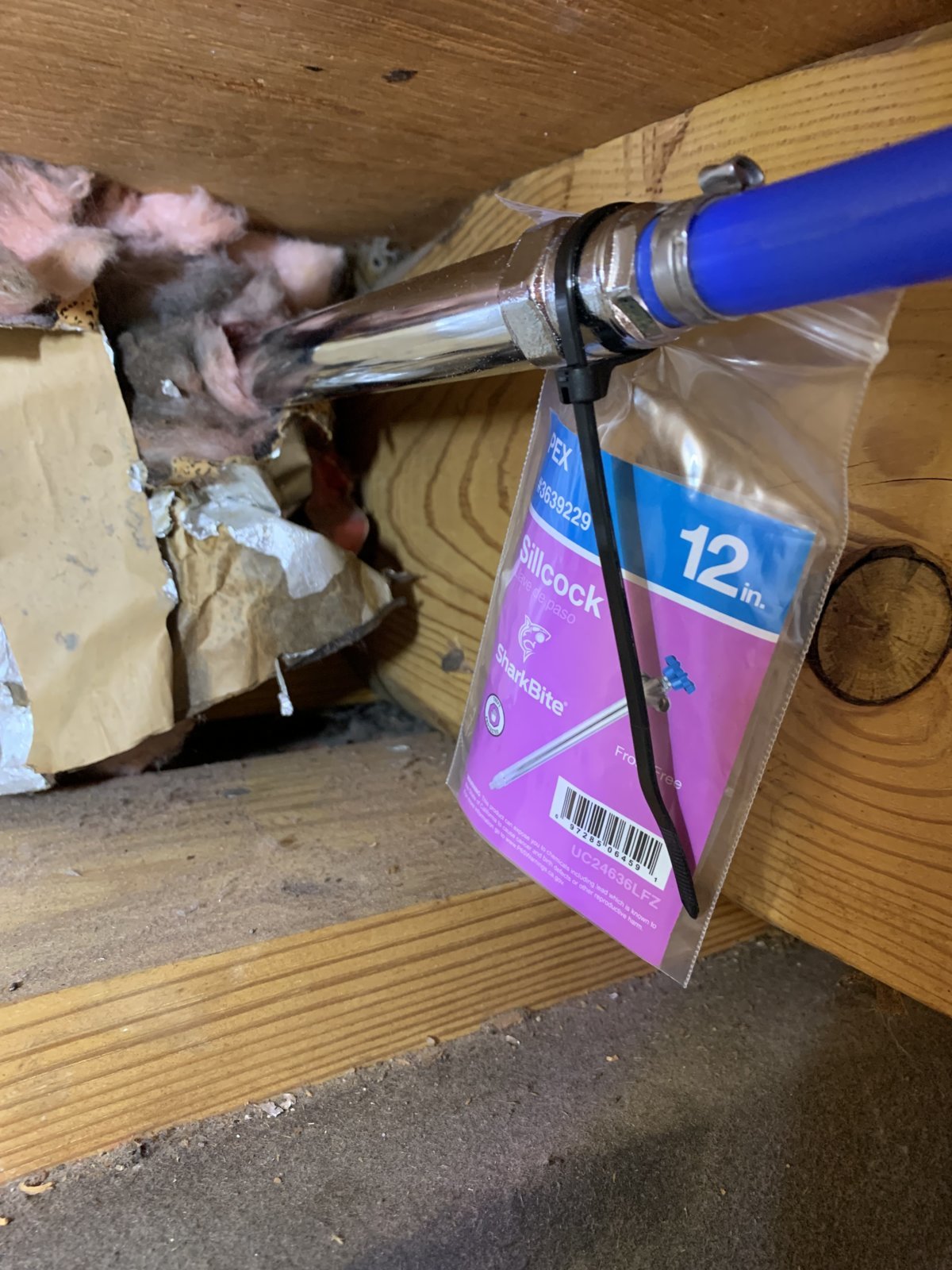

    And so the future homeowner/next husband/whoever knows which one it is
