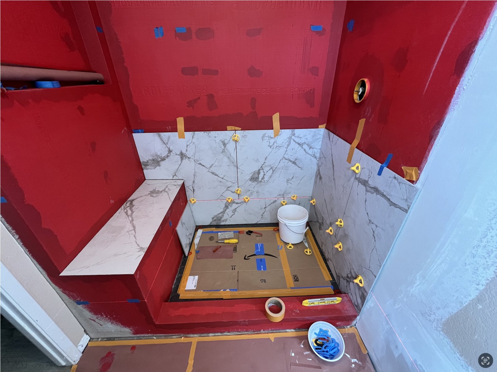

    Didn't get a chance to finish my tile before our first kiddo arrived... hopefully I can find some time this weekend to get back into this project. Would really like not to have to shower in our guest bathroom for once!
    These cut tiles are not thin-set in place yet.. waiting until I get the entire first two rows cut and ready.
    The primary shower has been ripped out for a year now, and is the second to last remodel project on the list.

    LFT thin set for sure. I actually don't know what I am doing :rofl: Worked in the trades through high school, but somehow managed not to do tile work, so tile itself is a new adventure, but pretty handy with everything around tile, so it's not a large leap. Just wish the interior decorator (wife) picked a 3x10 or 4x12 tile rather than the LFT, but once she saw those it was pretty much set. On one hand, lot fewer pieces of tile to install.. on the other, every single one of them needs to be custom cut. :frusty:

    Walls and backer board are plumb. I reframed/shimmed everything out to make the tile installation a no brainer. Just a little flair from the vinyl shower pan liner folds at the very bottom, so just a little less thinset in those corners should take care of that. Also why I wanted to go for at least the first two rows first- in order to use the second row and tile leveling system to pull that bottom row into alignment.

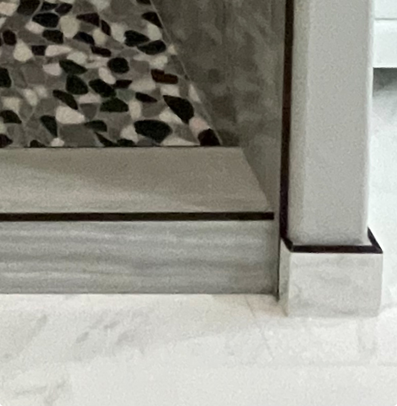

    And not pictured in that photo yet, is a length of the black Schulter alloy edge trim for the transition to the drywall. Just trying to wrap my head around how the edge trim plays with the unfinished edge to the curb coming in from the other direction.
    For the niche, and other exposed edges, I cut the at 45 and polished the edges... Really not making it easy on myself.

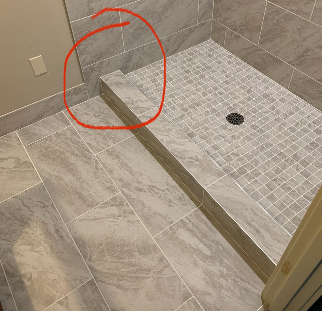

    all good things! Like I said you seem to be on the right track and leaps and bounds ahead of most home owner tile jobs, you are correct about not making it easy in some spots lol
    is that already a full tile coming out or is it trimmed? Normally I start from bathroom floor not shower pan in layout, then that piece that comes out wraps the curb..

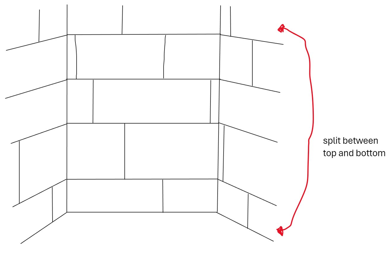

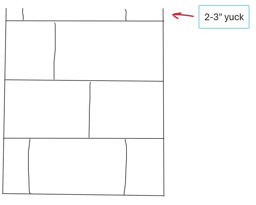

    Yes, the "0" is the subfloor not the pan. The "first row" is a little more than 1/2 a tile from the finished floor height outside of the pan. I would have ended up with a 2-3" band somewhere, so I opted to split the top and bottom rows in roughly half + 1/2 the overall delta.
    essentially this:
    vs this:
    This was also to prevent the niche from landing near the horizontal edge of one of the tiles.

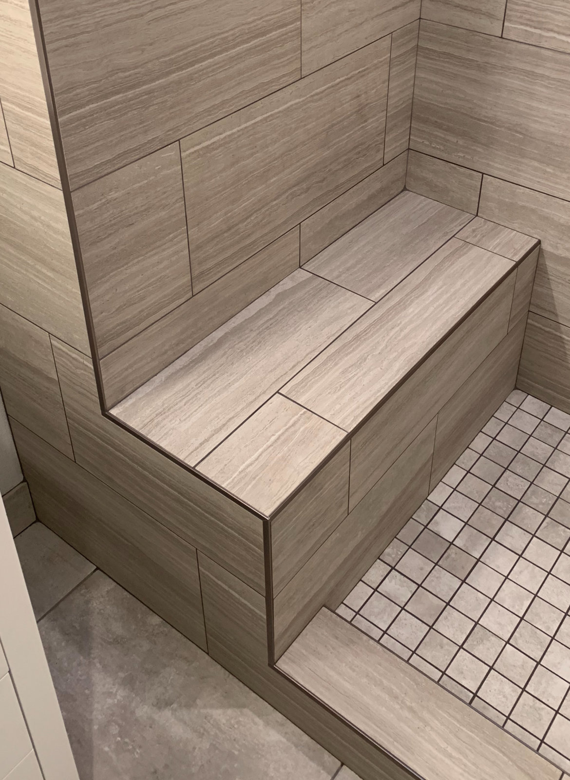

    I am more so talking about the tile coming out of the shower and how your curb might relate.. I like the layout top to bottom.. here’s some ideas, sorry again if they are unwanted!!

    I didn't run the (valve) wall tiles far enough past the curb to return them to the floor, which might have been a bad idea, but I didn't want to end up with a small 1" sliver on that piece- I would have knocked it off while moving things around for sure. So I went flush. I'll play with it all tomorrow am and see what sticks :rofl:
