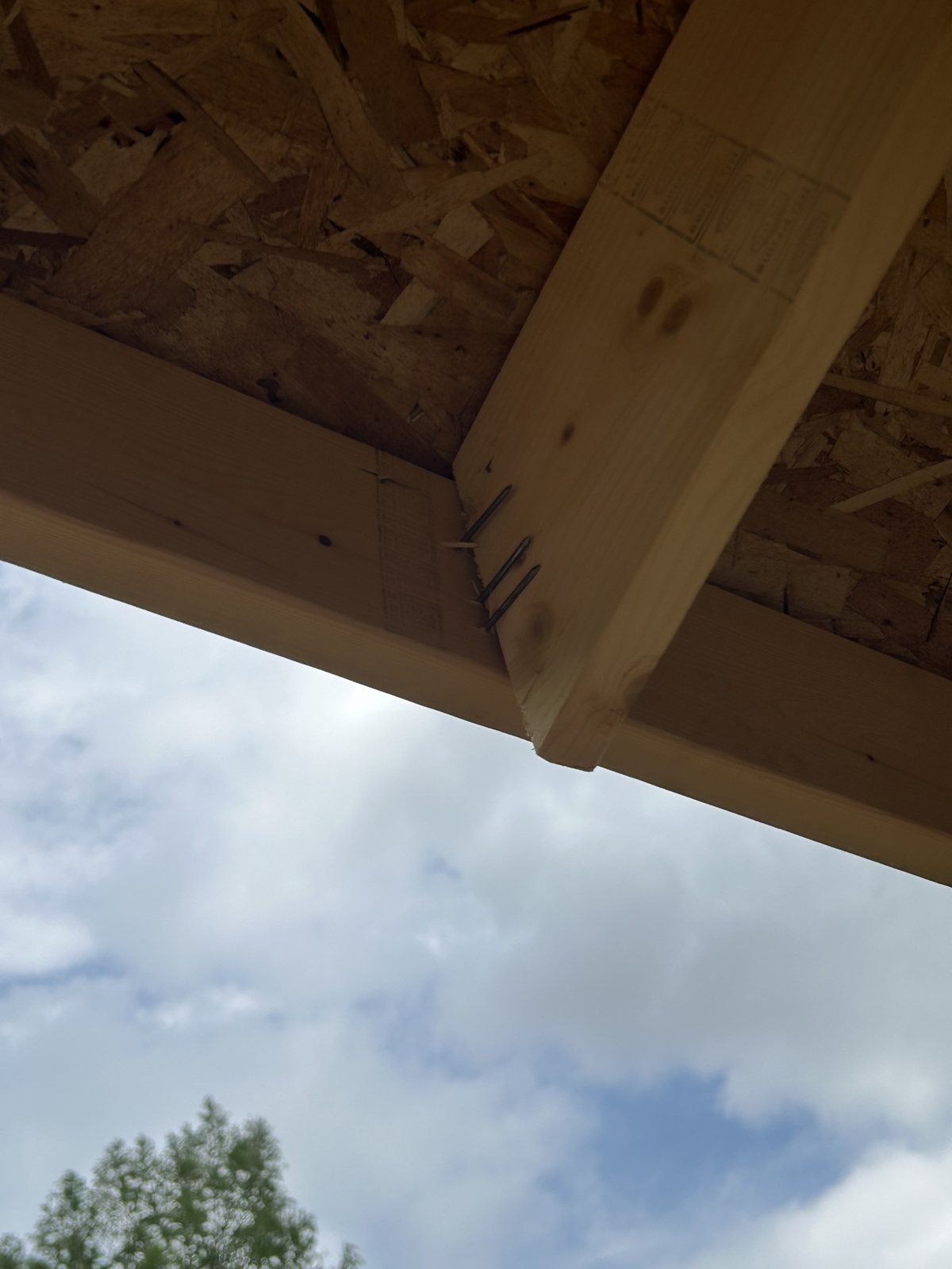

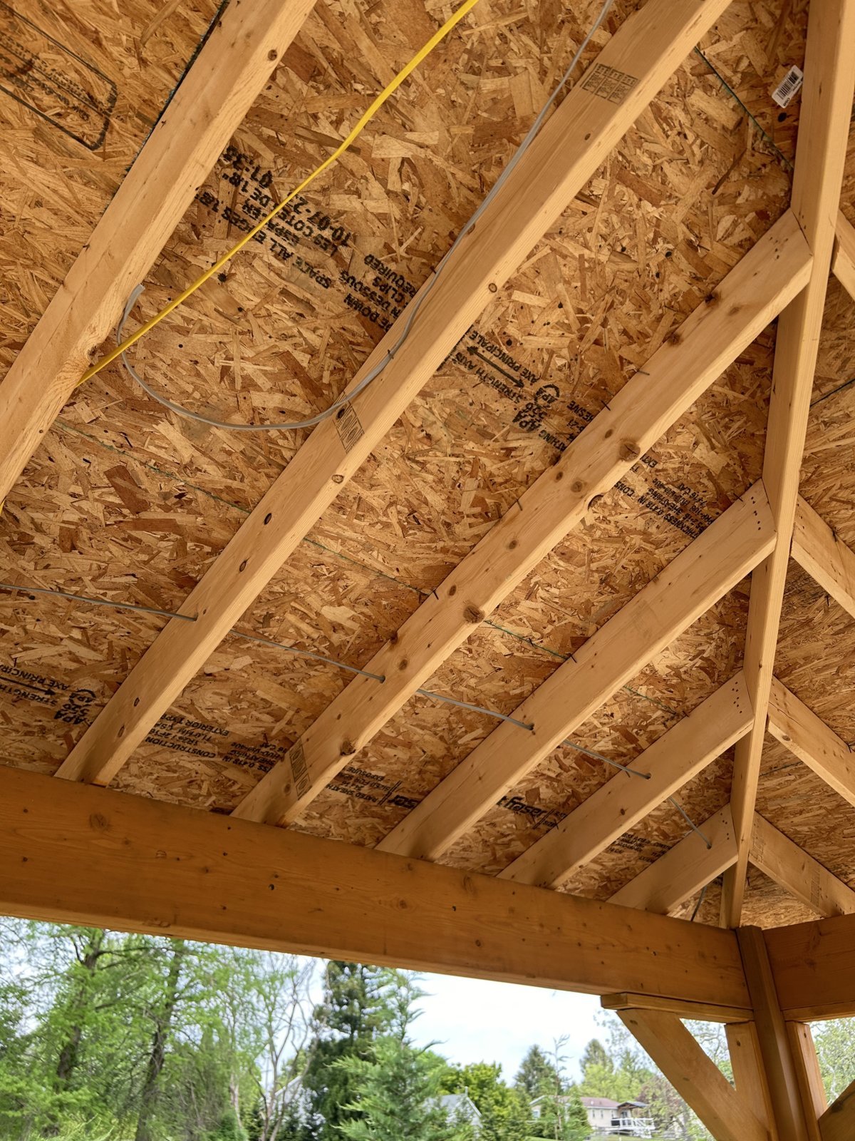

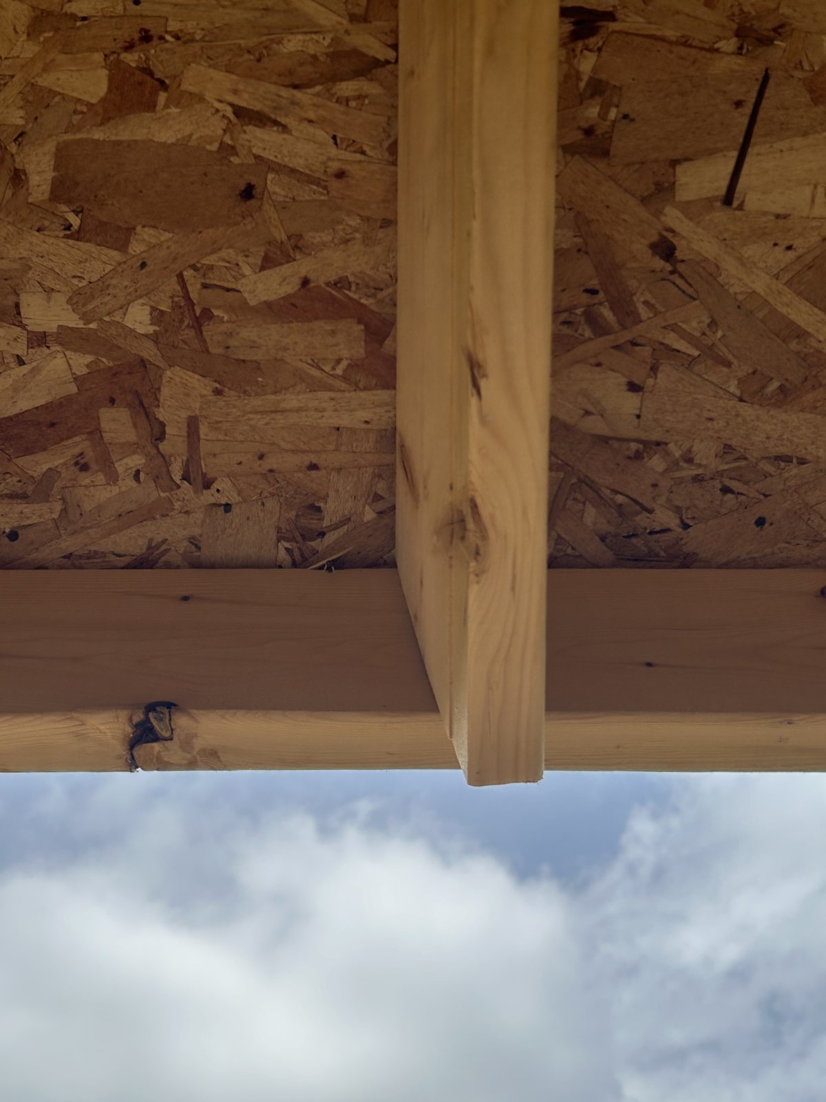

    A guy called me to finish his pavilion. He paid the contractor in full and he hasn’t seen the guy in 1-2 months, half finished and a butcher job to boot…none of the rafters are square nor consistently centered 16”-24” at random and the birds mouth doesn’t set on the beam…nail misses gallore. IMG_7656.jpg

    I can't "like" that. :(

    As a general contractor myself, i absolutely hate it when other contractors take advantage of a client like this... it makes general contractors as a whole a bad reputation

    If you can't hit a 2x more then 1/2 the time you sure as hell aren't going to be able to figure out the proper compound angle for jack rafters. Even though it's written on every framing square ever made. lol

    What was the guy thinking with the rafter tail??? It’s 2” below the facia, no level cut….

    I doubt there was any thinking involved. lol

    The owner told me he guessed at the birds mouth and cut it with a sawzall. They’re nowhere’s close to the correct angle

    Math is hard. Granted, if you plan on doing a cut and stack roof you should be able to do it at least the 5th grade level. Guess this guy never got that memo.

    This is a prime example of the majority of contractors in the northeast. If I had to estimate, 7/10 maybe 8/10 are this incompetent/apathetic.

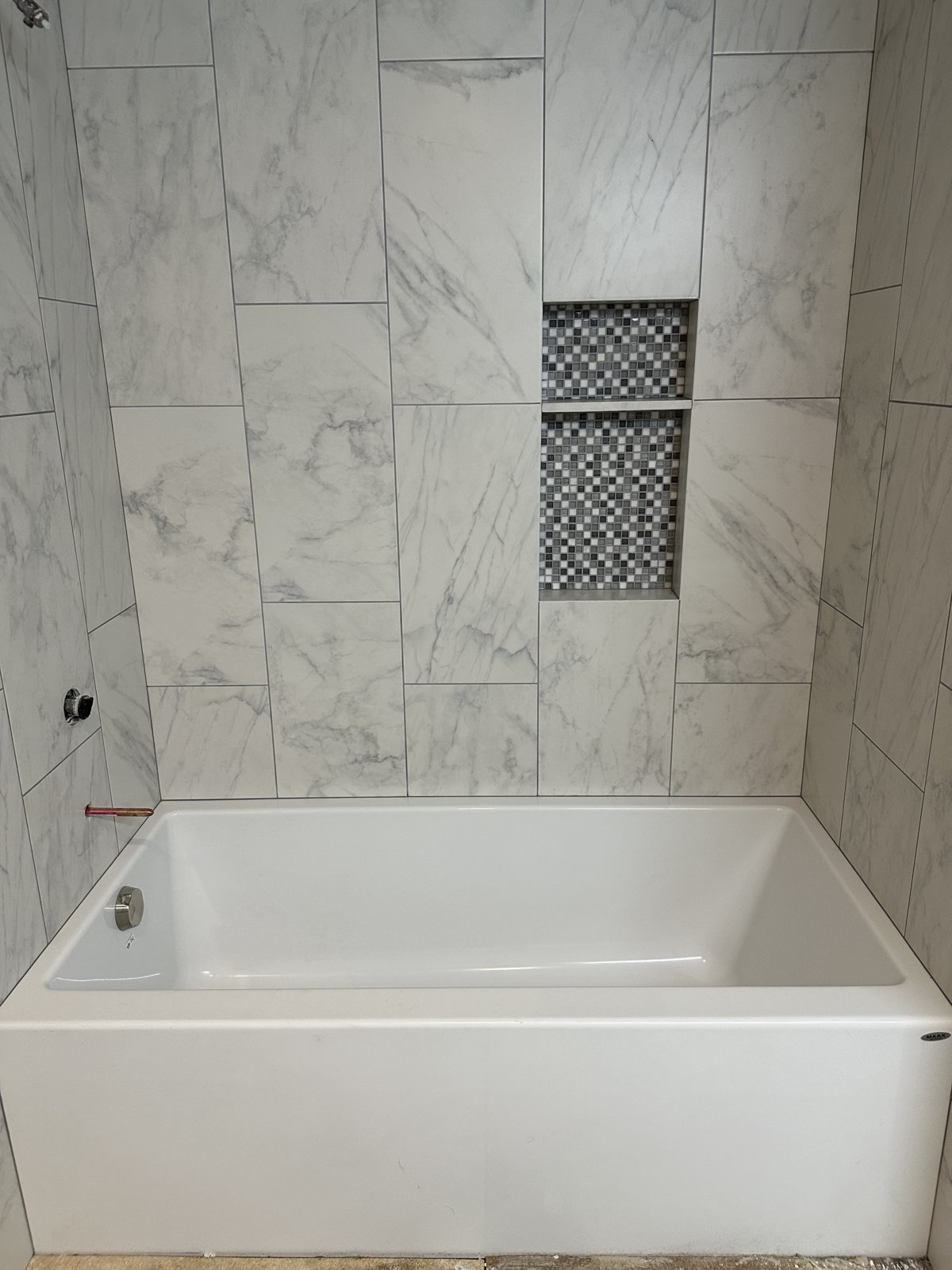

    Insurance finally settled. Work is progressing. I could have done it myself twice with as long as this has taken to get approved.

    the worst part is using OSB , like seriously WTF

    what happened before?
    looks nice though, has the plumber seen the size of the hole around valve? Looks like posi temp, also looks tight!

    Came home to water in the Garage at the end of August. Had rotted out the subfloor and footer along the back wall. Previous owner who fancied himself a DYIer improperly installed the tile. The project manager has seen it. I’m leaving it up to them to figure it out. Don’t have time…
