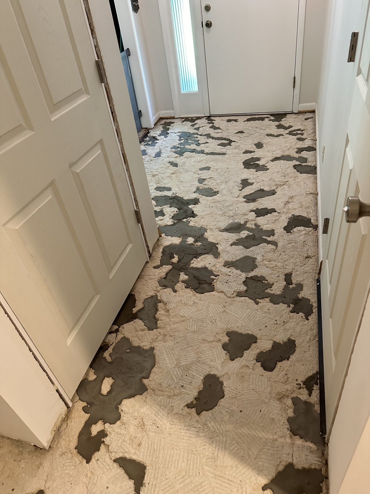

    Step 1, fill in the deep problem areas that busted out.

    dont be a scared to trowel it a bit! After level Quik if you need something a little less runny more to just patch spots you can do like Henry feather finish too.. more like a patch rather than something you pour

    Yeah we didn’t bring this up to fully level yet and plan for the self leveling stuff to take care of most of that. It’s basically impossible to trowel with the condition of the floor so that’s why this stuff looks so bad lol. I’ll be covering it with sound foam then vinyl plank anyways so I’m not super worried about imperfections as long as it’s level

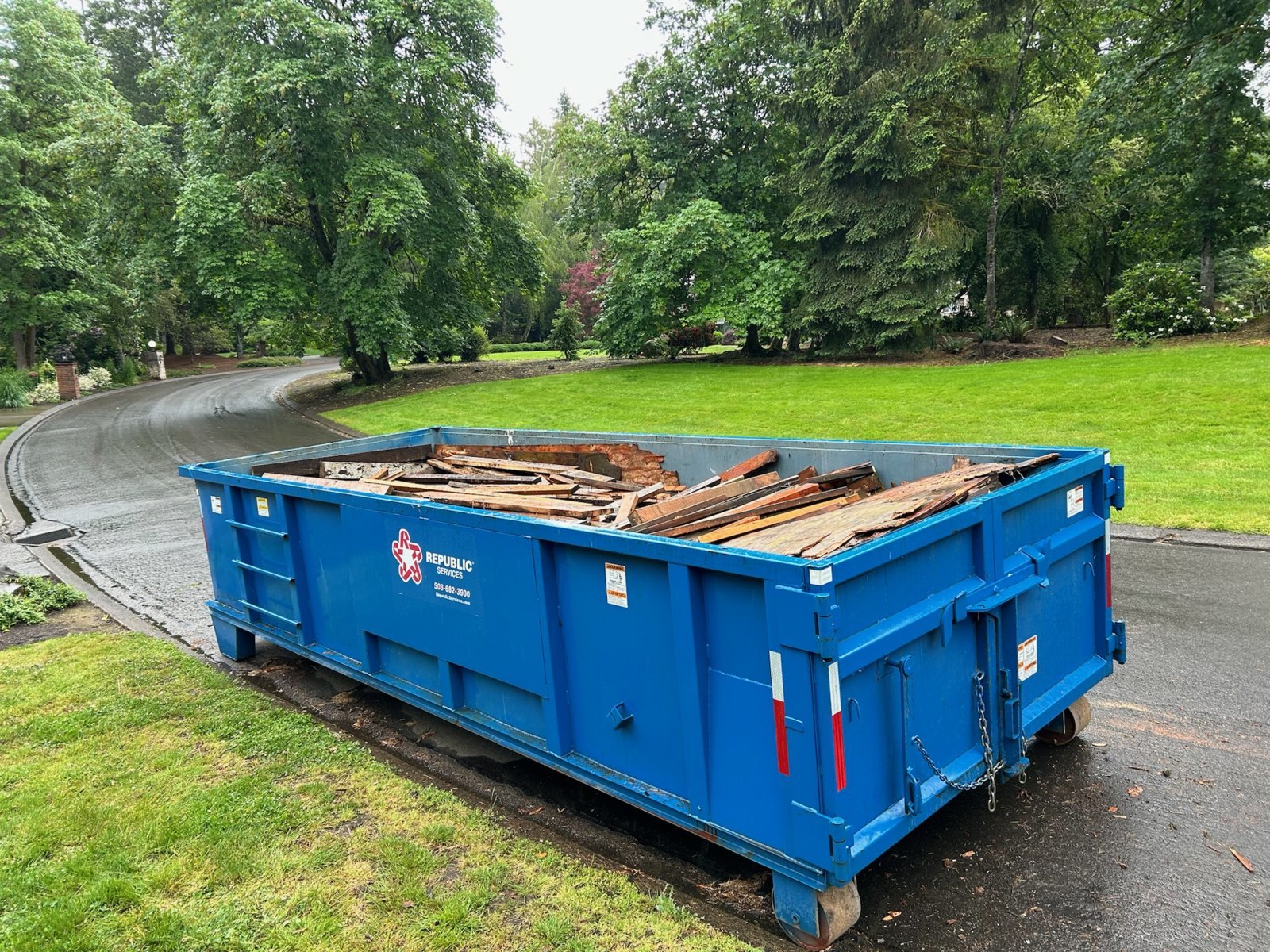

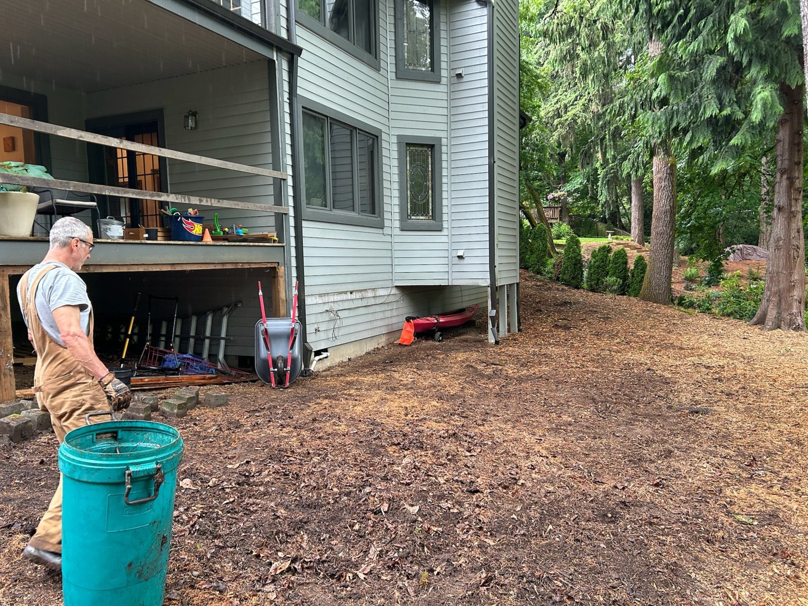

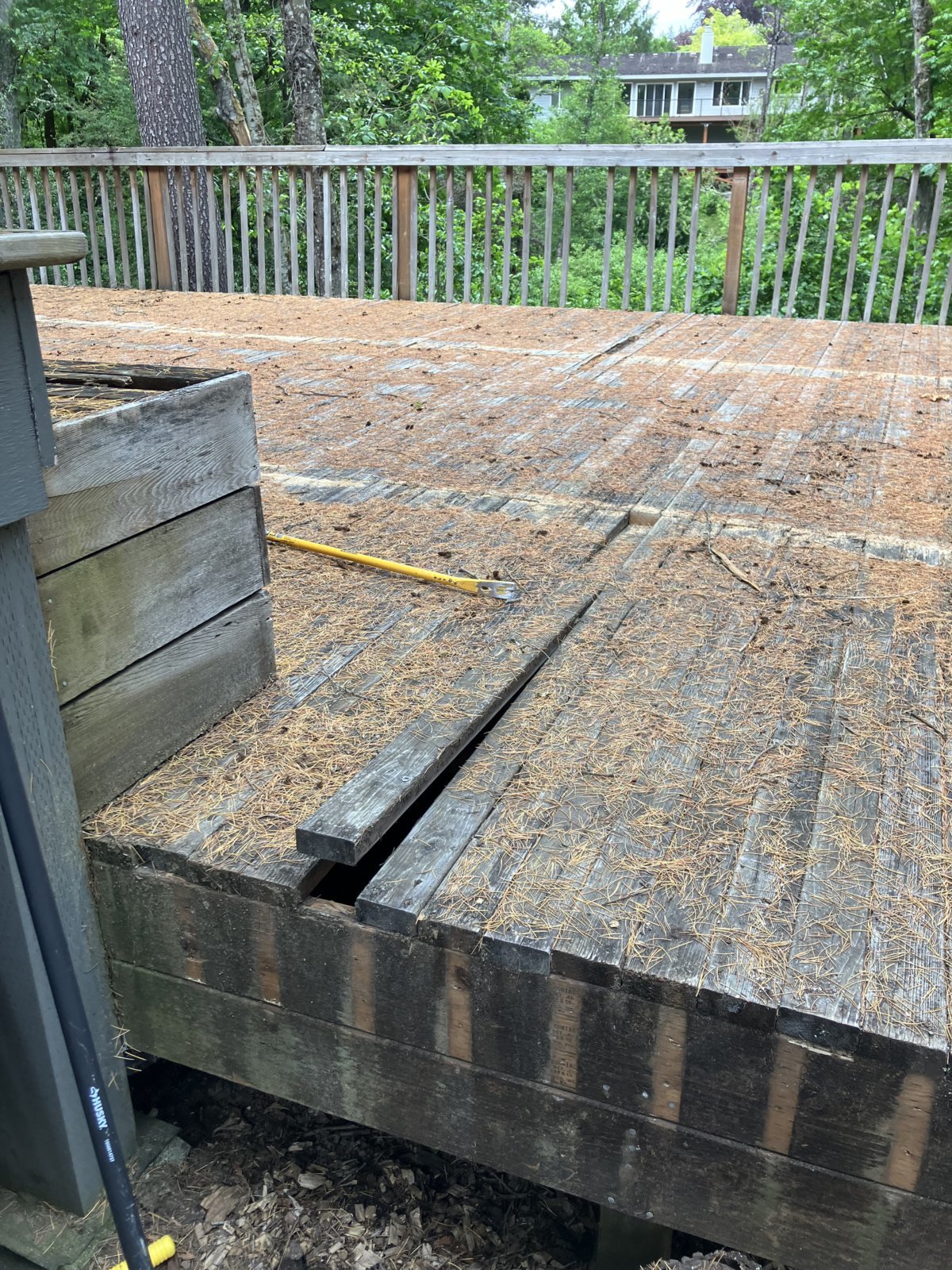

    Bye bye rotten deck.

    Whoa, 2x4's as deck boards. I bet that was solid feeling for a while till it rotted out.

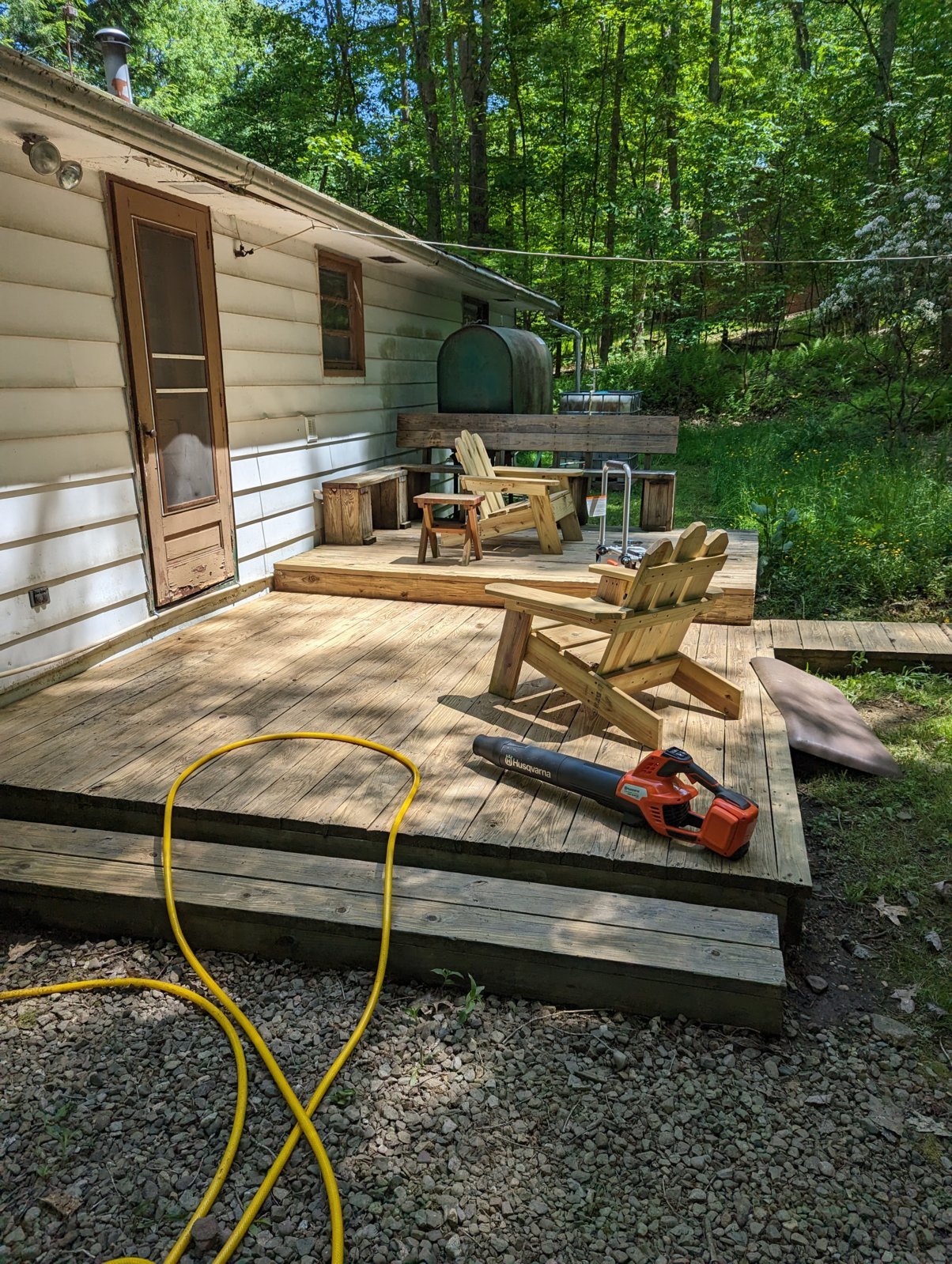

    30+ year old "Wolmanized" deck at camp. NEVER treated with anything....just pressure washed every few years. Looks and feels brand new afterwards. Not 1 single board has rotted!!! Home deck is a different story. NON-WOLMANIZED, but "treated" lumber - this will be my 3rd replacement in about 35 years!!!!
    Forgot....all 2x6s or 2x8s

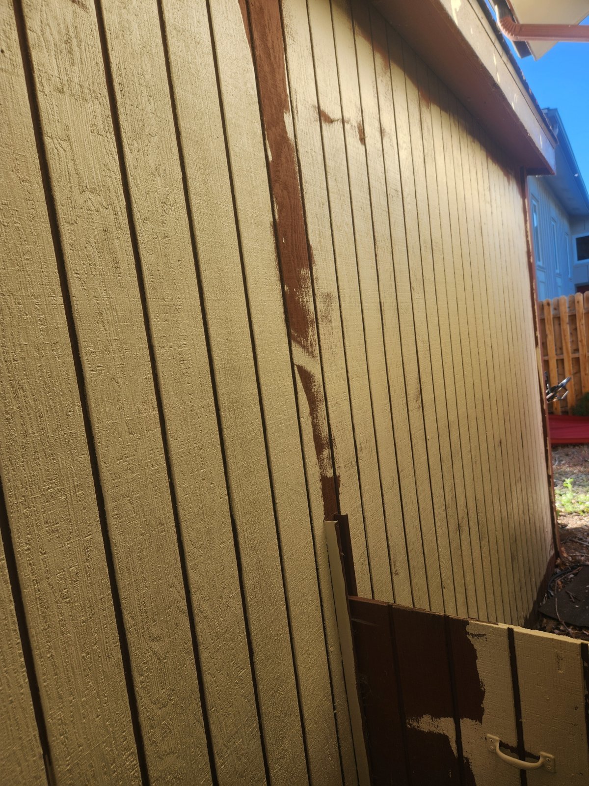

    I told my boys age 10 and 12. "You have to paint half the shed. This is where "half the shed" meets. I'm not sure if that's the DMZ or what? Did they leave it for dad to finish?
    I think I'll leave it. It's on the inside edge of the shed next to the garage. A moment in brotherhood.

    Wish more kids had to do this chore.
