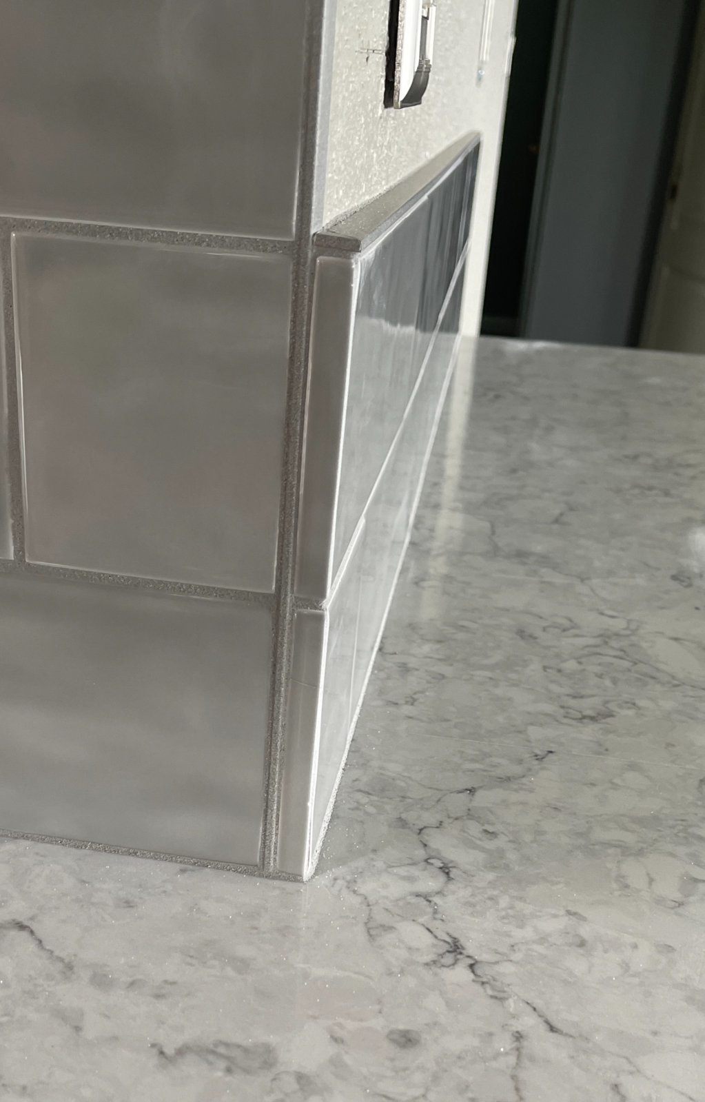

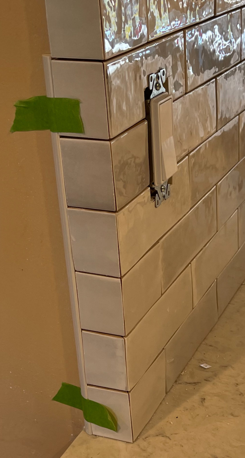

    Alright boss, I see what you're saying now. I have this tiny diamond disk for my dremel that I used to make small cuts for the outlets. I might be able to pick up a few more grinding wheels and use that. Oh boy those are going to be a lot of tiny miters to put the edge back on the tile. Guess I need to just send it. I'll post my successes and failures when the project is done.

    Just try a few cuts and fitting miters dry, see how you like it, always have some waste either way.. project is looking awesome!!
    You can also get a diamond file or tile and stone specific sanding at Home Depot or Lowe’s in the tile tool section.. same technique to just run back over saw cut to smooth out

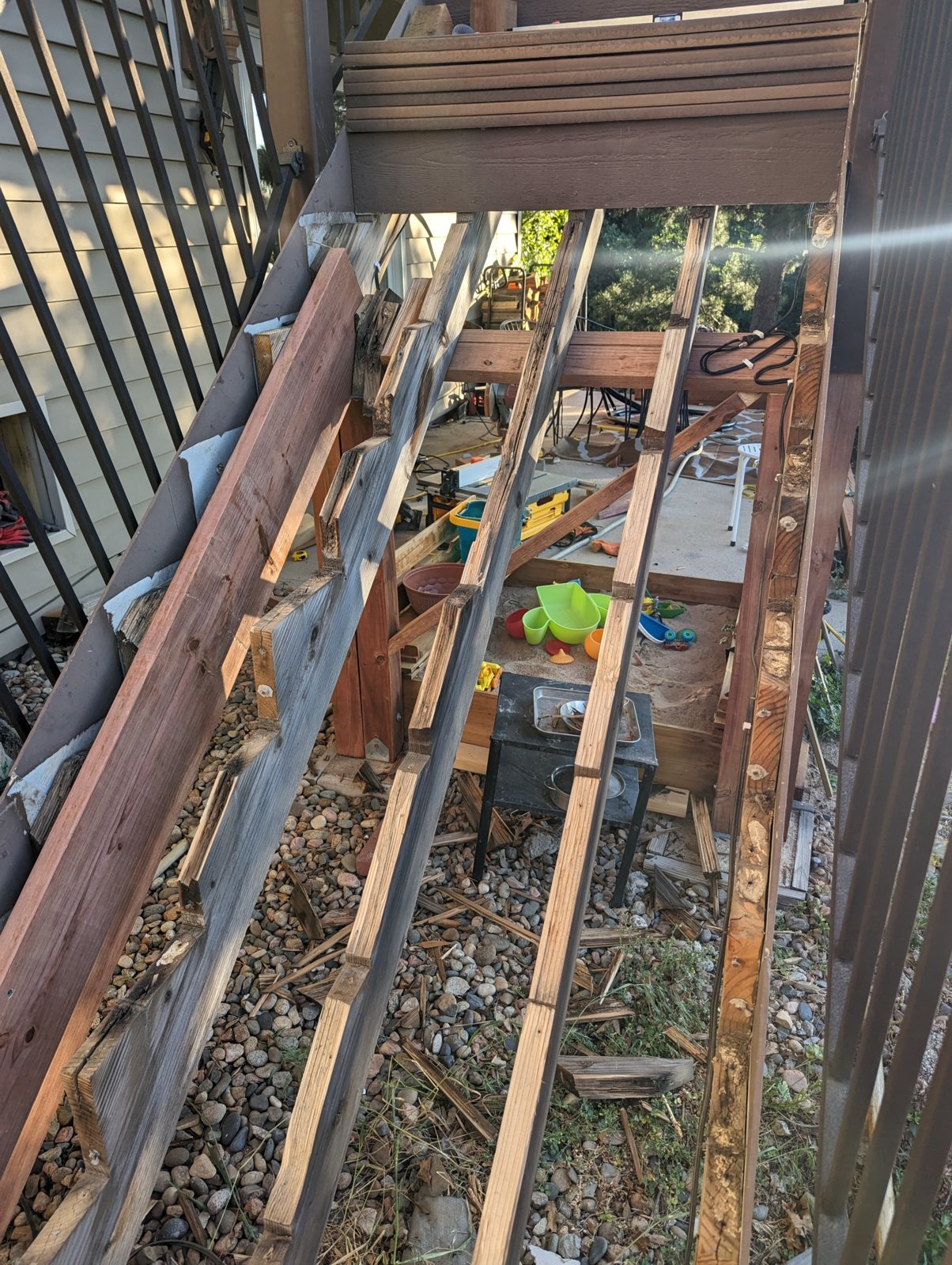

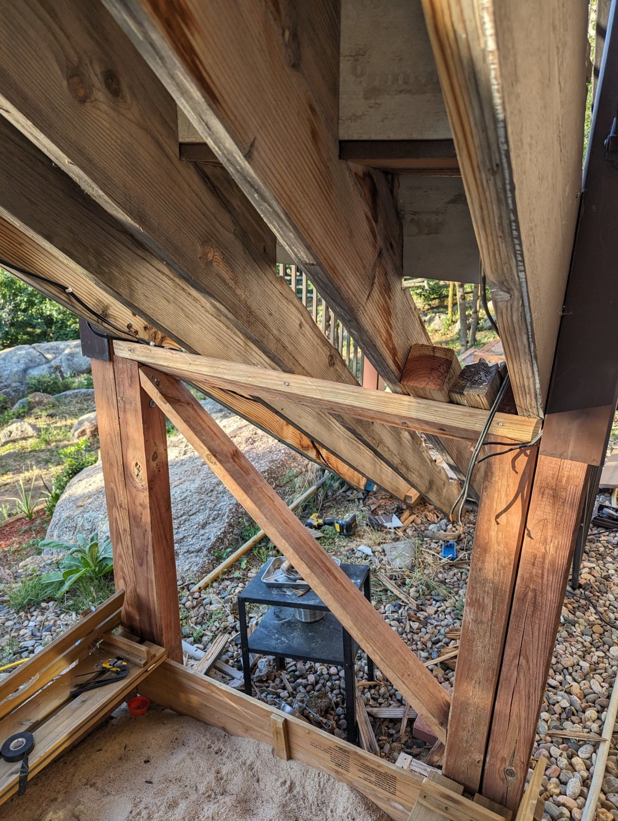

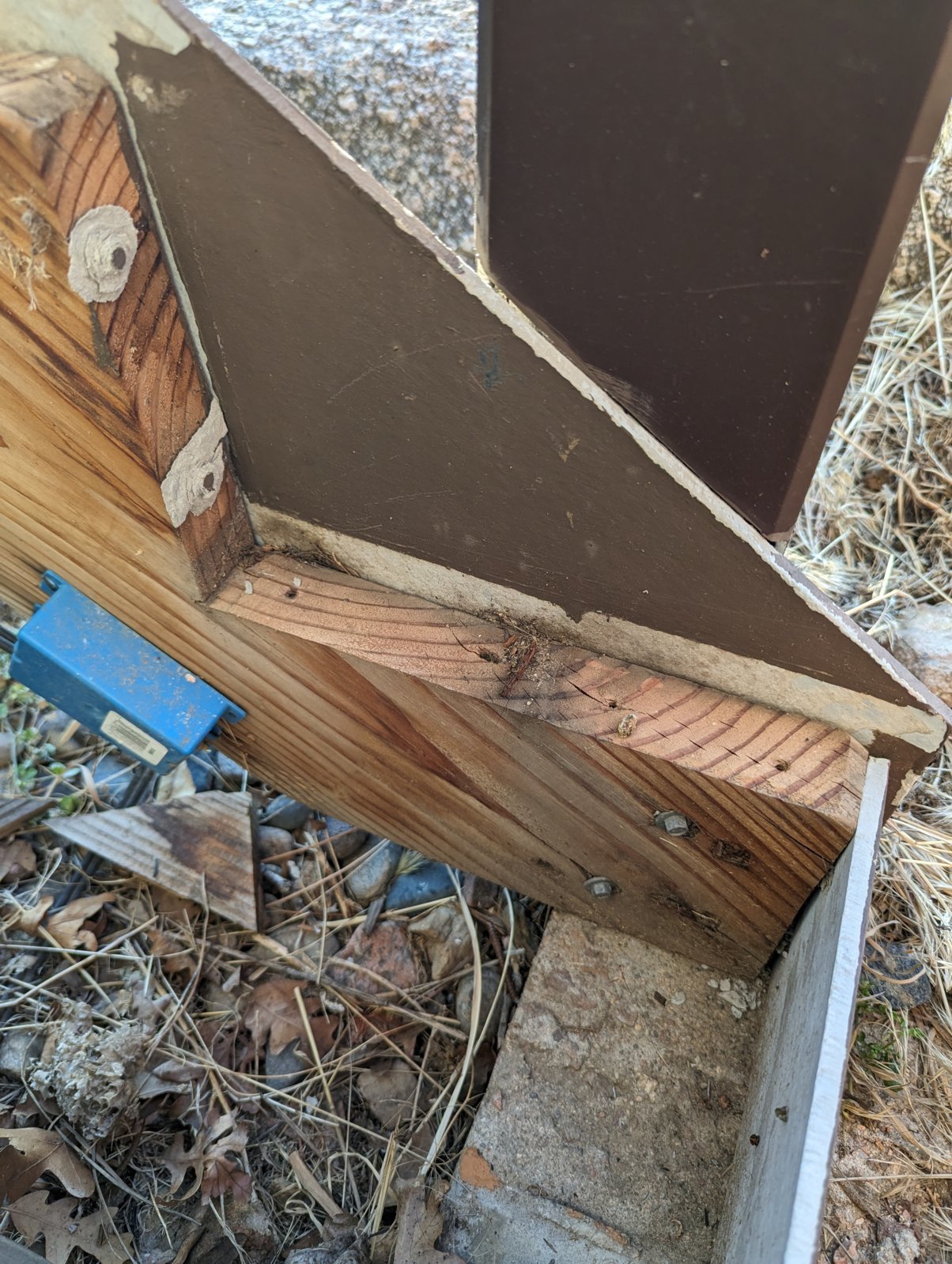

    I have a outdoor staircase that needed some posts repaired. I'm really happy with the initial results. But I ran into a problem and need some advice.
    Unfortunately, when I tried to fix the posts at the bottom, I found out that the problem is much worse than I expected. The stringers are completely trashed. As I pulled the steps off, the stringers would just crumble.
    The concrete slab that the stringer rests on doesn't completely cover the base of the stringer. It looks like some of the stringers may have prematurely failed there. What should I do? Note how the end broke off in this last picture.

    No expert here, but if I was in That situation I’d probably pull all the stringers and trace them on a new piece and just replace them all. Maybe put a paver block where each stringer lands so you don’t get the water rot issue again.

    Find your most intact section, measure the rise and run and make new stringers. There's no saving those.

    Id dig out behind it 6 or so inches, add concrete and replace stringers

    Cut new stringers. Add 1/2" to the tread so the heel of the stringers lands on the concrete.
