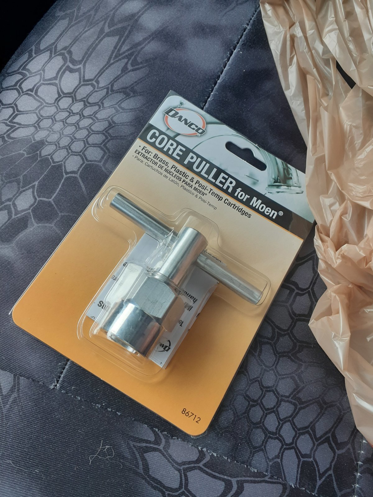

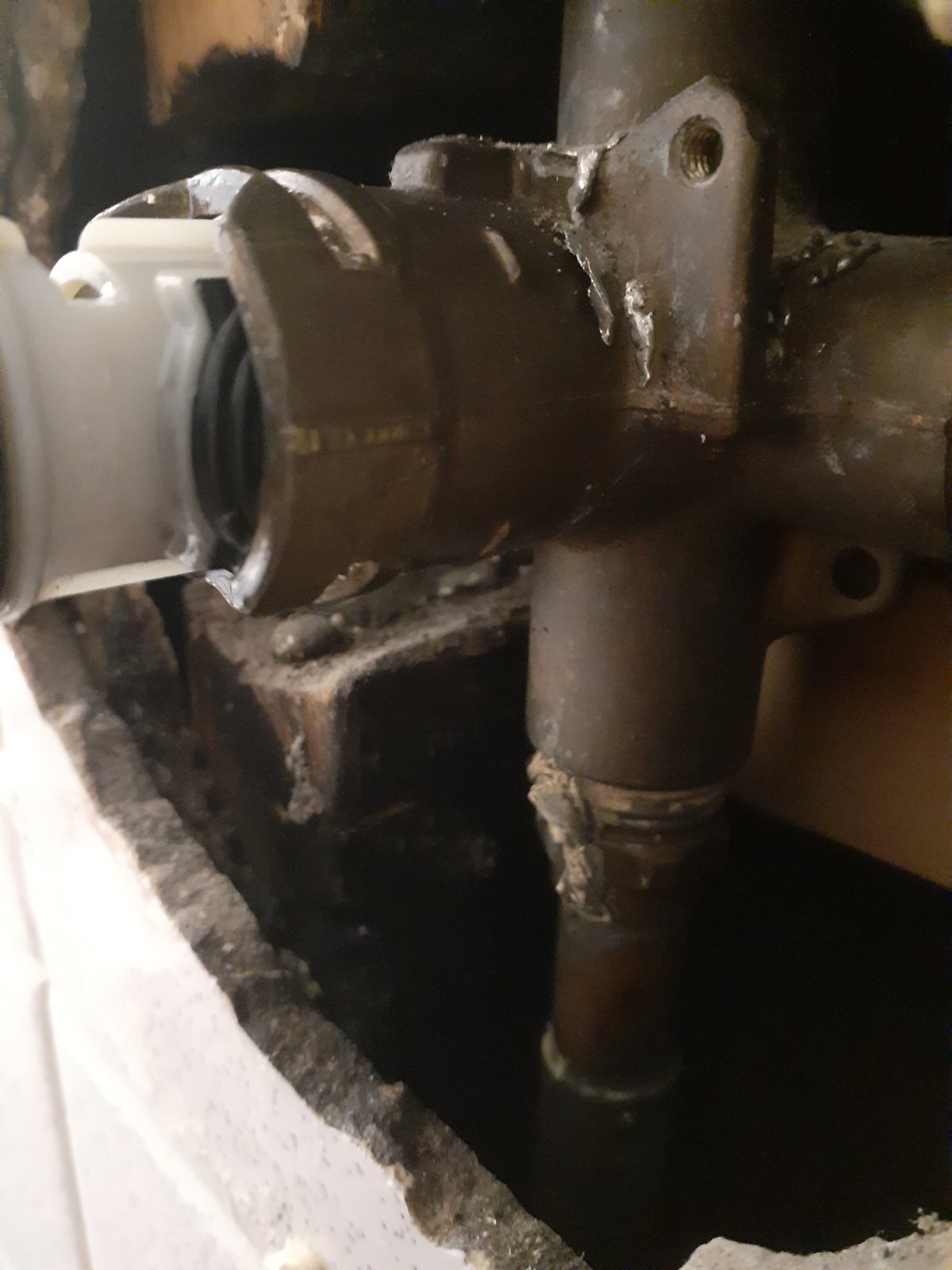

    Glad you like that. Thanks for the recommendation, just got back from the Home Depot did a little research got lucky and found this tool for 16 plus tax.
    I will update on the effectiveness of this little tool.

    "Faucet cartridge removal tool"
    If it's mineral buildup around the o rings some distilled vinegar or CLR should break that up and convince it to break free.

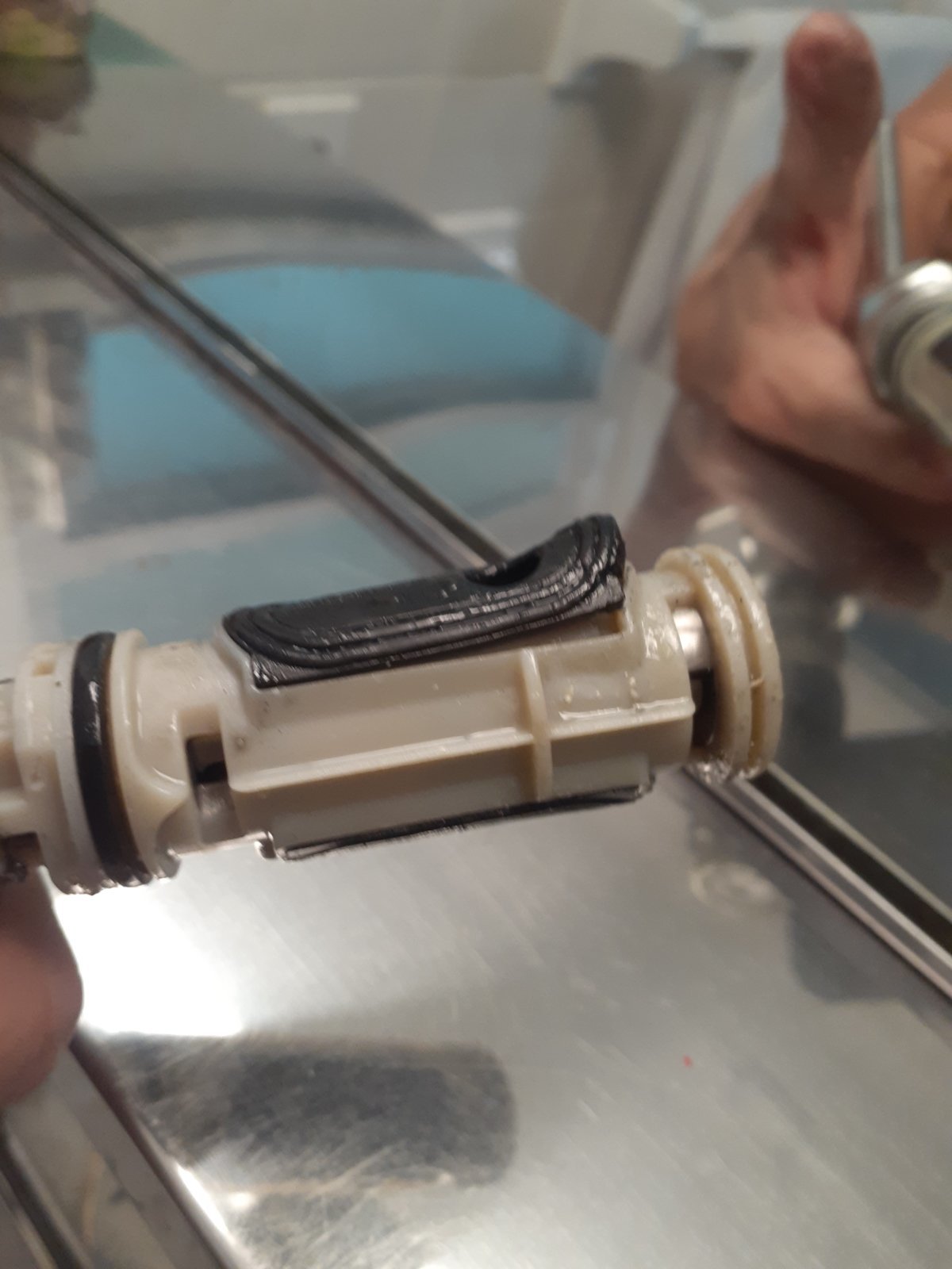

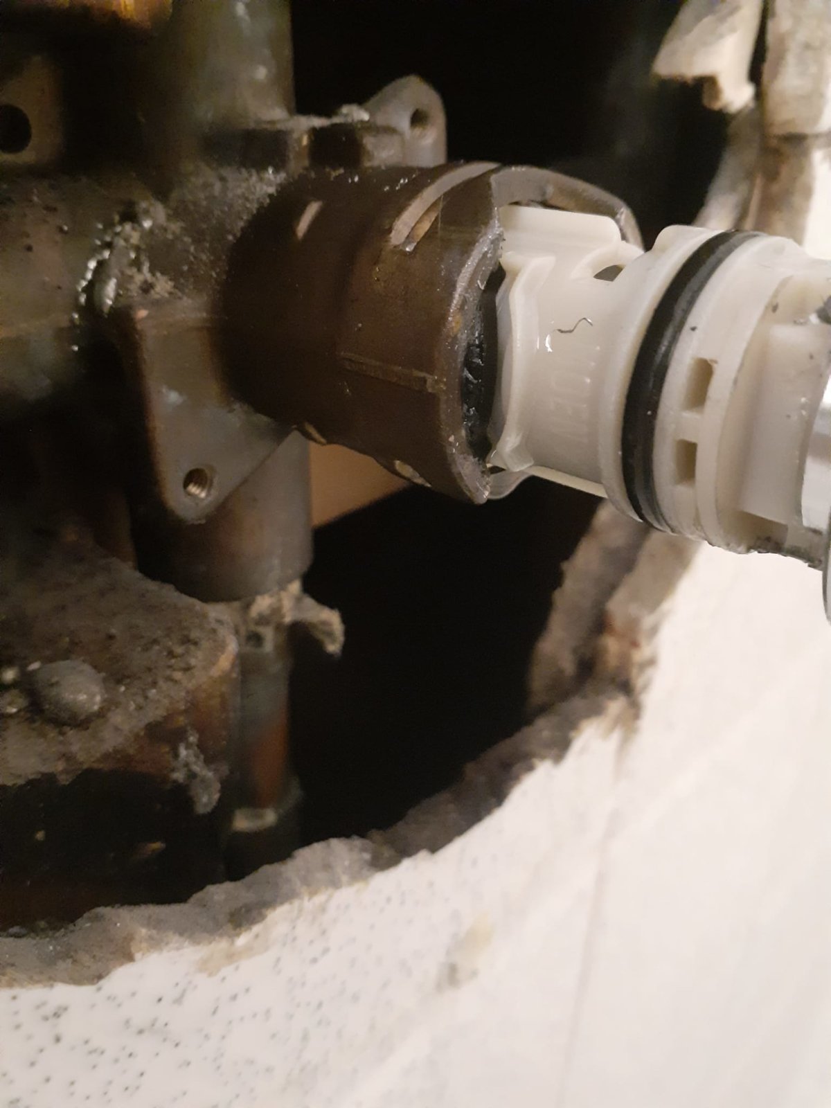

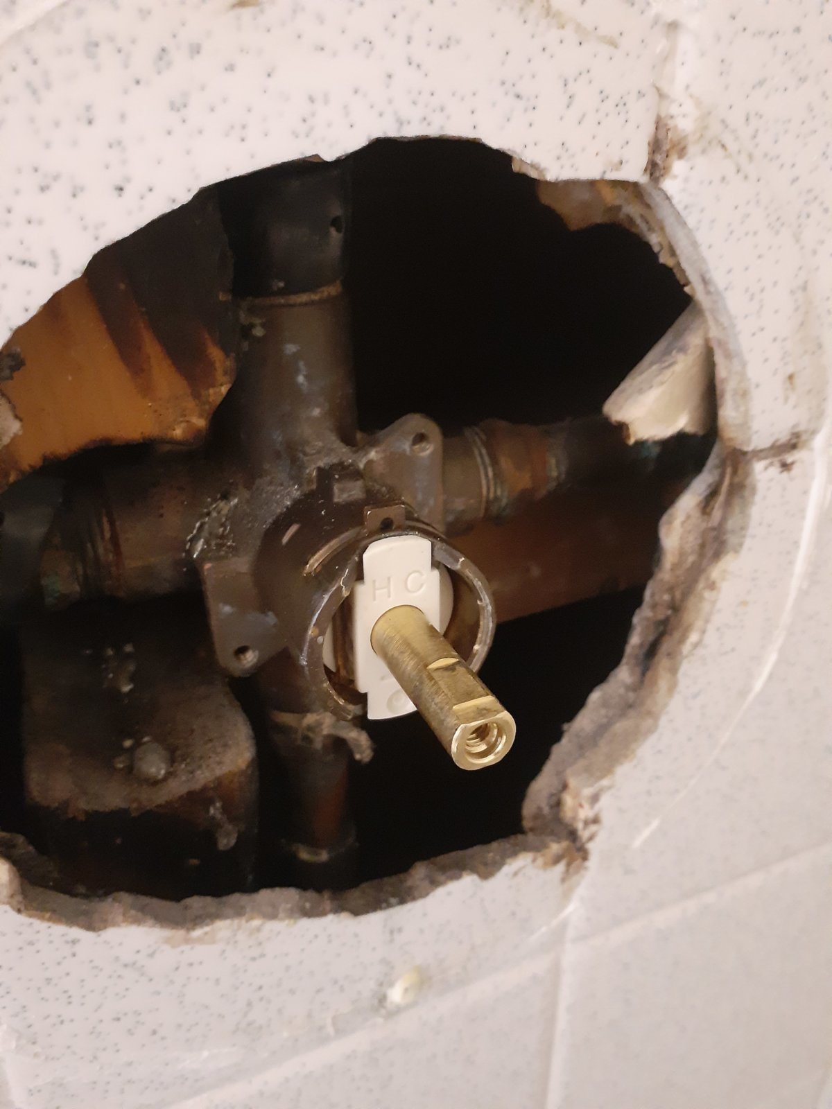

    Well that was scary. Job complete. Tool was definitely needed, 1/2 through pulling it out I panicked, old cartridge would come 1/2 out then come to a hard stop. I couldn't get any torque on the tiny tool to give it a man-sized heave. So I kept giving it the ole in-and-out, and at the end I was having to whack on it pretty hard, real hard with the dead-blow hammer to get it back in, I could see the issue the rubber seal was out of place so I figured would need to pull with enough force to cut the rubber on the extract. Luckily I think it went close enough to its proper position on one of the ole-ins and finally the last ole-out it came out.
    You can see in the pics the left side rubber had shifted, right side was right there. This must have been pretty old cartridge for rubber to get all bent out of shape.
    Don't you just love opening those clam-shell packages?
    $75.00 for the total job, plus my time driving to Homey Depot for part and of course time on the job, clean up, etc. Probably took 3 hours, geesh.
    Cheers, thanks for the replies with suggestions. :thumbsup:
