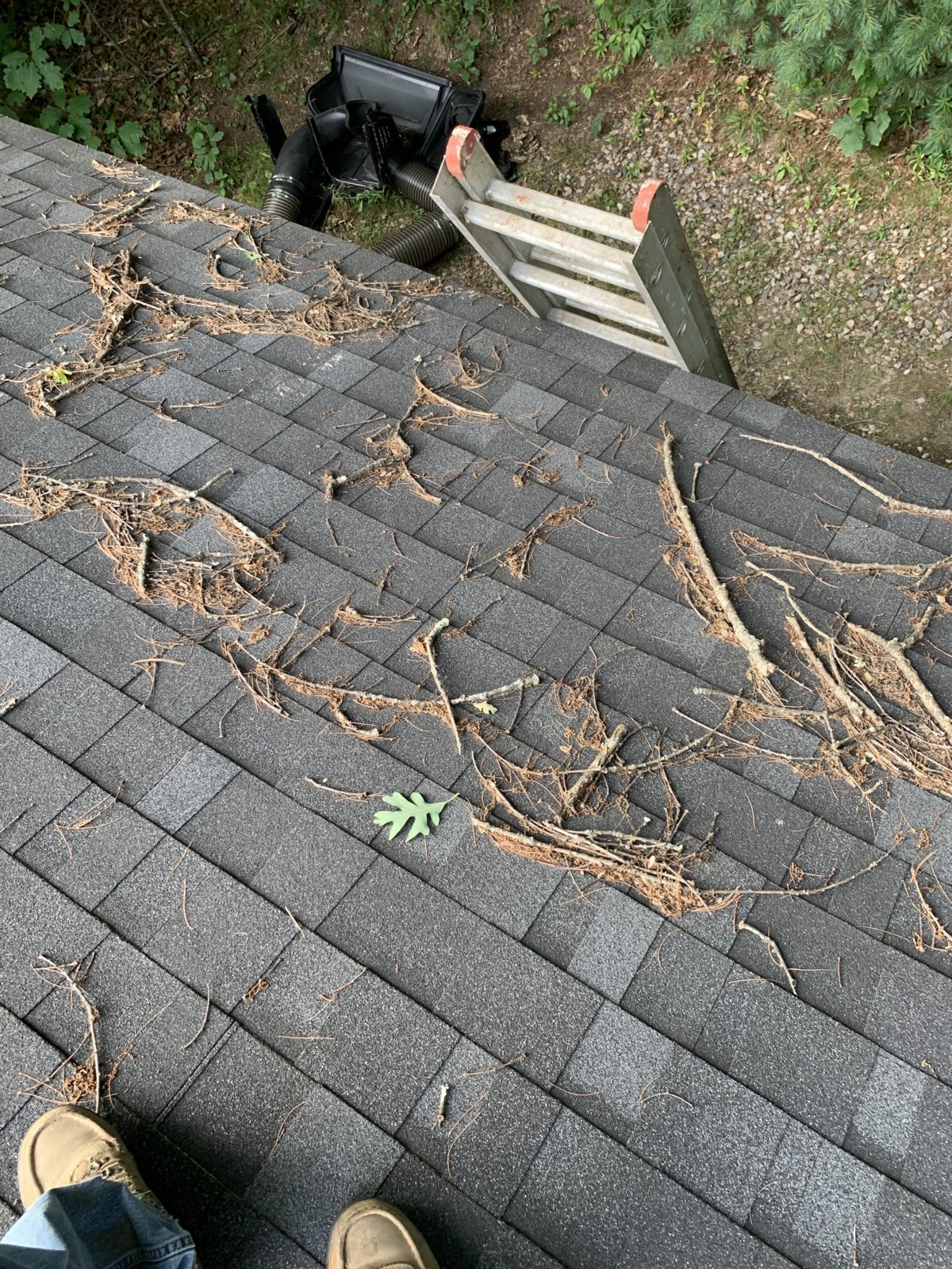

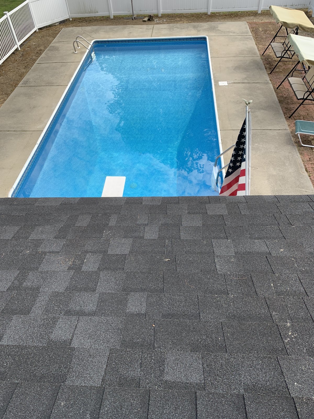

    Sweeping all the sticks, pine needles, and acorns off the back roof of the shed. It’s hot up here. I think I can make it!
