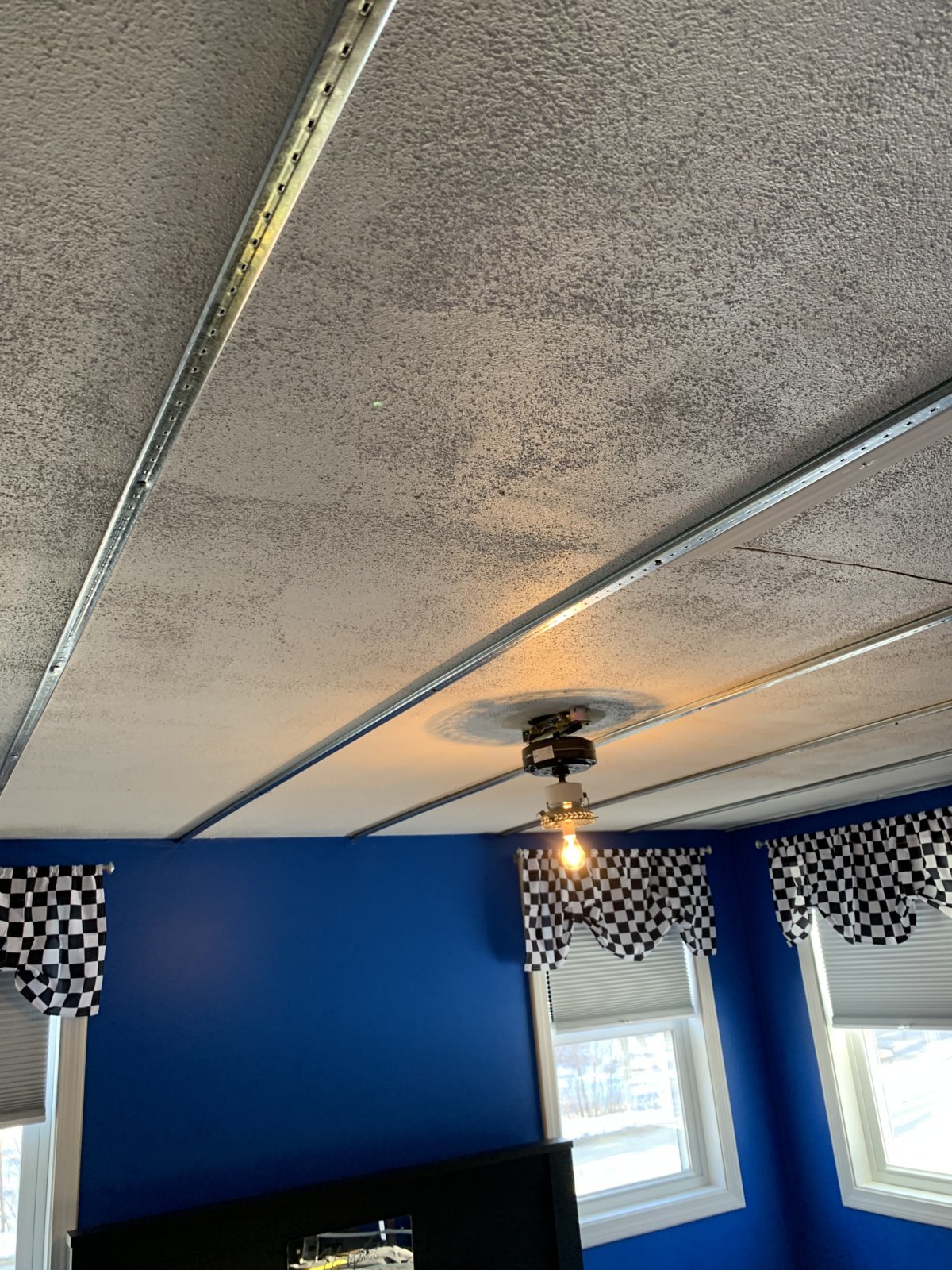

    Probably not worth it if you plan on gutting it but if you wanted to cover up the ceiling without the drywall dust you could use Armstrong ceiling planks. I used them to cover up an ugly heavy popcorn ceiling.

    Did this in a weekend. Screw these tracks through the the ceiling into the joists.

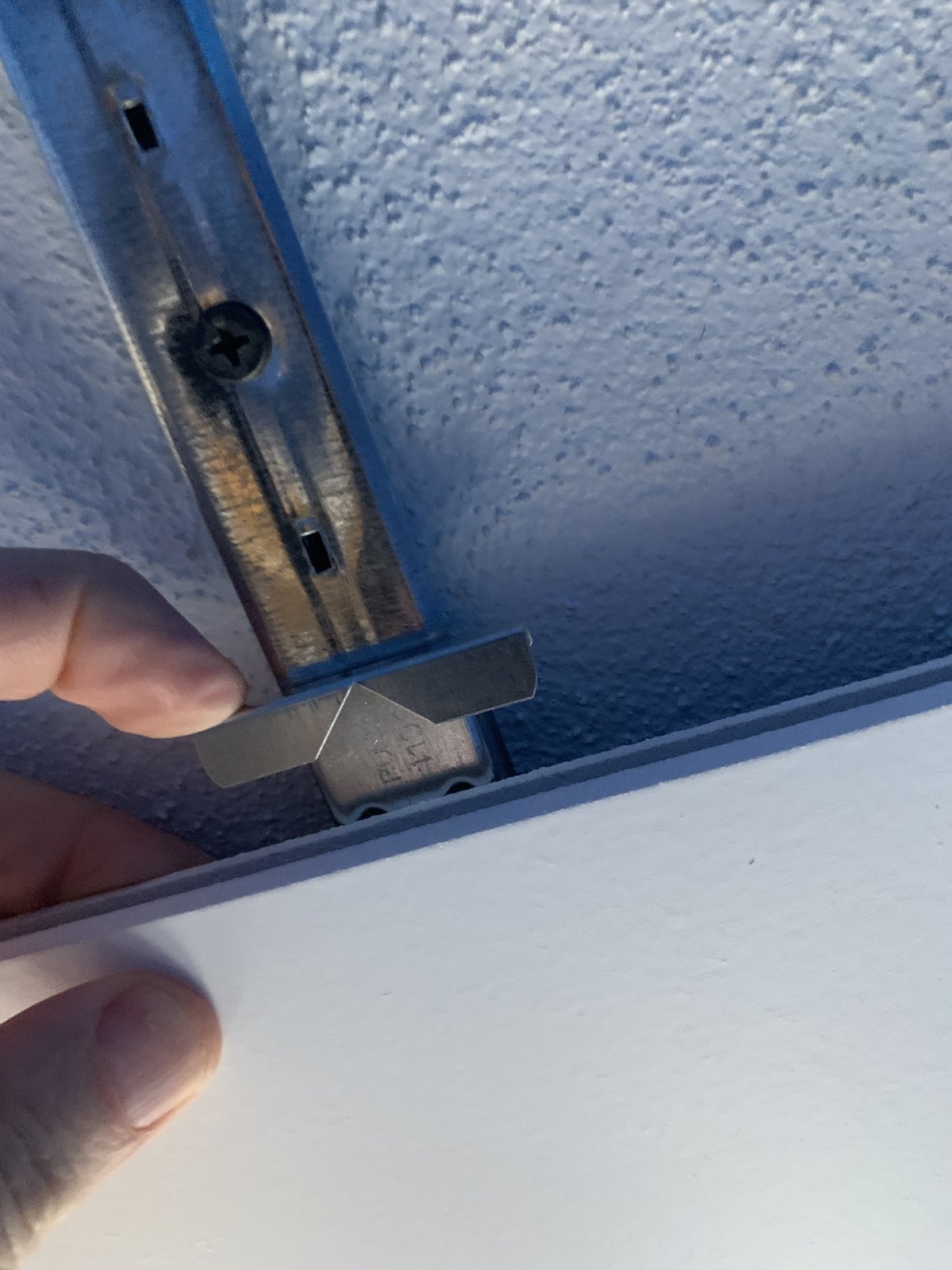

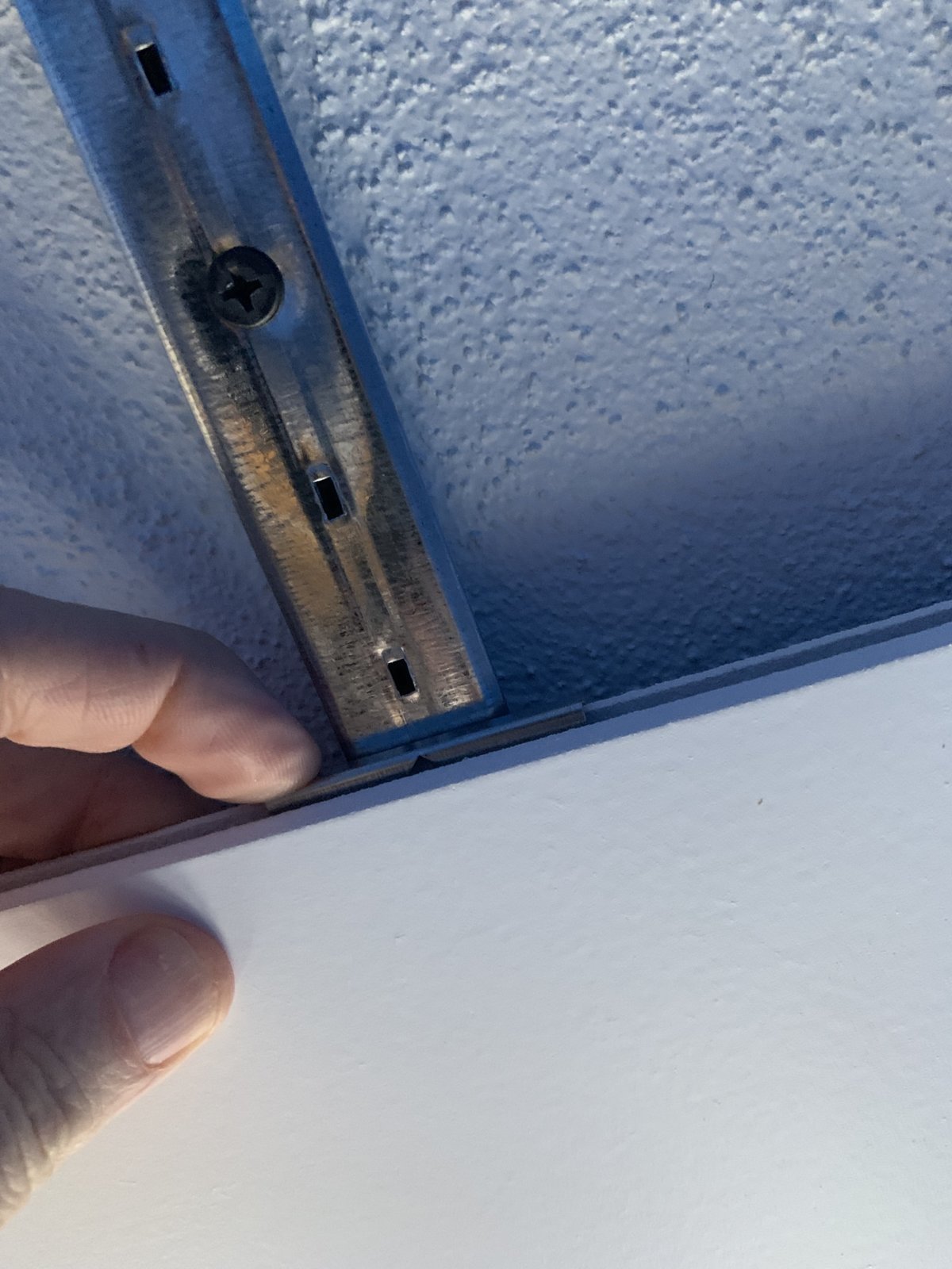

    Then these clips snap on the tracks and slide into the grove of the plank. It’s a bead board style ceiling. No nails next board slides into that groove and clip and repeat until the end

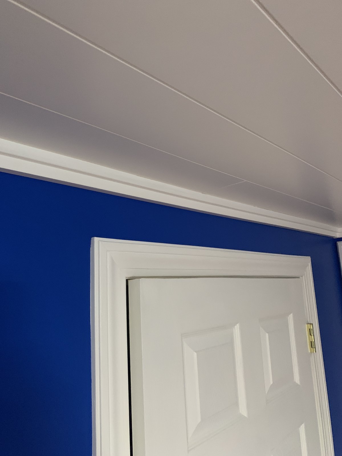

    Only had to nail a trim/molding around the edge. Not into the ceiling but into the wall. Have to leave a 1/2 gap around the whole ceiling so this covers it up. I just used two different size flat trim.

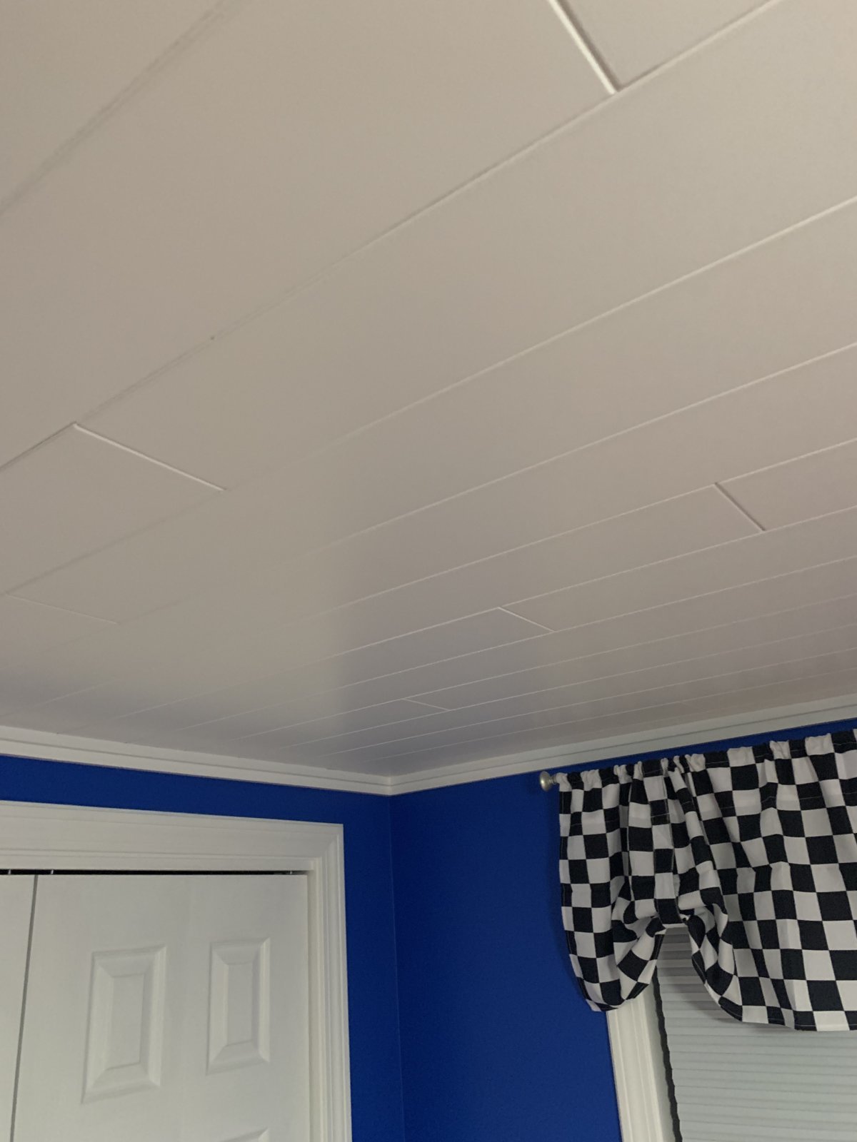

    It’s night time so I can’t get a good pic without glare from the light

    Looks yellow in the last two pictures but it’s a satin white. It is paintable though.
