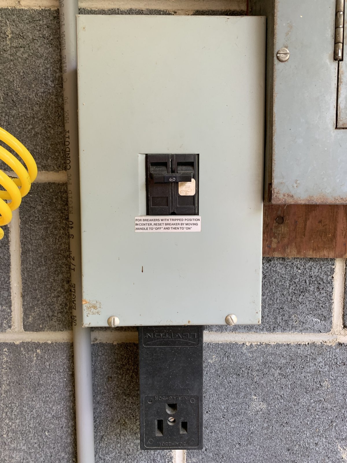

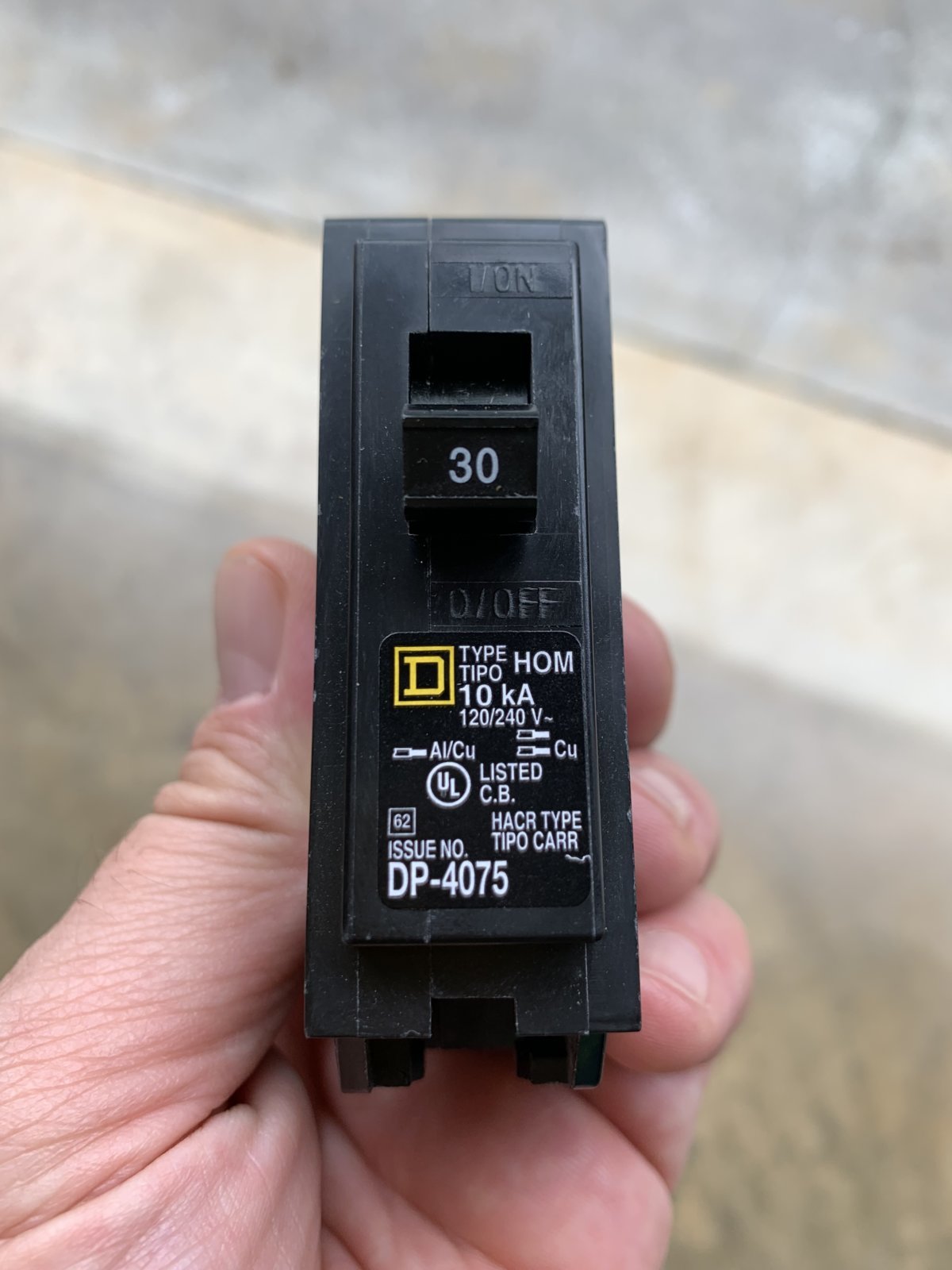

    This is currently a 240v (220V?) 60 amp breaker. Do they make a 30 amp 120V breaker that could replace this one as far as size? I know the wiring will be different.

    You'll have to go with a single 30 amp and just get a blank for that brand box.

    That’s what I was thinking. The guy that was going to do it said I had the wrong breaker, I don’t think I do. This one should fit in the main box or the sub-panel, right?

    If you have a SquareD box then yes, I'm pretty sure. There's several brands that style breaker that are somewhat interchangeable (Siemens/Murray, Cutler Hammer, GE) and will snap in, but I would recommend sticking with whatever manufacture the sticker inside that box says.

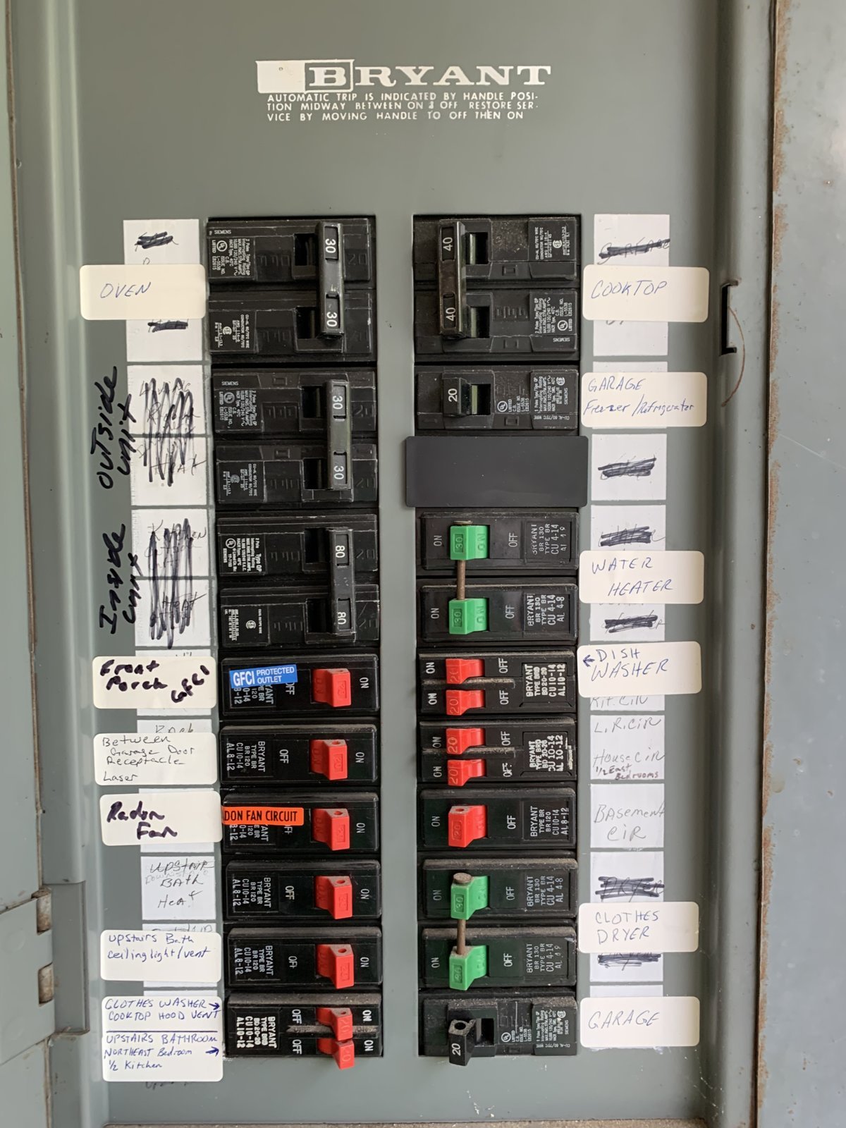

    Bryant
    not sure what the sub-panel is

    Ooof, that's an oldie with some mixed breakers. Not even going to get into that...
    Pop open the cover to the sub, find the manufacturer, and go from there.

    that looks to be a generic included-with-enclosure breaker. they're typically ITE style, which normally the siemens breakers fit best. the homeline breaker you have might work, though i've had some enclosures that they won't, and a siemens fits better without alteration. it really comes down to the buss bar style within the enclosure. siemens breakers have an additional recess just behind the fingers that grab the tab--the homeline doesn't, making it sit proud of the enclosure, with minimal contact.
    that panels top half has been updated with siemens breakers. i would highly recommend considering updating the rest of them, at the very least, the two 30A pairs with nails in them, with actual 2-pole 30A breakers. though it's really about time for a panel change...
