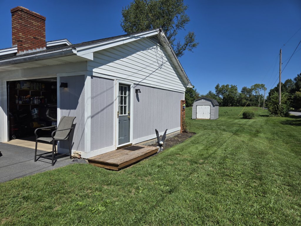

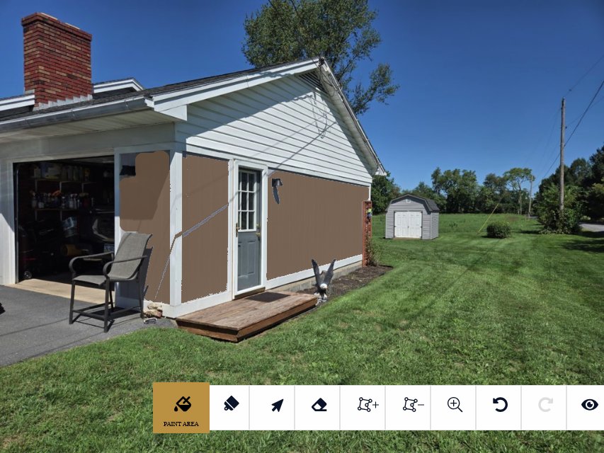

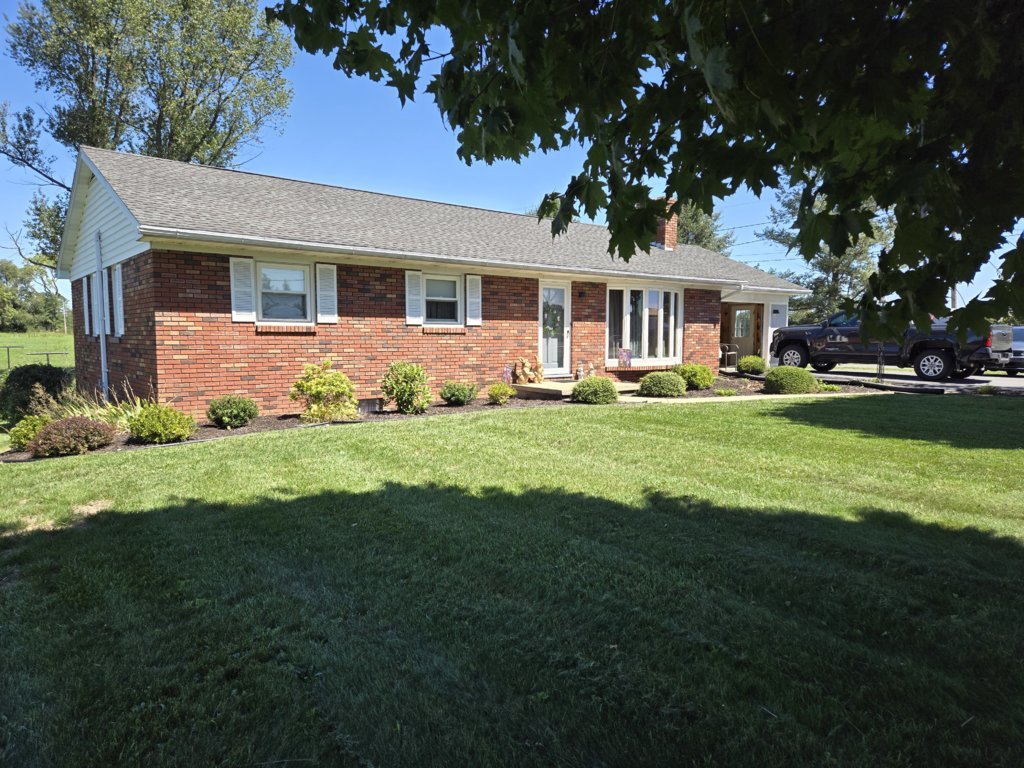

    So maybe yous guys can help a feller decide. I want to change the color of the garage siding. I'm thinking either a green or a brown. I really like green, but not sure it'll match the brick.
    Brick color

    The worst free, online photoshopping ever.

    Hmmm, that looks like the manuer spreaders got to the garage. o_O
    Green might be it then...

    Sure, make more work for yourself. Gray is the best choice. Enjoy the time savings and have a beer for me. lol

    Dark Grey Siding & Black Trim seem to be the thing now.

    So I guess the general consensus is keep what I got. I still have a new gallon of it so I can give it a new coat to freshen it up. Trim needs re-coated as well.

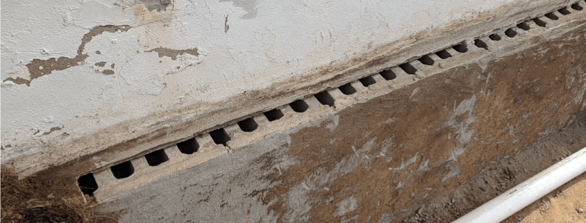

    Got a question for anyone with some experience...
    Long story short, one wall of my house's foundation was installed backwards so what ended up happening from decades of letting the downspouts pour over was what the picture attached showed (the "ledge" made from flipping the blocks resulted in breaking apart). What you see in the picture was fixed after some work on drainage a few years back. Another 10ft or so (to the left of what you see) has not been fixed but I would like to fix it before winter. Can I (should I?) fill the block cavity with something like pea gravel or should I use something different entirely? After filling I was going to trowel on some concrete with a slope and then goop on some waterproofing. Does this plan seem sound? Anything else to add? Thanks all.

    You can fill the block with expanding foam. Build a curb with bricks and mortar. Then seal it. If you just use mortar for the curb, it will crack.
