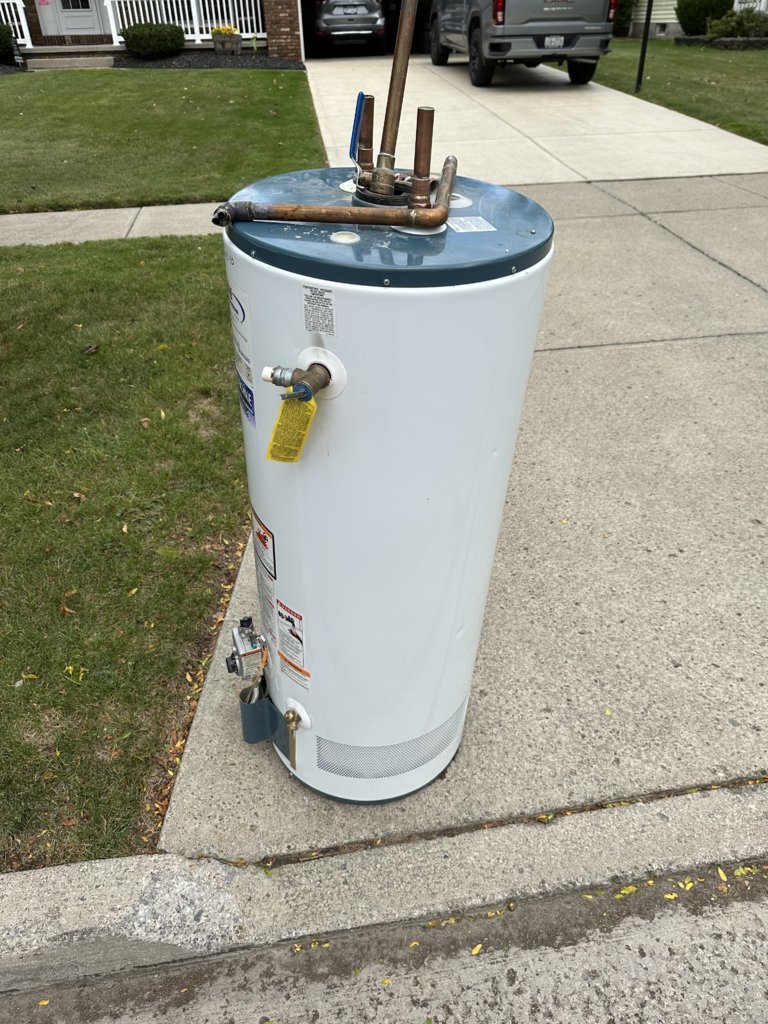

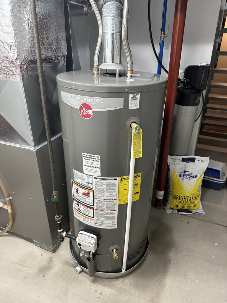

    Went down in the basement last night to clean out my dehumidifier and change the furnace filter. Walk into the utility room and there was water on the floor. Great! Went to the depot this morning. The original water heater I was gonna get I couldn’t find on the shelf. Think it was up on the 3rd shelf. Wasn’t waiting for someone to come with a fork truck and get it down for me. They had this other 50 gallon chilling out in the isle. Box was pristine. But I know better to check because the last time I got one for my old house, most were dented and beat to shit.
    Old one was a 40. Decided to go bigger. Never checked the dimensions of the one I got. Assumed it was the same size as the other one I was originally gonna get. Nope. This one was shorter and wider. Didn’t realized that until after I took out some of the copper. Whoops! Now the flex lines wouldn’t reach. Had to run back and grab some more fittings and sweat a little pipe.
    So the drain pan I got is tight. Also I don’t have a floor drain in this house. Whoever installed the furnace I think just drilled into the concrete and is running the condensate that way. How should I plumb this drain pan up? Run a pump and shoot it over to my sump?
    Also couldn’t find a side mount drain tube so had to make one. Ended up getting the wrong size pex fitting for it. So need to get the correct one. Just stuff the tube in there for now.
    Old ones at the curb if anyone wants some scrap :D:rofl:

    I would run the drain pan over the sump.

    Yea, that’s gonna require a pump. Probably a 60ft run. I might just leave it be and cap the pan. If I flush the tank I use a mop bucket. Takes a while or I could just lay a hose to the sump. I’ve never seen any of my water tanks blowout the pressure relief valve. Unless a major leak were to happen, then I think I would be pretty safe without it.

    Can you plumb a drain to an exterior wall? This is part of the reason I switched to tankless.

    Unfortunately the utility room is in the center of the basement

    you're the same person that asked previously about running the water softener purge line a long distance over to the sump, right?
    you could get a condensate pump like this and route all three-- furnace/water heater/softener into it, which would then carry everything over to the sump.
    https://www.homedepot.com/p/VCMA-15ULT-115-Volt-Condensate-Removal-Pump-554411/204481244

    That punny little pump will not handle a blown water heater or a tpr valve blow off.
    I would cut the floor open and install a 10+ gallon tank with a high-volume pump with a float switch and plumb the outflow to the exterior of the building.
    Just imagine a trying to control a full run hose.

    No that wasn’t me. But they never one on my water softener either. That was the same basic pump I had on my furnace at my old house. Worked well. That’s probably what I will go with

    The purpose of that pump isn't to handle a high flow, it's there to manage a small leak that would overflow your pan if it doesn't have somewhere else to go.

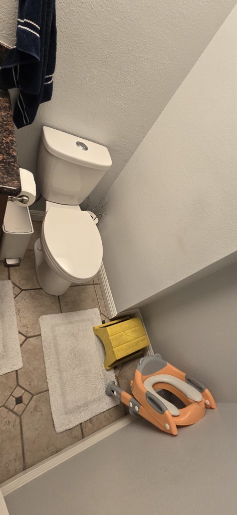

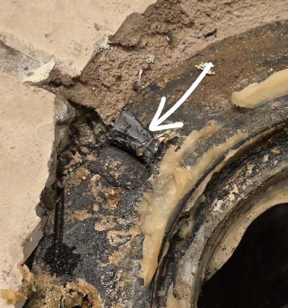

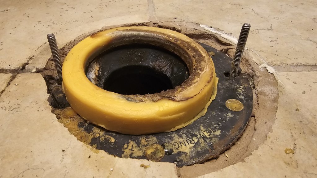

    The last couple years the grout around my toilet was dark. I assumed it was because of my lazy cleaning not getting within an inch of the camode. Then over the weekend I noticed a sheen to it. Wet to the touch. Dammit. Removed the shitter to find about 40% of the forbidden donut wasn't even touching the shitter! Leak was at the 9 o'clock position.

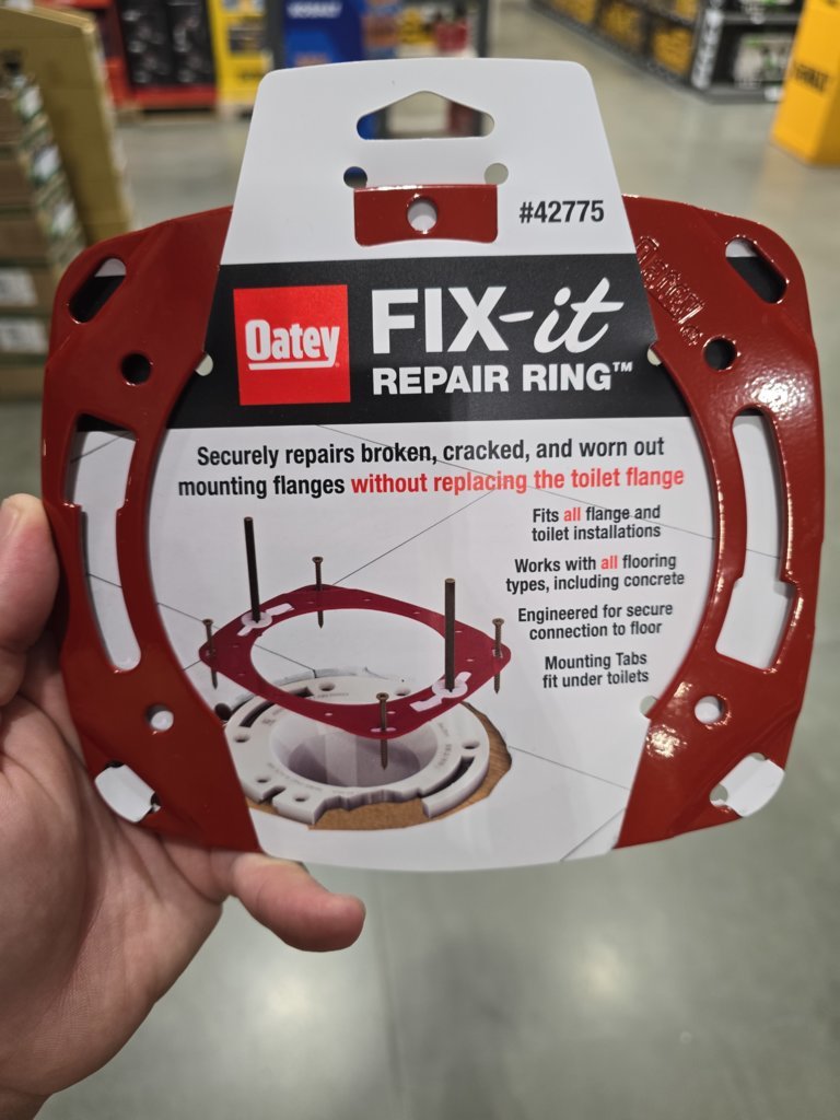

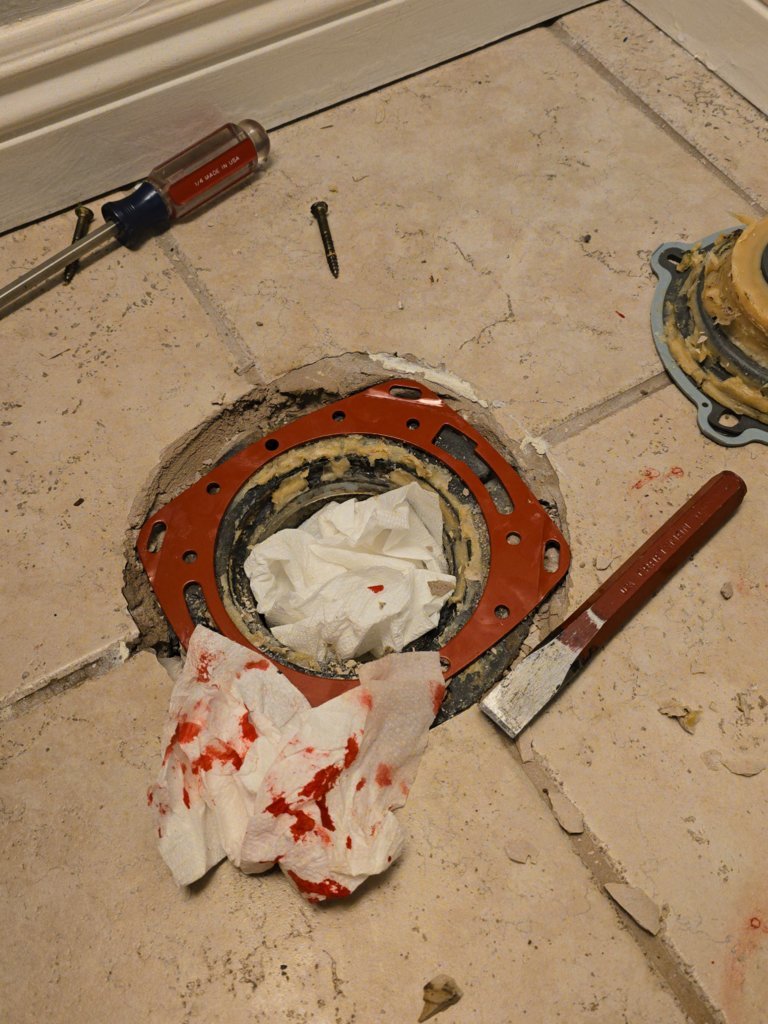

    New wax ring obtained, easy fix. Until the slot of the 40 y/o flange broke and the T-bolt wouldn't torque down :annoyed:
    Ran back to Holmes Depot for a fix, looks pretty easy. :rolleyes:
    Except the damn porcelain tile & thinset didn't give enough clearance. Time to chisel. Shit got sharp. Sutures? Never heard of her. :bananadead:
    Hopefully the new forbidden donut & silicone are good to go :fingerscrossed:

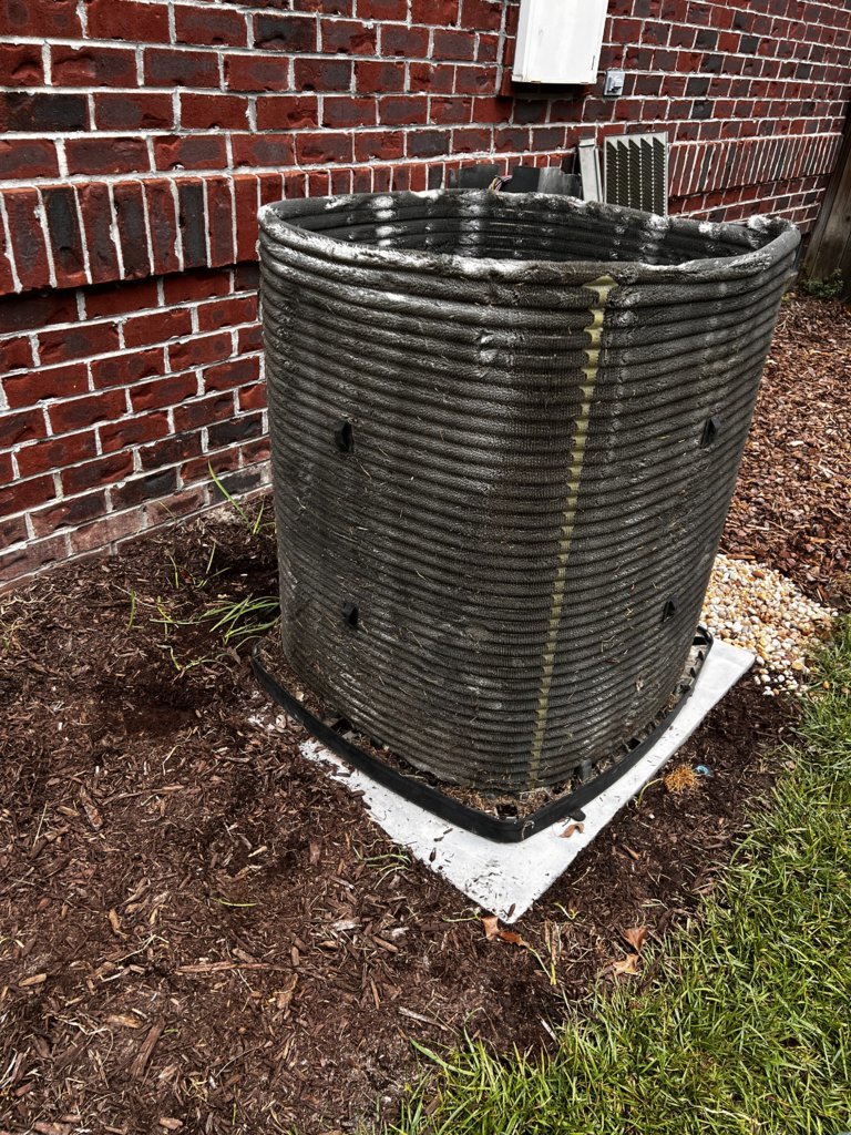

    Cleaned HVAC Condenser Coils
    (3hrs well spent)

    Is that picture, before or after the cleaning...

    I have an HVAC company come out twice a year to service, clean, and inspect my system. This is one of the things that they do for me. Their fee is well worth 3 hours of my time, but what do you think about the job? Is it pretty easy to do? Is this something that I should be doing myself between their visits?
