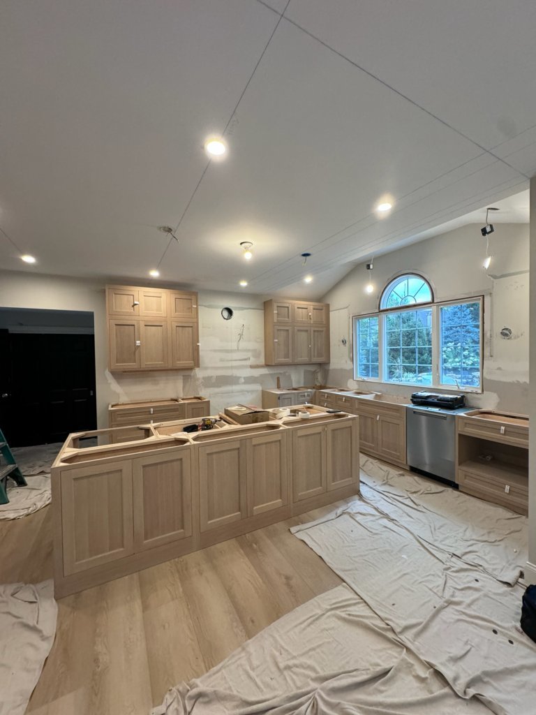

    Quick question to those of you who have hung your own kitchen cabinet uppers. Did you pre drill the holes where the screws were going to go through the back of the cabinets into the studs or did you just use cabinet screws and an impact driver? Have some cabinets coming at the end of the month and none of the DIY vids mention pre drilling holes but I really don’t want to screw up the new cabinets the day I go to install them!

    Cabinet screws and impact driver.

    I pre-drill and use cabinet screws with an impact driver. With screw tip technology these days, pre-drilling probably isn't needed. If the backs are not plywood, I'd definitely pre-drill regardless of screw type.

    What is the back of your cabinets made of? I have a couple of approaches I have used for years (as a cabinet maker/builder). My priorities
    1. Make sure you are attaching to wall studs. Pre mark wall and back of cabinet.
    2. Make sure your screws are completely supported for entire length of the screw.
    3. Use large head screws 5/8” or larger.
    FASTCAP PHZ8.3-inch-50PC PowerHead 3-Inch Cabinet Installation Screws, 50-Pack, Zinc
    4. I usually built a jig (scrap 2x4 box at correct height) for cabinet to rest on while I mounted them.

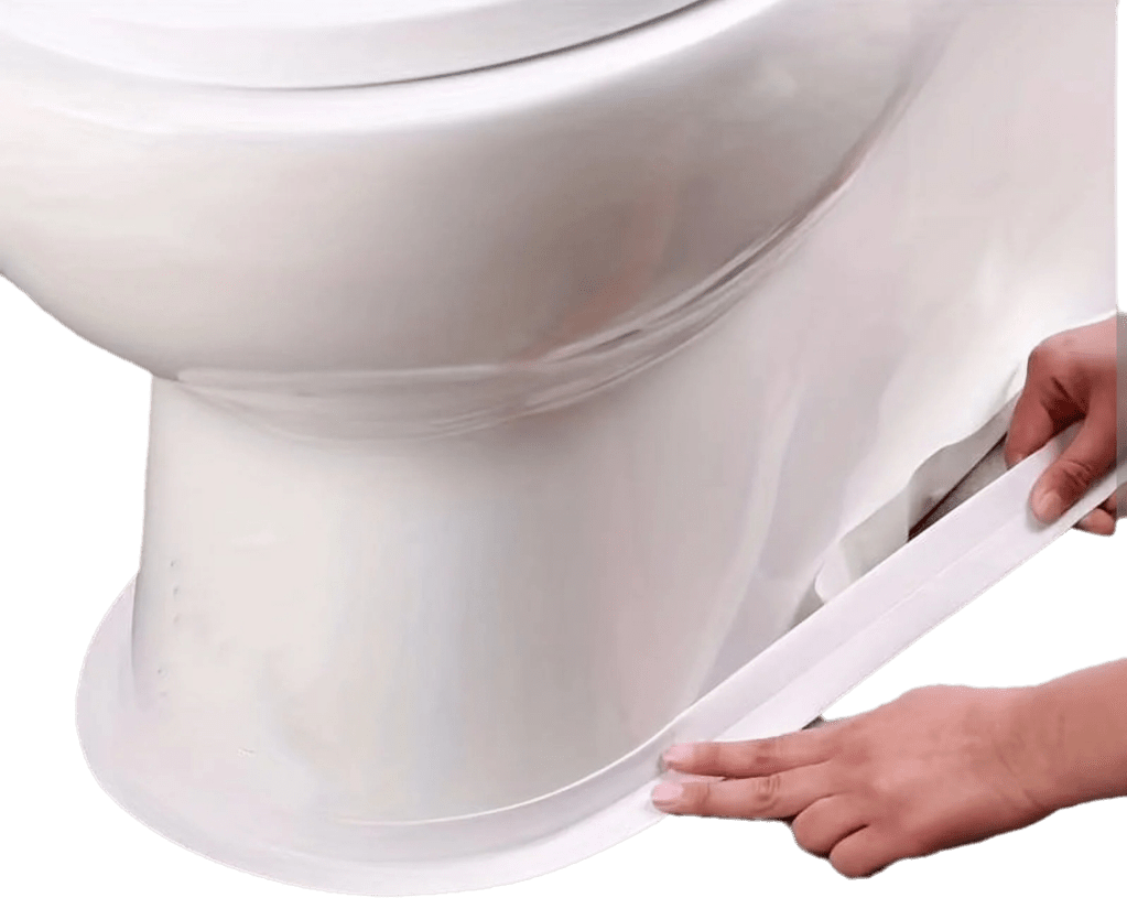

    Is caulk tape just smoke, or a legit product?

    I've never had a use/need for it and I certainly wouldn't try and stop any toilet leaks with it as shown in that picture. What project did you have in mind for it?

    Never heard of it.
    Never seen any professional (or anyone) use it.

    Previous owner used it at base of tub. I’m sure it worked for a while but shortly after moving in the glue failed and trapped ever spec of dirt floating around on the bathroom floor. It was a pain to clean and more of a pain to remove and replace
