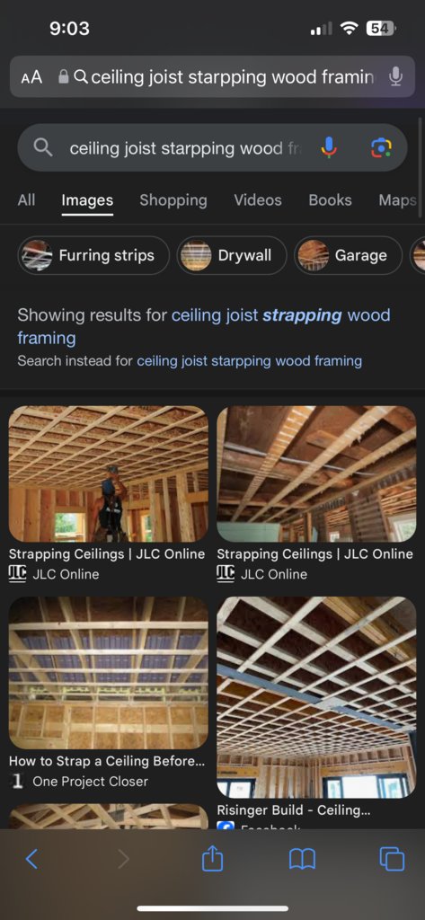

    Finally getting around to working in my basement. It has a full drop ceiling I’m tearing out.
    what is the best option for routing electrical and such that has been previously above the drop ceiling but below the floor joists, if I’m wanting to leave the ceiling exposed or possibly put drywall up? I’d rather not drill holes through floor joists.

    In the northeast in particular they often would put 3/4 inch slat wood along the floor joists underneath to drywall off of. In my house, that allowed space for wiring to be run under the floor joist without drilling. I’m also going from a bad drop ceiling in the basement to fresh drywall and gaining back some height but in my case almost all my electrical is being redone and plumbing has been redone as well so I can make changes that made sense for my planned ceiling.

    Can you specify, 3/4 inch slat wood, just like pieces or full boards? Basically just to act like spacers I assume?

    1x2 or 3 (so 3/4 x 1-3/4 or 2-3/4) running full length of the room perpendicular to the joists
    it acts as the edge support of the drywall the way the joist would
    also allows you to get a flat ceiling
    open beam might require all electrical to be redone in conduit depending on room designation

    Should have used the word strapping, that’s more accurate to what they’re doing. I’ve attached an image to give a better idea.

    But where does the electrical go in those photos? If the strapping is so thin you wouldn’t want to go through it would you?

    So your electrical can still go along the floor joists and instead of drilling or cutting the joists, you can feed the wire under the joist and around the strapping to get into another joist bay. Following code, you shouldn’t have a closed (drywall) ceiling with buried electrical boxes so you need full runs of new wire or you need an access point to have access to an electrical box you might have.

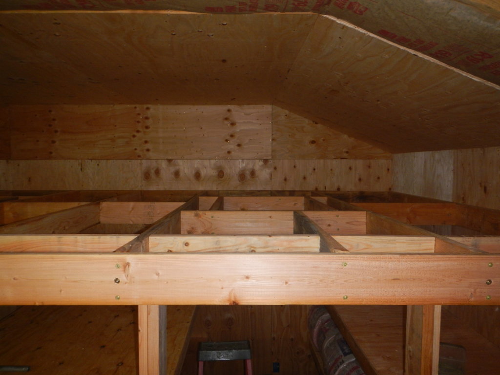

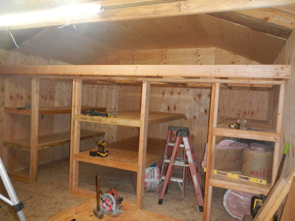

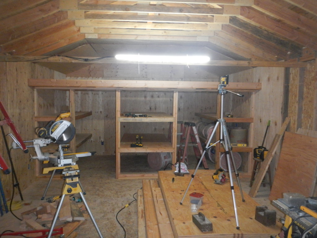

    Got the shelves and loft framed. 1/3 of the shed almost done. Wife says we can house some migrants in this thing (JOKING). Time to sheet the loft and front.

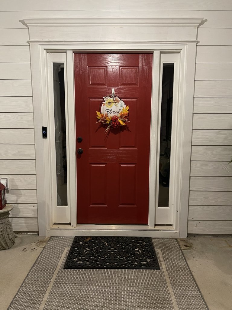

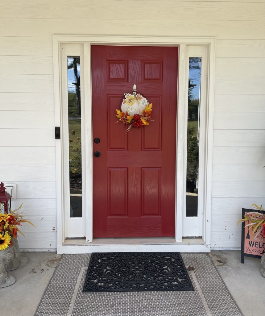

    The Wife wanted me to fancy up our front door a little bit so I did this yesterday now I am waiting on her to tell me what color that I am going to be painting it.IMG_3777.jpg IMG_3793.jpg
